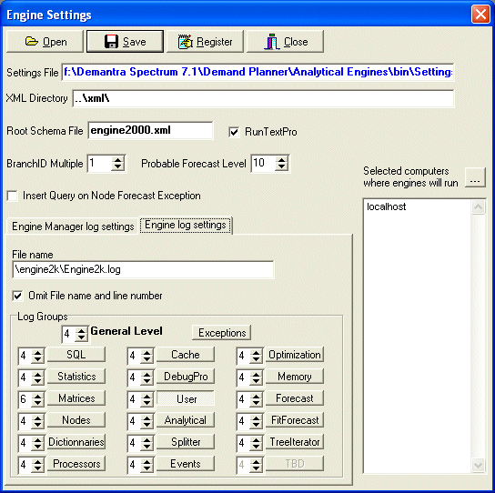

Engine configuration settings are edited in the Engine Settings window and saved in the file named settings.xml. When the engine starts, it reads the settings from this file.
To open the Engine Settings window
Click Settings > Configure Engine Settings. Or click the Configure Engine Settings button.
The Engine Settings window appears.
To load settings
Click Open.
Select settings.xml from the bin directory of the Analytical Engine.
The Settings File field displays the location of settings.xml.
Complete the fields as needed; see "Engine Settings".
Optionally choose different machine(s) to run the engine; see "Choosing Machines to Run the Engine".
To save your settings, click Save.
To register your settings, click Register.

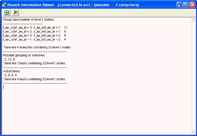

Viewing Branch Information
Internally, the Analytical Engine divides up each forecast tree into multiple branches and sends each branch to a different engine server. On one hand, it is useful to declare many branches, so that each engine will have less work. On the other hand, it is useless to declare more tasks than the forecast tree can possible include. Therefore it is useful to understand what the branches of a given forecast tree would be like.
To view branch information for a given forecast tree
Click View > Branch Information.
The Branch Information Viewer window appears.

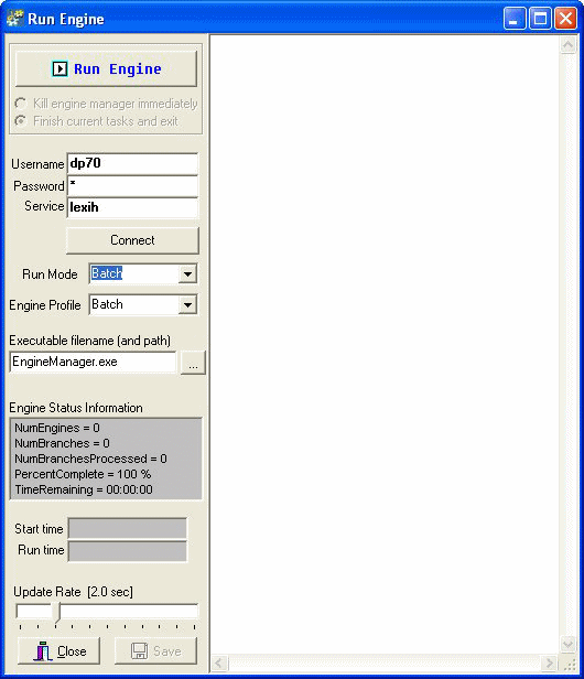

To run the engine
Start the Engine Administrator.
Click File > Run Engine. Or click the Run Engine button.
The Run Engine window appears.
Complete the fields Username, Password, and Service.
Click Connect.
For Engine Profile, choose an engine profile, which specifies the parameter settings to use during this engine run.
Enter EngineManager.exe in the Executable Filename (and path) field. This executable resides within the bin directory of the Analytical Engine.
Click Run Engine.
The Engine Status Information area displays the following:
Number of engines running
Number of branches (you use multiple branches when you have a large database)
Number of branches processed
Percent complete
Start time of the engine run, time remaining (if any), and end time (if finished)
The white text area in the right side of the Run Engine window displays the log.
To adjust the rate at which the log area is filled with data, drag the Update Rate slide to the left (slower) or to the right (faster).
The log shown in the text area can be saved to a file by clicking Save to file.
Under Terminate Engine Manager, select one of the following:
Finish current tasks and exit. This clears the queue of branch IDs (the messages sent by the Engine Manager to the engine servers). This allows the engine servers to complete their current processes. When they do not receive any further branch IDs, they shut down in an organized fashion. This is the recommended shutdown method in most circumstances. It is possible to continue processing at a later time.
Kill Engine Manager Immediately. This stops the Engine Manager immediately. The engine servers will continue for a while but when they notice that the Engine Manager has stopped, they will cease operation. Use this method when a quick shutdown is required, such as during debugging.
Note: Do not restart the Engine Manager if one or more engine servers are still running. Wait until they stop or close them using Windows Task Manager.
Click Stop.

You can also configure the engine to write forecast data for each node, before splitting to lower levels. This data is written to the NODE_FORECAST table, which includes information on how each model was used for that node. To enable this, set the node_forecast_details parameter to forecast is written with model details (1) before running the engine.
To edit these parameters, use the Business Modeler.

Start the Analytical Engine as described in "Running the Engine from the Engine Administrator" or "Running the Engine from the Start Menu".
