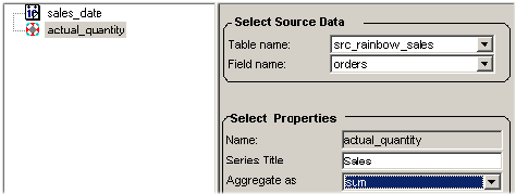

To declare the sales quantity
In the left box, right-click and then click Create Sales Quantity.
Select the table and field that contains the item quantity for any given sale. For example, in src_rainbow_sales, the orders field might contain the sales quantity for each sales record.
In Series Title, specify a user-friendly name for this series.
For Aggregate as, select the function to use when aggregating multiple records.

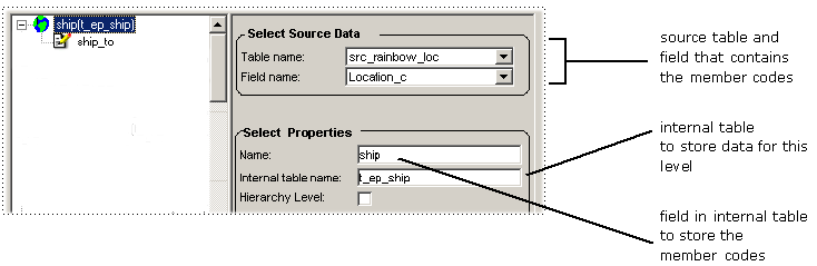

To define an item or location level
In the left box, right-click and then click Create Location Dimension or Create Item Dimension.
Then specify the level as follows:
In the Table Name field, click a source table from the drop-down list.
In the Field Name field, click the field within that source table that stores the unique codes that distinguish the members of this level.
In the Name field (in the Select Properties area), type a unique name of this level, for internal use.
Demantra automatically uses this as the basis for the Internal table name, which is the table in which Demantra will store information for each member of this level. Within this table, the member codes will be stored in a field whose name is the Name that you specified.

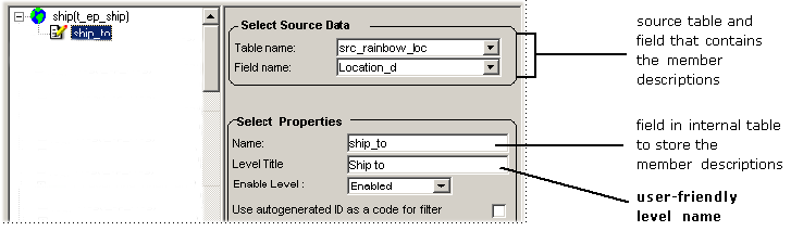

In the left box, right click the level and then click Create Description.
Specify the level description as follows:
For Table Name, select the same table.
In Field Name, select the field that stores the descriptions of the members of this level.
If the source data does not include a specific field that you can use as the member descriptions, then just use the field that stores the member identifiers.
In Level Title, type the name of this level, as it should be shown in the user interfaces.

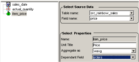

To declare the unit price
In the left box, right-click and then click Create Item Price.
For Table Name and Field name, select the table and field that contains the unit price for an item, at a given location and time. For example, in src_rainbow_sales, the orders field might contain the sales quantity for each sales record.
For Unit Title, optionally modify the title, whose default is Price.
For Aggregate as, select the function to use when aggregating the price of multiple items.
If you selected wavg (weighted average), then specify a weight to use. For Dependent Field, select a field within the same table that Demantra should use as the weights.

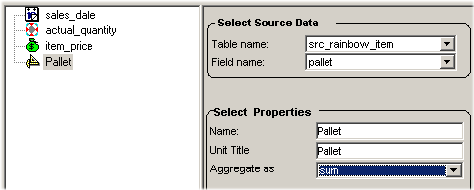

When you define a unit, you specify a set of conversion factors for that unit. The conversion factors can be different for different items.
Note: There must be a one-to-one relationship between the unit values and the members in the level where the unit is configured.
To define a unit
In the left box, right-click and then click Create Unit.
For Table Name and Field name, select the table and field that contains the conversion factor for this unit, for each item. For example, in src_rainbow_item, the pallet field might contain the conversion factor for each item.
The conversion factor for a unit X should give the number of Xs per base unit. For example, for a given SKU if a pallet consists of 100 items, then src_rainbow_item.pallet should be 0.01 for that SKU.
For Aggregate as, select the function to use when aggregating the unit count of multiple sales. You usually use Sum.
