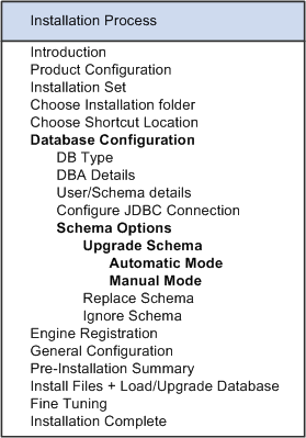

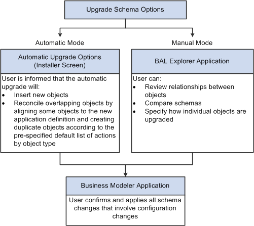

Two upgrade schema options are available: automatic mode and manual mode. In the automatic mode, the installer upgrades your schema based on a set of default actions:
New objects are inserted
Overlapping objects are be reconciled by aligning some of the objects to the new application definition and creating duplicate objects where relevant.
The automatic mode runs the BAL Explorer in the background without any personal interaction.

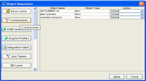

If you want to make specific choices about how objects are upgraded to the new schema, then you should choose manual mode. This mode launches the BAL Explorer and enables you to:

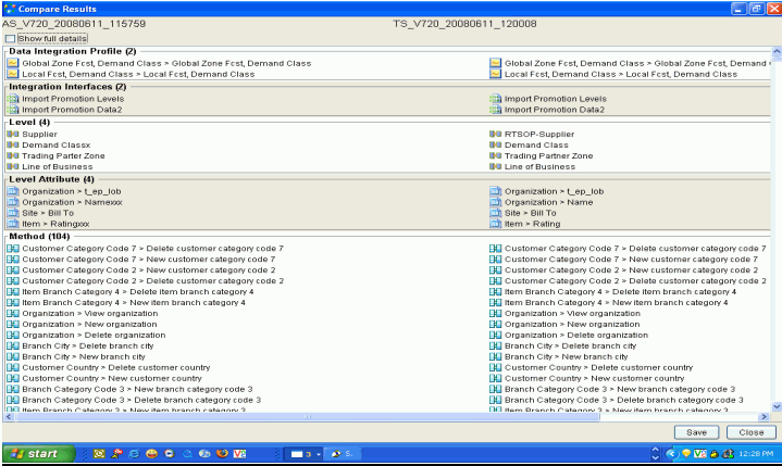

Review the relationship between objects
Compare schemas
Specify how individual objects are upgraded when conflicts occur between the schemas
The Business Modeler is invoked at the end of each upgrade mode, enabling you to apply any configuration changes identified in the new schema.
The following diagram shows the process involved with the two upgrade schema options:

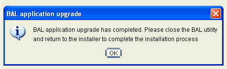

When the upgrade is complete, the Business Modeler displays the Upgrade Complete screen, which summarizes the objects that were upgraded.

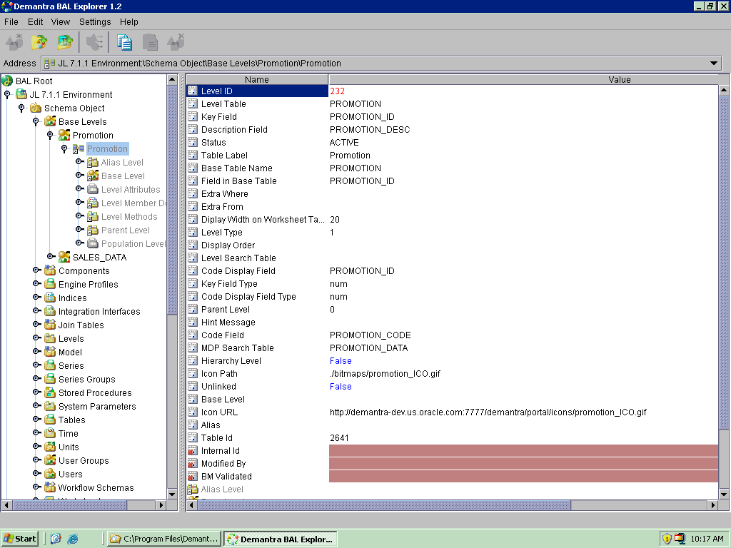

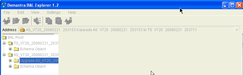

The BAL Explorer main screen, shown below, is comprised of two main components:
Schema Browser pane (on the left)
Object Details pane (on the right)
The Schema Browser displays all the schemas currently defined in the BAL Explorer. These schemas can be expanded to display the objects contained within the schema. Depending on the type of object you select, the attributes are displayed with icons representing their data type. For example, time attributes are displayed with a clock icon.
The Schema Browser also provides information about how objects are related.
Black represents a container relationship: object A contains object B (shown in black). Object B has meaning only within object A. Object B is shown in black within object A. For example, a list for a series has meaning only within that series.
Gray represents a referring relationship: object A refers to object B. Object B has meaning independent of object A. Object B is shown in gray within object A. For example, a worksheet refers to the Demand series.
The Object Details pane provides information about the object currently selected in the Schema browser, including:
Database fields that correspond to the configuration settings in the Demantra platform tools (Business Modeler and Workflow Editor).
Folders of objects that are contained within or referred to by the selected object.
The Object Details pane also displays any mismatches between the selected schema (the database) and the latest Demantra schema (the configuration files). Mismatches between the database and the configuration files appear as follows:
Green: Field is in the database but not found in the latest BAL configuration files.
Red: Field is in the BAL configuration files but not in the database. Missing fields are also indicated by the red x on the field icon.

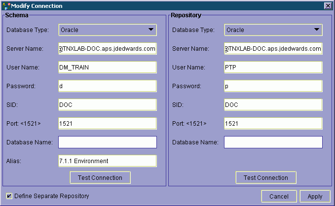

To create a schema connection:

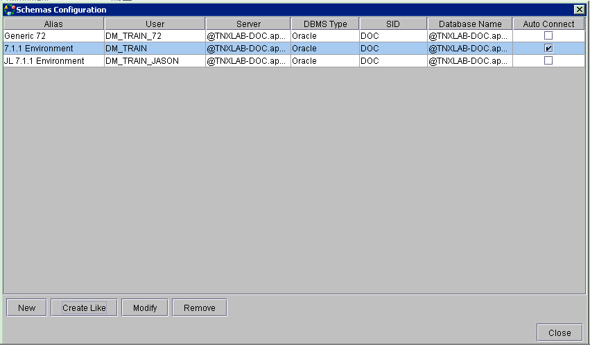

Click Open Schema. The Schema Configuration dialog box appears.

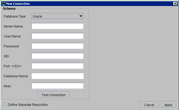

Click New. The New Connection dialog box appears.
Enter the following data in the following fields:
| Field | Description |
| Database Type | Select your database type. |
| Server Name | The name of the server where your database resides. |
| User Name | The user name of the database. |
| Password | The password of the database. |
| SID | If you are using an Oracle database, enter the SID. |
| Port <1521> | The port your database is using. The default is 1521. |
| Alias | The schema alias to appear in the Schema Browser. |
Select Define Separate Repository if you do not want the repository created in the current database tables. The Repository information area appears in the New Connection dialog box:
Note: A second database user must already exist for the repository to be successfully defined.
Click Test Connection to see if your schema is properly configured.
Click Apply. The new schema alias appears in the Schemas Configuration dialog box.
Click AutoConnect if you always want the schema to be active when you are working in the BAL Explorer.
Click Close. The new schema appears in the Schema Browser Pane.
To edit a schema connection:
Click Open Schema.
Select the schema you want to modify from the list of schema aliases.
Click Modify.
Make any changes necessary to your schema.
Click Apply.
Click Close.

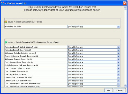

Important: Before upgrading to a new version, it is strongly recommended that you take a backup of your existing database.

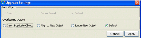

When you upgrade an existing schema to a new schema definition, conflicts can occur between the two schemas. The Upgrade Settings option provides guidance to the BAL Explorer when performing an upgrade. New objects are always inserted. Overlapping objects can be duplicated, aligned to the new object, or ignored.
There is a set of default options available for new and overlapping objects. The default options by object type are listed in a table below. When you choose the “Automatic Upgrade” option when installing, you are not able to interact with the BAL Explorer to change the default options. When you choose the “Manual Upgrade” option when installing, an upgrade package is created by BAL with the same default options but you can choose to change or override the default options in the BAL Explorer.
By default:
New objects are inserted.
Overlapping objects are either duplicated, aligned or ignored based on the object type itself.
Customizations to standard integration interfaces are not preserved during the automatic upgrade process.
Integration Interfaces and Data Profiles
| Type of Upgrade | Result |
| Automatic | BAL Explorer aligns modified standard integration interfaces and associated data profiles to the new version, |
| Manual | Same as the Automatic Upgrade except you can change the default upgrade action. |
After you upgrade:
Review your pre-upgrade schema backup for any standard integration interfaces that you may have customized. These interfaces would have been aligned to the new version in the upgraded schema.
Add back those customizations to the new version of the integration interface in the upgraded schema.

To set the global upgrade preferences:
From the Settings menu, select Upgrade Settings. The Upgrade Settings dialog box appears.
Note: New objects are always inserted.
For Overlapping Objects, select:
Insert Duplicate Object: Objects exist in both the original and new schema definitions. The original object is suffixed as "objectname_version number_build number", while the new object is created as a duplicate object with the same name as in the Demantra standard schema. See Naming Convention for Duplicate Objects for more information.
Note: Only overlapping objects that have changed between the current and new versions are duplicated. For example, if a worksheet in 7.1.1 has not changed compared to the 7.3 worksheet, then it is not duplicated when upgrading to 7.3.
Align to New Object: Original objects are merged with the objects in the new version schema definition. In cases where the table indicates "Align with Merge", the original objects are merged with the new objects; both exist after the upgrade.
Ignore New Object: Existing object is retained in its original form; new version of the object is ignored.
Default: Objects and sub-objects are upgraded based on the action type specified in the Table of Default Upgrade Actions for Overlapping Objects above.
Click Apply. All upgrade suggestions are based on these upgrade setting preferences from this point forward.

Click the source schema (the original schema).
Ctrl-click the target schema (the new schema).
For manual upgrades, right-click one of the selected schemas and select Compare. The Compare Results screen appears, listing the objects that differ between the two schemas. The system displays the source schema on the left (AS_V730_TIMESTAMP) and the target schema on the right (TS_V730_TIMESTAMP).
The installer takes you directly to the Compare Results screen.

Click Show full details to show the specific differences between the schemas.
Click Save to save the report in html format for future reference. The html reports are saved in the <Demantra install folder>\Demand Planner\BAL\logs\AS_V730_Timestamp to TS_V730_Timestamp folder. You can print the report from the saved document. Review the html comparison reports in detail to determine the optimum upgrade actions to use on your schema.
If you are not upgrading from the installer, click Prepare Upgrade for the schema that you want to upgrade. A progress bar appears so you can monitor the production of the upgrade package. When complete, the upgrade package appears in the Schema Browser before the schema object folder. In the following example, the AS_V730_20080221_2031 schema was prepared for upgrading. The upgrade folder appears before the schema object folder:
Click Close to close the Compare Results dialog box.
From the Settings menu, select Set Object Resolution. This selection enables you to modify the upgrade suggestions for each object individually.
Right-click the upgrade package and select Upgrade. The Object Resolution dialog box appears. The type of object conflict appears with the action suggested based on your global upgrade settings.
Choose how you want to handle each new or overlapping object.
For each new object, your options are:
Insert: Add the new object to the target database.
Default: Add the new object to the target database.
For each overlapping object, your options are:
Align to New: Align the source object with the target schema object.
Insert Duplicate: Create the new version of the object as a duplicate in the target schema.
Note: This option may not be available depending on the type of object.
Ignore: Retain the source object in its original form and ignore the new version of the object in the target schema.
Default: Objects and their sub-objects are upgraded according to the Table of Default Upgrade Actions for Overlapping Objects .
Click Apply when done. The source schema is upgraded to the target schema format based on your upgrade choices. A progress bar appears.
If there are any issues that need your intervention to resolve, the activation issues list is displayed. These issues can occur if you accidentally delete any objects that are referred to by other objects in the upgrade package.
For each issue displayed, you can accept the default Drop Reference which removes the link between the new objects and the existing object.
When you have specified how to deal with all the issues presented, click OK.
A prompt appears when the BAL application upgrade is complete. The following prompt is displayed for those upgrading using the installer. A different prompt appears if you are running the BAL without the installer.
Important: Do not close the BAL utility before receiving the prompt or the upgrade may fail.
Click OK to continue.
Close the BAL Explorer. If you are upgrading through the installer, the Business Modeler application opens automatically (this may take a few minutes). Otherwise, start the Business Modeler to continue the upgrade process.

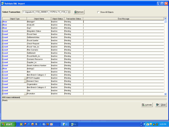

The Validate BAL Import screen appears. If are not updating from the installer, from the Configuration menu, select Validate BAL Import, and select the update package to continue.
Click the Activate button. The configuration changes are made through the Business Modeler to the database.

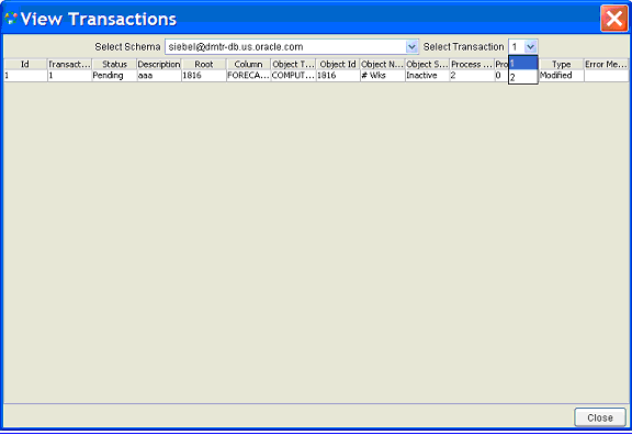

The View Transactions window displays information about all the schema upgrades that have been made within BAL, including the status, description, root, column, object table, type, and error message. You can filter the results by schema or transaction.
To view transactions, open the BAL Explorer application, select Transactions. The View Transactions window appears.
