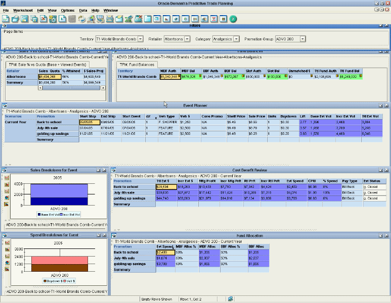

You plan and manage promotions in the Planning Environment, which is the entry point to both historical and planned event analysis. Event planning consists of creating and managing a calendar of promotional events, and understanding their impact on sales, promotion spending, and profitability, as well as their correlation with sales quotas. Demantra's Planning Environment provides all this critical information in one place.
In My Worksheets (in Collaborator Workbench), click Planning Environment.
If the worksheet does not show data immediately, click Data > Rerun. Or click the Run button.
At the top of the screen, select the territory, retailer, category, and promotion group.
In the Event Planner window, click a row. Notice the following changes in the rest of the worksheet, depending on the scenario and promotion associated with that row:
The graphs below this display graphical information for the promotion.
The tables below this display side-by-side details for all promotions within the currently selected scenario.
Click a promotion in the Cost Benefit Review or Fund Allocation window. Notice that the same promotion is highlighted throughout the worksheet.
The Planning Environment uses the following color conventions:
White indicates editable fields.
Gray indicates loaded data such as Start Ship and End Ship.
Blue indicates data that is calculated by PTP, especially by the Analytical Engine.
Red indicates negative profit numbers.
Also notice that in the Event Planner window, the Evt Status for a promotion may be displayed in different colors, to indicate whether that promotion has been optimized. Here:
White means that the promotion has not been optimized.
Yellow means that the promotion has been optimized.
Green means that the promotion has been optimized and accepted, so that the promotion is using the optimization results.

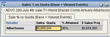

This window shows an analysis of planned sales to sales quota, for the given retailer. This is the total for the retailer. For convenience, the sales projection is also shown.

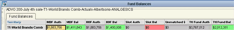

This window provides a detailed overview of authorized funds (MDF, BDF, slotting), spend and fund balances to date, for the given territory. This is the total for the territory.
This window shows event details such as the start and end ship dates, vehicle type, vehicle cost, buydown, base volume and incremental volume. Incremental volume is generated by Demantra's comprehensive analytical engine.
Notice that the events are grouped according to the associated scenario. As noted in "Promotions and Scenarios", the Sandbox scenario contains all the tentative events (unplanned events), and the Current Year scenario contains all the rest. The unplanned events have no impact on budget.

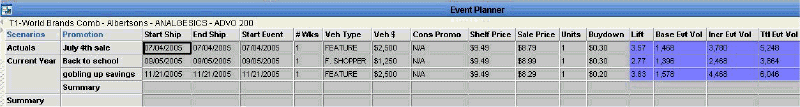

This window is the primary area in which you create or modify promotions.
Also notice that when you select a row in this window, the graphs and tables below are updated to show details depending on the scenario and promotion associated with that row.
This window graphically shows the sales breakdown for the selected event. The breakdown shows both base and incremental volume.
This window graphically shows the spending breakdown for the selected event. The breakdown shows both vehicle spending and buydown.
This window presents a detailed cost benefit analysis for each event in the currently selected scenario. Details include profitability metrics from both the manufacturer and retailer's perspective, overall event spend, cost per incremental unit (CPIU), and payment type. Here you can control the status of the event.
The incremental manufacturing profit is the additional profit that the manufacturer earns because of the promotion, in addition to the base profit that would be earned even without a promotion. The incremental retailer profit is analogous.
This window displays the allocated funding for each event in the currently selected scenario. Here you allocate the promotional costs between the MDF and BDF funds.

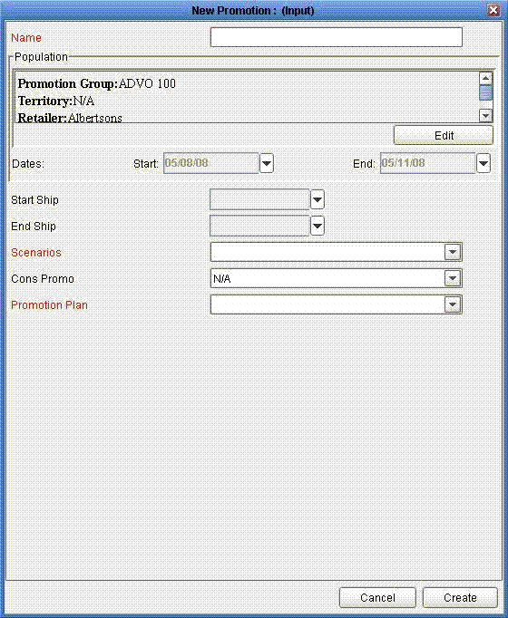

In the Event Planner window, right-click an existing promotion and then select New Promotion.
Oracle Demantra displays the following screen:
For Name, specify a name for this promotion.
The Population area shows the currently selected combinations with which the new promotion will be associated.
The default combinations are taken from the current selection in the worksheet. To change them, see "To reassign a promotion to a different item or location".
The Start and End dates are controlled by default settings. Edit them as needed.
Specify values for the other attributes as appropriate:
| Start Ship, End Ship | Optionally specify when the product will be shipped for the promotion. You might specify this information later, when the promotion is more certain. |
| Scenarios | Choose Sandbox. |
| Cons Promo | Specify the type of consumer overlay, if any. This affects the number of Units. For example, if Cons Promo is a two-for-one deal, then Units becomes 2. |
Click Create. The new promotion is created and is displayed in the Event Planner window. It has a default cost based on the vehicle type you specified.

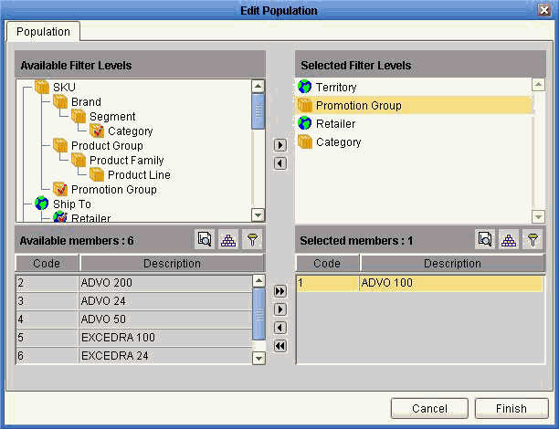

You can reassign an unplanned promotion to associate it with a different territory, retailer, item, or Ship To, as needed.
Important: You must create both a Refresh Population workflow and method before executing this procedure. First, create a Refresh Population workflow that contains only the Refresh Population workflow step. Then create the Refresh Population method on the Promotion level without any input or output arguments and link it to the Refresh Population workflow.
Right-click a promotion and click Edit.
Click Edit below the Population area.
The Edit Population dialog box is displayed.
Usually a promotion is associated with a territory, retailer, category, and promotion group.
To change the territory, retailer, category, or promotion group, click that level name in Selected Filter Levels and change the selection displayed in Selected members.
For example, to associate the promotion with a different promotion group:
In Selected Filter Levels, click Promotion Group.
Then in the Selected members list, double-click the promotion group that you no longer want to use for this promotion. For example, double-click ADVO 100 to remove it from this list.
Then in Available members, double-click the promotion group that should be used. This promotion group is then moved to the Selected members list. For example, double-click ADVO 200 to move it to the Selected members list; now the promotion is associated with ADVO 200 instead of ADVO 100.
Repeat as necessary.
Click Finish to exit this dialog box.

| View | Series | Description |
| Sales % vs Quota (Base + Viewed Events) | Sales Quota | Sales quota (revenue) |
| % Attained | Percentage of sales quota attained | |
| $ Sales Proj | Planned sales dollars: actuals plus forecast | |
| Fund Balances | MDF Auth | Authorized market development funds, calculated as follows: (base rate + dev rate)*volume + fixed MDF funds |
| MDF Bal | Remaining market development funds, calculated as the authorized MDF less the spent or committed funds | |
| BDF Auth | Authorized brand development funds+D75 | |
| BDF Bal | Remaining brand development funds, calculated as the authorized BDF less the spent or committed funds | |
| Slot Auth | Authorized slotting funds | |
| Slot Bal | Remaining slotting budget, accounting for the part that has been spent | |
| Unmatched $ | Trade spend not yet matched to a promotion. | |
| Ttl Fund Auth | Total authorized spending, including MDF, BDF, and slotting | |
| Ttl Fund Bal | Remainder of total authorized spending, after accounting for spending | |
| Event Planner | Start Ship | Date when product will start to ship |
| End Ship | Date when shipments will end for the event | |
| Start Event | Date when promotion starts in stores | |
| # Wks | Event length in whole weeks, assuming that each week starts on Monday. | |
| Veh Type | Vehicle type or event type of the promotion | |
| Veh $ | Vehicle cost for the promotion | |
| Cons Promo | Consumer overlay, the deal type as seen by the consumer. | |
| Shelf Price | Everyday price to the consumer | |
| Sale Price | Sale price per unit at shelf | |
| Units | Number of units in the deal to the consumer. Usually equal to 1. Use 2 for 2-for-1 sales, for example. | |
| Buydown | Buydown allowance per unit, discount offered to retailer for running the event | |
| Lift | Lift factor for the promotion | |
| Base Evt Vol | Base volume during the promotion | |
| Incr Evt Vol | Incremental volume due to the promotion | |
| Ttl Evt Vol | Total volume for the promotion | |
