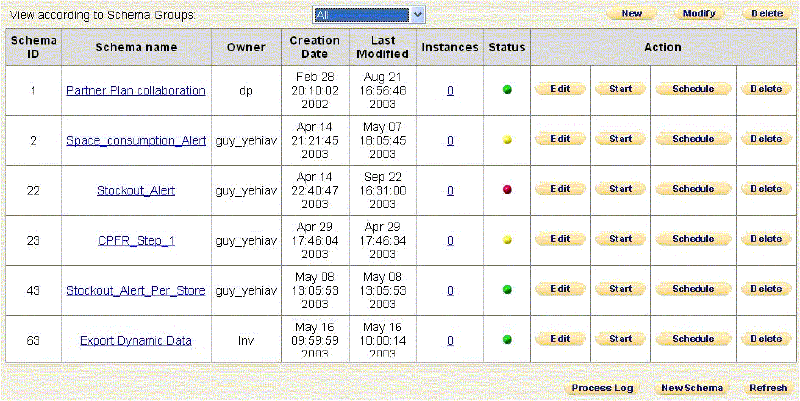

The Workflow Manager comes up, displaying a list of workflow schemas.
Click Start next to the schema that you want to start.
You can view all the status of all public workflow schemas and all private workflow schemas that you created. This means that you can see how many instances of those schemas are running, as well as the status of each instance.
The Workflow Manager displays the overall status information for the workflows.
Each row corresponds to a workflow schema. The Instances column indicates how many instances of this workflow schema are currently running, if any. The Status column uses the following color codes:

Click the Instances link in the row corresponding to that workflow.
The Workflow Manager lists all the instances of that schema that are currently running.

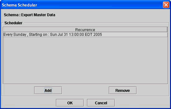

The system displays the Schema Scheduler page, which lists all the times when Workflow Engine will start an instance of this schema.
Click Add.

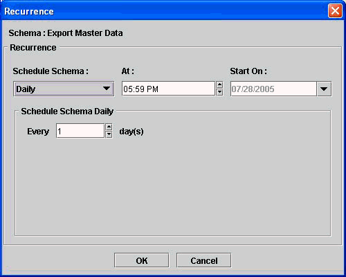

In the Schedule Schema dropdown list, select the option that specifies how often to start an instance of this workflow:
Daily
Weekly
Monthly
Once
At Startup (This option launches the workflow whenever the Web server is started.)
Periodic (in this option, you can start a workflow at periodic intervals (measured in seconds, minutes, hours, days, weeks, months, or years. Note that you cannot choose the starting time.)
Depending on the choice you make here, the system displays additional scheduling options in the bottom part of the page.
In the rest of the page, finish specifying the schedule.
Click OK.
On the Workflow Management page, click Schedule in the row corresponding to that workflow.
The system displays the Schema Scheduler page. This page displays one row for each scheduling entry for this workflow.
Click the row corresponding to the scheduling entry you want to remove.
Click Remove.

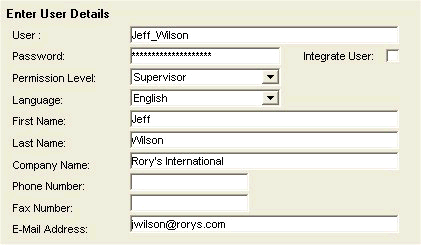

The User Details dialog box appears.
Specify basic user details as follows:
Under Enter User Details, type the following information in the appropriate boxes (or select from the dropdown lists):
For Permission Level, use System Manager if this user needs access to the Business Modeler and the Workflow Manager. Otherwise, use Supervisor.

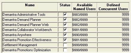

The User Modules dialog box appears. Here you specify which Demantra user interfaces this user can access.
Click the check box next to each module that the user needs to work with. Then click Next.

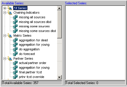

The New User - Select User Series dialog box appears. This dialog box allows you to determine what data series will be active for the new user, from the entire set of series in this component. Each list is a collapsible list of series groups and the series in them.
If a series is not active for a user, it is not available when the user creates worksheets and is not viewable in existing worksheets to which the user has access.
Specify the series that a user can see, as follows:
Move all series that you want into the Selected Series list. To do so, either double-click each series or drag and drop it.
Remove any unwanted series from the Selected Series list.
Note: You can also move an entire series group from one list to the other in the same way.
When you are done specifying series, click Next.

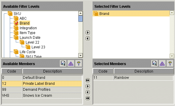

The New User - Select User Filters dialog box appears. This dialog box lets you filter the data that the user can see; specifically, you control which levels and which members of those levels the user can see.
Filter the data that the user can see, as follows:
Click a level in the left side of the dialog box and drag it to the box on the right. Or double-click a level in the left side.
Now specify which members of this level the user can see. To do so, click a member in the list, and then click the right arrow button. Or double-click the member you want to filter out.
The system moves the selected members to the box on the lower right side. Now the user can see only the selected members of this level. In the preceding example, the user can see only data that is associated with the Rainbow brand.
Note: The Selected Members list cannot include more than 200 members.
Repeat the preceding steps for each filter you want to add. Each filter automatically limits the choices available in subsequent filters.
When you have appropriately filtered data for the user, click Next.
