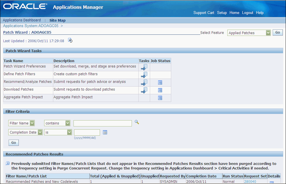

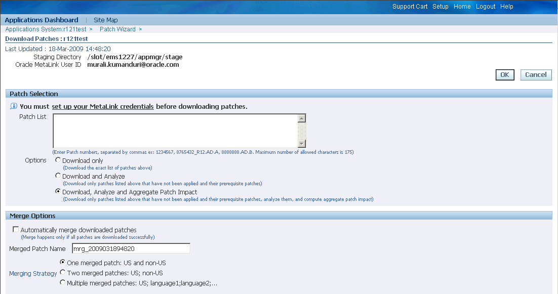

OAM (Web-based) procedure
Access the Oracle Applications Manager.
Follow the instructions in Accessing Patch Wizard to access OAM.
From the Patch Wizard Tasks table, click the Tasks icon corresponding to Download Patches.
The Download Patches page appears.
Download Patches Page - Top
Enter the patch numbers of the patches you want to merge in the Patch List field.
In the Merge Options area, select Automatically merge downloaded patches. Also, specify the merged patch name and the merging strategy in this section. Click OK to begin downloading and merging the patches.

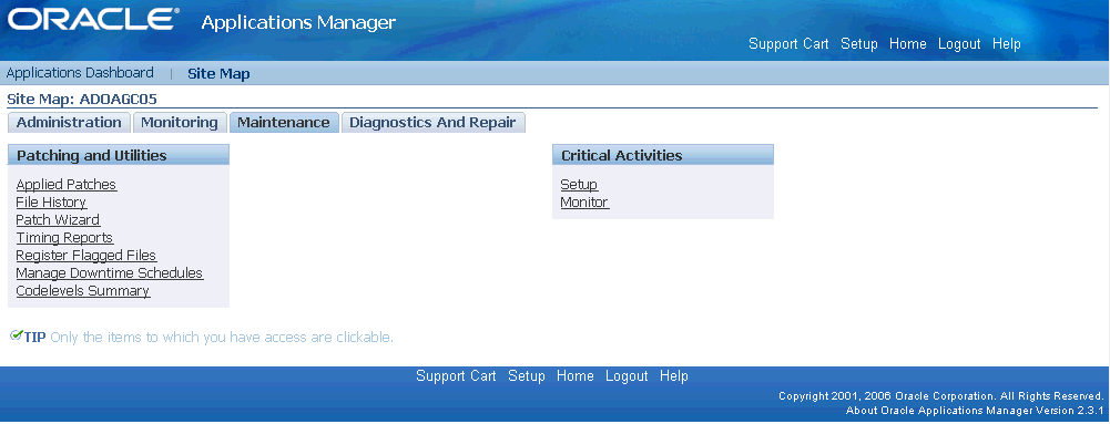

Access the Patch Wizard home page.
From the Site Map (Maintenance tab), click Patch Wizard under the Patching and Utilities heading.
Site Map Page
The Patch Wizard home page appears.

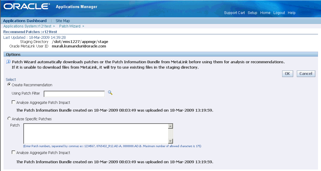

Submit a request for recommended patches.
From the Recommend Patches page, select a patch filter. Use the magnifying glass icon to see a list of available patch filters.
Recommend Patches Page - Top

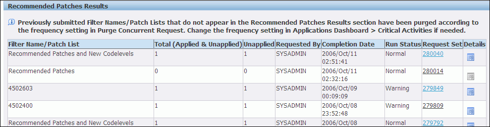

After you have entered the request information, click OK. The results of your request are shown in the Results section of the Patch Wizard main page. You can also schedule the request for a future date.

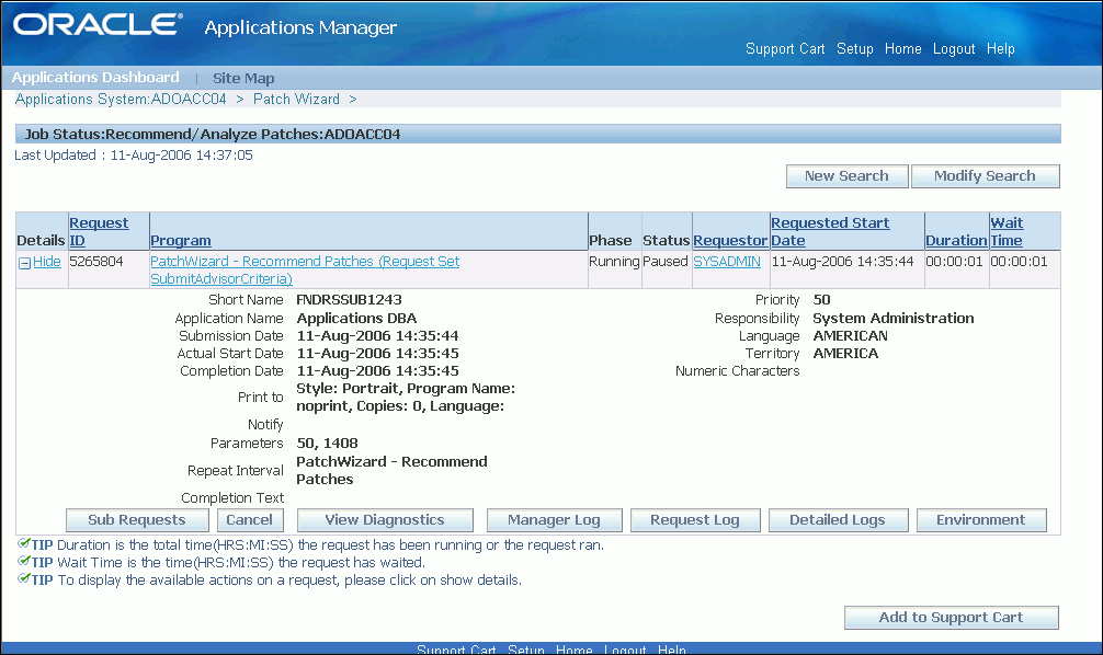

Track the status of your request.
From the main page, you can track the status of your recommended patch request. Click the Job Status icon for the Recommend/Analyze Patches task.
Job Status Page
The Job Status page displays summary information. If you click the Show/Hide icon corresponding to your request ID, the page displays more details. For more information about the fields and functions on this page, see: Patch Wizard.
Patch Wizard Home Page
Submit a request to download patches.
Click the Tasks icon for Download Patches. The Download Patches page appears.
On this page, list the patches you want to download in the Patch List field.

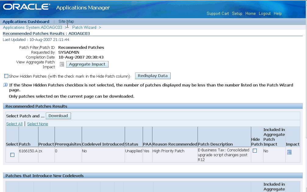

Another option is to click the Details icon for a recommended patch request in the Results section of the Patch Wizard home page.
Patch Wizard Home Page - Recommended Patches Results
The Recommended Patches Results page for the recommended patch request appears.
Recommended Patches Results Page
Select any number of recommended patches on this page and click the Download button. This populates the Patch List field in the Download Patches page with the selected patch numbers.
Set download options.
On the Download Patches page, set Merge options and indicate information about languages and platforms. If you choose to automatically merge patches while downloading, specify the merged patch name and the merging strategy. You can select the languages and platform of the patches to download. When you provide information in this section of the page, Patch Wizard only downloads patches that match the selected languages and platform. You can also schedule the download for a future date.
Submit request.
After you have entered the patch information, click OK.

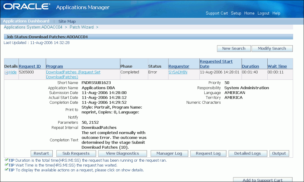

From the main page, you can track the status of your patch request. Click the Job Status icon for Download Patches.
Job Status Page
The Job Status page displays. If you click the Show/Hide icon corresponding to you request ID, the page displays more details. For more information about the fields and functions on this page, see: Patch Wizard.

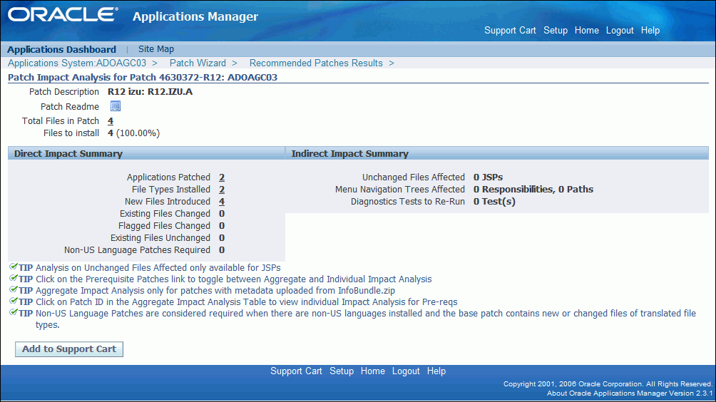

Access the Patch Impact Analysis page.
Clicking the Impact icon in the Recommended Patches Results page opens the Patch Impact Analysis page for the selected patch.
Patch Impact Analysis Page
Many of the line items on this page are links to detailed information about the impact of the patch on the system. For example, the File Types Installed value is a link to a page that lists the file types and the number of unchanged, changed, and new files in the file system as a result of applying the selected patch.

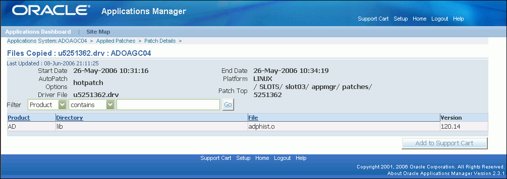

As an example of the details that are available for a selected driver, click Files Copied.
Files Copied Report
For each file, the Files Copied report shows the product short name, the directory where the file was copied, the name of the file, and the version number. To view other information associated with the driver file, click the Patch Details link at the top of the page to return to the previous page.

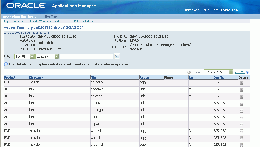

View the Action Summary report.
You can create a report that summarizes the actions of a selected driver file. Click the Patch Details link at the top of the page to return to the Patch Details page. (You can also access the Action Summary report by clicking the bug fix number on the Bug Fixes report.)
From the Patch Details page, select a driver and click the Action Summary button.
Action Summary Report
The Action Summary report shows more information about the driver and its actions. For definitions of the column headings, see Action Summary.

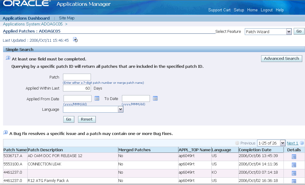

Enter the search criteria. For details about using the Simple Search page, see: Determining If a Patch Was Applied, or click the OAM Help button.
Specify the patch.
On the Simple Search page, enter the ID of the translation patch in the Patch field. Click Go.
Review the Patch Summary report
All applications of the patch are displayed. If multiple translations were applied, there will be multiple rows. The Language column shows the languages applied.
Applied Patches Page - Simple Search

Navigate to the Timing Reports (Navigation: Sitemap > Maintenance > Patching and Utilities > Timing Reports).
See: Timing Reports.

Analyzing Patches Without an Internet Connection
Requirement: How do I analyze specific patches if I do not have access to an Internet connection?
You can run Patch Wizard to analyze specific patches without access to an Internet connection, if necessary, by downloading the patches to a system which has Internet access. Once the download is complete, copy the patches to the Patch Wizard's staging directory. Then run Patch Wizard as you normally would based on the files you copied to the staging directory.
To analyze specific patches without using an Internet connection
Download the patch zip file(s) to a system which has Internet access.
Set up a staging directory on a system that does not have Internet access. Patch Wizard must be able to read from and write to this staging directory.
Copy the patch zip file(s) to the <staging directory>/ad directory, if the downloaded patch is an AD product patch. Otherwise, copy the patch zip file(s) to <staging directory>/nonad directory. The zip file(s) must be copied to a system that can access the Patch Wizard staging directory. If the staging directory is on a local disk, the zip file(s) must be copied to the system where you run Patch Wizard. If the staging directory is on a shared (network) disk, it can be copied to any system with access to the shared disk.
Run Analyze Specific Patches as you normally would from this point.
