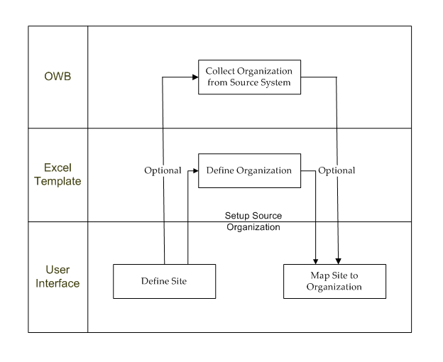

The site definition is set up in Oracle Manufacturing Operations Center and mapped to source organizations in different systems. A Site can be a production or non-production facility with manufacturing units or can only have office buildings for administration, marketing, and research and development. In this guide, a plant refers to a site that is a production facility. The following diagram illustrates the site setup flow:
To set up a site:
Define MOC site using the Site Setup user interface.
Load the source organization from EBS.
For initial data collections (a full refresh), run the MTH_PLANTS_DIM_EBS_INIT_PF process flow in the MTHEBIIP module.
For incremental collections, run the MTH_PLANTS_DIM_EBS_INCR_PF process flow in the MTHEBICP module.
Define non-EBS source organizations in the Microsoft Excel template by updating the definitions in MTH_ORG.csv.
Load non-EBS source organizations by running MTH_ORG_XS_ALL_MAP in the OWB Mapping MTH Utilities project.

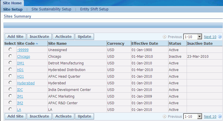

You can set up sites, define the currency for a site, and activate or inactivate the site using the Sites Summary page. You can also assign a site to a source organization.
To add a site
Using the Manufacturing Operations Center responsibility, click Site Home. The Sites Summary page appears.
Click Add Site. The Add Site page appears.

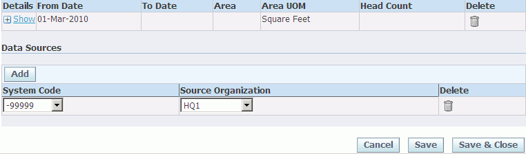

Data Sources
Click Add to add a System Code and Source Organization to the site.
Click Save and Cancel to add the site.

You can view the summary of sites available in the Oracle Manufacturing Operations Center application using the Sites Summary page.
To view the sites summary
All sites are Active by default. Click Inactivate to inactivate a site.
Click Update to update a site.
Click Add to add a site.

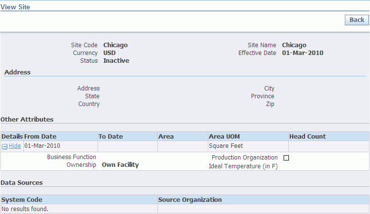

You can view the site details using the View Site page.
To view a site
Navigate to the Sites Summary page. The page displays a list of sites.
Click on a Site Code. The View Site page displays the details of the site.

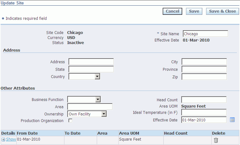

You can update site details using the Update Site page.
To update a site
Select the Site for which you want to update information.
Click Update. The Update Site Page appears.
You can edit the following:
Address
All the fields in the Other Attributes region.
Data Sources
Click Save to save the new values and remain on the same page.
Click Save and Close to navigate to the Site Summary page.
