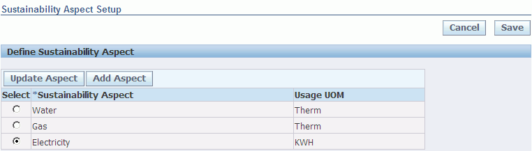

To setup sustainability aspect
Navigate to the Sustainability Aspect Setup page.
In the Define Sustainability Aspect region, click Add Aspect and select the name of the Sustainability Aspect. Electricity and Gas Aspects are seeded in the application.
Select the Usage UOM.
Click Save.
Select Update Aspect to update the information for a sustainability aspect. You can update Usage UOM only.

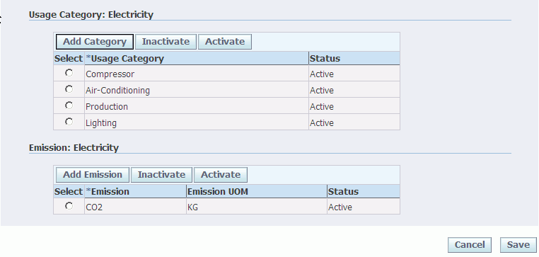

To define Usage Categories
Select the Sustainability Aspect for which you want to define usage categories.
In the Usage Category region, click Add Category.
Select a Usage Category as Air-conditioning, Lighting, Compressor, or Production. The Status displays as Active by default.
Click Save. If you want to inactivate a usage category, then select the Usage Category and click Inactivate.
To define Emissions
Select the Sustainability Aspect for which you want to define emissions.
In the Emission region, click Add Emission.
Select an Emission and the Emission UOM from a list of seeded values.
Click Save. The Status displays as Active by Default. If you want to inactivate an emission, then select the Emission and click Inactivate.

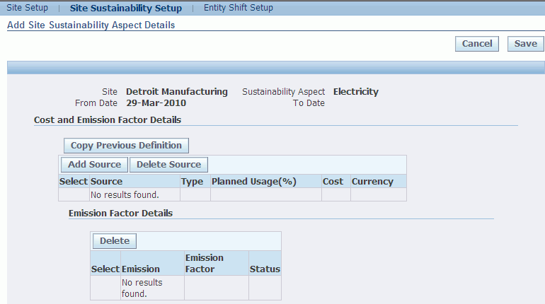

Use the Add Site Sustainability Aspect Details page to add new site sustainability information.
To add site sustainability aspect details
Navigate to the Search Site Sustainability Aspect page.
Search for the Site and the Sustainability Aspect for which you want to add new details.
In the New Cost and Emission Setup region, click Add Cost and Emission Factor. The Add Site Sustainability Aspect Details page appears. The header region of the page displays the Site, Sustainability Aspect, From and To Date and the Number of Sources.
In the Cost and Emission Factor Details region:
Click Add Source.
Select the Source and Type.
Enter the Planned Usage% and Cost.
To delete a source, select the Source and click Delete Source.
To copy details in the Cost and Emission Factor details tables from the last record, click Copy Previous Definition.
Click Save.

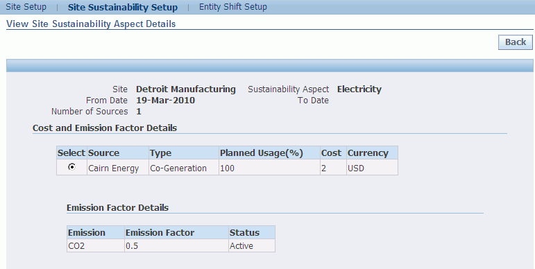

Use the View Site Sustainability Aspect Details page to view the site sustainability information.
To view site sustainability aspect details
Search for the Site and the Sustainability Aspect for which you want to view the details.
In the Search Results, click the From Date field to view the sustainability aspect details in a specific date range. The View Sustainability Aspect Details page appears. The header region displays the From Date and To Date and the Number of Sources for the Sustainability Aspect.
4. The following fields display:
Source is the source of energy.
Type is the source type. Type displays as either Cogeneration or Utility.
Planned Usage % is the percentage of planned usage of the energy source for the site and sustainability.
Cost is the cost of using the energy as per the Planned Usage %. The sum of all planned usage % for all sources defined is equal to 100%.
Currency is the currency in which Cost is expressed.
Emission is the emission resulting from the usage of energy.
Emission Factor
