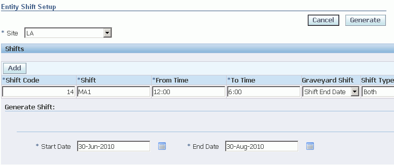

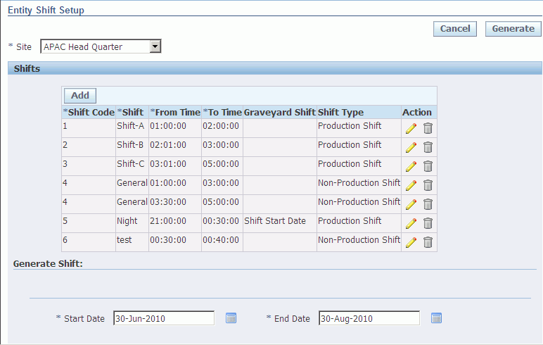

You can set up entity shifts using the Entity Shift Setup page.
To perform entity shift setup using the Entity Shift Setup page
Using the Manufacturing Operations Center Administrator responsibility, click Site Home.
Select the Entity Shift Setup tab.
Select the site for which you want to perform shift setup.
In the Shifts region, enter the Shift Code and Shift.
Enter the From Time and To Time for the shift.
Select the Graveyard Shift as Shift Start Date or Shift End Date.
Select the Shift Type as:
Production to inherit the shift to all production entities and organizations attached to the site
Non- Production to inherit the shift to all non-production entities and organizations attached to the site
Both to inherit the shift to all production and non-production entities and organizations attached to the site
In the Generate Shift region, enter the Start Date and End Date for the shift.
Click Generate. A message displays that the shift is created.
Click Ok.
Note: When you click the Generate button, the shift is generated in initial mode and shifts are overwritten for the period between Shift Start Date and Shift End Date.
To view entity shifts
Navigate to the Entity Shift Setup page.
Select the Site for which you want to view the shifts. The Shifts region displays the shifts for the site.
To add a shift
In the Generate Shift region, enter the Start Date and End Date for the new shift.
Click Add. A row in the Shifts region is enabled.
Enter the details for the shift.
Click Ok.

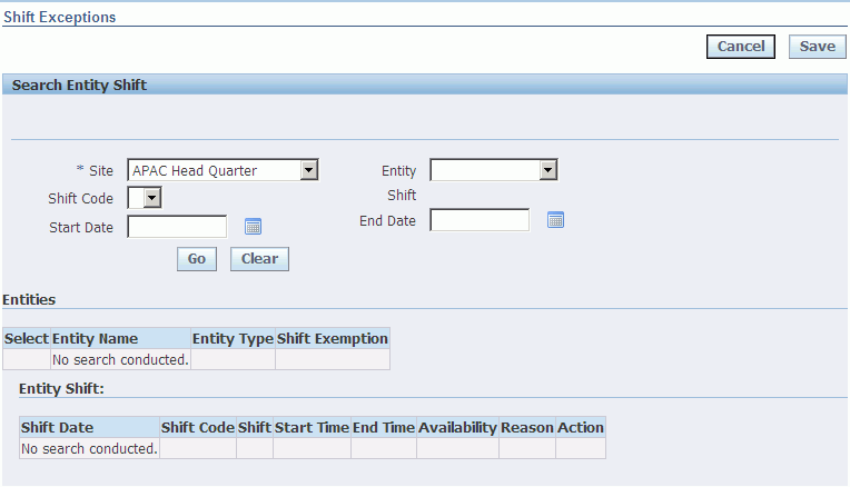

You can edit shifts for exceptions by using the Shift Exceptions page.
To edit shifts
Using the Manufacturing Operations Center User responsibility, navigate to the Shift Exceptions page.
Enter any of the following search criteria to in the Search Entity Shift region to view entity shifts:
Site. Required.
Entity
Shift Code. If you select Shift Code, then the value in the Shift field displays by default.
Start Date
End Date

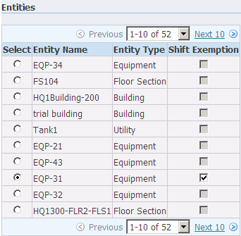

Click Go. If you search by Site, the Entities region displays all the entities of the site

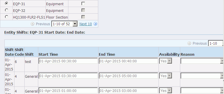

To view the shifts of an entity, select an entity. The Entity Shifts region displays the shifts of the selected entity and their Availability.
To exempt a shift, select an Entity Name in the Entities region.
Select the Shift Exemption check box to delete the shifts for the entity for the selected date range.
Click Save.
