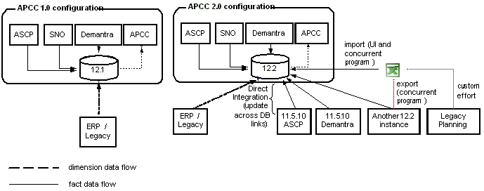

The following diagram compares the configurations of APCC 1.0 and 2.0.

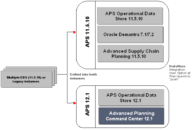

11.5.10 Out-of-Box
For the 11.5.10 customers, there is a complete, out-of-box integration to a separate, standalone 12.2 APCC instance. The key assumptions and limitations that apply in this case are:
All dimensions are collected or loaded using legacy upload, into the APCC instance.
The EBS source instance setups, including instance codes, are identical in 11.5.10 and 12.2 instances.
The drill-downs into ASCP, IO, and Demantra are not supported.
This scenario is available for Demantra, Oracle Demand Planning (ODP), ASCP and IO only.

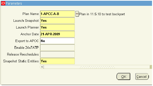

For ASCP and IO plans, there is a new plan launch parameter, Export to Advanced Planning Command Center. The available values are Yes and No. The default is No.
Note: If the Set to Display KPI Indicators plan option is set to No, the Export to Advanced Planning Command Center parameter must also be set to No. It cannot be updated.
When the Export to Advanced Planning Command center parameter is set to yes, perform the steps below:

On APS 11.5.10 instance, the ASCP and IO Launch Plan concurrent program has a parameter named Export to APCC. This launches the Archive Plan Summary program internally for the current plan with the following default values:
Plan = Current plan name
Keep Archived Versions = No
Publish All Demantra Facts = No
When set to Yes, it triggers the Archive Plan Summary Program and creates a new archive of the plan on the APCC 12.1.

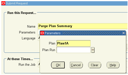

Integration with 11.5.10 Purge Plan Summary
From APS 11.5.10 instance you can launch the concurrent program Purge Plan Summary to purge the facts of a plan, or a specific version of a plan, from both the APS 11.5.10 and APCC 12.1 instances. There is also a Purge Plan Summary program on 12.1 instance that you can launch independently, as shown below:

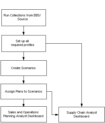

To launch 12.1 integration, follow the processes below:
Launch collection from the EBS/Source system.
Set up all the required profiles for the APCC 12.1 integration.
Create scenarios.
Assign plans to these scenarios to enable comparisons in APCC reports and dashboards.
A summary of the process is shown in the diagram below.

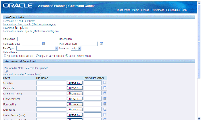

A new menu entry under the Advanced Planning Scenario Manager, named Load Fact Data From External Systems, accesses the Load Fact Data page. The data you load, using .csv file format, can be from either a legacy planning application or files that are exported from another 12.2 or 11.5.10 planning application.
You also have the option to upload the data using Id’s for all entities, subject to the condition that the same source ERP instance. If you choose this option, you must:
Apply the same instance code to the uploaded file.
The instance codes that are available in the files are also set up in the target instance with the same name
All necessary master data, such as organizations, items, resources, must be available in that target instance with the appropriate source instance code.
There are three methods available for uploading your data:
1. Append to latest version: This option allows you to append with or without an overwrite date. You will receive an error is your plan is not named.
If you choose append to latest version with no overwrite date, the application adds the uploaded data to the latest version.
If you choose append to latest version with overwrite date, the applications deletes all data for that entity after the overwrite date in the latest version and then uploads the data to the latest version. This is useful when uploading historical data, for example, shipment history.
Note: Don't forget to name your plan. In the append method of uploading your data, you will receive an error if the plan is not named.
Replace latest version: This option deletes all data for that entity in the latest version and uploads the data to the latest version. When you use this method to upload your data, you must create a new plan if there is not a plan with the same name.
3. Create new version: This option creates a new version by using the current date and the next sequence number.
In any plan, only one file can be loaded per entity. You do not need to load data for all twelve entities at the same time. When you do upload more than one file at a time, however, the upload method you have chosen applies to all files.
You can identify the plans created by the Load Fact Data page with a flag. Use this flag to ensure that:
These plans are never displayed in any application except the APCC dashboards.
The Append and Replace functions only work with these special plans and not regular plans.
