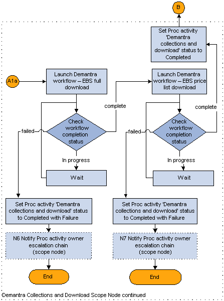

Running the Demantra Collections and Download Subprocess
The Demantra Collections and Download subprocess begins when the ASCP Collections subprocess finishes. It executes a series of collection and download activities. It runs download activities by invoking Web services that exist in Demantra Demand Management workflows. This assumes that a generic Web service exists that takes a Demantra workflow name as a parameter and executes that workflow.
The BPEL process calls a Web service called Check Demantra Workflow Status, which determines when each download operation is complete. This assumes that a generic Web service exists that uses a Demantra workflow name as a parameter and returns the completed status of that workflow.
This is the first of three diagrams that illustrates the Run Demantra Collections and Download subprocess:
the picture is described in the document text
This is the second of three diagrams that illustrates the Run Demantra Collections and Download subprocess:
This is the final diagram that illustrates the Run Demantra Collections and Download subprocess:

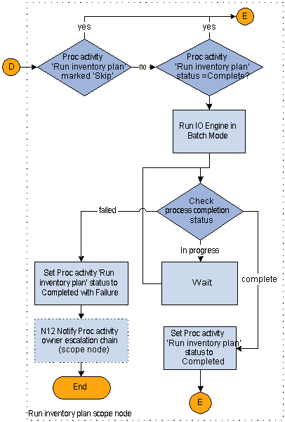

Running the Inventory Plan Subprocess
This diagram illustrates the Run Inventory Plan subprocess:

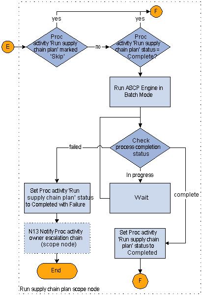

Running the Supply Chain Plan Subprocess
This diagram illustrates the Run Supply Chain Plan subprocess:

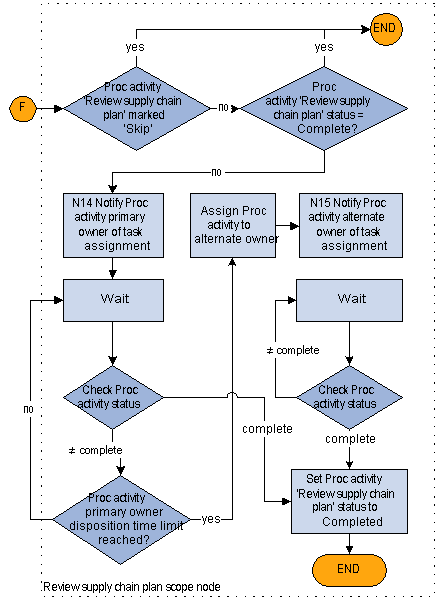

Reviewing the Supply Chain Plan Subprocess
The Review Supply Chain Plan subprocess notifies the owner of the activity to access the ASCP application to verify, change, and release the results. The escalation logic is executed if the primary owner does not respond to the notification within the amount of time specified in the Finish by field of the activity.
This diagram illustrates the Review Supply Chain Plan subprocess:

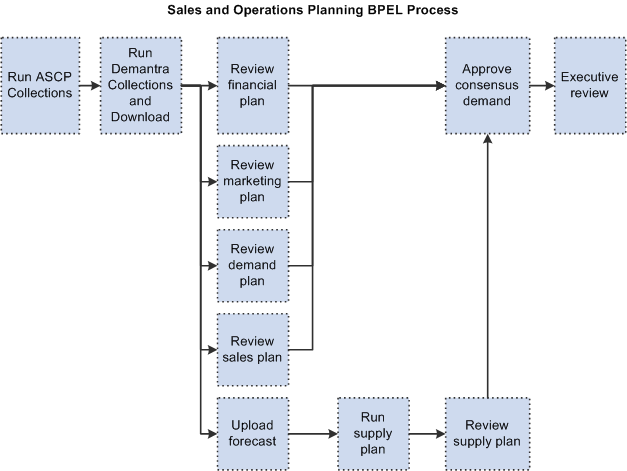

The Sales and Operations Planning Business Process
The sequence of the Sales and Operations Planning subprocesses is:
  1. Run the ASCP Collections subprocess.
  2. Run the Demantra Collections and Download subprocess.
  3. Review the Financial Plan subprocess.
  4. Review the Marketing Plan subprocess.
  5. Review the Demand Plan subprocess.
  6. Review the Sales Plan subprocess.
  7. Upload the Forecast subprocess.
  8. Run the Supply Plan subprocess.
  9. Review the Supply Plan subprocess.
  10. Approve the Consensus Demand subprocess.
  11. Run an Executive Review subprocess.
This diagram illustrates the Sales and Operations Planning business process:
The basic structure of most subprocesses is similar to those of the Forecast, Inventory, and Supply Planning BPEL process. See BPEL Processes appendix, The Forecast, Inventory, and Supply Planning Business Process section.

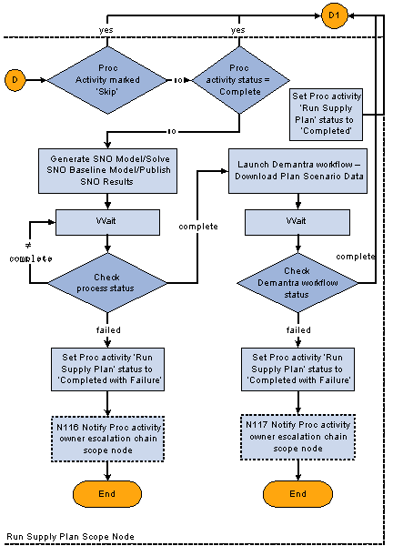

Running the Supply Plan Subprocess
The Run Supply Plan subprocess uses Oracle’s Strategic Network Optimization (SNO) application as the supply plan evaluation engine. The Sales and Operations Planning BPEL process automates the Real Time (RT) - Sales and Operations Planning to SNO to RT-Sales and Operations Planning cycle.
The Download Plan Scenario Data step requires a service, which can launch an existing workflow in Demantra Demand Management with a level member context.
This diagram illustrates the Run Supply Plan subprocess:
