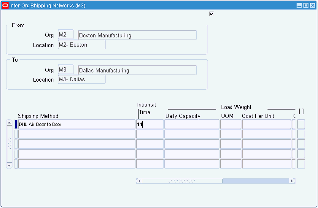

| 8. Define Delivery Times Specify the delivery times for shipment methods that have been defined in Oracle Inventory. Used by Scheduler to determine when a technician could be scheduled based on the delivery time of the parts. |

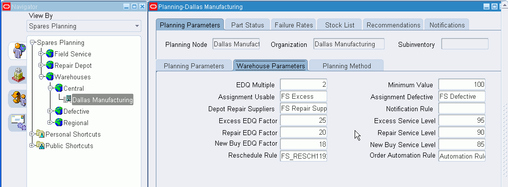

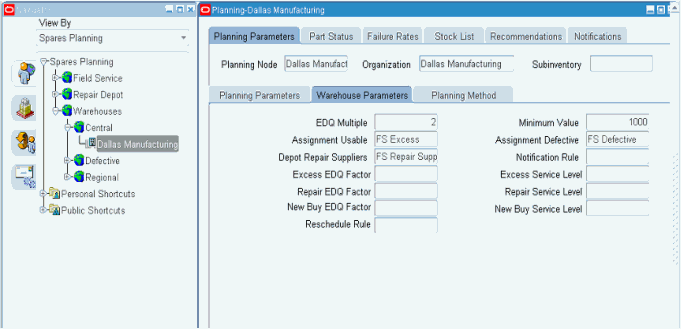

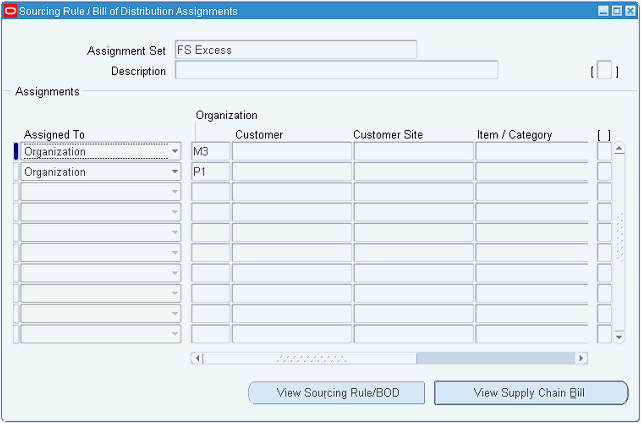

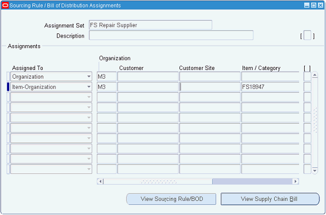

| 9. Set Up Warehouse Replenishment Planning Define and assign excess and defective warehouses and internal repair suppliers. Define warehouse planning parameters, set up reschedule rules, specify plan methods, and set up lead times. |

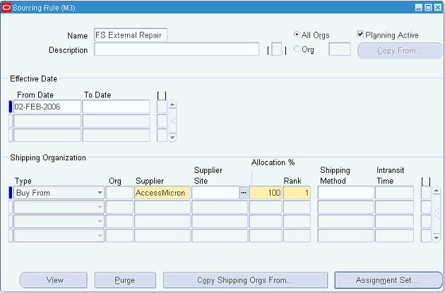

| 10. Set Up External Repair Execution. Define and assign external repair suppliers. Set up Repair Parameters and Profile Options. |

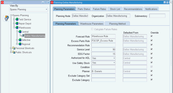

You assign the forecast rule to a warehouse (organization) or a technician (sub inventory) in the Planning Tree of the Planner's Desktop.
To select a Forecast Rule:
Steps
Navigate to the Planner's Desktop.
The Planner's Desktop appears displaying the Planning Parameters tab, and Planning Parameters sub tab.
From the Tree in the Planner's Desktop, select a warehouse, technician, or node.
Note: The warehouse can either be the warehouse being planned or the defective warehouse.
Note: If you select a node other than an organization (warehouse) or sub inventory (technician), then the Forecast Rule (or other parameters) default to lower level nodes underneath the node where the Forecast Rule was selected.
In the Forecast Rule field of the Planning Parameters sub tab, select a Forecast Rule from the list of values.
Save your work.

Excess rules are used to filter out excess parts that do not have a significant impact on excess value. This enables the field technician or warehouse planner to focus excess recovery on the few items that have a high value impact.
If you do not use excess rules, available quantities that are greater than the maximum level in the Authorized Stock List (ASL) are considered to be excess and would then appear in the Excess List window for return.
You assign excess rules to either the technician or the warehouse in the Planner’s Desktop.

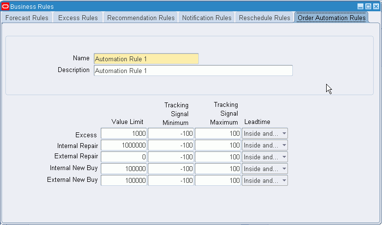

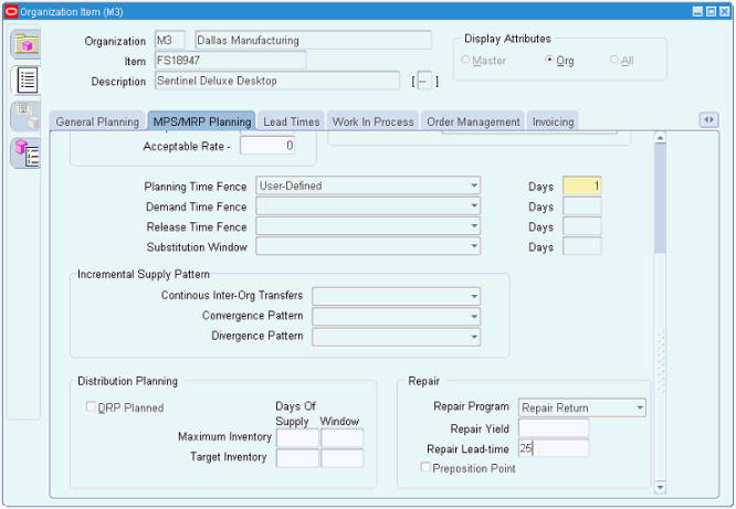

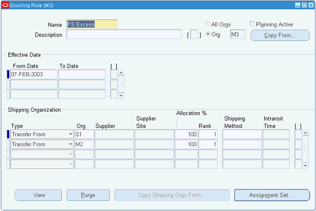

Warehouse notifications are used for warehouse replenishment. The functionality which includes visibility to excess inventories and defectives for repair is found in the Notifications tab of the Planner’s Desktop.
Automating warehouse notifications is beneficial when planners have a large number of warehouse notifications to execute and when the cycles need to be processed frequently to insure timely replenishment. These rules are set up to automate notifications that have a low notification value combined with a good forecast reliability. You can create automation rules for these new-buy notification types:
Internal Order: This represents transfer orders between warehouses.
WIP Order: This is used when manufacturing is required.
Requisition: This is used when purchasing is required.
In each of the above cases, you can enter Excess Value, Repair Value, Notification Value, and Min-Max Values for Tracking Signals.

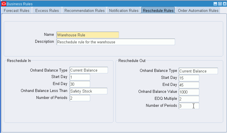

The Reschedule In Rule defines gaps in the schedule where parts are on-order but the projected on-hand balance is tracking too low ahead of the scheduled delivery. The current order may need to be repositioned earlier in the schedule to eliminate gaps or situations where the projected on-hand balance is potentially putting service at risk.
Reschedule Out defines schedule segments where parts are on-order and are due to arrive well before they are needed causing the projected on-hand balance to track too high. The current order may need to be repositioned later in the schedule to avoid an inventory level that is higher than needed.
An exception condition exists when the projected balance is out of the range defined by the reschedule rules. Reschedule Rules are used in Warehouse Replenishment Planning (WRP) to capture reschedule recommendations for the planner.
Use this procedure to set up Reschedule Rules:
Steps
Navigate to the Reschedule Rules window.
The Business Rules window opens to the Forecast Rules tab.
Select the Reschedule Rules tab.
Enter the Reschedule Rule Name, and optionally, a Description.
In the Reschedule In region, select the On Hand Balance Type for the Reschedule In Rule to monitor.
The Current Balance option projects the on-hand balance period by period using Requirements, Current On-hand, and Current On-order. The Planned Balance option includes Planned Orders and the Repairable Returns forecast.
Normally, the rescheduling would be based on the Current Balance.
Enter the Start Day and End Day to define the period applicable for the Reschedule In Rule to monitor.
Select the On Hand Balance Less Than condition for Reschedule In.
Enter the Number of Periods. This specifies the number of occurrences that the Projected On Hand Balance falls below the On Hand Balance condition (within the range of days defined by the Start Day and the End Day) to qualify for Reschedule In.
For example, if the On Hand Balance Less Than condition is Safety Stock, the Start Day is 1, the End Day is 30, and the Number of Periods value is set to 2. If the On Hand Balance falls below the Safety Stock on two or more occasions during the next thirty days, then the Reschedule In rule creates a recommendation.
In the Reschedule Out region, select the On Hand Balance Type for the Reschedule Out Rule to monitor.
Enter the Start Day and End Day to define the range of days for the Reschedule Out Rule to monitor.
Select the On Hand Balance Value for the Reschedule Out exception condition.
The On-hand Balance Value defines the value that the projected balance must exceed the upper limit by to qualify as a Reschedule-Out.
Enter the EDQ (Economic Delivery Quantity) Multiple used to define the reschedule upper limit.
The EDQ Multiple along with the Reorder Point (ROP) is used to define the Upper Limit. The Upper Limit is equal to the ROP plus the EDQ Multiple times the EDQ.
Enter the Number of Periods. This specifies the number of periods the On Hand Balance must track above the On Hand Balance value parameter (within the range of days defined by the Start Day and the End Day) to qualify for Reschedule Out.
For example, the On Hand Balance value is 1000, the Start Day is 15, the End Day is 45, and the Number of Periods value is set to 3. If the On Hand Balance exceeds the Upper Limit by 1000 USD on at least three consecutive periods during the thirty-day period that starts 15 days from now, then the Reschedule Out rule creates an exception message.
Save your work.
Note: The Reschedule Rules are assigned to the warehouse being planned in the Warehouse Parameters tab.

To Create A Sourcing Rule
Navigate to the Sourcing Rule window.
The Sourcing Rule window appears.
Note: You would create the Sourcing Rule for the organization representing the warehouse that is being planned.
Enter a Sourcing Rule name.
(Optional) Enter a Description.
In the Shipping Organization region enter Transfer From as the Type. Enter the organization representing the excess warehouse where excess inventory will be utilized in the Org field.
See Defining Sourcing Rules, in the Oracle Purchasing User's Guide
Save your work.
In this example organizations S1 and M2 have been defined in the Sourcing Rule as excess warehouses that will be used in the replenishment planning for another warehouse.
To Create an Assignment Set and Assign the Sourcing Rule to the Primary Warehouse Being Planned
Navigate to the Sourcing Rule / Bill of Distribution Assignments window.
The Sourcing Rule / Bill of Distribution Assignments window appears.
The Assignment Set is the link between the Sourcing Rule that defines the excess warehouses and the warehouse being planned.
Enter the Assignment Set name and Description.
Enter Organization in the Assigned To field from the list of values.
Enter the organization (warehouse being planned) in the Organization field.
Enter Sourcing Rule in the Type field and the name of the Sourcing Rule in the Sourcing Rule/BOD field.
See Assigning Sourcing Rules and Bills of Distribution, Oracle Purchasing User's Guide.
The Planner's Desktop window appears displaying the Planning Parameters tab, and Planning Parameters sub tab.
In the Spares Planning tree of the Planner's Desktop select the warehouse being planned.
Select the Warehouse Parameters sub tab within the Planning Parameters tab of the Planning window.
The Warehouse Parameters sub tab appears.
Enter the Assignment Set for the excess warehouses in the Assignment Usable field of the Warehouse Parameters tab.
Save your work.
In this example through the use of Sourcing Rules and Assignment Sets two organizations, S1 and M2, have been designated as warehouses where excess will be utilized in the planning and replenishment of organization Dallas Manufacturing.
In WRP this enables the excess warehouses defined in the Sourcing Rule to be incorporated into the warehouse planning.
In the Notifications tab of the Planner’s Desktop this also enables excess inventories from the excess warehouses defined in the Sourcing Rule to be visible in the warehouse replenishment notification.
The Assignment Set is the link between the Sourcing Rule that defines the defective warehouses and the warehouse being planned.
Enter the Sourcing Rule name in the Assignment Set field.
In the Spares Planning tree of the Planner's Desktop, select the warehouse being planned.
Enter the Assignment Set for the defective warehouses in the Assignment Defective field of the Warehouse Parameters tab.
Save your work.
In this example through the use of Sourcing Rules and Assignment Sets two organizations, DWH and M6, have been designated as warehouses where defective parts will be utilized in the planning and replenishment of organization M3.
In WRP this enables the defective warehouses defined in the Sourcing Rule to be incorporated into the warehouse planning.
In the Notifications tab of the Planner’s Desktop this also enables excess inventories from the defective warehouses defined in the Sourcing Rule to be visible in the warehouse replenishment notification.
Repair Suppliers in the field service supply chain can be both internal and external. For internal repair suppliers that are using Oracle Depot Repair there is integration with WRP and the Notifications tab in the Planner's Desktop. That integration consists of automated execution that creates two internal orders: one into the repair depot, and one out of the depot to the warehouse being planned, and the Repair Order in Depot Repair. You define the internal repair suppliers using Sourcing Rules and then link them to the warehouse being planned in Assignment Sets.
This section covers creating the Sourcing Rule and Assignment Set and linking the Assignment Set to the warehouse being planned.
Use this procedure to set up internal depot repair suppliers:
Prerequisites
To Create a Sourcing Rule
Note: You would create the Sourcing Rule for the organization representing the warehouse being planned.
Enter a Sourcing Rule Name.
In the Shipping Organization region enter Transfer From as the Type. Enter the organization representing the internal repair depot where defective inventory will be repaired and used as replenishment in the Org field.
In this example organization M1 has been defined in the Sourcing Rule as an internal repair supplier that will be used in the replenishment planning for the warehouse M3.
The Assignment Set is the link between the Sourcing Rule that defines the internal repair suppliers and the warehouse being planned.
Note: You can use the same Assignment Set for other Sourcing rules that define sourcing for external repair. For information on external repair, see Setting Up External Repair Execution.
In this example the Sourcing Rule has been assigned to the organization M3 and also specifically to the item FS18947 at M3.
In the Planner's Desktop, select the warehouse being planned in the Planning Tree.
Click the Warehouse Parameters sub tab within the Planning Parameters tab of the Planning window.
Enter the Assignment Set for the repair sourcing in the Depot Repair Suppliers field of the Warehouse Parameters tab.
Save your work.
In this example organization M1 has been defined in the Sourcing Rule as an internal repair supplier that will be used to repair defective parts in the replenishment planning for the warehouse M3.
In WRP this enables the Repair Suppliers defined in the Sourcing Rule to be incorporated into the warehouse planning.
In the Notifications tab of the Planner’s Desktop this also enables execution automation for internal repair suppliers.
Planned Order Release Automation business rules are used by Warehouse Replenishment Planning in Spares Management to automate the creation of actual orders from planned orders without user intervention.
Warehouses in the Field Service supply chain are in a constant need of replenishment. Large numbers of planned orders from the planning system are often required in the replenishment process. Planned Order Release Automation business rules enable planners to automate the more routine planned orders giving them more time to focus on the exceptions.
The Create Warehouse Replenishment Data concurrent program uses the Order Automation business rules defined for each supply type to create the actual orders from the planned orders.
The Order Automation business rules should be used to automate the lower value planned orders that have a good forecast. The business rule parameters are based on planned order value and the tracking signal that measures forecast error.
To understand more details of the automation process, see Overview: Planned Order Release Automation, Oracle Spares Management User Guide
For each Order Automation business rule, parameters for each supply type (excess, repair, and new-buy) can be defined. All applicable parameters must be met for the planned order to be automated. For example, if the value limit was met but the tracking signal or lead time parameter was not met, then the planned order will not be automated by the system.
This table describes the different parameters:
| Parameter | Description |
| Value Limits | Dollar value of a planned order. If the actual value of the planned order is less than the Value Limit, then the planned order will be a candidate for automation based on that parameter. Define this parameter by internal and external for each supply type. (Actual value = Planned Order Quantity x Cost) Parts with zero cost will be excluded from automation. |
| Tracking Signal | Measure of forecast error for the part being planned. If the actual tracking signal fell within the minimum and maximum parameters, then the planned order would be a candidate for automation based on that parameter. Define this parameter by internal and external for each supply type. |
| Lead Time | The Need date of a planned order falls inside of the lead time or outside of the lead time. Using the lead time parameter, the planner could select for automation only those orders inside of lead time or outside of lead time or both. Define this parameter by internal and external for each supply type. |
To Set Up Order Automation Business Rules
Use this procedure to set up Order Automation business rules:
Navigate to the Order Automation Rules window.
The Business Rules window appears displaying the Forecast Rules tab.
Select the Order Automation Rules tab.
The Business Rules window appears displaying the Order Automation Rules tab.
Enter a rule name in the Name field.
(Optional) Enter a description in the Description field.
(Optional) Enter the Internal and External Value Limit for the Repair and New-Buy supply types, and the Value Limit for the Excess supply type.
Excess External Value Limit is not applicable.
The Value Limit must be a whole positive number and can be up to 12 characters long.
(Optional) Enter the Minimum and Maximum Tracking Signal values for the Excess, Repair, and New-Buy supply types.
The Minimum Tracking Signal value must be a negative number and can be up to 8 characters long.
The Maximum Tracking Signal value must be a positive number and can be up to 8 characters long.
(Optional) Select the lead time parameter for the Excess, Repair, and New-Buy supply types. Values are Inside, Outside, or Inside and Outside.
Save your work.
In the Spares Planning tree select the warehouse being planned.
Select the order automation business rule in the Order Automation Rule field.
Save your work.

To set up the Reschedule Rule, see Setting Up Reschedule Rules.
The Planner's Desktop window appears.
From the Spares Planning Tree, select the warehouse organization.
The adjacent Planning Parameters and Warehouse Parameters windows provide details of the planning tree node (warehouse) that you selected.
Select the Warehouse Parameters sub tab.
The Warehouse Parameters tab displays fields for the EDQ Multiple and Minimum Value for excess on order. Also included are Service Level, and EDQ Factor by Supply Type.
EDQ Multiple: This value is used to define the Excess Limit in the excess on-order recommendation in WRP and the Notifications Tab in the Planner's Desktop. The Excess On-Order Limit is equal to the Reorder Point (ROP) plus the EDQ Multiple times the EDQ.
Minimum Value: Excess on-order recommendations are created when on-hand plus on-order quantities exceed the excess on-order limit, and the value of the excess on-order is in excess of the Minimum Value which is expressed in the currency value.
The Minimum Value is used in WRP and the Notifications tab of the Planner’s Desktop.
Service Level by Supply Type: Expressed as a percentage, the service level is used along with the EDQ to calculate the safety stock quantity. The service level defines on a planned basis the desired percent of demand filled when needed.
Service Level by supply type is only used in WRP.
EDQ Factor by Supply Type: This factor is used in calculating the EDQ. The EDQ Factor combines both ordering costs and carrying costs in the EDQ calculation to determine the delivery quantity.
EDQ Factor by supply type is only used in WRP.
EDQ varies directly with the EDQ Factor. Increasing the EDQ Factor produces a larger calculated EDQ and vice versa.
To change any of these values, enter a different number in the appropriate field for the supply type.
Save your work.
Service Level, Economic Delivery Quantity (EDQ) Factor, Forecast Method, and Forecast Rules are required to create Min-Max level recommendations for the technician or warehouse in the Planner’s Desktop. A recommendation rule is optional, but can be used to identify and automate the more routine Min-Max recommendations.
Use this procedure to specify planning parameters for a warehouse or technician:
Steps
Select a technician (sub-inventory) or warehouse (organization) from the Spares Planning Tree and select the Planning Method sub tab.
Select a Planning Method.
Personal Usage: For a technician, this is the activity history based on the Forecast Rule for the sub-inventory assigned to the technician. For a warehouse, this is the activity history based on the Forecast Rule rolled up from the technicians sourced to the warehouse and the activity at the warehouse. The activity history and Forecast Rule will be used to create a forecast that is used to create the Min-Max levels.
Territory Norm: Used for a new or transferred technician. The activity forecast is based on a consolidation of the activity for all technicians tiering into a node in the Planning Tree. Territory Norm is not used to plan warehouses.
Product Norm: Based on product populations and failure rates defined in the Failure Rates tab. Product Norm is used for new product introductions or to plan for a product population change.
Personal Usage and Product Norm: A combination method with weighting factors to determine the blend from each method.
Personal Usage and Territory Norm: A combination method with weighting factors to determine the blend from each method.
Select the Planning Parameters sub tab and enter Forecast Rule, Recommendation Rule, Service Level, and EDQ Factor.
See Setting Up Other Warehouse Planning Parameters for an understanding of Service Level and EDQ.
See Defining Forecast Rules for a better understanding of forecasting.
Save your work.

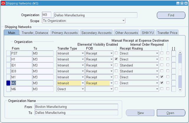

Lead Time is the period of time between recognizing that an order needs to be created and receiving the order at the warehouse being replenished. Warehouse Replenishment Planning (WRP) uses different lead times to plan each of the three supply types: Excess, Repair, and New-Buy.
You define lead times for the Excess supply type using the Intransit Time column for the Shipment Methods listed in the Inter-Org Shipping Network window.
Navigate to the Shipping Networks window.
The Shipping Network is defined by the organization representing the Excess Warehouse as the Ship From and the organization representing the warehouse being planned as the Ship To.
Select a row for an Organization from-to combination.
Navigate to the Inter-Org Shipping Networks window.
The Inter-Org Shipping Networks window appears.
Enter the Intransit Time (lead time) expressed in days for the Shipping Method.
Note: Make sure one of the Shipping Methods is designated as the default. WRP uses the lead time from the default Shipping Method to define the lead time for Excess planning.
In this example the lead time from the excess warehouse or M2 to the warehouse being replenished or M3 is 14 days.

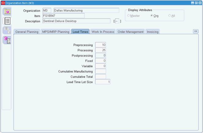

You define the lead times for the New-Buy supply type for the item and organization in the Lead Times tab of the Organization Item window.
The new-buy lead time, expressed in days, is equal to the sum of pre-processing, processing, and post-processing or 35 days in the example shown above.

Repair suppliers in the field service supply chain can be both internal and external. External Repair Execution (ERE) is integrated into Warehouse Replenishment Planning (WRP) and provides automated functionality to execute repair at an external repair supplier and replenish the field service warehouse with repaired parts based on need.
You define the specific external repair suppliers using Sourcing Rules and then link them to the warehouse being planned in WRP in Assignment Sets.
This section covers creating the Sourcing Rule and Assignment Set and linking the Assignment Set to the warehouse being planned in WRP.
In External Repair Execution each repair supplier needs to be modeled as an inventory organization in Inventory and a Supplier in Purchasing. The supplier is assigned to the organization in Oracle Inventory.
To set up inventory organizations and assign the supplier to the organization, see the Inventory Structure chapter in the Oracle Inventory User's Guide.
To set up suppliers in purchasing, see the Supply Base Management chapter in the Oracle Purchasing User's Guide.
Create a Sourcing Rule for organizations where external repair suppliers will be used for the replenishment of the warehouse being planned.
Navigate to the Sourcing Rule window for the organization used for the warehouse being planned by WRP.
See Defining Sourcing Rules, Oracle Purchasing User's Guide.
Note: Use the same Assignment Set used for Sourcing Rules that define sourcing for internal repair.
See Defining and Assigning Internal Repair Suppliers.

External Repair Execution (ERE) utilizes both shipping networks and shipping methods.
ERE requires that a shipping network be defined for the defective warehouse to the repair supplier. This shipping network is a prerequisite to processing an internal order between the two organizations.
Another shipping network is required between the repair supplier and the field service warehouse being replenished in WRP. This shipping network along with the method of shipment is used to create the in-transit lead time from the repair supplier to the warehouse.
Navigation: Inventory > Setup > Organizations > Shipping Networks
See Defining Inter-Organization Shipping Networks, Oracle Inventory User's Guide.

Repair parameters for a particular item appear on the MPS/MRP Planning tab of the Inventory Organization Item window. The parameters define the repair program name, the repair yield percentage, the repair lead time in days, and indicate whether an inventory of defective parts is pre-positioned at the repair supplier to reduce in-transit time.
See Setting Up Repair Parameters.

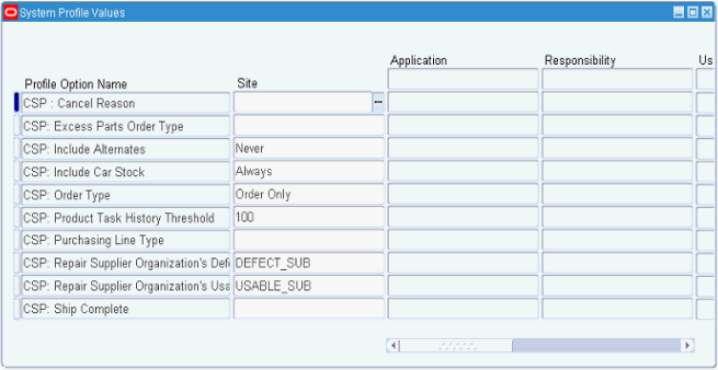

The values set in the CSP: Repair Supplier Organization's Defective Subinventory profile option and the CSP: Repair Supplier Organization's Usable Subinventory profile option define the names used for those subinventories.
See Setting Profile Options for External Repair Execution.
See also the Profile Options Appendix in the Oracle Field Service Implementation Guide.
Use this procedure to set up repair parameters for the inventory item:
Prerequisites
Steps
Navigate to the Organization Item window.
The Organizations window appears.
In the Organizations window, select the repair supplier organization. Click OK.
The Find Organization Items <Org> window appears.
Select the item in the Find Organization Items window.
The Organization Item <Org> window appears.
Select the MPS/MRP Planning tab.
The MPS/MRP Planning tab appears. Scroll down to the Repair region.
In the Repair region:
Select the Repair Program from the list of values.
The repair program will appear on the repair purchase requisition. The repair program will determine the process used to execute the repair activity at the repair supplier.
For example: Repair and Return, Exchange, or Advance Exchange.
Enter the Repair Yield. This is the average percentage of defectives sent to the repair supplier that can actually be repaired.
Specify the Repair Lead Time, in days.
This lead time represents the internal processing time at the repair supplier. This lead time, along with the in-transit time to the repair supplier and the in-transit time from the repair supplier determines the total repair lead time for planning purposes. Repair lead time is used to determine the release date for the planned repair order.
For information on setting up repair lead times, see Setting Up Lead Times for Warehouse Replenishment Planning.
Optionally, select the Preposition Point check box to indicate whether the defective parts will be pre-positioned in inventory at the repair supplier.
Save your work.

Use this procedure to set up site profile options for External Repair Execution:
Steps
Navigate to the System Profile Values window.
The Find System Profile Values window appears.
In the Profile field enter CSP:%. Click Find.
The System Profile Values window appears displaying the CSP: profile options in alphabetical order.
Scroll to the CSP: Repair Supplier Organization's Defective Subinventory profile option. In the Site column, enter the name for the defective sub-inventory at the repair supplier organization.
At the CSP: Repair Supplier Organization's Usable Subinventory profile option, in the Site column, enter the name for the usable sub-inventory.
Save your work.
