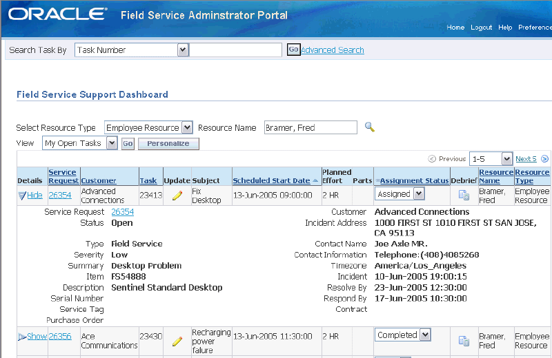

The Field Service Support Dashboard is the entry point for administrators or managers to perform multiple functions on behalf of their reporting field technicians. The Field Service Support Dashboard is similar to the Field Service Technician Dashboard. Both of the dashboards function and operate basically the same except with the Field Service Support Dashboard you can query on task-related information for a specific resource. For information on the Field Service Technician Dashboard, see Explaining the Elements of the Field Service Technician Dashboard.
The Field Service Support Dashboard consists of:
Simple Search (based on service request number, task number, and customer), Advanced Search, and Resource Search fields

In the Main View, managers and administrators can select from the list of seeded views, and can create additional personalized views to display selected columns of information in the desired sequence.
The Details column displays for every seeded and personalized view. After task-related information is retrieved for a specific resource, click the Show link or "+" icon to:
View the details of the service request associated with a task.
View the details of a repair order associated with a task, when the task is from a repair order.
An Update icon appears in each row. Clicking the Update icon opens the Update Task page to the Details tab, where the manager can:
Update task details.

Use this procedure to load information about a specific technicians schedule into the Field Service Administrator Portal (Field Service Support Dashboard).
Steps
Navigate to the Field Service Support Dashboard.
The Field Service Support Dashboard appears displaying the default view of task-related information.
To search for specific task-related information, begin by selecting either Employee Resource or Supplier Contact from the Resource Type list of values. Technicians are usually employee resources of the service organization.
Next, provide partial or complete values in the Resource Name field.
Enter the technicians name in the Resource Name field, or
Enter part of the technicians name into the Resource Name field, and then click the Tab key.
The Search and Select: Resource Name page appears displaying names that contain the entered search string. For example, type 'bram' in the Resource Name field, and then press the Tab key. Resource Names: George Abrams, Fred Bramer, and BalasuBramani Jones are retrieved. Click the Quick Select icon in the row for the Resource Name that you want to have return to the Field Service Support Dashboard, or
If you do not have any partial information for the Resource Name, leave the Resource Name field blank, and then click the Search for Resource Name icon.
The Search and Select: Resource Name page appears. Click Go. All resource names of the selected resource type are listed. Click the Quick Select icon in the row for the resource name that you want to have return to the Field Service Support Dashboard.
To filter the tasks that display, select a view from the View list of values, and then click Go.
The Dashboard appears with tasks assigned to the selected resource, and that also match the View filter.
Note: To create a personalized View, click Personalize. See Personalizing the View Display.
Tip: When selecting columns to display in a personalized view, keep in mind that many details are available by displaying the Details column (Hide/Show).. Therefore you can decrease screen clutter by selecting only the frequently needed information for the personalized view, and then view details as needed.
To view details for a task, in the row for a task, click the Show/Hide link in the Details column.
Details for the task appear below the selected row.

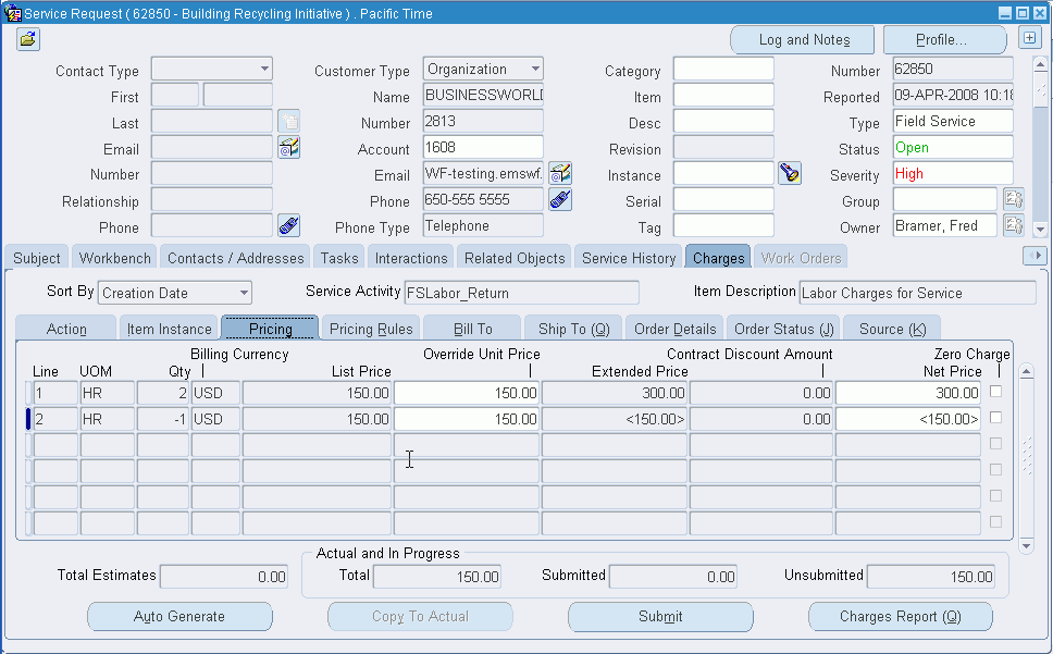

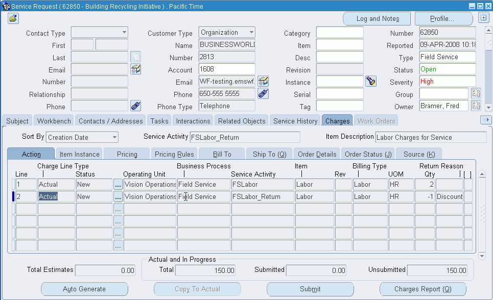

Correcting Labor Debrief Lines
This functionality will override the profile option CSF: Allow Overlapping Labor Lines in Debrief.
Expand the Labor section.
Click Add Another Row.
Select a Business Process and a Service Activity code that has been defined with a line category of return.
Enter the labor correction line in the same format as the original labor line was entered.
Enter one of the following:
Correct Start Time and End Time.
The Service Date and Duration are populated by the system.
Correct Start Time, End Time, and Item.
Correct Item and Duration.
The Service Date is populated by the system.
Enter the Return Reason Code.
Click Apply.
The labor line is saved.
Example of Labor Correction Line

Select the Charges tab.
Charges information displays for the service request. This screen shot is displaying labor line charges.
Select the Pricing tab and verify the charge lines are correct for the service request.
Labor and expense charge lines are created with negative amounts if any corrections were made to these types of debrief transactions. This screen shot is displaying pricing information for labor lines.
Review and correct charges information as appropriate.
