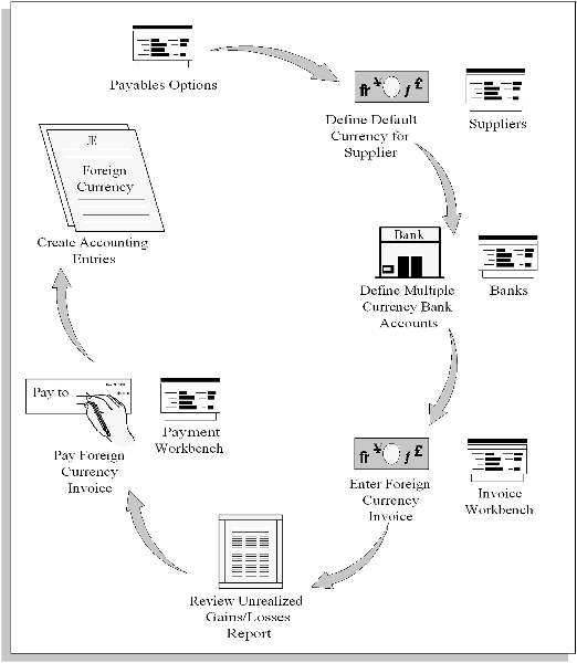

The following diagram shows the general steps you follow to enter and pay a foreign currency invoice.
You can pay invoices in either the same currency you used to enter them, or an associated fixed-rate currency. You can enter or change invoice currency defaults at five subsequent times. During each of these steps you can override the default created by the previous step.
Payables Options, choose default invoice currency
Supplier Entry
Supplier Site Entry
Invoice Batch defaults (optional)
Invoice or Expense Report Entry
The invoice currency is the default for invoice distributions, and this invoice distribution currency default cannot be changed.

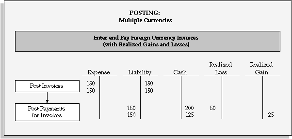

The following diagram shows the accounting entries for the previously described example.
Example
You install General Ledger and Payables and define US dollars as the ledger currency for your ledger. You select Accrual Basis as your accounting method. You account for payments and gain/loss at payment time only.
You enter two invoices, both for 300 pounds (GBP) with a Corporate exchange rate, and validate the invoices. The Corporate exchange rate on the date you enter the invoices is 2:1. When you account for the invoices, Payables creates accounting entries in both the foreign currency (300 GBP) and your ledger currency ($150 US) for both invoices, and Journal Import creates one journal entry in your ledger currency and one in GBP.
When you pay the first invoice, the exchange rate has decreased to 1.5:1, representing a loss in your ledger currency of $50 US (300/1.5 - 150). When you pay the second invoice, the exchange rate has improved to 2.4:1, creating a gain of $25 US. When you account for the payments, Payables creates accounting entries in both the foreign currency and your ledger currency for both payments. The accounting entries for the gains and losses are in your ledger currency only.

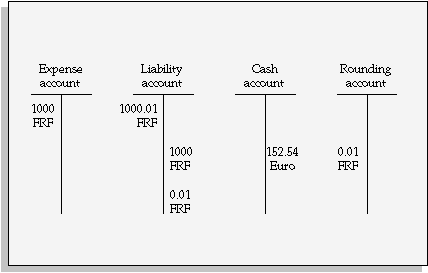

Payables creates journal entries in the transaction currency and your ledger currency for all invoices and payments. Payables continues to record gains and losses in the Gain/Loss Accounts you assign. When you pay invoices in a different currency than the payment currency, Payables uses the Rounding account that you define in the Currencies region of the Payables Options window to record the rounding error.
For example, suppose the french franc were still a valid NCU. Your ledger currency is FRF and you enter an invoice in 1000 FRF and enter EUR as the Payment Currency. The Payment Amount converts to 152.53917 EUR, at the fixed conversion rate of 6.555693, and rounds to 152.54 EUR. The payment, converted back to your ledger currency is 1000.0054, which rounds to 1000.01. The .01 FRF difference is recorded in the Rounding account.
