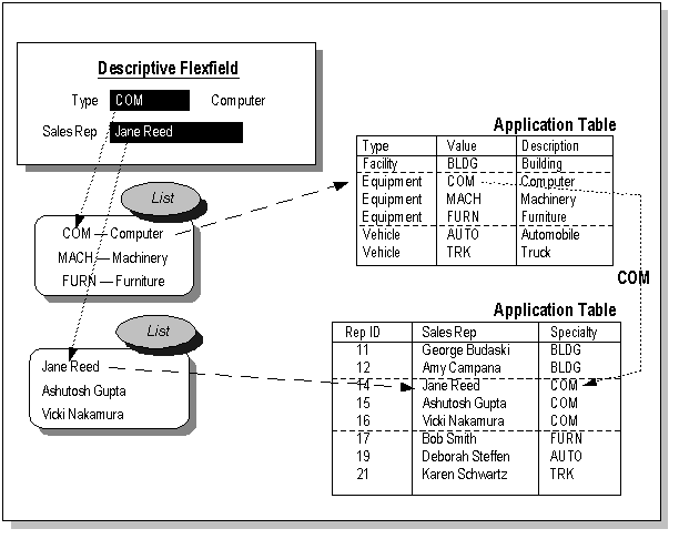

Overview of Implementing Table-Validated Value Sets

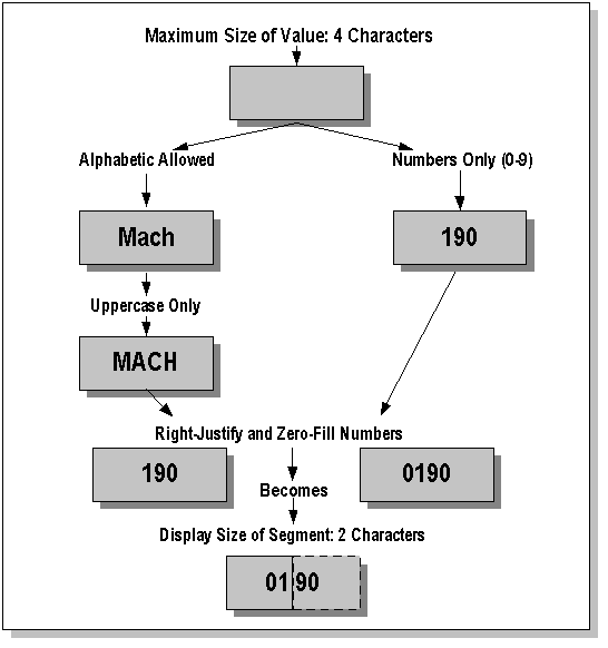

The following diagram shows how some of these formatting options interact.
Formatting Options
You have several other options from which to choose. See: Value Formats.

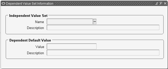

Dependent

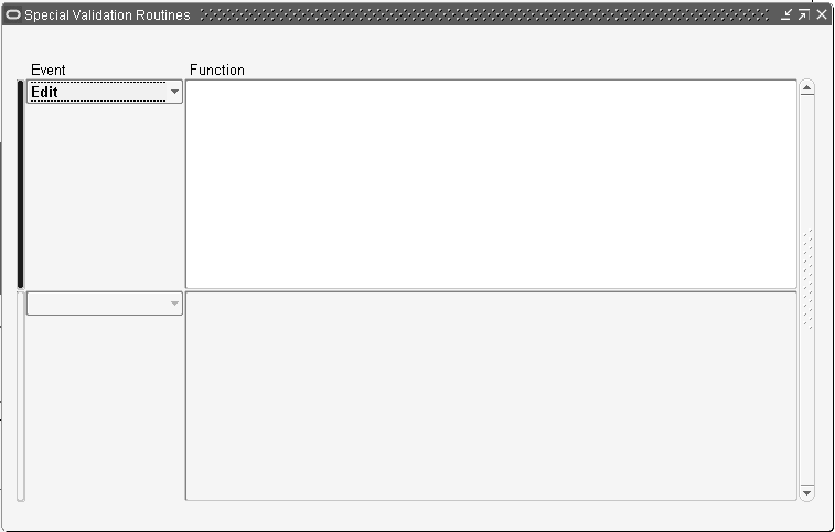

Special
Pair

The following are the available character formatting options:
With the Numbers Only option, you may not enter the characters A-Z, a-z, or special characters such as ! , @, or # , in the segment that uses this value set. You may enter only the values 0-9, minus signs, plus signs, the radix separator (D), and the group separator (G) in any segment or parameter that uses this value set. Note also that your Char format type value set remains Char even without alphabetic characters, and your values will behave and sort as character values.
Important: If you want to restrict users from entering a negative sign for a value set where you do not allow alphabetic characters, you should enter zero (0) as this value set's minimum value. However, you cannot prevent users from entering a value that contains the radix character (D).
If you are defining a value set that uses a validation table, you should set the value in this field to reflect the characteristics of the values in the value column you specify for your validation table.
Note: The Numbers Only option cannot be used in Translatable Independent and Translatable Dependent value sets.
Indicate whether any alphabetic characters you enter as values for a segment using this value set should automatically change to uppercase.
Note: The Uppercase Only option cannot be used in Translatable Independent and Translatable Dependent value sets.
Indicate whether your flexfield should automatically right-justify and zero-fill numbers when you enter values for this value set. This option affects values that include only the characters 0-9, regardless of whether you select the Numbers Only option. This option has no effect on values that contain alphabetic characters or special characters such as a period or a hyphen.
For example, if you have a five-character value set, and you define a value of 7, your flexfield stores and displays your value as 00007. If you define your flexfield segment to have a display size less than the maximum size and you want to Right-justify and Zero-fill Numbers, your flexfield segment may often display only zeroes (your flexfield segment displays only the number of characters specified by the display size). In these cases, your users need to scroll through the flexfield segment to see a meaningful value, thus slowing data entry or inquiries.
Usually you use this option to ensure that character values that appear to be numbers will be sorted and appear in order as if they were actually number values (for cross-validation rules, value security rules, and reporting, for example). You may also use this option to ensure that numeric-looking values all have the same number of characters so they line up nicely in reports.
If you set Right-Justify and Zero-fill Numbers to Yes, you should ensure that the values in this value set use Right-justify and Zero-fill.
Tip: We recommend that you set Right-justify and Zero-fill Numbers to Yes for value sets you use with the Accounting Flexfield and to No for most other value sets.
If you are defining a value set that uses a validation table, you should set the value in this field to reflect the characteristics of the values in your validation table.
If you set the Right-Justify and Zero-Fill Numbers flag to Yes, the values in your value columns should also be right-justified and zero-filled; that is, there should be an exact match in formatting.

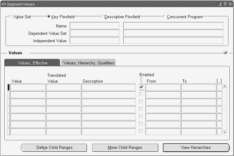

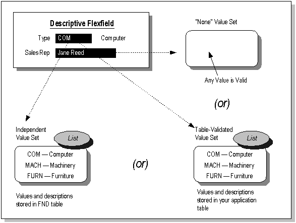

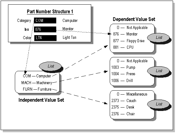

First, you should decide whether your users need a predefined list of values from which to choose, or whether they can enter any value that fits the value set formatting conditions. If you want to provide a list of values, you choose from independent, dependent, translatable independent, translatable dependent, or table value sets. If you do not want a list, use a non-validated (None) value set.
Once you have chosen to provide a list of values for a segment, you choose whether to use independent, dependent, translatable independent, or translatable dependent or table validation. You would only use a dependent set if you want your segment values to depend upon the value chosen in a prior independent segment (a segment that uses an independent value set). You would only use a translatable dependent set if you want your segment values to depend upon the value chosen in a prior translatable independent segment (a segment that uses a translatable independent value set). Whether you use an independent or table set depends on where you intend to get your values. If you already have suitable values in an existing table, you should choose a table set. If you were to use an independent set and you already maintain those values in an application table, you would need to perform double maintenance on your values. For example, if you need to disable an invalid value, you would need to disable it in both the Segment Values window (for your value set) and in your application form that maintains your existing table (for use by your application). If you do not already have a suitable table, you should probably use an independent set and maintain your values using the Segment Values window.
The following table lists each value set type, whether it uses a list of values, and where these values, if any, are stored.
| Value Set Type | List of Values | Values Stored |
| Independent | Yes | FND table |
| Dependent | Yes | FND table |
| Table | Yes | Application Table |
| None | No | No |
| Special/Pair | Depends on value set | Depends on value set |
| Translatable Independent | Yes | FND table |
| Translatable Dependent | Yes | FND table |

Examples of Validation Types
You use a None type value set when you want to allow users to enter any value so long as that value meets the value set formatting rules. That is, the value must not exceed the maximum length you define for your value set, and it must meet any format requirements for that value set. For example, if the value set does not allow alphabetic characters, your user could not enter the value ABC, but could enter the value 456 (for a value set with maximum length of three). The values of the segment using this value set are not otherwise validated, and they do not have descriptions.
Because a None value set is not validated, a segment that uses this value set does not provide a list of values for your users. A segment that uses this value set (that is, a non-validated segment) cannot use flexfield value security rules to restrict the values a user can enter.
An Independent value set provides a predefined list of values for a segment. These values can have an associated description. For example, the value 01 could have a description of "Company 01". The meaning of a value in this value set does not depend on the value of any other segment. Independent values are stored in an Oracle Application Object Library table. You define independent values using an Oracle E-Business Suite window, Segment Values.
A table-validated value set provides a predefined list of values like an independent set, but its values are stored in an application table. You define which table you want to use, along with a WHERE cause to limit the values you want to use for your set. Typically, you use a table-validated set when you have a table whose values are already maintained in an application table (for example, a table of vendor names maintained by a Define Vendors form). Table validation also provides some advanced features such as allowing a segment to depend upon multiple prior segments in the same structure.
A dependent value set is similar to an independent value set, except that the available values in the list and the meaning of a given value depend on which independent value was selected in a prior segment of the flexfield structure. You can think of a dependent value set as a collection of little value sets, with one little set for each independent value in the corresponding independent value set. You must define your independent value set before you define the dependent value set that depends on it. You define dependent values in the Segment Values windows, and your values are stored in an Oracle Application Object Library table. See: Relationship Between Independent and Dependent Values.
Example of a Dependent Value Set
Special and pair value sets provide a mechanism to allow a "flexfield-within-a-flexfield". These value sets are primarily used for Standard Request Submission parameters. You do not generally use these value sets for normal flexfield segments.
Example of special and pair value sets
Special and Pair value sets use special validation routines you define. For example, you can define validation routines to provide another flexfield as a value set for a single segment or to provide a range flexfield as a value set for a pair of segments.

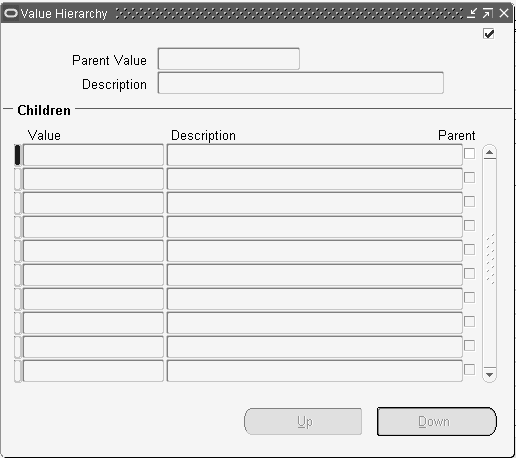

Parent and Child Values and Rollup Groups, Oracle General Ledger User's Guide
Defining Hierarchy and Qualifiers Information

Independent and dependent value sets have a special relationship. While you can have the same dependent values for any of your independent values, the meanings (or descriptions) - as well as any segment qualifier values, enabled/activation information and descriptive flexfield data for that value - of the dependent values depend on which of the independent values you choose in the prior independent segment. For example, you could have value sets with the values (dependent default value of 0) as described in the following table:
| Independent Value Set (Account Segment) Value | Independent Value Set (Account Segment) Description | Dependent Value Set (Sub-Account Segment) Value | Dependent Value Set (Sub-Account Segment) Description |
| 01 | Cash accounts | 0 | Default Value |
| 01 | Cash accounts | 1 | Bank of California |
| 01 | Cash accounts | 2 | Bank of Denver |
| 01 | Cash accounts | 3 | First Federal Bank |
| 02 | Equipment accounts | 0 | Misc equipment |
| 02 | Equipment accounts | 1 | Computers |
| 02 | Equipment accounts | 2 | Printers |
| 02 | Equipment accounts | 3 | Delivery Vehicles |
| 03 | Other asset accounts | 0 | Default value |
You must set up your independent-dependent value sets carefully using the following sequence:
Create your independent value set first
Create your dependent value set, specifying a default value
Define your independent values
Define your dependent values
When you define each of your independent values, Oracle E-Business Suite automatically creates a default dependent value that goes with your independent value. For example, the previous diagram shows a default value of zero (0). If for some reason you create a dependent value set after your independent value set has values, you must manually create a default value in your dependent set for each of your independent values, since each independent value must have a default dependent value. If necessary, create your default dependent values manually using the Segment Values form (you also use this form to create all dependent values other than the default value). You must create at least one dependent value for each independent value, or else your user will be unable to enter segment value combinations in the flexfield. However, we recommend that you carefully follow the above order for creating your value sets so that you never have to create default dependent values manually, since manually creating default dependent values is both tedious and error-prone.

Table-validated value sets let you use your own application tables as value sets for flexfield segments and report parameters instead of the special values tables Oracle E-Business Suite provides. You need not enter each value manually using the Segment Values window. Value sets you base on validation tables can be similar to Independent value sets, where values in your Table type value sets are independent of the values in all other segments. Or, depending on how you define your validation table's WHERE clause, they can depend on one or more previous segments in your flexfield.
In general, you should use a validation table if you want a key or descriptive flexfield segment, or report parameter, to use values that your application already requires or maintains for other application purposes. Using a validation table then lets you avoid maintaining two copies of the same values (one in your application's table and the other in Oracle Application Object Library's tables).
You can use many advanced features with your table-validated value sets. You can use validation tables for flexfield segments or report parameters whose values depend on the value in a prior segment. You use flexfield validation tables with a special WHERE clause (and the $FLEX$ argument) to create value sets where your segments depend on prior segments. You can make your segments depend on more than one segment, creating cascading dependencies. You can also use validation tables with other special arguments to make your segments depend on profile options or field values.
Note: Table-validated value sets with WHERE clauses cannot be used with the Accounting Flexfield.
If you want to make use of key flexfield features such as rollup groups and parent-child relationships, you can store the child values in your validation table, but you should use the Segment Values windows Oracle E-Business Suite provides to add or define the parent values and rollup groups.

Navigate to the Segment Values form to define your values and translated values.
In the Values, Effective tabbed region, the Value column contains the "hidden" untranslated value.
The Translated Value field contains the current translated value. The hidden value defaults in the Translated Value field if no other value is defined. The Translated Value field is enabled for Translatable Independent and Translatable Dependent value sets only.
You can update the translated value for the current session language in the Translated Value field. To update the translated value for a language other than the current session language, use the Translation icon in the Toolbar.

Use the Special Validation Routines window to define special validation for a Special value set. You also use this window to define validation routines for a Pair value set.
Warning: You should never change or delete a predefined value set that Oracle E-Business Suite supplies. Such changes may unpredictably affect the behavior of your application features such as reporting.
You can use this region to define a value set that lets your users enter an entire key flexfield combination within a single report parameter. For example, you may want to pass concatenated Accounting Flexfield segments as a parameter to a report. With this type of value set, a user can enter the report parameter and then see the "normal" behavior of a key flexfield, such as the key flexfield window and segment validation associated with that key flexfield. You use Oracle Application Object Library flexfield routines for these special value sets.
Warning: Special/Pair value sets are user-exit value sets (that is, they can be validated by the C engine only). They cannot be validated by PL/SQL APIs. Concurrent programs using Special/Pair value sets may only be run from Forms-based applications.
You should take special care to avoid a situation where you have a value set that contains a flexfield which in turn contains a flexfield (as a value set of one of its segments). There are two situations where this could cause a problem. The first situation (recursion) is where a flexfield calls itself as one of its segments, leading to an infinite chain of pop-up windows. Such a loop may also be indirect. The second potential problem may lead to data truncation and data corruption problems: since a flexfield is often passed as its concatenated flexfield values, the length of these concatenated flexfields can quickly exceed the maximum size of the value set and the underlying segment column in the flexfield table. This is less likely to cause a problem for key flexfields than for descriptive flexfields or range flexfields, because key flexfields are usually passed as a single code combination ID number instead of as concatenated segment values and therefore take less space. Though the Value Sets windows and the Flexfield Segments windows do not prevent you from defining flexfield loops or multiple flexfields within flexfields, you can cause serious truncation problems and possible data corruption problems in your application by allowing this to occur.
Warning: Plan and define your value sets carefully to avoid value sets within value sets as described above.
See: Special Validation Value Sets for information on using these validation types. This section contains information on the various types of events and flexfield routine arguments and syntax you use with special validation. It also contains a worked example of using special validation for the Accounting Flexfield.

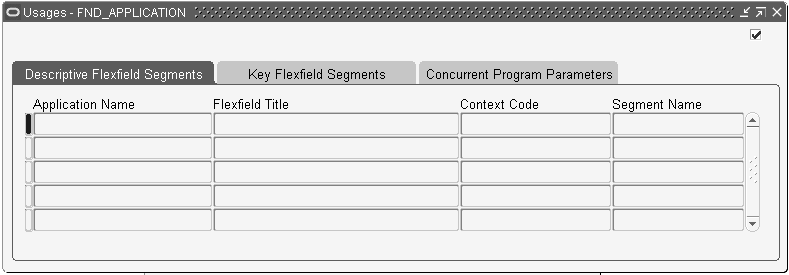

Use the Usages button to view which flexfield segment or concurrent program parameter uses a particular value set.

Ensure the following has been done before you define your dependent value set information.
Define your independent value set. You should not define individual independent values for the corresponding independent value set before defining your dependent value set. See: Defining Value Sets.
Define your dependent value set name and formatting options. See: Defining Value Sets.
Note: This window is also used to enter information for Translatable Dependent value sets. Translatable Dependent value sets must be dependent on Translatable Independent value sets. Translatable Independent value sets can have only Translatable Dependent value sets dependent on them.
Enter the name of an independent value set on which this dependent value set depends.
You can only enter the name of a value set you have already defined. You must save the value set definition of your independent value set before you can select it in this field. An independent value set may have more than one dependent value set depending upon it, but a dependent set cannot depend on another dependent set.
The Segment Values window automatically creates your dependent default values at the time you create your independent values. To ensure that the Segment Values window creates a dependent default value for each of your independent values, you should create the values in your independent value set only after you create all of the dependent value sets that depend on that independent set. If you create a new dependent set for an independent set that already contains values, you must manually enter the dependent default value for each existing independent value using the Segment Values window. See: Segment Values Window.
Tip: First define all of the independent value sets your application needs, then define all of your dependent value sets. Create all of your value sets before you create any of your values.
Enter a default value for your dependent value set.
This value is the default for any segments that use this dependent value set. Usually, you enter zero. You must make sure that the value you enter here fits the value set information you enter. For example, if this dependent value set does not allow alphabetic characters, your default value may not contain any alphabetic characters.
All the values in the independent set must have at least one dependent value. So, whenever a user creates a new value in the independent value set (using the Segment Values form), it must have at least one dependent value. The Segment Values window automatically creates the required dependent value by using the default value you enter here. See: Segment Values Window.
For example, suppose you have an independent value set called "Account" with a dependent value set called "Sub-Account." You may wish to create a new independent value, 99, for "Account" with description "Receivables" without creating any associated sub-account values. Since your flexfield requires a dependent value of some sort to go with the independent value, it uses the default value you enter here, such as 00 with description "No Sub-Account."
Enter a description for your default dependent value. The Segment Values window creates this description with the dependent default value it creates whenever you create a new independent value. For example, suppose you have an independent value set called "Account" with a dependent value set called "Sub-Account." You may wish the "Sub-Account" default value 00 to have the description "No Sub-Account." See: Segment Values Window.

See Special Validation Value Sets for information on using this region. The section contains information on the various types of events and flexfield routine arguments and syntax you use with special validation. It also contains a worked example of using special validation for the Accounting Flexfield.
You can view which flexfield segments or concurrent program parameters use a given value set with the Usages button on the Value Sets window.
To use this feature, you must first have privileges to the relevant flexfield segment or concurrent program parameter form. In particular:
You must have access to the Descriptive Flexfields Segments form to view the descriptive flexfields that use the value set.
You must have access to the Key Flexfields Segments form to view the key flexfields that use the value set.
You must have access to the Concurrent Programs (Developer Mode) or the Concurrent Programs (System Administrator Mode) form to view the concurrent program parameters that use the value set.
If you do not have access to any of the above forms, the Usages button is disabled.
Use this window to define valid values for a key or descriptive flexfield segment or report parameter. You must define at least one valid value for each validated segment before you can use a flexfield. These validated segments provide users with a list of predefined valid segment values, and have a validation type of Independent, Dependent, Translatable Independent, Translatable Dependent, or Table.
You should use this window to define values that belong to Independent, Dependent, Translatable Independent, Translatable Dependent, or Table value sets. You can define new segment values, specify value descriptions for your values and to enable or disable existing values as well.
The values you define for a given flexfield segment automatically become valid values for any other flexfield segment that uses the same value set. Many Oracle E-Business Suite reports use predefined value sets that you may also use with your flexfield segments. If your flexfield segment uses a value set associated with a Standard Request Submission report parameter, creating or modifying values also affects that parameter. If you use the same value set for parameter values, the values you define here also become valid values for your report parameter.
You also specify segment value qualifiers, rollup groups, and child value ranges.
You can also view and maintain segment value hierarchies for the Accounting Flexfield or for any custom application flexfields that use the value hierarchies feature.

For most flexfield segments and report parameters, defining values is very simple if they use independent value sets and their value sets are not used with the Accounting Flexfield.
To define segment values:
Navigate to the Segment Values window.
Query the value set to which your values (will) belong. You can locate values either by their value set or by the flexfield segment or concurrent program parameter that uses their value set for validation.
Enter a segment value that is valid for your application. A valid value can be a word, phrase, abbreviation, or numeric code. Users can enter this value in a flexfield segment or a report parameter that uses this value set. Users also see this value whenever they select a value in a flexfield segment that uses this value set.
Any value you define must conform to the criteria you defined for your value set. For example, if your value set can only accept values one character long with no alphabetic or special characters allowed, you can only enter the values 0 through 9 in this field.
If you enter a value that contains the segment separator character defined for the flexfield that uses this value set, application windows display the character in your value as a ^ (or another non-alphanumeric character, depending on your platform) in your concatenated value fields to differentiate it from the segment separator. This change is for concatenated display purposes only and does not affect your value.
Since individual values can be referenced from many places in your applications, you cannot delete valid values that have already been defined, nor can you change those values. You can, however, change the description of a valid value in the Description field after you query up the value (or the translated value of a Translatable Independent or Translatable Dependent value set).
You cannot define values that would violate any flexfield security rules that are enabled for your responsibility.
If your value set is a Translatable Independent or Translatable Dependent value set, this value is "hidden" from the user in the flexfield windows.
If your value set has the type Translatable Independent or Translatable Dependent, the Translated Value field is enabled. The value from the previous step defaults in. You can update the Translated Value for all installed languages using the Translation icon in the Toolbar.
Validation is done for the translated values as well as the hidden values. For example, if you have defined your value set to have a maximum size of 50 characters, no translated value may be larger than 50 characters.
Enter a description for your value. Users see this description along with your value whenever they select a value in a flexfield segment that uses this value set.
Check the Enabled check box to make your value effective.
If you want to have the value effective for a limited time, you can enter a start date and/or an end date for it. The value is valid for the time including the From and To dates.
You cannot delete values from this window because they are referenced elsewhere in the system, but you can disable them at any time. You should not disable or have effective dates for a segment value that you use as a segment default or a default dependent value.
If you are defining values whose value set will be used with the Accounting Flexfield, define hierarchy and qualifiers information. See: Defining Hierarchy and Qualifiers Information.
Save your changes.

The Hierarchy Details buttons open the windows you use to define and maintain detailed information about your value hierarchies.
You use the Hierarchy Details zone and the following zones primarily for values you use in segments of the Accounting Flexfield.
| Variable | Description |
| Define Child Ranges | Choose this button to define child ranges for your parent value. The button is disabled unless your value is already a parent value. |
| Move Child Ranges | Choose this button to move child ranges from one parent value to another parent value. The button is disabled unless your value is already a parent value. |
| View Hierarchies | Choose this button to view the hierarchy structure to which your selected value belongs. You cannot make changes in this window. The button is disabled unless your value belongs to a hierarchy structure (it is either a parent value or a child value of another parent value). |

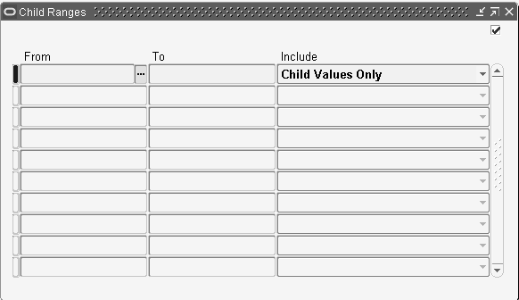

Use this window to define child values for the value you defined in the Segment Values zone. Oracle E-Business Suite use child values to sum families of data or report on groups of data. You specify child values by entering a set of ranges. If you want to specify a single child value, set the low and high ends of the range equal to that value.
You cannot open this window if the value belongs to a rollup group and rollup groups are frozen. You freeze rollup groups using the Key Flexfield Segments window.

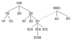

You can create networked hierarchies; that is, you can create hierarchy structures where a particular value may be a child that belongs to more than one parent. You should plan your value hierarchy structures carefully to avoid unwanted duplication of information caused by reporting or counting the same value more than once.
For example, suppose you want to define a hierarchy structure as shown in the following diagram.
In this structure the parent value 1000 has child values of 100, 200, and 300; and the value 300 is a parent to child values 301, 302, and 303. For the parent value 300, you could specify the child value range 301 (Low) to 303 (High). Since all three values 301, 302 and 303 are not parent values, you give this range a range type of Child.
For the parent value 1000, you need to specify two ranges so that you include both non-parent values (100 and 200) and parent values (300). First, you specify the child value range 100 (Low) to 200 (High) and give this range a range type of Child to include the values 100 and 200 as well as all the values between them (alternatively, you could specify these two values individually by specifying the same value for both Low and High). Then, to include the parent value 300, you specify the child value range 300 (Low) to 300 (High) and give this range a range type of Parent.
Enter the low and high ends of your child value range. You can enter any value that meets the validation criteria you define for this value set using the Define Value Set window. The high end of your child value range must be greater than or equal to the low end. Your ranges behave differently depending on your value set format type. For example, in a value set with a Character format type, 100 is less than 99 (even though they appear to be numbers). Similarly, a range that includes values from 100 to 200 would also include the value 1000.
Important: The Accounting Flexfield uses value sets that have a format type of Character, so you should specify your child ranges carefully for those value sets. For example, 100 is less than 99 (even though they appear to be numbers).
To specify a range that contains only a single value, enter the same value for both Low and High.
If you select Child, any child values that fall in your specified range are considered to be children of your parent value. If you select Parent, any parent values that fall in your specified range are considered to be children of your parent value. Specifying Parent lets you create tree-structured hierarchies.
If you have existing child ranges from a previous version of Oracle E-Business Suite, those ranges automatically receive a range type of Child and they behave exactly as they did with your previous version.

Choose Up to view the values at the level just above your current value. If this value is a parent value, you can choose Down to view the child values that belong to the current value. If this value has more than one parent, you see a list of the parent values to which you can navigate. If you choose Up after navigating down a networked hierarchy, you move up to the parent you navigated down from most recently.
If you move up or down in the hierarchy structure, this window automatically changes the parent value displayed in the Parent Value field to show you the parent value in the level immediately above the level of the values you are viewing.
For example, suppose you have a hierarchy structure (in this case a networked structure) as shown in the following diagram:
In this structure, the parent value 1000 has the child values 100, 200, and 300; the value 300 is in turn a parent to the values 301, 302 and 303. The value 303 has child values of 303A, 303B (which is a parent to the value 303BB), and 303C. The value 00003 is a parent value of 303 as well, and also has the child values of 403 and 503. Suppose you want to look at the structure starting with the value 1000 in the Segment Values zone. When you open the View Hierarchies window, you see the parent value 1000 with the values 100, 200, and 300 below it, as shown in the following diagram:
You choose Down with your cursor on 300, as shown above (Down is your only choice for this value). Once you choose Down, you then see (immediately):
You choose Down with your cursor on 303, as shown above (you can choose from Up or Down for this value). Once you choose Down, you then see its child values 303A, 303B, and 303C, as shown in the following diagram:
You choose Down with your cursor on 303B, as shown above (you can choose from Up, Down, or Network for this value). Once you choose Down, you then see the value of 303B listed with its child value of 303BB, as shown in the following diagram:
You choose Up, as shown above (you can only choose Up for this value). Once you choose Up, you then see the value 303 listed as a parent value with its children values of 303A, 303B and 303C as shown in the following diagram:
At this point, your cursor is next to the value 303B and the parent displayed in the Parent Value zone is 303. When you choose up, you can either go back up to your original parent value (303, which has the parent value 300), or you can go over to the other hierarchy path that leads to the parent value 00003. Once you choose 303B, you see a window offering you the two choices 300 and 00003 (these choices indicate the values that would appear in the Parent Value field. You will see 303 in the Children block if you make either choice), and 300 is highlighted. You choose 00003 this time, and then you see the parent value 00003 with the child values 303, 403, and 503, as shown in the following diagram:
At this point you cannot go up any further in the hierarchy structure.

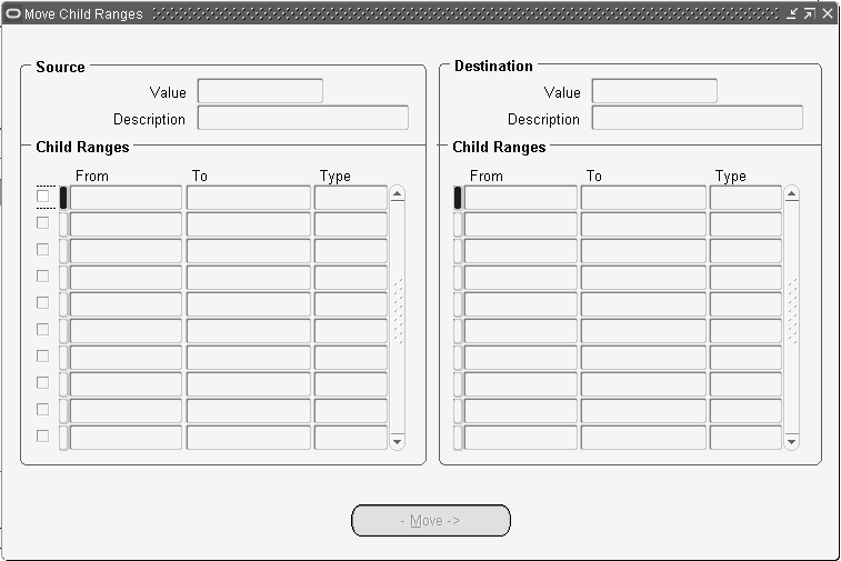

Use this window to move a range of child values from one parent value (the source value) to another parent value (the destination value). When you move a range of child values from one parent value to another, you also move any child values that belong to the child values in the range you move. In other words, when you move a child to a different parent, you also move any "grandchild" values with it.
Use this window only for values you use in segments of the Accounting Flexfield.
For example, suppose you have defined hierarchy structures as shown in the following diagram:
The value 1000 is a parent of the child values 100, 200 and 300; the value 300 is in turn a parent of the child values 301, 302, and 303. A separate structure consists of the parent value 003 with no child values. If you move the parent value 300 from the parent value 1000 to the parent value 003, you also move the child value range 301 (Low) to 303 (High). All three values 301, 302 and 303 are now grandchild values of 003 instead of 1000.
Enter the value from which you want to move a child range.
This field defaults to display the selected parent value from the Segment Values window.
Choose which child ranges you want to move to the destination value's child ranges.
The Type field displays the type of values this child range includes. If the field contains Child, any child values that fall in the specified range are considered to be children of your parent value. If the field contains Parent, any parent values that fall in the specified range are considered to be children of your parent value.
The Destination block displays the child value ranges that currently belong to the destination parent value.
Enter the parent value to which you want to move child value ranges. You can only choose a value that is already a parent value.
Choose the Move button to move the child ranges you selected in the Source block to the destination parent value you specified in the Destination block.

Use the Value Set window to define your independent value sets, any dependent value sets that depend on them, and any table-validated value sets your flexfield needs. See: Value Set Windows.

Enter a code for your rollup group. The code is required and used internally.
Enter a name and description for your rollup group.
Save your changes.
Apply your rollup group name to particular values using the Segment Values window. See: Defining Segment Values.
For more information on defining rollup groups, see the Oracle General Ledger Implementation Guide.
