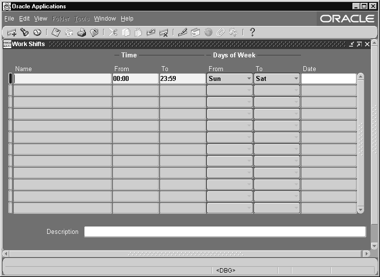

When you define a concurrent manager, you assign one or more work shifts to it. Work shifts determine when the manager operates. You define work shifts using the Work Shifts form.
If you define a period of time as a work shift, but do not necessarily want to use the work shift, you can:
Not assign the work shift to a concurrent manager
Assign the number of target processes for the work shift as zero (0), on the Define Manager form.
Delete a work shift assignment using the Define Manager form.
Work shifts can run twenty-four hours a day, from midnight till the next midnight. In military time this is defined as:
12:00am - 00:00:00
11:59:59pm - 23:59:59
The military time clock for a twenty-four period starts and stops at midnight.
If you do not want a work shift to run twenty-four hours a day, but you do want to run programs continuously past 12:00 am, you must define two work shifts:
The first work shift stops at 23:59 (11:59pm).
The second work shift starts at 00:00 (12:00 am).
For example, you want to run some data-intensive programs during the night, when most of your employees are away from the job site. You define two work shifts which you assign to this manager.
The first work shift starts at 20:00 (8:00pm) and stops at 23:59 (11:59pm).
The second work shift starts at 00:00 (12:00am) and stops at 05:00 (5:00am).
If you assign overlapping work shifts to a concurrent manager, the work shift with the more specific time period takes effect for the overlapping time period. For example, a work shift for July 4 overrides a work shift from 9:00 am to 5:00 pm on Monday through Friday.
The following table presents a descending list of priority levels for overlapping work shifts. A work shift with a specific date and range of times has the highest priority. The "Standard" work shift has the lowest priority.
| Priority | Work Shift Definition | Example |
| 1 | Specific date and range of times | April 15, 2000 8:00am-5:00pm |
| 2 | Specific date and no range of times | April 15, 2000 |
| 3 | Range of days and range of times | Monday-Friday 8:00am-5:00pm |
| 4 | Range of days and no range of times | Monday-Friday |
| 5 | Range of times and no date and no range of days | 8:00am-5:00pm |
| 6 | Standard work shift. No date, days, or time defined. | Standard work shift is 365 days a year, 24 hours a day. |
When you have overlapping work shifts that have the same level of priority, the work shift with the largest target processes takes effect.
For example, you have two work shifts with a range of days and a range of times. You have a "Weekday" work shift from 9:00 am to 5:00 pm on Monday through Friday with 4 target processes.
You also have a "Lunch" work shift from 11:00 am to 1:00 pm on Monday through Friday with 8 target processes.
The "Lunch" work shift takes effect from 11:00 am to 1:00 pm (Mon.-Fri.) because it has the larger number of target processes.

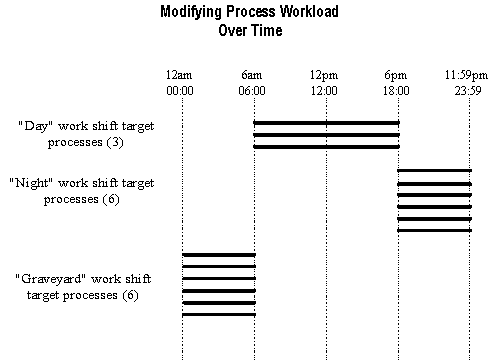

Part of a manager's definition is how many operating system processes it can devote to reading requests. For each of these processes, referred to as a target process, a manager can start one concurrent program.
For each work shift you assign to a manager, you define a number of target processes.
By using work shifts with different numbers of target processes, you can modify your concurrent processing workload according to the day, time of day, and even specific dates.
The figure below illustrates how, by using three work shifts, a manager can be defined to run three programs concurrently from 6:00am-6:00pm, and six programs concurrently from 6:00pm-6:00am.

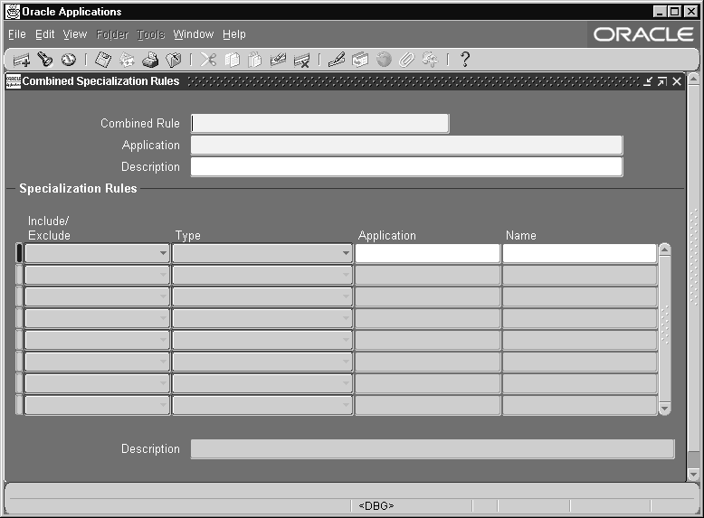

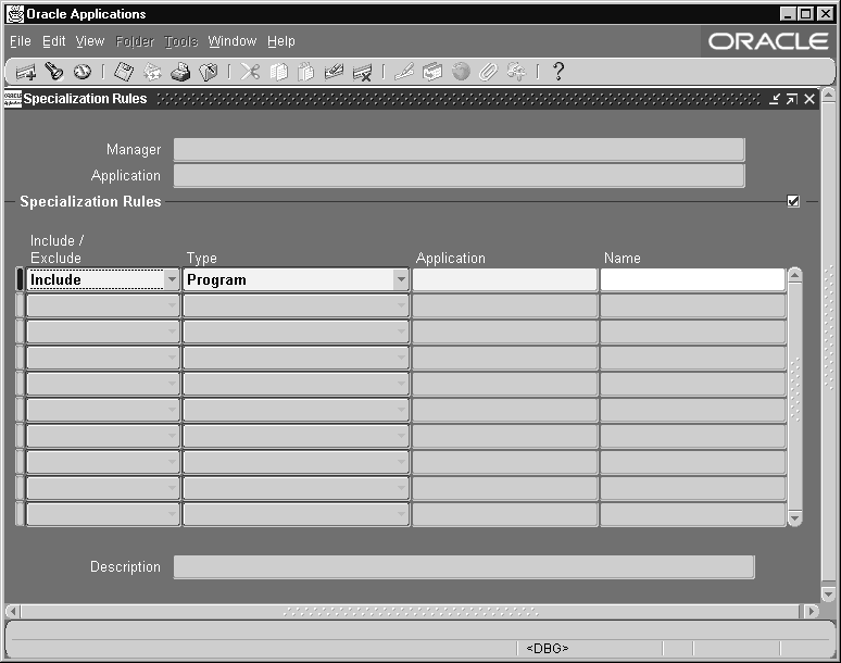

Use the Rules section to specialize your manager to run only certain kinds of requests. Without specialization rules, a manager accepts requests to start any concurrent program.
A listing of available rules is displayed. Check the Include check box for a rule to include it.
The following information is also given for each rule:
Type
Application
Name
Description
To edit any of this information, use the Edit button. Use the Remove button to remove a rule from the list. To create a new rule, use the Create New dropdown list and click Go.

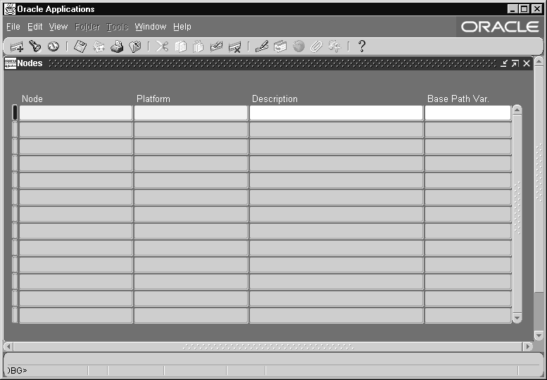

If you are operating in a parallel concurrent processing environment and you want your manager to operate on a specific node, select the name of the node.
The primary node, if available, is the node your concurrent manager operates on. If the primary node or the database instance on it goes down, your concurrent manager migrates to its secondary node. Your concurrent manager migrates back to its primary node when that node becomes available.
Nodes must be previously registered with Oracle E-Business Suite, using the Nodes window in Oracle E-Business Suite.

The number of operating system processes you want your work shift to run simultaneously. Each process can run a concurrent request.
For example, if a work shift is defined with three (3) target processes, the manager can run up to three requests simultaneously.
Nodes must be previously registered with Oracle E-Business Suite using the Nodes window in Oracle E-Business Suite.
Use this page to define work shifts for your services. Define work shifts to specify when your services can work.
Navigation: Site Map - Administration > [Service Instance type] (under Application Services) > Create [Service] > Workshifts region, (B) Add from Available Shifts > (B) Create New Site Map > Work Shift Library (under Application Services) > Create New
Name - The name of your work shift should be intuitive, for instance "Week Days", "Weeknights" or "Weekends".
Description - Add a description for your work shift.
Schedule - For each work shift, specify a time period covering a range of days or a particular date. Specify if you are scheduling by day or by date.
Day - Enter the first and last days of this shift. For instance, if your shift name is "Week Days", you could enter "Monday" in the "Days of Week From" field and "Friday" in the "Days of Week To" field. If you enter a value in the "Days of Week From" field, you must enter a value in the "Days of Week To field".
Date - Enter a date here to create a date-specific work shift. Date-specific work shifts override work shifts that do not specify a specific date. If you want to enter a value in this field (specify a date), you may not enter values for the Days of Week fields for this row.
Time - Enter the times of day at which your concurrent shift begins/ends. The time format is HH24:MM. For example, if your work shift name is "Week Days", you could enter "09:00" (9:00 am) as the start time and "17:00" (5:00 pm) as the end time. Note that Oracle E-Business Suite uses a 24-hour clock.

A specialization rule associates an action with a type of request. There are two kinds of actions: Include and Exclude.
Include defines a manager to only read requests of the type specified.
Exclude defines a manager to read all requests except the type specified.
Requests to run concurrent programs may be allowed or disallowed on the basis of:
the ORACLE ID of the request's Set of Books (for multiple installs) or Organization if you are using multiple organizations.
the program itself or the program's application
the request type of the program
the user who submitted the request
a combined rule, which combines more than one action to generate a single rule. The combined rule applies its actions to one or more types of request.
For example, a combined rule can exclude an action from an Oracle ID and exclude another action from a specific program.
Each rule performs one action. When using more than one rule, the rules are evaluated as follows:

A combined specialization rule combines more than one action to generate a single rule. The actions are combined as AND statements so that the rule is defined as:
Action 1 AND . . .
Action 2 AND . . .
Action 3 AND . . . so on.
You can create combined rules and use them with several managers, instead of duplicating a complex rule each time.
There are two kinds of Actions you may use to build a combined rule; Exclude and Include. Each action is defined by one line within the rule. Combining the specialization lines or individual actions defines the overall combined rule.
An Exclude action overrides a Include action.
For example, you can define an Exclude application program x action and a Include user Yvonne Jones action. Combining these two actions generates the combined rule "read all requests from user Yvonne Jones except requests to run program x". See: Combined Specialization Rules.
Combined specialization rule actions, their binding logic, and examples are presented in the following table.

Using combined rules you can precisely specialize a manager.
A combined rule combines more than one action to generate a single rule. Each action is defined by one line within the rule. Combining the lines or individual actions defines the overall combined rule.
Tip: You can use a combined specialization rule as one of many rules to specialize a manager.
A single Exclude action within a combined rule acts the same way as a single Exclude action that defines a specialization rule. Both instruct a manager to read all requests to run concurrent programs except those identified by the action.
| Variable | Description |
| Exclude | Oracle ID - APPS |
| Result | The manager reads requests to run concurrent programs that connect to any Oracle ID, except those programs that connect to Oracle ID “APPS". |
A single Include action within a combined rule acts the same way as a single Include action that defines a specialization rule. Both actions instruct a manager to read only the requests that satisfy the action.
| Include | Oracle ID - APPS2 |
| Result | The manager only reads requests to run concurrent programs that connect to Oracle ID “APPS2". |
Using multiple Exclude actions as multiple lines within a combined rule is equivalent to using multiple Exclude actions as multiple specialization rules.
You can exclude more kinds of requests by adding more Exclude lines to your combined rule.
| Exclude | Program - Oracle Sales & Marketing, No entry for Name field. |
AND
| Exclude | Program - Oracle Inventory, No entry for Name field. |
| Net Result | The manager reads all requests to run concurrent programs except requests for programs for the application “Oracle Sales & Marketing", and requests for programs for the application “Oracle Inventory". |
Using multiple Include actions adds more requirements to a combined rule, and excludes more kinds of requests.
You cannot use two Include actions for the same action type. Each Include action is an exclusive statement for a particular type of action. For example, you cannot require a request to be for a program that connects to two different Oracle IDs.
| Include | Program - Oracle Payables, No entry for Name field. |
AND
| Include | Program - Oracle Payables Confirm Receipt Batch |
| Net Result | The manager only reads requests to run a single program, Confirm Receipt Batch, and only if that program is from the application "Oracle Payables". |
You cannot use Exclude and Include actions for the same type of action. Each Include action is an exclusive statement for a particular type of action.
For example, it does not make sense to require a request to be for a program that connects to the Oracle ID “APPS" and disallow a request to connect to another Oracle ID.
When using multiple lines within a Combined Rule, the Exclude action always overrides a Include action.
| Include | Program - Oracle Payables Invoice Import |
AND
| Exclude | Oracle ID - APPS2 |
| Net Result | The manager reads requests to run the Oracle Payables Invoice Import program, but will not run the program when it connects to the Oracle ID “APPS2". The Exclude action overrides the Include action. |
You can define a combined rule that instructs a manager to only read requests to run a single program when submitted by a specific user.
| Include | User - Sheryl |
AND
| Include | Program - Oracle Project Accounting Distribute Usage Costs |
| Net Result | The manager only reads requests submitted by Sheryl to run the Distribute Usage Costs program. |
You can define a combined rule that instructs a manager to ignore requests to run a certain programs when submitted by a specific user.
AND
| Exclude | Program - Oracle Project Accounting Expenditure Status |
| Net Result | The manager only reads requests submitted by Sheryl, excluding requests to run the Oracle Project Accounting program Accounting Expenditure Status. |
| Include | Request Type - Oracle Project Accounting Expenditure Reports |
AND
AND
| Net Result | The manager only reads requests to run programs belonging to the Oracle Project Accounting request type “Reports", run against the Oracle ID “APPS2", excluding the program Expenditure Reports. |

The primary difference between a specialization rule and a combined specialization rule is in how the use of multiple actions affects the outcome of the rule, as described in the following table:
| Rule | Action | Effect of Multiple Actions | Relationship to Other Rules |
| Specialization Rule | INCLUDE | With each additional Include rule, the manager can read MORE REQUESTS. | Each rule establishes an OR condition. OR...INCLUDE... |
| Specialization Rule | EXCLUDE | With each additional Exclude rule, the manager is excluded from, and reads, FEWER REQUESTS. | Each rule establishes an AND condition. AND...EXCLUDE... |
| Combined Rule Specialization Line | EXCLUDE | With each additional Exclude line, the manager is excluded from, and reads, FEWER REQUESTS. | Each line within a rule establishes an AND condition. AND...EXCLUDE... |
| Combined Rule Specialization Line | INCLUDE | With each additional Include line or additional requirement, the manager reads FEWER REQUESTS. | Each line within a rule establishes an AND condition. AND...INCLUDE... |

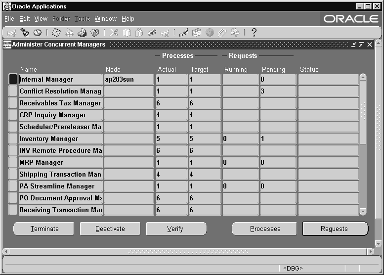

Use the Administer Concurrent Managers form to issue commands to your concurrent managers.
You can also have the Internal Concurrent Manager "manually" verify the status of your individual managers, and restart individual managers. See: Administer Concurrent Managers.
The following table describes control functions for the Internal Manager.
| Control Function | Description |
| Activate concurrent manager | Activates the Internal manager and all other managers, except managers that were deactivated individually using "Deactivate concurrent manager". |
| Verify concurrent manager status | Manually executes the process monitoring (PMON) cycle. |
| Deactivate concurrent manager | Deactivates the Internal manager and all other managers. |
| Terminate requests and deactivate manager | All running requests (running concurrent programs) are terminated, and all managers are deactivated. |
The following table describes control functions for any other manager.
| Activate concurrent manager | If the manager is defined to work in the current work shift, it starts immediately. Cancels "Deactivate concurrent manager" and "Terminate requests and deactivate manager". |
| Restart concurrent manager | Internal manager rereads the manager's definition, and the rules for concurrent program incompatibilities. You should restart a manager when you: - Change work shift assignments - Modify the number of target processes - Modify specialization rules - Change concurrent program incompatibilities |
| Deactivate concurrent manager | Deactivates the manager. All requests (concurrent programs) currently running are allowed to complete before the manager shuts down. A manager will not restart until you select the manager and choose "Activate concurrent manager". |
| Terminate requests and deactivate manager | All running requests (running concurrent programs) handled by the manager are terminated. Once deactivated, a manager will not restart until you select the manager and choose "Activate concurrent manager". |

View the status of your concurrent managers (including any transaction managers) and, if you wish, change the status of any manager by issuing a control command. For example, you can deactivate a manager that is currently active, then view its new status after the change takes effect.
Use the Refresh button to refresh the data shown.
In a parallel concurrent processing environment, a manager's processes are targeted to run on this node.
If a concurrent manager is defined to use a platform-specific system queue, this field displays the name of the queue to which the manager submits its processes.
Each manager process can run one concurrent request (start one concurrent program). Typically, the number of actual processes equals the number of target processes (the maximum number of requests a manager can run).
However, the number of actual processes may be less than the number of target processes due to manager deactivation or manager migration.
This field displays the maximum number of manager processes that can be active for this manager.
Typically, when there are requests pending, this number should be the same as the number of actual processes. However, if there are no pending requests, or requests were just submitted, the number of requests running may be less than the number of actual processes.
Moreover, if a concurrent program is incompatible with another program currently running, it does not start until the incompatible program has completed. In this case, the number of requests running may be less than number of actual processes even when there are requests pending.
This field displays the status of a manager after you have chosen a specific action for it using the top row of buttons near the bottom of the window.
You can control concurrent managers individually or collectively by controlling the Internal Concurrent Manager. This field is blank when managers have been activated by the Internal Concurrent Manager.
In a parallel processing environment, this field displays Target node/queue unavailable when the primary and secondary nodes (or system queues) are not available.
| Terminate | When you terminate requests and deactivate the Internal Concurrent Manager, all running requests (running concurrent programs) are terminated, and all managers are deactivated. Managers previously deactivated on an individual basis are not affected. You can terminate requests and deactivate individual managers. All running requests (running concurrent programs) handled by the manager are terminated. Once deactivated, a manager does not restart until you select the manager and choose the Activate button. |
| Deactivate | When you deactivate the Internal Concurrent Manager, all other managers are deactivated as well. Managers previously deactivated on an individual basis are not affected. You can deactivate individual managers. Once deactivated, a manager does not restart until you select the manager and choose the Activate button. When you deactivate a manager, including the Internal Concurrent Manager, all requests (concurrent programs) currently running are allowed to complete before the manager(s) shut down. |
| Verify | This choice appears only when you select the Internal Concurrent Manager. The Internal Concurrent Manager periodically monitors the processes of each concurrent manager. You can force this process monitoring or PMON activity to occur by choosing the Verify button. Another result of selecting this choice is that the Internal Concurrent Manager rereads concurrent program incompatibility rules. |
| Restart | This choice appears only when you select an individual manager. When you restart a concurrent manager, the manager rereads its definition. You should restart a manager when you have made the following changes using the Define Concurrent Manager form, and you wish those changes to take effect:
| Fixed | This choice appears only when a manager has been down due to an underlying issue beyond the concurrent manager startup threshold and the Internal Concurrent Manager has stopped attempting to restart it. After the underlying problem has been fixed, this choice is available so that you can indicate that it has been fixed and the ICM should try to restart the concurrent manager again. |
| Activate | When you activate the Internal Concurrent Manager, you activate all other managers as well, except those managers that were deactivated on an individual basis. You cannot activate the Internal Concurrent Manager from the PC client. The Internal Concurrent Manager is only activated from the server. You can also activate an individual concurrent manager that is currently deactivated, so long as the Internal manager is active. If the manager is defined to work in the current work shift, then the Internal manager starts it immediately. |
| Processes | You can view the details of the processes of a given concurrent manager. Processes that are currently active, migrating, or terminating, as well as processes that have been terminated or deactivated, are displayed. |
| Requests | For a selected manager you can view all running and pending requests handled by the manager. |
The following actions are available only for certain services managed Generic Service Management. These services must be defined to accept commands to suspend their operations.
| Suspend | Suspend the operations of the service. |
| Resume | Resume the operations of the service. |

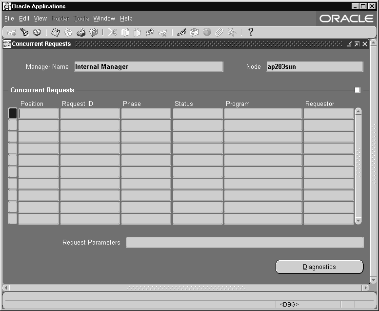

View all running and pending requests for a selected manager, whose name and node are identified near the top of the window.
This window informs you when the request completed or if it did not complete, shows you a diagnostic message indicating why.

Nodes must be previously registered with Oracle E-Business Suite, using the Nodes window. See: Nodes.

| Specialization Rules | You define what kinds of requests the manager reads by defining specialization rules for your manager. |
| Work Shifts | You define when the manager operates by assigning one or more work shifts to your manager. With each work shift, you can vary the number of programs the manager can run simultaneously. |
Assign work shifts to a concurrent manager. A work shift defines the dates and times the manager is enabled. For each work shift you define the number of processes the manager starts running.
Work shifts are defined using the Work Shifts form. See: Work Shifts.
Enter the number of operating system processes you want your work shift to run simultaneously. Each process can run a concurrent request.

Specialize your manager to run only certain kinds of requests. Without specialization rules, a manager accepts requests to start any concurrent program.
Select from the poplist whether or not to include or exclude those requests that are based on the rule to run.
Select the type of specialization rule you want to assign to your manager. Based on the rule's action you selected, allow or disallow, requests can be run by your manager according to a:
Combined Rule
For example, only requests that satisfy the combined rule you select are allowed to be run by your manager. Or conversely, requests that satisfy a certain combined rule are excluded from running.
Combined specialization rules, which combine more than one logical statement, are defined using the Combined Specialization Rules form. See: Combined Specialization Rules.
ORACLE ID
For example, programs with a certain ORACLE ID are excluded from running. Or conversely, a concurrent manager only includes programs with a specific ORACLE ID.
Program
For example, only the program you select is excluded from running. Or conversely, a concurrent manager only includes the programs you select. You can also include or exclude all programs belonging to a specific application using the Program type by entering the application in the Application field and leaving the Name field empty.
Request Type (of the program)
For example, programs of a certain request type are excluded from running. Or conversely, a concurrent manager only includes programs with the request type you select.
User (application username at sign on)
For example, all programs submitted by a certain user are excluded from running. Or conversely, a concurrent manager includes only programs submitted by the user you select.
Use this window to name and define your concurrent manager work shifts. Define work shifts to specify when your concurrent managers can work.
For each work shift, specify a time period covering a range of days or a particular date. See: Work Shifts Definitions.
The name of your concurrent work shift should be intuitive, for instance "Week Days", "Weeknights" or "Weekends".
Enter the first and last days of this shift. For instance, if your shift name is "Week Days", you could enter "Monday" in the "Days of Week From" field and "Friday" in the "Days of Week To" field. If you enter a value in the "Days of Week From" field, you must enter a value in the "Days of Week To field". You may not use the Date field for this row.
Enter a date here to create a date-specific workshift. For instance, you can name a workshift "Memorial Day", and enter the date in this field to enable this workshift only on the Memorial Day holiday.
Date-specific workshifts override workshifts that do not specify a specific date. If you want to enter a value in this field (specify a date), you may not enter values for the Days of Week fields for this row. See: Overlapping Work Shifts - Priority Levels.

Define rules identifying which requests a concurrent manager can read. With the rules you define here, you may specialize the function of a concurrent manager.
Using this window, you can define several Include and Exclude statements, each referred to as a specialization line, and combine the lines into a single specialization rule referred to as a Combined Rule.
Unlike the individual rules you define using the Specialization Rules window from within the Concurrent Managers window, the combined rules you define here differ in two ways:
You can combine Include and Exclude statements. This enables you to identify very specific requests for running concurrent programs.
Within a combined rule, using multiple Include statements restricts a concurrent manager more.
With individual rules you define using the Specialization Rules window (within the Concurrent Managers window), the more "Include" rules you define, the less restricted a manager becomes.
See: Concurrent Managers
Together, the application name and the name you define for your combined specialization rule uniquely identifies the rule.
The application name does not prevent a concurrent manager from starting programs associated with other applications.
Define the individual rules (statements) that make up your combined specialization rule.
Each rule in this block defines one statement.
The sum of all the specialization rules defines your combined specialization rule.
Select from the poplist whether to include or exclude those requests that are based on the rule to run.
Select the type of specialization rule you want to enforce on a concurrent manager.
You cannot combine two Include rules of the same type. For example, you cannot include programs to be associated with an ORACLE ID, then, on another line, include programs to be associated with a second, different ORACLE ID.
Based on a rule's action, exclude or include, programs can be run by your manager according to a:
ORACLE ID
Program

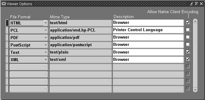

Use this form to define the MIME types for the output formats of your concurrent requests. These MIME types are used in viewing reports.
For each file format, you can associate one or more MIME types.
A user can use one MIME type to view reports of a certain format. For example, a user can view all text format reports in Microsoft Word. The MIME types for supported formats for a particular user are set by several profile options. They are:
Viewer: Application for HTML
Viewer: Application for PCL
Viewer: Application for PDF
Viewer: Application for PostScript
Viewer: Application for Text
This MIME type is sent to a browser window when the user views a report of that file format.
Associate one or more MIME types with each supported file format. By defining viewer options, you can specify the application or applications that are available for displaying files of each format.
The file format.
The MIME type to use for the file output.
If this box is checked, the Report Viewer will convert the output file into the character set specified by the FND: Native Client Encoding profile option.

A node consists of one or more processors and their associated memory. In parallel concurrent processing environments (such as cluster, massively parallel, and homogeneous networked environments) each node operates independently of other nodes except when sharing resources, such as a disk.
You can assign concurrent managers to different nodes to spread your concurrent processing workload and increase throughput. A concurrent manager runs its processes on the nodes to which it is assigned.
Enter the operating system name of a node.
Select the operating system platform that your node resides on.
Consult your installation manual to determine the correct base path variable for your platform to determine the location of the concurrent managers' log and out files for this node.
