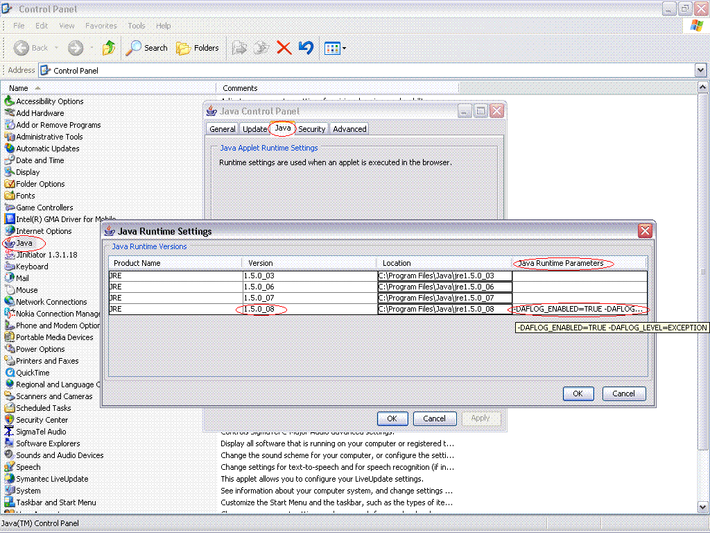

For logging in Client-side Desktop Applets, you must use the FND AppletLog Class available in 'fndctx.jar'. Use of AppsLog in Applets is not supported.
AppletLog is a simple wrapper around System.out that logs to the Java console. You can control logging by setting 2 Java System Properties (AFLOG_ENABLED, AFLOG_LEVEL) in the Java Console.
You need to configure these values for the specific JRE version that is running the Applet. Navigate to Control Panel -> Java -> Java Tab -> Java Runtime Parameters (Double-click in the text area to enter values). You can also bring up the Java Console from the Windows Icon tray (in the Taskbar) by right-clicking on the Java icon while your Applet is running. The JRE version can be determined by double-clicking on the Java icon.
Code Sample:
import oracle.apps.fnd.common.logging.client.AppletLog;
AppletLog log = AppletLog.getAnonymousLog();
if (log.isEnabled(AppletLog.STATEMENT))
log.write(TreeViewer.class, "Rendering node=" + leaf, AppletLog.STATEMENT);
By default logging is enabled at the UNEXPECTED level.
Read the Developer Usage Guidelines, and ensure that you fully understand and follow the standards correctly. Do not use AppletLog for middle-tier logging.
