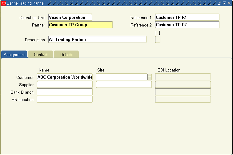

Navigate to the Trading Partner Groups window.
Select an operating unit that is linked to your responsibility for the trading partner group.
Note: The Operating Unit field is defaulted to the default operating unit set by the profile option MO: Default Operating Unit. This operating unit is the current operating unit that you are signing on. You can select another operating unit from the list of values if you are associated with more than one operating units.
Enter a unique trading partner group identifier.
Optionally, enter a description for the trading partner group.
Do one of the following:
To add a new trading partner to a trading partner group, choose the New button to open the Trading Partners window.
To update an existing trading partner in a trading partner group, enter the trading partner location code. Then choose the Open button to open the Trading Partners window.
The Operating Unit field displays the selected operating unit for the trading partner group.
Enter a trading partner name. This trading partner will be associated with the operating unit.
Optionally, enter the trading partner description.
Optionally, enter references 1 and 2. This is for any additional data needed by the trading partner.
Optionally, access trading partner flexfields (also known as attributes) by choosing the flexfield represented by [ ]. In order to be used, flexfields must first be defined using System Administration.
In the Assignment tabbed region, associate this trading partner definition with the corresponding Oracle E-Business Suite physical address entity. This is address- or site-level data.
Since Trading Partners within the Trading Partner group are associated with an operating unit, only those Trading Partner addresses associated with the selected operating unit will be displayed in the list of values for selection.
When multiple operating units are associated with your responsibility, if you want to associate a different set of addresses for the same Trading Partner group and same Trading Partner, then you have to reselect the operating unit in the Trading Partner Groups form and then change the setup for the underlying Trading Partners. The operating unit is relevant to the underlying addresses only and not to the Trading Partner groups or Trading Partner headers.
If you are defining the trading partner as a customer, select a customer and customer site. These values are defined in Oracle Order Entry and / or Oracle Receivables.
If you are defining the trading partner as a supplier, select a supplier and supplier site. These values are defined in Oracle Purchasing and / or Oracle Payables.
If you are defining the trading partner as a bank, select a bank branch address. This value is defined in Payables.
If you are defining internal locations such as your ship-from location, select the Human Resources location code. These values are defined in Oracle Human Resources.
