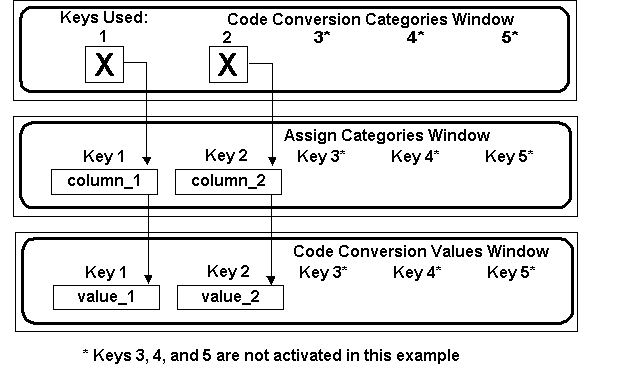

To use Keys 1-5, set ups are required in the Code Conversion Categories window and the Assign Categories window previously discussed. Users must indicate what the full search key will be during code conversion set up. For example, it may be the sales channel, customer code, and customer site. Users select what columns to examine from columns in the specific transaction tables in the Oracle e-Commerce Gateway. These columns contain the actual code values examined during code conversion.
The following illustrations show the relationship of the five keys across the three code conversion windows.
Code Conversion Categories window:
In the example, only two keys are turned on, so a maximum of two search keys will be read during code conversion.
Assign Categories window:
In the Assign Categories window the columns that contain the data in the transaction to be used as the search keys in the code conversion value table are identified. Because the example uses only two keys, only Key1 and Key2 are populated.
Code Conversion Values window:
In the Code Conversions Values window the actual data values are entered. In the example, the value_1 of 1000 is the customer code, and the value_2 of 2000 is the customer site number to be used as part of the full search key during code conversion.

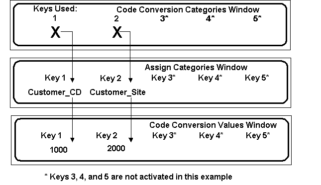

Relationship of the Code Conversion Windows
The following illustration shows the relationship of the five keys across the three code conversion windows with actual data.
Relationship of the Five Keys Across the Three Code Conversion Windows

The Code Conversion Categories window has two of the potential five search keys enabled for Category SHIP_VIA to accommodate the customer name and customer site search keys in the other code conversion windows.
The Assign Code Conversion window enables code conversion on a column and specifies which columns to examine for the actual search key values. You decide which columns are used as the Key1 through Key5. The following were set up for this transaction:
Column is CARRIER_INT.
The Category SHIP_VIA is assigned to CARRIER_INT to enable code conversion.
Key 1 is assigned the CUSTOMER_NAME column in the transaction table.
Key 2 is assigned the CUSTOMER_SITE column in the transaction table. You selected the keys from a list of values.
The full search key to access the code conversion value table for inbound transactions include the code category, direction, Key 1, Key 2, and the 1-5 external code. For example, the first entry in the table includes the following search key values: (See the sample Code Conversion Value Table for all entries.)
Key 1 has value ‘ALPHA' for the CUSTOMER_NAME.
Key 2 has value ‘1006' for the CUSTOMER_SITE.
The Code Conversion Value window includes the search key values applicable to the internal and external codes for all the Trading Partners and all transactions. The Category that you assign to a column limits the access to just those table entries that have been assigned that Category.
The full search key to access the code conversion value table for outbound transactions include the code category, direction, Key 1, Key 2, and the internal code. For example, the first entry in the table includes the following search key values: (See the sample Code Conversion Value Table for all entries.)
