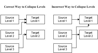

Collapsing levels is the mapping of multiple source levels to the same target level. For example, if your source is 3 levels and your target is 2 levels you can collapse the levels as shown in the following figure:
In the correct example above, the result of collapsing levels is that the data in Source Levels 2 and 3 are consolidated and mapped to Target Level 2. If there are two rows in Source Level 2 and three rows in Source Level 3, a total of six rows will be created in Target Level 2.
The incorrect example shows the collapsing of Source Levels 1 and 3 to Target Level 1, causing Source Level 3 to cross over Target Level 2.
Another option is to relate Source Levels 1 and 2 to Target Level 1 and relate Source Level 3 to Target Level 2, as shown in the correct example below. (Do not map Source Level 3 to Target Level 1, crossing over Target Level 2.)
Whichever option you choose, consider what it means to promote lower level detail data to a higher level. The source data may need to be aggregated to be meaningful at the higher level.

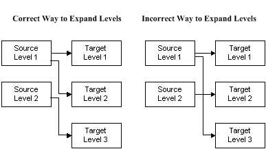

Expanding levels is the mapping of one source level to multiple target levels. For example, if your source is 2 levels and your target is 3 levels you can expand the levels as shown in the following figure:
The result of expanding levels, as shown in the correct example above, is that the data in Source Level 2 is distributed and mapped to Target Levels 2 and 3. If there are two rows in Source Level 2, two rows will be created in Target Level 2 and Target Level 3.
Do not expand Source Levels across Target Levels, as shown in the incorrect example above. Source Level 1 is incorrectly expanded to Target Levels 1 and 3, crossing over Target Level 2.
Another option, as shown in the correct example below, is to distribute Source Level 1 to Target Levels 1 and 2 and map Source Level 2 to Target level 3. (Do not map Source Level 1 to Target Levels 1 and 3, crossing over Target level 2, as shown in the incorrect example.)
Whichever option you choose, consider what it means to demote data from a higher level to a lower level of detail. The source data may need to be deaggregated to be meaningful at the lower level.
