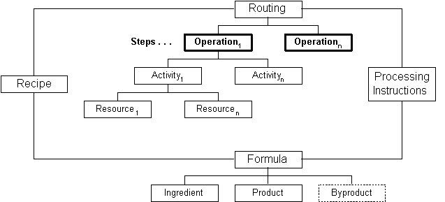

An operation is an ordered set of activities that have to be completed for a predetermined step in a production batch. Resource requirements that are needed to perform these activities are usually specified. You build operations from activities that require resources.
Operations are depicted hierarchically in the following diagram that shows the:
Routing composed of a series of Operations organized in Steps.
Operations composed of Activities containing Resources.
Formula composed of Ingredient, Product, and possibly Byproduct.
Recipe linking the Routing and Formula together with Processing Instructions.
Note: Set up instruction sets as described in the Oracle Manufacturing Execution System for Process Manufacturing User's Guide.
The assembly of several operations in a stepwise progression creates a Routing.
