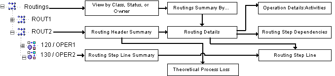

Use the following windows to maintain routings:
Routings Summary By to display a list of defined routings with their individual version numbers and descriptions. View routings by Class, Status, or Owner. Display the Process Routing Details window from the Routings Summary By window.
Routing Header Summary to display important descriptive information on a specific routing. Display the following windows from the Routing Header Summary window:
Theoretical Process Loss
Routing Step Line Summary to determine the step number, operation, step quantity, and unit of measure for the step in a specific routing. Display the Routing Step Line window from the Routing Step Line Summary window:
Routing Step Dependencies to create and modify the interrelationships between routing steps. Step dependencies are those relationships between steps that establish whether a specific step can or cannot start until another step is completed.
Theoretical Process Loss to enter the theoretical percent loss expected for a range of material processed during a specified routing.
Routing Step Line to edit individual routing step lines.
The following graphic depicts the previously described routing navigation flow:
