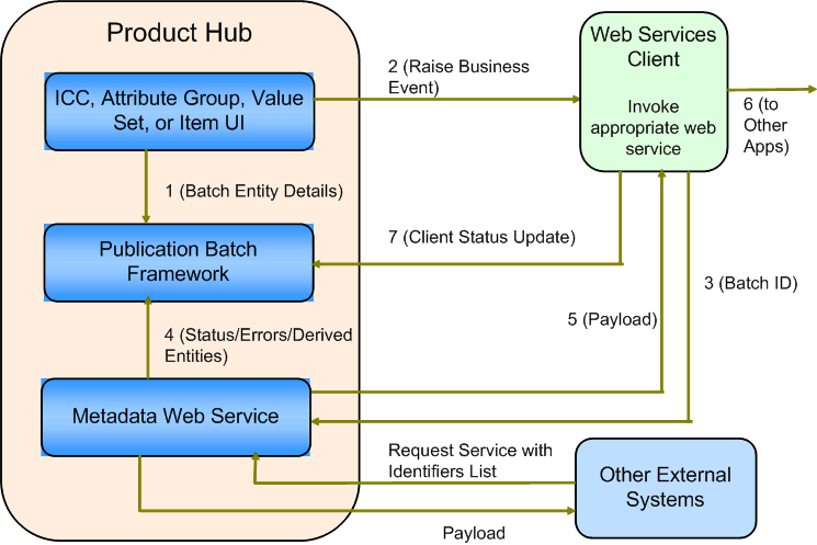

The figure below shows a sample implementation that consumes one of these Web Services.
System Flow and Interaction Diagram
Related Topics
