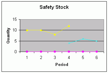

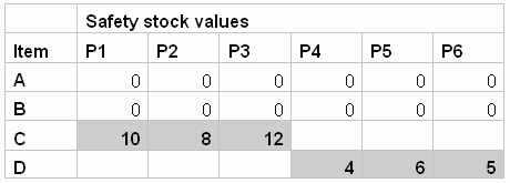

Assuming that the forecast is for the latest revision in the supersession chain, Inventory planning creates safety stock for the latest revision item in a given planning bucket. Inventory planning performs safety stock smoothing across the buckets as long as the item it is planning for is the same. Since Inventory Optimization does not consider the supersession chain, it does not smooth across items in the chain.
If the supersession definition is A to B to C in buckets 1, 2, and 3 and A to B to C to D in buckets 4, 5, and 6, then inventory planning will smooth safety stock for item C across the three buckets and then smooth for D across buckets 4, 5 and 6. But there will be no smoothing between the third and fourth bucket.
the picture is described in the document text

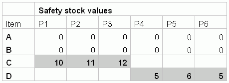

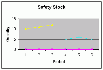

After Oracle Inventory Optimization smoothing:
