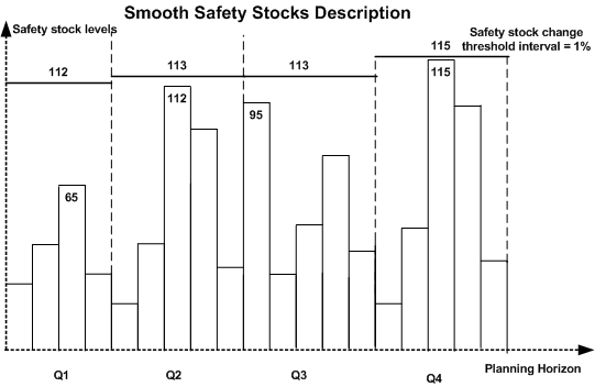

Oracle Inventory Optimization calculates time phased safety stock values across the planning horizon. However, there may be frequent changes to the safety stock if the demand variability is high. You may prefer estimating safety stock that is stable across the planning horizon. Oracle Inventory Optimization enables you to hold a constant safety stock for a specified time in the planning horizon. If you do not want the inventory planning engine to recommend any change in the safety stock for a specific duration, you can indicate the number of days. Oracle Inventory Optimization ignores the negative on-hand when it calculates the safety stock. The inventory planning engine considers the negative on-hand as an independent demand due in the first bucket.
You can use the following plan level options in the Plan Options window to control the stability of the safety stock:
Safety stock change interval (days)
Safety stock change threshold interval (%)
For more information on these plan level options, see Plan Options Overview.
Consider an example. In the following illustration, the vertical axis represents the safety stock level while the horizontal axis represents the planning horizon. In this example, planning horizon is split into 4 quarters. The safety stock change threshold interval is set to 1%.
Safety Stock Change Threshold
The highest level of safety stock is indicated in the last change interval (Q4) at 115. The safety stock requirement in the adjacent interval is 95, which is lower than the requirement in Q4. This indicates that the safety stock quantity for Q3 needs to be reduced. As the safety stock change threshold interval is set to 1%, the inventory planning engine changes the safety stock levels at 113. The inventory planning engine reduces the stock from Q4 by a maximum of 1%. This amounts to 1.5, which leads to a reduction of 2 units. The inventory planning engine compares the safety stock requirements between the next adjacent quarters subsequently. In Q2, the safety stock required is 112. As 112 is within 1% of 113, the inventory planning engine does not change the safety stock levels. In Q1, the inventory planning engine recommends a reduction in the safety stock level by 1% of 112 (Q2).
Follow the steps provided to smoothen the safety stock:
Review your inventory policy to determine the change interval.
Divide the planning horizon into several equal sizes of change interval.
Set the safety stock change interval in the Plan Options form.
Determine the safety stock change threshold and specify the value in the Plan Options form.
Run the plan and analyze the results.
