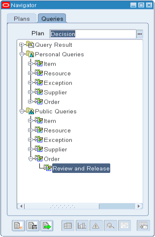

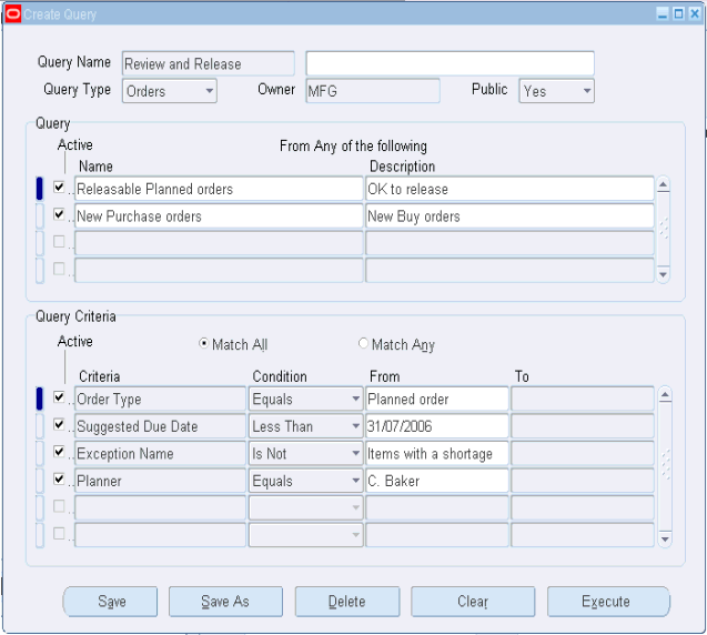

To create a query:
Steps
Open the Planner Workbench. From the Inventory Planner responsibility, navigate:
Inventory Plan > Workbench
The Navigator window appears.
Switch to Queries Tab, if it has not been set as the default Tab in the Navigator Pane.
See Setting Queries Preferences.
Select the 'Create Query' icon located at the bottom left of the Navigator Pane.
The Create Query window appears.
Specify a Query Name and Description.
Select a Query Type, Owner, and specify whether this query will be available to the public.
(Optional) If this query includes existing sub-queries, in the Query region, list the Names of the sub queries.
Note: Multiple sub-queries can be entered, each with its own criteria Upon execution, all sub-queries will be executed
Select the Active check box for sub-queries that you want to be in effect.
In the Query Criteria region, enter the query criteria. Multiple criteria can be specified.
Select the Match All radio button to retrieve the intersection of all criteria.
Select the Match Any radio button to retrieve the union of all criteria.
Click Save.
To edit a query:
Steps
Open the planner work bench, and then switch to Queries tab if the Queries tab is not the default tab in the Navigator pane.
If the query is specified as a non public query, drill down to the query from the Personal Queries node.
If the query is specified as a Public query, drill down from the Public Queries node.
Note: Queries specified as Public can only be edited by the user who created the query. Other users can only view and use them.
Drill down to the required Order query from the Order Node. Highlight the required query. Right mouse click the query, and then select View Query from the right-click menu.
Edit the query, and then click Save.
To execute a query:
Steps
Drill down to the Order Query to be executed, and highlight the query.
Specify the Plan name against which the query should be executed.
Click the Execute Query icon.
The Supply/Demand Query Review and Release window appears.
Note: Queries can also be executed using the right mouse menu option of “Execute Query”.

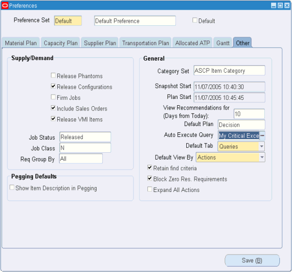

You can set preferences to:
Cause the navigator pane to open to the Queries tab instead of the Plans tab.
Specify the Auto Execute Query. Upon opening the workbench, the Auto Execute Query automatically runs, and results are shown in the Supply/Demand Query Review and Release window.
Specify the Default Plan. Auto Execute Query executes against the Default Plan.
To set query preferences.
Steps
Navigate to the Preferences window.
Tools > Preferences
The Preferences window appears.
Select the Other tab.
In the Default Tab field, select Queries from the list of values.
In the Auto Execute Query field, select the query to automatically execute when the Workbench opens.
In the Default Plan field, enter the name of the default plan against which you want the automatic query to execute.
Click Save.

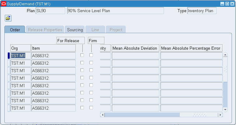

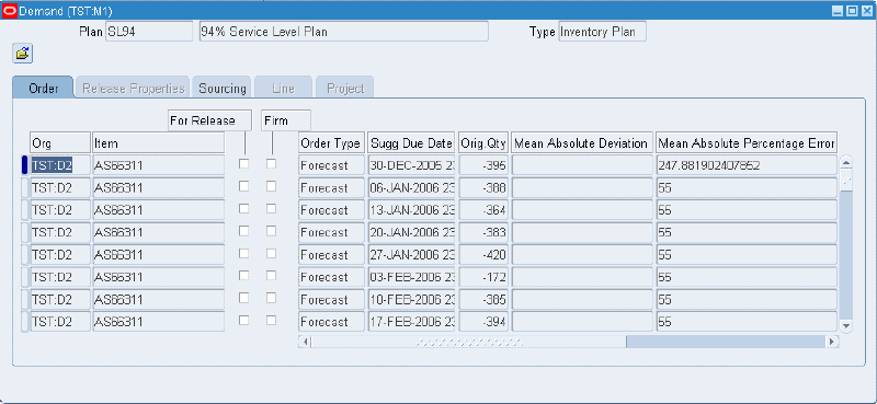

You can view time-phased supply and demand for all the items in your inventory plan using the Supply/Demand window. This enables you to analyze factors regarding supply and demand on a day-by-day or bucket-by-bucket basis. For example, you can find out how demands are met and how supplies are planned over a specify time frame. You can navigate to the Supply/Demand window from various node types such as items, organizations, and plans from the Navigator. In addition to the Navigator, you can also drill down to the Supply/Demand window from other windows such as the Vertical Plan window.
For more information on navigating to the Supply/Demand window and its fields, see Oracle Advanced Planning Implementation and User's Guide.
With Release 12, the mean absolute deviation (MAD) and the mean absolute percentage error (MAPE) metrics for forecasts calculated in Oracle Demand Planning and fed into Oracle Inventory Optimization are now visible in new columns of the Supply/Demand window of the Inventory Optimization Planner Workbench.

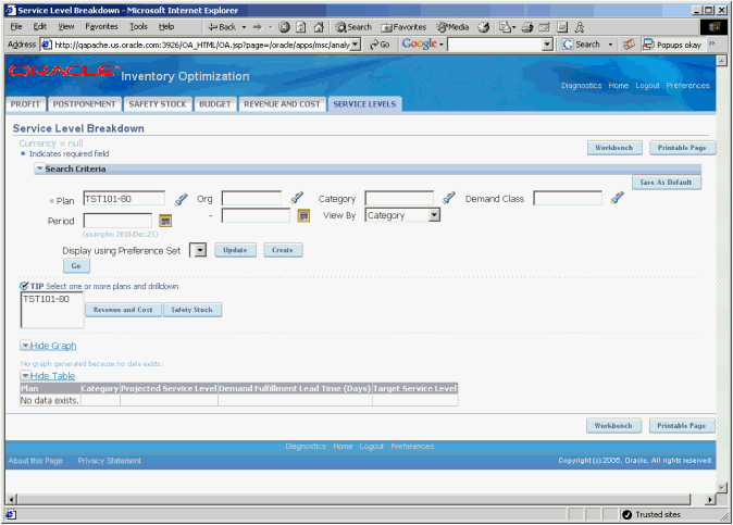

When reviewing a plan, the fulfillment lead time assigned at different levels can be viewed in the service levels folder of the analysis workbench. The fulfillment lead time shown is the value set by the user in the service level set at the particular level of aggregation being viewed. In the case where there is no assignment at the level at which the user is viewing the data, the results of default values, or assignments at more aggregate and less specific levels are not shown.
Steps
Navigate to the Service Level Breakdown page.
Inventory Analyst > Service Levels Folder
Select one or more Plans. Click Go.
This folder shows the service levels and fulfillment lead times at the level that you are viewing the data.

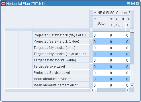

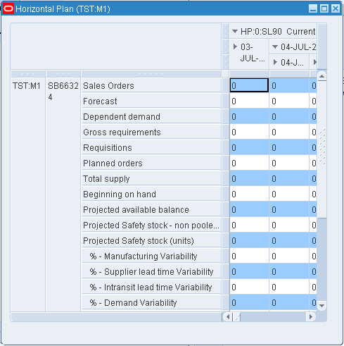

You can view the time-phased safety stock quantities for all items in a plan using the Horizontal Plan window. The values for the safety stock displayed in the Horizontal Plan and the Supply/Demand window may vary because the inventory planning engine rounds off the safety stock quantity in the horizontal plan. To access the Horizontal Plan window, click the Horizontal Plan icon in the Planner Workbench.
With Release 12, the horizontal plan of the Inventory Optimization Planner Workbench can now display the following additional rows:
Target Service Level, expressed in percent (%)
Achieved Service Level, expressed in percent (%)
Mean Absolute Deviation
Mean Absolute Percent Error
Safety stock - non pooled (units)
Safety stock units sub rows that show the percentage of safety stock to be carried to protect against the following types of variability:
Manufacturing variability
Supplier lead time variability
In-transit lead time variability
Demand variability

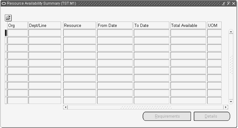

Material availability is the capacity of a supplier site to produce a specific item. This is set up in the Collections Workbench of Oracle Inventory Optimization. Resource availability is the number of hours a resource is available for production. This is set up in Oracle Bills of Material.
By viewing material and resource availability, you can find out how much can be manufactured without having to look at what is currently available. You can make changes to resource availability using the Oracle Bills of Material application and to material availability using the Collections Workbench. You can also make changes to these using the Planner Workbench, but these changes will be visible only in Oracle Advanced Supply Chain Planning and not in Oracle Inventory Optimization.
You can view time-phased material and resource availability for all items and resources in your inventory plan using the Resource Availability Summary window. You can navigate to the Resource Availability Summary window in one of the following ways:
From the Resources window, click the Availability button.
From the Navigator, select a resource and choose Resource Availability from the Resources right-click popup menu.
For more information on the Resource Availability Summary window and its fields, see Oracle Advanced Planning Implementation and User's Guide.
