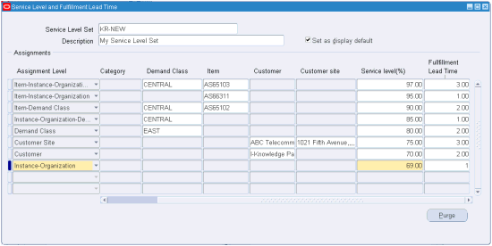

Specific service level targets can be assigned to items, categories of items, customers, classes of demand, an organization or combinations of these. These are defined in a form titled Service Levels and Fulfillment Lead Time. This form serves as a central place to set service levels for items, categories, organizations, customers, and so on. It makes obsolete several ways that service levels could be set prior to Release 12.0, such as a flex field in Oracle Inventory, and the Allocations form.
When an item has target service levels assigned at different levels of specificity, the more specific setting overrides the less specific one. The various levels of assignment allowed in a Service Level Set are listed below in increasing order of specificity.
For example, Item-Demand Class is more specific than Customer Site. In the case where the scope of target service level overlaps Customer Site and Item-Demand Class, the settings for Item-Demand Class would be in effect.
Instance-Organization
Customer
Customer Site
Demand Class
Instance-Organization-Demand Class
Category
Category Demand Class
Item-Demand Class
Item-Instance-Organization
Item-Instance-Organization-Demand Class
See Defining Service Agreement Simulation Sets.
A service level set needs to be associated with a plan to ensure that specific assignments of target service levels and fulfillment lead times are respected in the planning process. The Service Level Set is associated with a plan by clicking the constraints tab of the Plan Options folder, and then selecting the appropriate Service Level Set from the list of values to use with the plan.
Specific service level targets can be assigned to items, categories of items, customers, classes of demand, an organization or certain allowed combinations. These are done by choosing the appropriate assignment level, and then specifying the desired target service level and fulfillment lead time.
To set up a Service Level Set, use this procedure:
Prerequisites
Steps
From the Inventory Planner responsibility, navigate to the Service Levels and Fulfillment Lead Time window.
Inventory Planner > Setup > Service Levels & Fullment Lead Time
Define a Service Level Set name and description.
(Optional) Select the 'Set as display default' check box to indicate that this Service Level Set should appear as the default value in the header region of the Plan Options window.
In a row under the Assignment Level column, select an Assignment Level from the list of values.
For that same row, specify the applicable details, such as: Category, Demand Class, Item, Customer, and Customer site, to apply to the selected Assignment Level.
Note: The fields in the Assignment Level row in which you can add details varies, depending on the Assignment Level you selected.
For that same row, in the Service Level (%) column, specify the target service level, in percent, for the Assignment Level.
For that same row, in the Fulfillment Lead Time column, specify the Demand Fulfillment Lead Time, in days. See Demand Fulfillment Lead Time.
Repeat steps 4 - 7 for each additional Assignment Level in the Service Level Set.
Save your work.

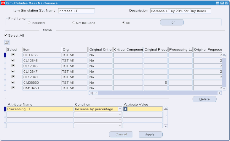

Item Attribute Simulation Sets enable Inventory Optimization plans to more easily simulate changes to key item attributes. You to attach values of key attributes to item-organizations or to item-regions, and then save those assignments under an Item Attribute Simulation Set name.
Item Simulation Sets provide the ability to mass maintain planning-related item attributes. Planners can create multiple item simulation sets, with each simulation set addressing a set of "what-if" scenarios.
The Item Simulation Set field appears in the header region of the Plan Options window. When you specify a particular item attribute simulation set name in the Item Simulation Set field of the Plan Options window, the plan uses the item attribute values specified in the named simulation set.
Key setup steps are:
Identify the scenario to be simulated.
Determine the scope of the simulation.
Create a Query to identify Items that fit the scope.
Identify attributes that need to be modified to meet the simulation objective.
Modify the attributes according to the scenario to be simulated.
Save the attributes as a named Item Simulation Set.
Link the Item Simulation Set to a plan in the header region of the Plan Options form.
The simulation set holds only the changes for the collected planning item attributes.
When running a plan these changes overwrite the collected data values for that specific plan.
Collected data remains unaltered.
If there is no simulation set linked with a plan, the plan runs against the collected data.
See Defining Item Attribute Simulation Sets.

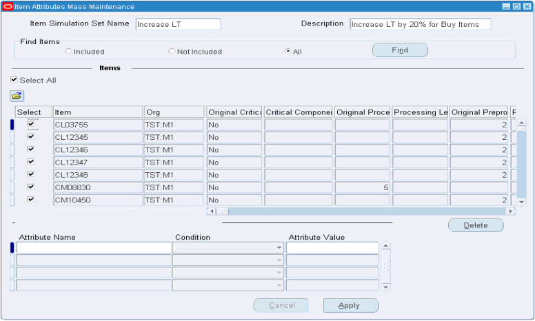

Steps
From the Advanced Supply Chain Planner responsibility, navigate to the Item Attributes Mass Maintenance window.
Setup > Item Attributes Mass Maintenance
The Item Attributes Mass Maintenance window appears.
Define the Simulation Set Name and Description.

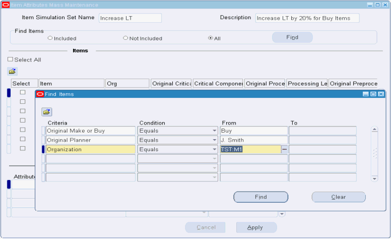

Find relevant items.
Example, using the Find Items - 'Included' radio button:
Item A:
Make/Buy: Make
Planner: J. Smith
Processing LT: 3 days
Item A was previously updated.
Item B:
Make/Buy: Buy
Planner: J. Smith
Processing LT: 2 days
Item C:
Make/Buy: Buy
Planner: J. Smith
Item C was previously updated.
Query criteria:
Make/Buy: Buy
Planner: J. Smith
The 'Included' radio button is selected
Result: the query results return Item C only.
Note: Item B does not qualify since it has not been updated in this simulation set, and Item A does not qualify since it does not meet the query criteria
Use the 'Not included' radio button when finding those items that have not been updated as part of the simulation set. This is useful for adding new items to the simulation set. The results of the query filters out the items that have been updated in this simulation set.
Continuing the previous example, if the query is used in conjunction with the 'Not included' radio button, query results return Item B only.
Note: Item C does not qualify since it has been updated in this simulation set, and Item A does not qualify since it does not meet the query criteria.
Use the 'All' radio button for finding all items regardless of update status. This is useful in situations where a new simulation scenario is being developed and is applicable to all items.
Continuing the previous example, if the query is used in conjunction with the 'All' radio button, query results return Item B and Item C.
Note: Item A does not qualify since it does not meet the query criteria
Define the simulation set. Select the check boxes associated with relevant items.
Modify attributes. The available conditions that can be used to update the Attributes are as follows:
Set value to: set the attribute to a specified value
Increase by value: increase the original attribute by a specified value
Increase by percentage: Increase the original attribute by a specified percentage (%)
Decrease by value: Decrease the original attribute by a specified value
Decrease by percentage: Decrease the original attribute by a specified percentage (%)
Set original value: Reset the attribute back to the original collected value
Repeat the preceding step for all attributes to be modified. Click Apply.
The form updates to show the original and modified values.
Note: The original set of values refer to the collected data, and hence cannot be updated.
Specify the simulation set in the Item Simulation Set field of the Plan Options window.
Note: If the Item Simulation Set field is left blank, then collected data will be used for planning.

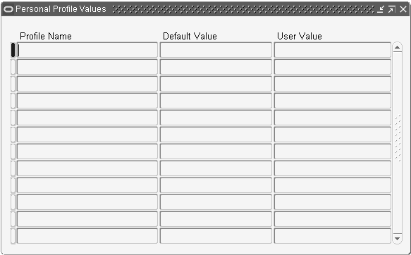

Log on to Oracle Inventory Optimization.
From the Navigator, choose Other > Profile.
The Personal Profile Values window appears.
Use the information in the following table to complete the fields in the Personal Profile Values window.
| Field | Description |
| Profile Name | Select the "MSR:Budget Category Set" profile name from the LOV. |
| User Value | Select the category set from the LOV to which the planned items belong. |
Save your work.

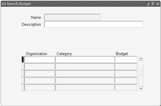

To define the budget at the organization or category level, choose Setup > Specify Budgets.
The Specify Budget window appears.
Use the information in the following table to complete the fields in the Specify Budget window.
| Name | Specify a name for the budget. |
| Description | Specify a description for the budget. |
| Organization | Select the organizations from the LOV for which you want to define the budget. |
| Category | Select the categories from the LOV for which you want to define the budget. |
| Budget | Specify the value for the budget. |

Manufacturing lead time variability for an item is set in the Item Attributes Mass Maintenance window, which is accessed from the Workbench.
Steps
From the Inventory Planner responsibility, navigate to Inventory Planner>Setup>Item Attributes Mass Maintenance.
The Item Attributes Mass Maintenance window opens.
In the Item Simulation Set window, enter the name of the Item Simulation Set.
Click the Item field and select the item from the drop-down menu and click OK. If necessary, enter a partial name in the Find field to locate the item and them click OK.
Click the Org field and select the organization that contains the item from the drop-down menu and click OK. If necessary, enter a partial name in the Find field to locate the organization and them click OK.
Click the Select checkbox to the left of the Item and Org.
In the Item attributes available for update section at the bottom of the window, click the Attribute Name field.
The Item Attributes window opens.
In Item Attributes window, select Manufacturing LT Variability and click OK.
Click the Condition field.
A window opens with a list of all the possible conditions.
Select the desired condition.
Click the Attribute Value field and enter the desired value.
Click Apply.
Save you work.

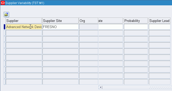

Supplier lead time variability represents the uncertainty in the availability of supplies. You need to set this up for the inventory planning engine to factor in this uncertainty when it calculates the safety stock levels.
You can specify supplier lead time variability either at the item-supplier level or at the supplier level. The inventory planning engine uses the information specified at the supplier level if you have not specified it at the item-supplier level.
Supplier lead time variability is set in the Suppliers window accessed from the Collections Workbench. Supplier variability can be specified either as a discrete distribution or as a percent (%) variance for a normal distribution.
Note: You can specify supplier lead time variability information only in the planning server.
To set supplier lead time variability
Steps
From the Inventory Planner responsibility, navigate to the Collections Workbench.
Inventory Planner > Collections > View Collected Data
The Navigator window opens.
On the Plans tab of the Navigator, select: View by Items.
Drill down to the item for which supplier lead time variability has to be associated.
Note: To assign supplier variability independent of a specific item, select the supplier in the Navigator. If an item does not have supplier-specific variability, the inventory planning engine defaults to the supplier level.
Right click the supplier and select Supplier Variability from the drop-down menu.
The Supplier Variability window appears.
Specify either the normal distribution Supplier Lead Time Variability percent, or use the Dates Late and Probability columns to define a discrete probability distribution representing supplier lead time variability.
Note: Supplier variability prior to Release 12.0 was modeled as a set of discrete probabilities. In the Dates Late and Probability columns, users set up the number of days that the supplier was expected to be late, along with an associated discrete probability for the occurrence. With Release 12.0, the user can specify a percent (%) variance in the Supplier Lead Time Variability column. Users can specify variance using one or the other methods, but not both.
| Fields | Description |
| Supplier | Supplier name |
| Supplier Site | Supplier site name |
| Org | Organization |
| Days Late | The number of days by which the item has been delivered late. You can enter only whole numbers. You can enter a negative whole number to indicate early delivery. |
| Probability | Specify a number between 0 and 1 corresponding to each estimation of days late for the item. The probabilities should sum to 1. |
| Supplier Lead Time Variability | Specify a percentage. See Setting Plan-Level Lead Time Variability Default Values. |
Save your work.

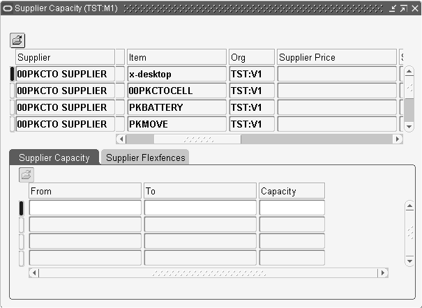

During the collections process, Oracle Inventory Optimization captures the item purchase price by supplier and supplier site by taking the unit price from the most recent purchase order for each item. Oracle Inventory Optimization uses the item purchase price to calculate the purchasing cost for an item. You can view the item purchase price in the Supplier Capacity window. You can navigate to this window from both the Collections Workbench and the Planner Workbench.
To view item price by supplier:
Steps
Navigate to the Collections Workbench (Collections > View Collected Data) or Planner Workbench (Inventory Plan > Workbench).
View by Suppliers.
In the Navigator, drill down and select an item underneath a supplier.
Select Supplier Information from the right-click popup menu. The Supplier Capacity window appears.
Scroll to the right to view the Supplier Price field.
