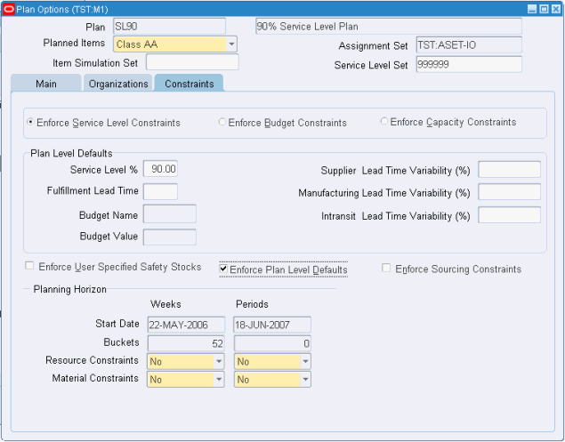

This section describes plan options. The plan options appear in the following tabbed regions of the Plan Options window:
You can access the plan options, via either of the following navigation methods:
From the Navigator select Inventory Plan > Options, or.
From the Navigator select Inventory Plan > Names. From the Plan Names form, select a plan, and then click Plan Options.
This table describes the fields located in the header region of the Plan Options window.

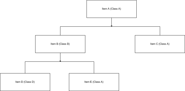

The inventory planner engine may include items that have a classification other than what you specify in the Planned Items field in the Plan Options window. Consider the following illustration that depicts the bill of material for Item A.
Item A belongs to class A. Items B and C are components of item A. Items B and C belong to classes B and A, respectively. Items D and E are components of item B. Items D and E belong to classes C and A, respectively. If you choose to plan for class A items, the inventory planner engine plans for items A, B, C, and E. The inventory planner engine includes item B in the plan because item E, a component of item B, belongs to class A.
Oracle Inventory Optimization calculates safety stock quantities only for those items whose safety stock planning method is set to MRP planned %. Safety stock quantities are not calculated for items whose safety stock planning method is set to Non-MRP planned.

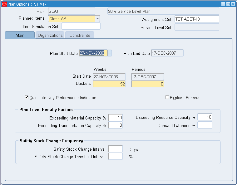

You can specify the plan start and end dates in the Main tabbed region. In addition, you can set various plan level penalty factors and details regarding changes to the safety stock.
Main tabbed region
Penalty factors are plan level values that:
You can override by setting values for organizations and items in the source instance
Override those set in profile options
The following table describes the fields and options in the Main tabbed region:

| Plan Start Date | If you have not run the plan, choose a start date for your plan; the default is beginning of the first planned time bucket. You can even specify a date in the future as your start date. If you have run the plan, this displays the planning horizon start date of the latest run. If you enter a start date in the middle of bucket, the inventory planning engine starts the plan on the first day of the bucket. You cannot change the start date of the plan when you copy one plan to another. For more information, see Plan Start Date in Future. |
| Plan End Date | Calculated planning horizon end date based on your entries in Buckets and the owning organization calendar. |
| Start Date | Calculated start date for each bucket based on your entries in Buckets and the owning organization calendar. The value for the Days column is the Plan Start Date. |
| Buckets | Number of buckets of this bucket type. |
| Display Key Performance Indicators | Select this plan option to instruct the planning engine to calculate key performance indicators for the plan. |
| Explode Forecast | Select this plan option to instruct the planning engine to explode forecasts as follows: - Product family forecasts to item forecasts - Model forecasts to other model, option class, and item forecasts. This option applies to items with forecasts with forecast control Consume and derive. If you clear this plan option, the explosion is assumed to happen in the source instance or in Oracle Demand Planning before the plan run. |
| Exceeding material capacity % | Enter a numerical value to quantify the impact of exceeding material capacity. |
| Exceeding resource capacity % | Enter a numerical value to quantify the impact of exceeding resource capacity. |
| Exceeding transportation capacity % | Enter a numerical value to quantify the impact of exceeding transportation capacity. |
| Demand lateness % | Enter a numerical value to quantify the impact of late demand. |
| Safety Stock Change Interval | Enter the number of days that the inventory planning engine should hold the item safety stock levels constant. It does not recommend a change in safety stock levels during this time but may recommend a change after this time. |
| Safety Stock Change Threshold Interval | Enter the percentage of safety stock change that is significant to your business. When the inventory planning engine calculates a new recommended safety stock level for an item, it checks its percentage difference from the safety stock values of the previous adjacent change interval. If this percentage difference is lower than the this plan option, the inventory planning process does not recommend a change to the safety stock level for the item. |

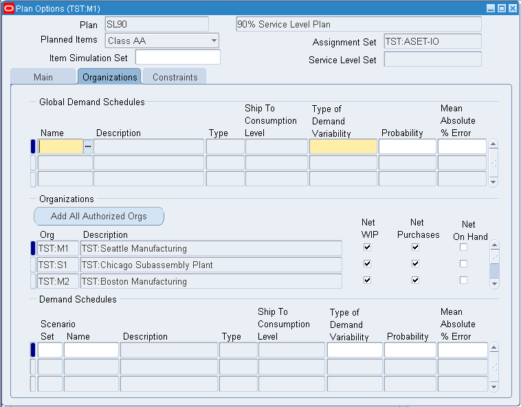

The Organizations tabbed region enables you to specify information including the global demand schedule, type of demand variability that applies to the plan, and the forecast scenario.
Organizations Tabbed Region
The following table describes the fields and options in the Organizations tabbed region:

| Global Demand Schedules | Select the names of Oracle Demand Planning scenarios that drive this plan. For more information on global forecasting, see Oracle Advanced Planning Implementation and User's guide. |
| Type of Demand Variability | Select a demand variability type for the global forecast. Values are:
Note: If you select a value for one forecast in a scenario set, that value applies to all forecasts in that scenario set; you cannot select different variability for the other forecasts in the scenario set. |
| Mean Absolute % Error | If Type of Demand Variability is Mean Absolute % Error, enter your mean absolute percent error (MAPE) of the global forecast. If you enter a value for one forecast in a scenario set, that value applies to all forecasts in that scenario set; you cannot enter different mean absolute percent errors for the other forecasts in the scenario set. ‘ |
| Add All Authorized Orgs | When you click, the form retains the organizations that appear in Org and adds all organizations to which you have organization security (according to your responsibility). If one of your authorized organizations is already listed, the form does not add it a second time. |
| Org | An organization for which this plan is intended. |
| Description | The name of the organization. |
| Net WIP | Select to consider discrete jobs and other production orders as supply in the planning demand/supply netting process. Only firm supplies are considered. |
| Net Purchases | Select to consider purchase orders, purchase requisitions, in-transit shipments and other non production order scheduled receipts as supply in the planning demand/supply netting process. Only firm supplies are considered. |
| Net On Hand | Select to consider on-hand inventory in the netting process. |
| Demand Schedules | Select the names of forecasts and Oracle Demand Planning scenarios that drive this plan. |
| Scenario Set | Enter the identifier for the scenario set with which the forecast is associated. See Setting Demand Variability. |
| Probability | If Type of Demand Variability is Probability, enter your confidence in the local forecast. For 35% confidence, enter 35. If you enter a value for one forecast in a scenario set, that value applies to all forecasts in that scenario set; you cannot enter different probabilities for the other forecasts in the scenario set. |

Demand Schedules
You can specify a forecast set or a demand planning scenario as input demand for an inventory plan.
To specify sources of demand
Steps
Navigate to the Planner Workbench.
Choose Plan Options > Organization tab.
Select the demand schedule (Forecast or demand planning scenario) from the list of values.
You can specify constraints and information regarding the planning horizon in the Constraints tabbed region. Constraint-based planning is an approach for balancing material, budget and plant resources while meeting service levels. It takes into account constraints at the enterprise and plant levels. Material, resources, capacity, or budget constraints are considered. Factory, distribution, and transportation issues are integrated. This complete picture of the problem provides instant and global visibility to the effects of planning and scheduling decisions throughout the supply chain.
This table describes the fields and options in the Constraints tabbed region.
| Object | Description |
| Enforce Service Level Constraints | Select to enforce the service levels specified at the most detailed level. The inventory planning engine exceeds the material, budget, and resource available capacity if needed. |
| Enforce Budget Constraints | Select this plan option to use a budget amount as a constraint on inventory investment. |
| Enforce Capacity Constraints | Select if you want material and resource capacity constraints to be respected. |
| Service Level % | If you select Enforce Service Level Constraints, enter the service level that you want the inventory optimization planning process to use as the service level requirements for all parts in the plan |
| Fulfillment Lead Time | Fulfillment Lead Time is models the time between taking an order and receipt of goods by the customer. |
| Budget Name | If you select Enforce Budget Constraints, select the name of the budget that you want the inventory optimization planning process to use as the budget constraint. Alternatively, you can leave this field empty if you want to specify the plan option Budget Value. |
| Budget Value | If you select Enforce Budget Constraints, enter a value for the inventory optimization planning process to use as the budget constraint. Do not enter this plan option if you select a value for plan option Budget Name. |
| Supplier Lead Time Variability (%) | This is the plan level default value for supplier lead time variability, in percent. See Setting Plan-Level Lead Time Variability Default Values. |
| Manufacturing Lead Time Variability (%) | This is the plan level default value for manufacturing lead time variability, in percent. See Setting Plan-Level Lead Time Variability Default Values. |
| In-transit Lead Time Variability (%) | This is the plan level default value for in-transit lead time variability, in percent. See Setting Plan-Level Lead Time Variability Default Values. |
| Enforce User Specified Safety Stocks | Select this plan option to enforce any safety stock levels that you define as a constraint on inventory stocking levels. |
| Enforce Plan Level Defaults | Select this check box to force the system to use only the plan level default values and ignore any other settings of service levels and fulfillment times. See Setting Plan-Level Default Values. |
| Enforce Sourcing Constraints | Select if you want to enforce the sourcing splits in the item sourcing rules. The inventory planning engine violates sourcing constraints if enforcing them puts the plan constraint (service level, budget, or capacity) at risk. |
| Start Date | Displays the start date for each bucket type. |
| Buckets | Displays the number of buckets of this bucket type. |
| Resource Constraints | Select Yes to consider resource constraints. |
| Material Constraints | Select Yes to consider material constraints. |
You can select one of the following three constraint options:

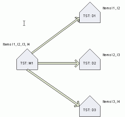

The supply chain is as shown below.
The order of profitability is:
For Items: I1 > I2 > I3 > I4
For Organizations: D1 > D2 > D3
The target safety stock quantities are 1 unit for all Item-Organizations.
The standard cost is $1 for all Items at all the Organizations
The sorted list of order of profitability for the Item-Organizations is:
I1 at TST:D1
I2 at TST:D1
I2 at TST:D2
I3 at TST:D2
I3 at TST:D3
I4 at TST:D3
Example 1: Plan Level Budget = $8
Based on the above sort order, I1 at TST:D1 and I2 at TST:D1 get $2 while all other item-organizations get $1.
Example 2: Plan Level Budget = $4
Given the sort order, I3 at TST:D3 and I4 at TST:D4 do not get any allocation while all other item-organizations get $1.
Example 3: Budget specified at Organization Level. TST:D1 = $5; TST:D2 = $1
At organization TST:D1, I1 will get $3 and I2 will get $2
At organization TST:D2, I2 will get $1 and I3 will get nothing
Example 4: Plan Level Budget = $3; User Specified SS for Item I3 at TST:D3 is 3 units
Allocate $1 to I1 at TST:D1, I2 at TST:D1, and I2 at TST:D2
Allocate $3 to I3 at TST:D3
All other Item-Organization get zero allocation
