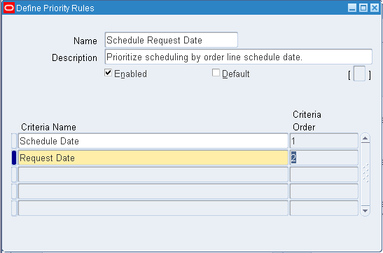

As a prerequisite, you must define at least one sequencing (priority) Rule before you use the Order Backlog Workbench. The terms sequencing rule and priority rule are used interchangeably.
Oracle Advanced Planning Solution uses priority rules to determine the processing order used when scheduling orders through the scheduler. You can:
Define a default scheduling order processing priority rule.
Disable a priority rule.
Define single or multiple criteria within a priority rule to further define the processing order that the scheduler uses during line scheduling.
Priority rules are not instance-specific. They are defined by selecting specific criteria that determine the order input to the scheduler.
Note: At least one priority rule must be defined prior to utilizing the Order Backlog Workbench for scheduling.
Navigate to the Define Priority Rules window.
Enter a Name for the priority rule.
Enter a Description for the priority rule.
Select the Enabled checkbox to enable the priority rule to be used by the scheduler.
Choose whether the priority rule will be used as the default priority rule when the schedule is executed.
Select the Default checkbox to use the priority rule as the default rule.
Note: If another priority rule was defined as the default priority rule and you select the Default check box, you will see a decision box asking if you want to update the current default priority rule to the rule you are currently modifying. Select Yes to update your default priority rule.
Select the criteria name of the priority rule in the Criteria Name field. Values are:
Promise Date
Request Date
Sales Order and MDS Entities priority
Scheduled Date
Select the criteria processing order that the scheduler will use when scheduling order lines. Enter a numeric value in the Criteria Priority field.
Save your work.
