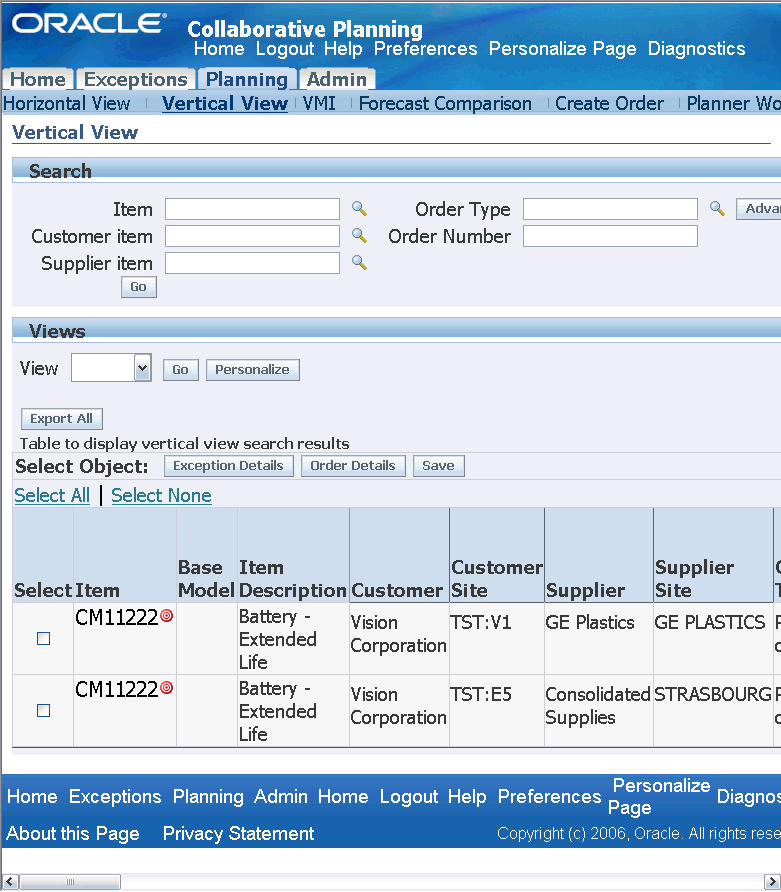

The Search Region
You can find an item or order in the Search region of the Vertical View screen. Complete the following steps to search for an item or order:
  1. From the Home page of Oracle Collaborative Planning, select the Planning tab.
  2. On the Planning page, select Vertical View.
    Note: Alternatively, you can select Vertical View under the Planning category in the right hand list on the Collaborative Planning Home page.

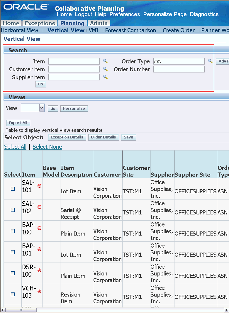

  3. In the Search region, enter your search criteria and select Go.
    The following image shows the Search region in the Vertical View and the search results for an order type of ASN.
    The Search Region in the Vertical View Screen

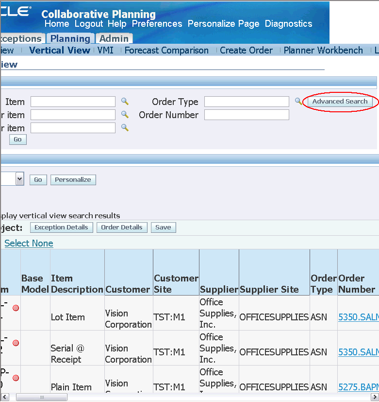

  3. Select Advanced Search.
    The following image shows the Advanced Search button in the Vertical View screen:
    The Advanced Search Button in the Vertical View Screen
    the picture is described in the document text

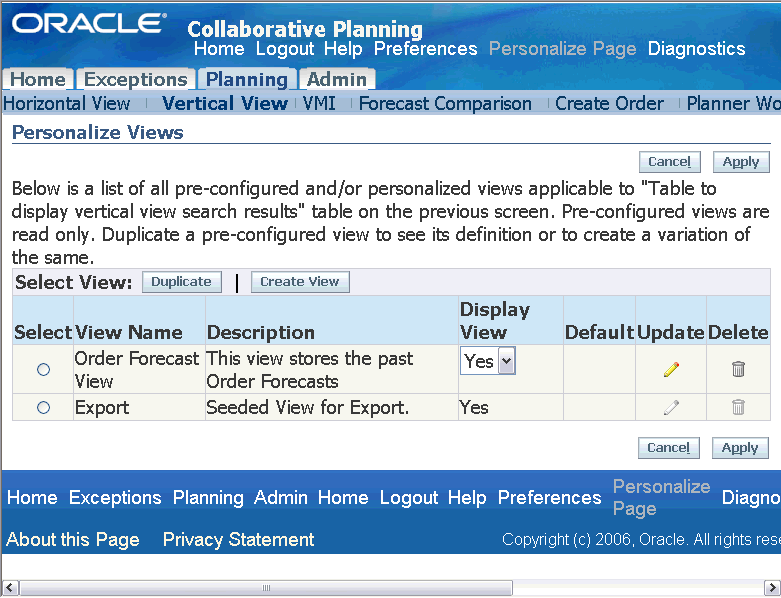

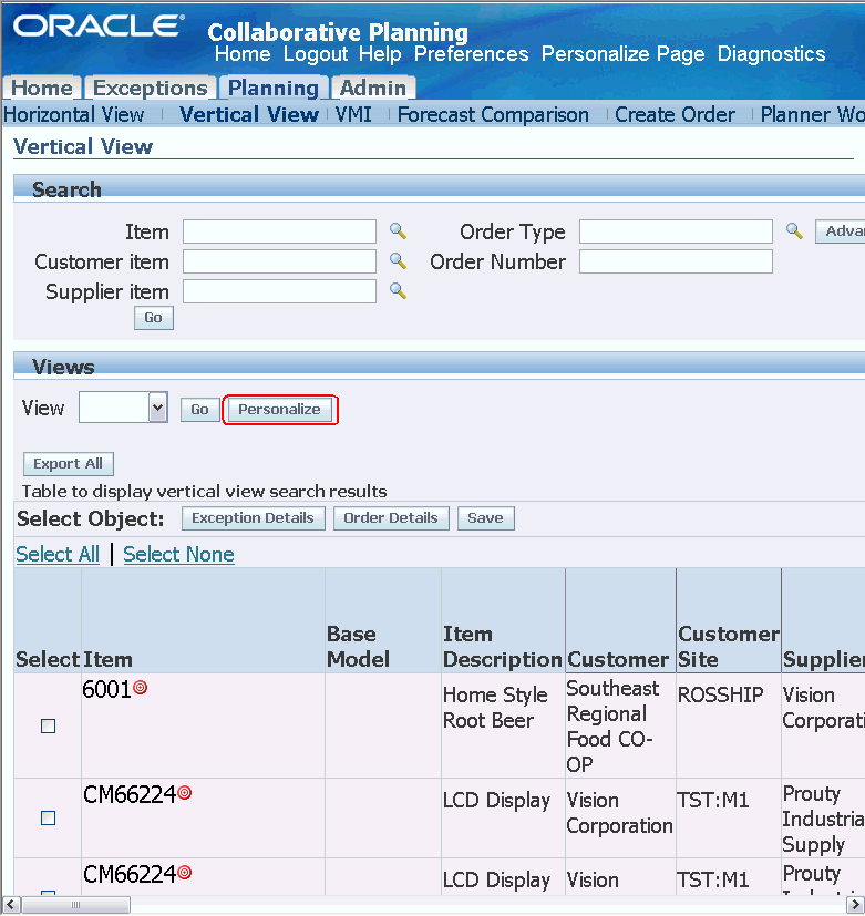

  4. In the Vertical View screen, select Personalize. The following image shows the Personalize button in the Vertical View screen:
    The Personalize Button in the Vertical View Screen
  5. In the Personalize Views screen, select the personalized view that you want to save the search results in, and select Apply. The following image shows the Personalize Views screen:
    The Personalize Views Screen

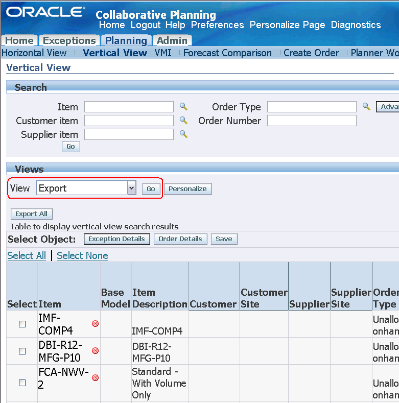

  2. Display the results using the seeded Export view: Oracle Collaborative Planning provides a system-defined data view called Export that arranges the data to be exported in the appropriate column format. The following example depicts the Export view on the Vertical View screen:
    Export View on the Vertical View Screen
    Select Export from the list in the View field, and select Go to view the records that are saved in the Export folder.

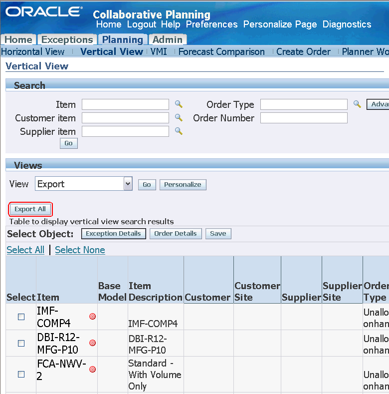

  3. Export the records and save locally:
    1. Select the Export All button on the Vertical View screen.
      The Export All Button on the Vertical View Screen

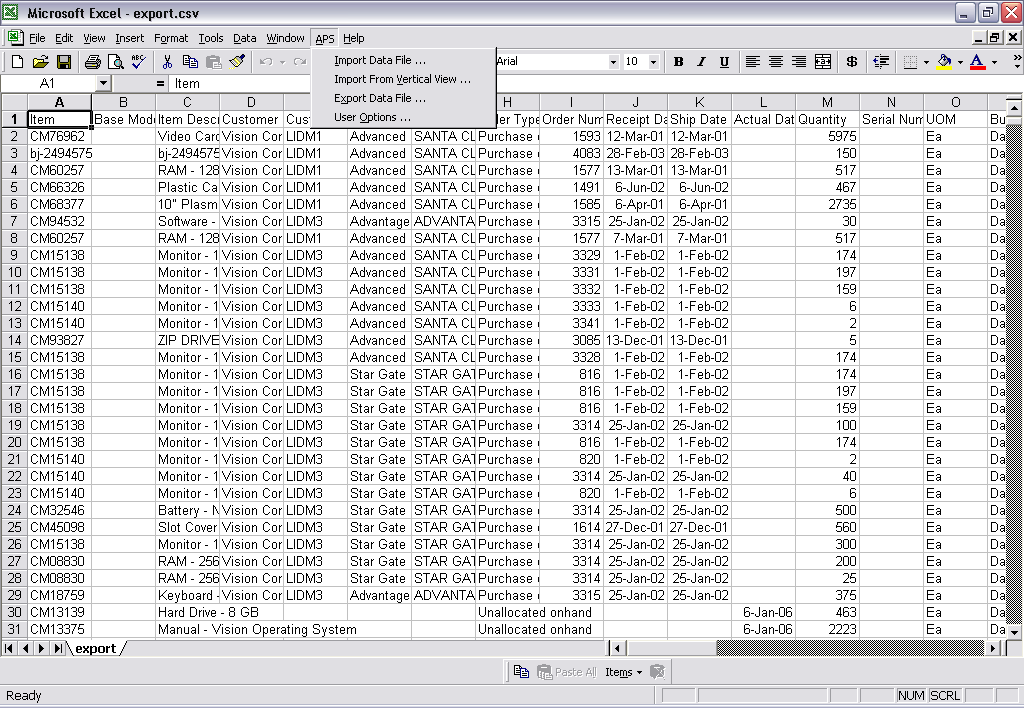

  4. Import the file into Microsoft Excel:
    1. Open the ExcelLoad.xlt template using Microsoft Excel. When prompted, select Enable Macros.
    2. Select the Import From Vertical View option from the APS menu and open the locally saved .csv file. The following example depicts an imported .csv file and the APS menu:
      The export.csv File and the APS Menu
      The APS menu provides the following options for importing supply and demand information in the ExcelLoad.xlt template:
      • Import Data File: If you are loading flat-file data into Collaborative Planning and not modifying data that is exported from Collaborative Planning, you can use this option to open a .dat file for modification. You can also use this option if you need to modify or enter the supply and demand records that are saved in .dat format.
      • Import From Vertical View: Use this option to open a .csv file that has been exported from the CP vertical view.
