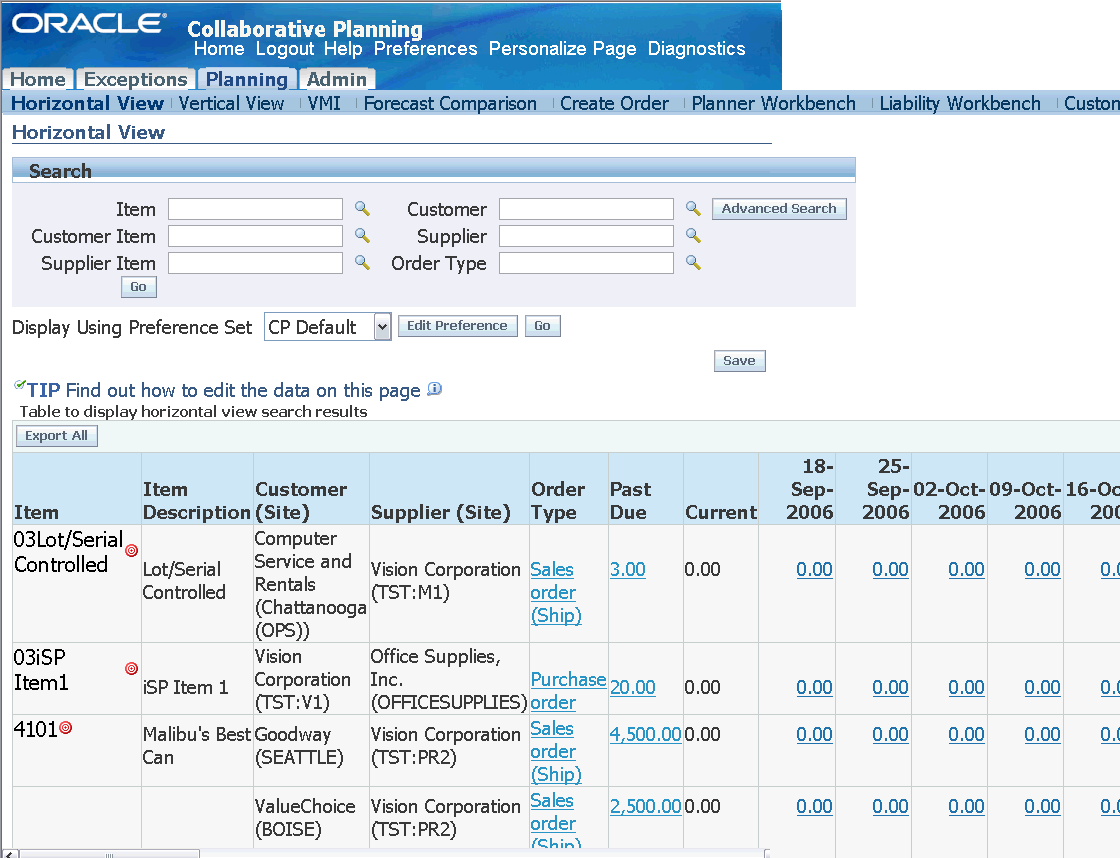

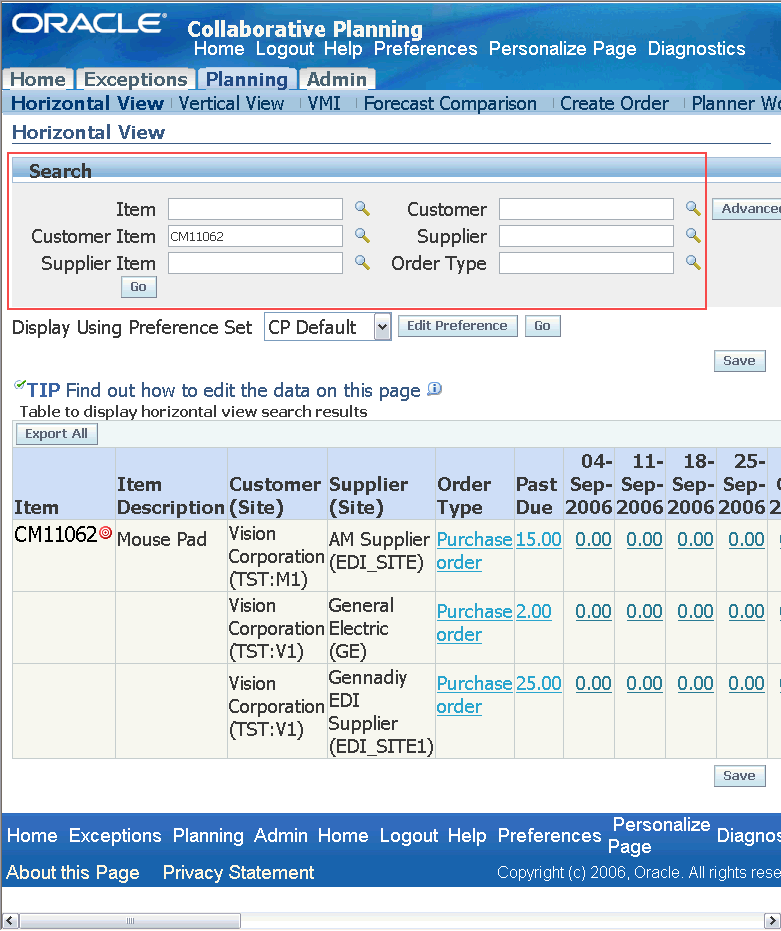

The seeded horizontal view enables you to view supply and demand information over time. In order to use the horizontal view, you must create a preference set.
You can find a customer, supplier, item, or order in the Search region of the Horizontal View screen. Complete the following steps to filter records based on search criteria:
From the Home page of Oracle Collaborative Planning, select the Planning tab.
On the Planning page, select Horizontal View. Alternatively, you can select Horizontal View under the Planning category in the right-hand list on the Collaborative Planning Home page.
In the Search region, enter your search criteria and select Go.
The following example depicts the Search region in the Horizontal View and the search results for the customer item CM11062.
The Horizontal View Screen

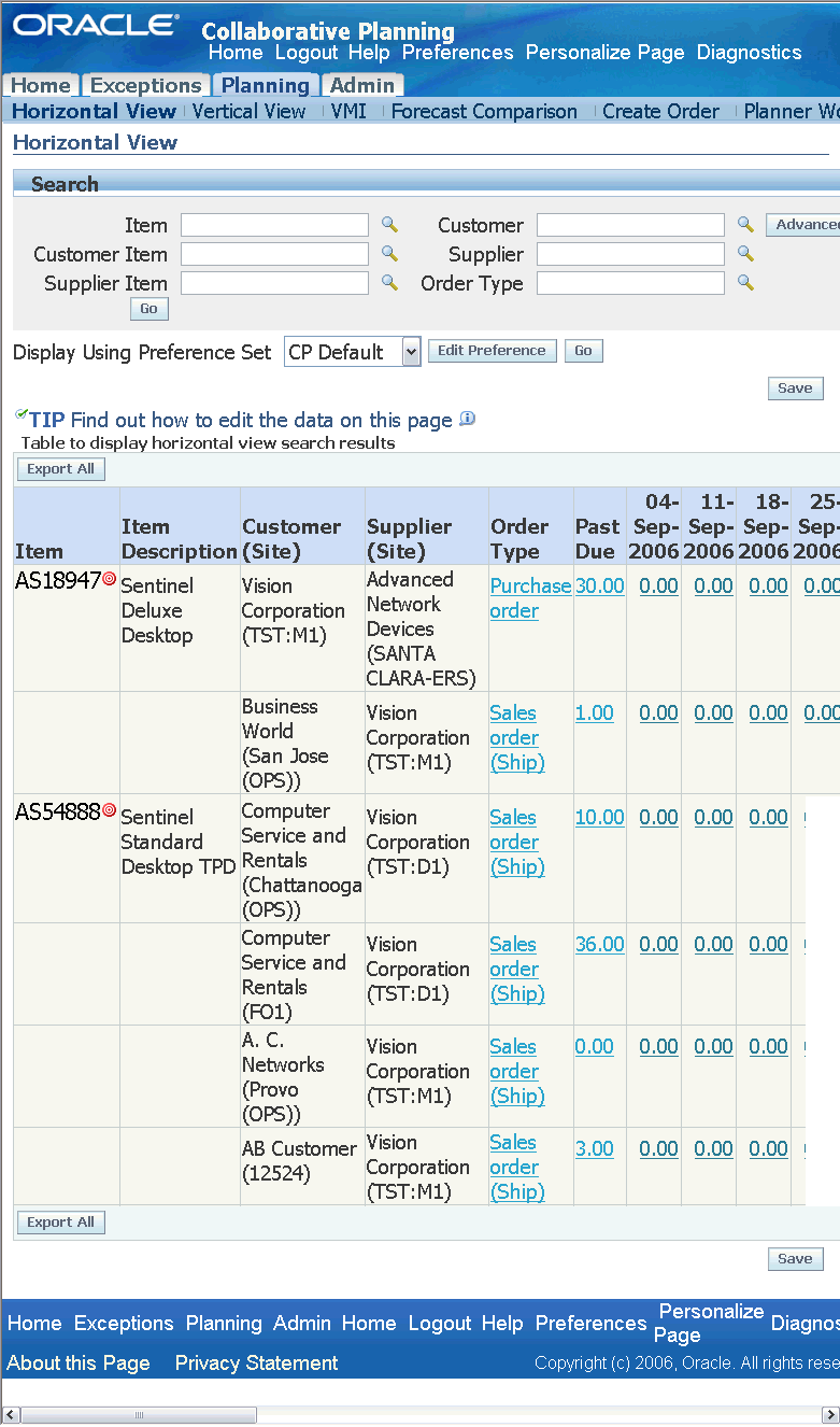

There are several columns displayed using horizontal view. The following table lists those columns and their descriptions:
| Column | Description |
| Items | Items are set up using Oracle Inventory. For more information about item setup, refer to Setup. |
| Customer (Sites) | For more information about customer and customer site setup, refer to Setup. |
| Supplier (Sites) | For more information about supplier and supplier site setup, refer to Setup. |
| Order Type | For more information about supported order types in Oracle Collaborative Planning, refer to Setup. |
| Net Forecast | A calculated column that displays when Display Net Forecast and Total Supply Commit is checked. Net forecast in a bucket = [Order forecast - (PO + Requisitions + ASNs] in a bucket. |
| Total Supply Commit | A calculated column that displays when Display Net Forecast and Total Supply Commit is checked. Net forecast in a bucket = [Supply commit + sales orders)] in a bucket. |

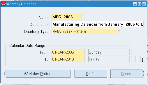

Create a workday calendar in the Workday Calendar window. Use the following navigation path to open the Workday Calendar window:
Navigator > Bills Of Materials > Setup > Calendars
Workday Calendar Window
The default system calendar acquires the following attributes from the selected calendar:
The start day of a week and month period: Derived from the start date of the calendar.
The quarterly type: The quarterly type can have the following periodic divisions indicating the number of weeks in the first, second, and third months of a quarter:
4/4/5 week pattern for a quarter
5/4/4 week pattern for a quarter
Calendar months in a year
13 periods in a year
For more information on creating workday calendars, see "Creating a Workday Calendar" in Oracle Bills of Material User's Guide.

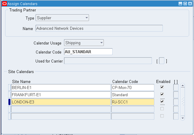

Note: You can also access workday calendars through Oracle Order Management. Use the following navigation path to open the Workday Calendar window: Navigator > Order Management > Setup > Shipping > Calendars > Enter
Select the role of the trading partner (Supplier, Customer, Organization, or Carrier) and assign the workday calendar to the trading partner in the Assign Calendars window. Use the following navigation path to open the Assign Calendars window:
Navigator > Order Management > Setup > Shipping > Calendars > Assign
Assign Calendars Window
Note that a calendar must be created and defined in the Oracle Bills of Material (BOM) or Oracle Order Management application as a Workday calendar before it can be assigned to a shipper, receiver, or carrier. If the receiving calendar is not defined, the delivery calendar, manufacturing calendar, or the shipping calendar of the supplier site or the supplier organization is used. If none of these calendars is available, Collaborative Planning uses the default system calendar.
For more information on assigning calendars to trading partners, see "Defining Transportation Calendars" in Oracle Order Management Implementation Manual.

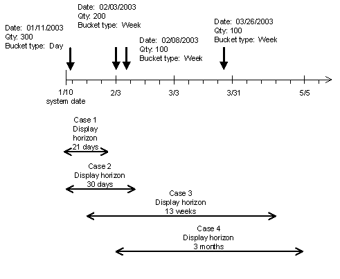

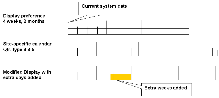

You can specify a time horizon to display order information in Horizontal View preference sets. You can specify a single time bucket such as day or a combination of multiple time buckets. For more information on creating preference sets, see "Preference Sets."
The start day of a site-specific week and a site-specific month are always the same. Unlike a manufacturing calendar, the start day on a site-specific calendar does not consider a working day or non-working day specification.
The trading partners can post orders specifying a calendar date and a bucket type along with other information through the Sales Orders window. For more information on posting orders, see "Order Entry" in Oracle Order Management User's Guide. Oracle Collaborative Planning groups these order records in the following way by obeying the site-specific calendar of the trading partner:
The trading partners specify a time range on orders posted to the system through the Create Order page or by uploading a flat file. For more information on the Create Order page, see "Add to Order and Add To Quote Capability" in Oracle Order Management User's Guide.
The planning engine determines the start date from the order's key date, such as Ship date and Receipt date.
Planners populate the Ship date or the Receipt date based on the order type, and enter an end date while posting the order in the Sales Order window.
Bucket type: Day
System creates a record on each day beginning on the start date and ending on the end date.
Bucket type: Week
System creates one record for each week on the same weekday (Sunday through Saturday) across consecutive weeks that include the start date and end date.
Bucket type: Month
System creates one record for each month on the same day of the month across consecutive months that include the start date and end date.
The system stores the order at the daily, weekly, or monthly level, depending on the following bucket types:

As different customer sites may use different site-specific calendars, the system may find data for two sites with different site-specific definitions while retrieving information based on a query. In this situation, a single customer site displays against the Collaborative Planning default system calendar instead of against the customer site's calendar. The following example explains this situation.
| Calendar Type | Quarterly Pattern | Week/Month Start Day | |
| Collaborative Planning system | Default calendar | (4-4-5) | Monday |
| Customer site 1 | Receiving calendar | (5-4-4) | Monday |
| Customer site 2 | Receiving calendar | (4-4-5) | Monday |
| Calendar Entries | Start Date | End Date | ||
| Collaborative Planning system | Default calendar | Period 1 | 6-Jan-03 | 2-Feb-03 |
| Collaborative Planning system | Default calendar | Period 2 | 3-Feb-03 | 2-Mar-03 |
| Customer site 1 | Receiving calendar | Period 1 | 30-Dec-02 | 2-Feb-03 |
| Customer site 1 | Receiving calendar | Period 2 | 3-Feb-03 | 2-Mar-03 |
| Customer site 2 | Receiving calendar | Period 1 | 6-Jan-03 | 2-Feb-03 |
| Customer site 2 | Receiving calendar | Period 2 | 3-Feb-03 | 2-Mar-03 |
| Record Number | Customer Site | Date | Quantity |
| Record 1 | Customer site 1 | 6-Jan-03 | 100 |
| Record 2 | Customer site 1 | 2-Feb-03 | 100 |
| Record 3 | Customer site 2 | 1-Jan-03 | 25 |
We assume that the system date is 7-Jan-03 with the following user preference:
| Days | Weeks | Months | |
| User preference set | 0 | 0 | 2 |
The Collaborative Planning Horizontal View retrieves transaction data for a time horizon of two months. It uses the start and end dates of the default system calendar. The default system calendar periods are as follows:
| Calendar Type | Calendar Entries | Start Date | End Date |
The Horizontal View retrieves the following records:
The Horizontal View finds only one customer site and tries to render the data against the customer site's receiving calendar, which has start and end dates as follows:
| Customer site | Calendar Type | Period | Start Date | End Date |
The Horizontal View then uses the start and end dates of the receiving calendar to query and parse the data. Using the start and end dates of the receiving calendar of customer site 1, the Horizontal View then retrieves the following records:
| Record Number | Customer site | Date |
Since two customer sites exist, the Horizontal View resolves the calendar conflict by selecting the default system calendar to display data, yielding the following information:
| Customer site | Date | Quantity |
| 2-Feb-03 | 100 |
No data is displayed for customer site 2.
To understand the transition better, consider the following example, which is illustrated by this diagram:
Assume that you have the following time bucketing preferences:
Week start day: Monday.
Current system date: 31-Jan-2004, Saturday.
Your display preference: 8 days, 2 weeks, 0 months.
In this situation, the last day bucket falls on Sunday, 8-Feb-2004. Therefore, the two weekly buckets will start from 9-Feb-2004, and 16-Feb-2004 both on Monday. No adjustment is required in this case.
If you want to look at the same data after two days, when the system date is 2-Feb-2004, Tuesday, the last day bucket will fall on 10-Feb-2004, Tuesday.
The weekly bucket should start from the following day, 11-Feb-2004, or Wednesday. But it is middle of the week. In this case, more day buckets will be added to complete the week and the two weekly buckets will start from 16-Feb-2004, and 23-Feb-2004 (both are Mondays), respectively.
The final bucket pattern in the display will be:
2-Feb-2004 (Tuesday) to 10-Feb-2004: Bucket type= Day as per your display preference.
11-Feb-2004 (Wednesday) to 15-Feb-2004: Bucket type = Day, extra 4 Day buckets added to complete the week.
16-Feb-2004 (Monday) to 29-Feb-2004: Bucket type = Week, as per your display preference.
Similarly, if there is a transition from day to month, (such as in display preference of 8 Days - 0 Weeks - 2 Months), and the last day bucket falls on the middle of the selected calendar's month, extra days will be added to complete the month.
Similarly, for transitioning weekly buckets to monthly buckets, if the last week bucket falls in middle of a month period as defined in the selected calendar, then extra weeks will be added to the complete the month. For example, if the end of 4 weeks (in 0day-4week-2month preference set) falls on 21-Mar-2004 and next month starts from 29-Mar-2004, a week will be added till the end of the month, making your display 0day-5week-2months. The following diagram illustrates this example:
In Horizontal View, start date of the week and month are derived according to the calendar used. The correct calendar is selected based upon the following calendar hierarchy.
When the first bucket displayed in the view is specified as Day, the system does not make any adjustments and uses the current system date as the start day in the Horizontal View.
When the first bucket displayed in the view is specified as Week, the system adjusts the view to the first day of the current week derived from the selected calendar.
When the first bucket displayed in the view is specified as Month, the system adjusts the view to the first day of the current month derived from the selected calendar.
Consider an example for which you have selected the month to start from 9-Sep-2006 in the selected calendar based upon the quarterly settings. If the order's demand date in a monthly bucket is 14-Sep-2006, it will be adjusted to 5-Sep-2006, instead of 1-Sep-2006. The following image shows how the Start Day is adjusted to the first day of the week and month using the correct calendar:
However, for new records, the system populates the ship date or receipt date based on the trading partner responsible for arranging the transport, considers this date as the bucket start date, and uses it for order bucketing.
To convey the date used for order bucketing, the Horizontal View displays the Request Date type (Ship or Arrival) in the order type column after the order type. The following order types are classified based on Request Date type:
Purchase order
Sales order
Order forecast
Supply commit
Note that this display rule applies only to outbound transactions (transactions between the owner of Collaborative Planning and the owner's customers). It does not apply to transactions between the owner and the owner's suppliers. Any purchase order issued by the Collaborative Planning owner to its supplier would not have the Ship or Arrival designation. Only purchase orders issued by the customer to the owner of Collaborative Planning and posted to Collaborative Planning by the customer would show the Ship and Arrival designations. For more information about the order bucketing procedure, see "Support time aggregation on orders posted to Oracle Collaborative Planning."
The Horizontal View aggregates orders and display data according to a site-specific calendar definition. However, planners may define one or more calendars for different business needs. In addition, a supply/demand statement always involves more than one trading partner. The system may have to select a calendar from multiple calendars representing different trading partners' sites. To select the calendar for the Horizontal View, the Collaborative Planning system uses the following conventions.
The receiving calendar of the OEM's organization is used to display the data.
The Horizontal View determines the start and end dates of the time buckets based on the calendar entries found on this calendar.
In the absence of the receiving calendar, the system uses either the manufacturing calendar of the OEM organization or the default system calendar.
The receiving calendar of the customer's site is used to display the data.
The Horizontal View determines the start and end dates of the time buckets based on the calendar entries found on the receiving calendar of the customer's site.
In the absence of this calendar, the system uses the shipping calendar of the supplier's site (OEM's organization), the manufacturing calendar of the supplier's site, or the default system calendar.
In the absence of this calendar, the system uses the delivery calendar of the supplier's site or the default system calendar.
When two or more receiving calendars are involved, the system uses the default system calendar to display data.

| Date | Order type | Quantity | Bucket |
| 01/11/2003 | Order forecast | 300 | Day |
| 02/03/2003 | Order forecast | 200 | Week |
| 02/08/2003 | Order forecast | 100 | Week |
| 03/26/2003 | Order forecast | 100 | Week |
The following diagram shows the four scenarios with varying display preferences and a common set of data posted to the system. Depending upon the start date of the Horizontal View and the display settings in your preference set, you can edit the data. Each scenario represents an independent query initiated from the Horizontal View.
In cases 1 and 3, you can edit data in the Horizontal View. In cases 2 and 4, you cannot edit data. The following table explains the reasons. Note that in all four cases a single time bucket is used to display data either days, weeks, or months.
| Case | System date | Start date of Horizontal View | Display buckets | Edit data in Horizontal View? |
| 1 | 1/10/2003 | 1/10/2003 | 14 days | Yes. Data posted at daily level. Display buckets at daily level. |
| 2 | 1/10/2003 | 1/10/2003 | 30 days | No. Data posted at daily and weekly levels. Display buckets at daily level |
| 3 | 1/10/2003 | 1/20/2003 | 13 weeks | Yes. Data posted at weekly level. Display buckets at weekly level. |
| 4 | 1/10/2003 | 2/3/2003 | 3 months | No. Data posted at weekly level. Display buckets at monthly level |
In case 3 you can see a quantity of 300 in the weekly bucket beginning on February 3. There are two orders with quantities of 200 and 100 each. If the quantity of 300 is changed to 500 the system will make the following changes after you submit the data:
| Date | Order type | Old Quantity | New Quantity | Bucket |
| 02/03/2003 | Order forecast | 200 | 200 | Week |
| 02/08/2003 | Order forecast | 100 | 300 | Week |
| 02/03/2003 | Total for week | 300 | 500 |
The system sorts the records in the buckets in ascending order by quantity. If you edit the quantity in the bucket, the first record or the record with the smallest quantity is adjusted.
If the quantity of 500 is subsequently changed to 100, the system will make the following changes after you submit the data:
| 02/03/2003 | Order forecast | 200 | 0 | Week |
| 02/08/2003 | Order forecast | 300 | 100 | Week |
| 02/03/2003 | Total for week | 500 | 100 |
The record with the smallest quantity was decremented until it reached zero. The next record was decremented until the total amount deducted from the weekly quantity came to 400.
