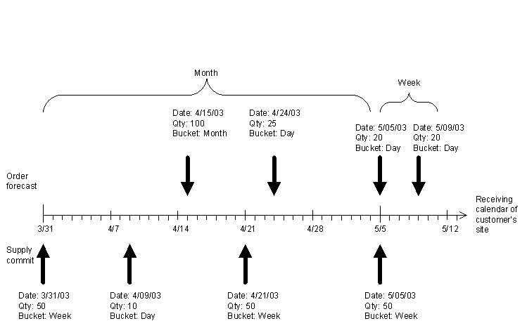

A forecast mismatch exception is a discrepancy between you and your trading partner's forecast. Forecast mismatch exceptions pertain mostly to the horizontal or bucketed view.
Note that the planning engine uses a site-specific calendar to compute exceptions for mismatches in supplies and demands. The start and end dates for the time buckets are determined from the time horizon specified by the planner. Primarily, the planning engine applies the receiving calendar of the customer's site to compute exceptions and buckets supply/demand data and compares them for generating exceptions. In the absence of this calendar, the system applies other site-specific calendars. For more information about determining the site-specific calendar used for comparing forecasts, see "Horizontal View Displays Orders Based on Site-Specific Calendar."
You can plan your operations with varying time buckets and post your data accordingly to the Collaborative Planning system. The system generates exceptions in accordance with the data while referencing a site-specific calendar. The following example describes a situation in which the user enters supply and demand data with multiple bucket types (day, week, month) across a range of time.
The following records are posted to the system:
| Date | Order type | Quantity | Bucket |
| 3/31/2003 | Supply commit | 50 | Week |
| 4/9/2003 | Supply commit | 10 | Day |
| 4/15/2003 | Order forecast | 100 | Month |
| 4/21/2003 | Supply commit | 50 | Week |
| 4/24/2003 | Order forecast | 25 | Day |
| 5/5/2003 | Order forecast | 20 | Day |
| 5/5/2003 | Supply commit | 50 | Week |
| 5/9/2003 | Order forecast | 20 | Day |
1. The system first sorts the records and orders them by date against the receiving calendar of the customer's site that receives the material.
To find mismatches in supply and demand, the system compares the time buckets used in the order forecasts published to the suppliers (demand data) with the time buckets used in the supply commits received from the suppliers (supply data).
The system then adopts the higher of the two buckets and rolls up the data in the supply/demand statement with the lower time bucket.
The Collaborative Planning exception engine then compares the data for both the statements and reports the mismatches.
The following image illustrates this scenario:
Data Bucketing for Comparison and Exception Computation
The system generates the following exceptions:
| Exception Details | |
| Start date | 3/31/2003 |
| End date | 5/4/2003 |
| Total demand | 125 |
| Total supply | 110 |
| Exception details | |
| Start date | 5/5/2003 |
| End date | 5/11/2003 |
| Total demand | 40 |
| Total supply | 50 |
