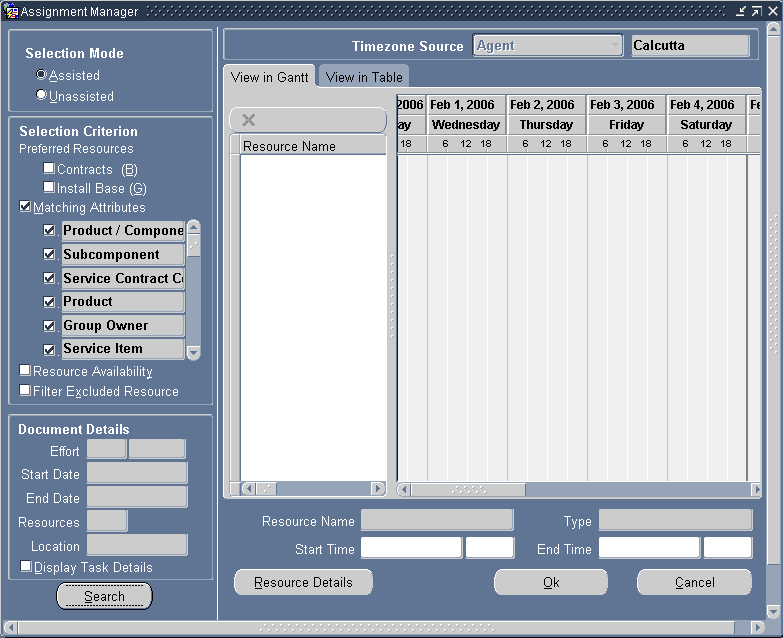

This section describes modules that require proper configuration to ensure that the Assignment Manager selection criteria functions completely when called by these modules. Assignment Manager performs an autoquery whenever it is opened from a calling module. Assignment Manager also generates specific error messages when it encounters any problems performing a search. If no error occurs and no resources are found based on the search criteria, Assignment Manager displays error messages stacked from the API.
Territory Manager retrieves qualified resources specified in territories. Make sure that matching attributes are set up correctly and qualified resources are specified when defining territories. Territories should be set up properly in order to use the assisted assignment option.
Forms-based Resource Schedule displays the work shift information of qualified resources. Resources' shift schedules should be defined in the Forms-based Resource Schedule module in order to use the resource availability for the assisted assignment option.
Note: Log in with the CRM Administrator responsibility and select Calendar > Calendar Setup to access the calendar setup windows.
A service request designates a resource as Web available or unavailable. It assigns the resource Web availability by using the Territory Assisted assignment option.
Oracle Contracts specify preferred engineers defined in Contracts. This component enables the use of Contracts preferred resources in the Assisted assignment option.
Installed Base specifies preferred resources defined in Installed Base. This component enables the use of Installed Base preferred resources in the Assisted assignment option.
Assignment Manager displays a resource's tasks for a specified time period in the Gantt chart. The time period for each task is color coded according to a set of rules stored in the color configuration table. Each row in this table contains rules for unique color values. Assignment Manager accesses a Task Manager table with seeded color values that can be retained in their original state or modified. You can also configure additional color values. When Assignment Manger obtains the list of tasks to display for a resource, the Assignment Manager engine calls the Tasks public API: JTF_TASK_CUSTOM_COLORS_PUB.GET_TASK_BGCOLORS. The API receives information about the task, task type, assignment status, and priority, and returns the background color value for each record in decimal format. The Assignment Manger UI interprets the color's decimal value and displays it in standard color format.
The attributes that determine a task color can be registered with those of the currently displayed color in the color configuration table. The following table contains the color configuration table columns and their corresponding attributes:

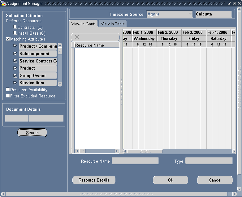

The Assignment Manager UI can be customized to better suit the requirements of the applications with which it is integrated. These applications, which include Tasks, Depot Repair Tasks, Service Requests as well as Service Request Tasks, and Escalations, generally require a limited subset of the total fields and options available in the Assignment Manager UI. Assignment Manager renders the UI based on seeded data in the table JTF_AM_SCREEN_SETUPS_B. When implementing Assignment Manager, you can customize its UI by modifying data in this table.
The following table describes JTF_AM_SCREEN_SETUPS_B including Who columns and flex field columns. Columns directly related to modifying the Assignment Manager UI are indicated accordingly:
| Column Name | Data Type | Not Null | Default | Description |
| SCREEN_SETUP_ID | Number | N | N | UI Related. Specifies the unique ID for the table. |
| DOCUMENT_TYPE | Varchar2(30) | N | N | UI Related. Specifies the document from which Assignment Manager is called, such as SR (Service Request). This will be unique for the table. |
| MODE_ASSIST | Varchar2(1) | N | Y | UI Related. Determines whether or not the UI displays the Assisted mode radio button. Valid values are Y/N. |

This section provides examples of customizing the Assignment Manager UI for different calling documents.
When the calling document is a Service Request, the default Assignment Manager UI includes the Assisted Mode and Unassisted Mode radio buttons, the Start Time and End Time fields, as well as the default Document Details fields.
Default Service Request Screen
Since the Assisted Mode and Unassisted Mode radio buttons, the Start Time and End Time fields, are not required by the Service Request application, you can modify the table JTF_AM_SCREEN_SETUPS_B to render the Assignment Manager UI without these features. You can also modify the Document Details section with your own custom fields. The following SQL script customizes the Assignment Manager UI in this manner:
UPDATE jtf_am_screen_setups_b
SET mode_unassist = 'N'
,doc_dtls_user_values = 'Y'
,show_selected_time = 'N'
,last_updated_by = 123 -- userid of user who is updating
,last_update_date = SYSDATE
,object_version_number= object_version_number + 1
WHERE document_type = 'SR'
Customized Service Request Screen

The Assignment Manager self-testing framework provides relevant parties such as support analysts and quality assurance engineers with a method for testing Assignment Manager that does not require input from calling documents. Normally, Assignment Manager fetches and displays a list of resources based on parameter values passed by a calling document such as a service request, task, or escalation. With the self-testing Framework, data from calling documents can be simulating for testing purposes.
The Assignment Manager Test Form is a tool that simulates the process of invoking Assignment Manager from a service request, using either the service request header or the Task tab, and a task. To accomplish this, the parameters and record groups that require assigned values before calling Assignment Manager are exposed.
The Assignment Manager Test Form enables you to choose the following document types from the Document Type menu:
Service Request
Service Request and Task
Task
Escalations
Depot Repair
The form opens with a default option of Service Request.
Assignment Manager Test Form fields contain color coded labels that are explained in a legend on the screen. Red labels indicated hidden fields and blue labels indicate fields that are no longer used as a qualifier to select a resource.

The Assignment Manager user interface enables users to filter excluded resources.
Filter Excluded Resource Parameter
The Assignment Manager user interface contains a new parameter, AM_FILTER_EXCLUDED_RESOURCE. The calling module can set the value of the parameter to Y or N.
Assisted Mode
In assisted mode the "Selection Criteria" region contains a check box labeled 'Filter Excluded Resource'. The value set for the parameter AM_FILTER_EXCLUDED_RESOURCE isused to select (=Y) or remove the selection (=N) for this checkbox. If the checkbox is selected, then the Excluded Resources is filtered from the list of Preferred or Qualified Resources based on the business rules for this feature.
Unassisted Mode
In unassisted mode, the Excluded Resources is not filtered. If an excluded resource is selected for assignment from the list of resources, the user receives a warning to this effect.
If the check box for Exclude Resources is NOT selected, then Assignment Manager behavior remains unchanged and it does not filter excluded resources. The specification of the API JTF_ASSIGN_PUB.GET_ASSIGN_RESOURCES includes a new parameter. Because the default value of the parameter is set to N, Assignment Manager does not filter the excluded resources if the calling module does not pass the parameter.
