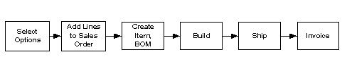

The CTO process goes through these basic steps:
CTO Process
First, you navigate to the Sales Order window and enters an ATO model as an item. Depending on your setup, you can use the Configurator or Options window to select options. The system adds the options to the sales order as new lines. The system creates a new item and a new bill of material (if necessary) and then communicates with the manufacturing applications so that the item is built. The completed item is then shipped to the customer and an invoice is generated.

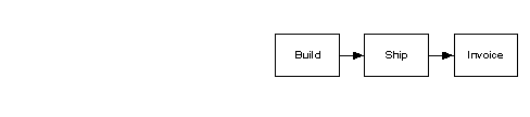

The PTO process is similar to the CTO process except that all options are finished goods that are stocked in the warehouse, so no assembly operation is required. These are the basic steps for the PTO process.
PTO Process
The ATO process is also similar to the CTO process. The item is built based on the demand from the customer order. However, for an ATO item the customer cannot select options. Therefore the item and the bill of material are already defined. You enter an ATO item and it follows this process.
ATO Process

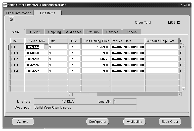

After the options for the configuration are selected, the items on the order must be scheduled.
Sales Order Window with Model, Option Classes and Options
See: Scheduling

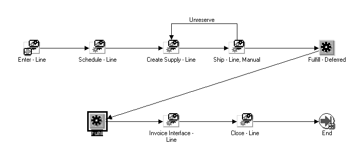

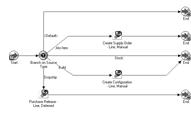

Although there are many item types in this business process, only two top level line Oracle Workflow processes are needed to support it. The seeded flow Line Flow - Generic is used for the model, option class and option lines. The seeded flow Line Flow - Configuration is used for the configured item.
The flow for the model, options and option classes all begin with the following basic process depicted in.
Line Flow - Generic Workflow Process
The lines progress through the Enter - Line and Schedule - Line subflows along the same path. At the Create Supply - Line subflow, their paths deviate.
Create Supply - Line Subprocess
The graphic above shows the variety of subflow paths that can be taken within Create - Supply Line. In the Branch on Source Type function, the options follow the path for Stock and the model follows the path for Build. Purchase Release - Line, Deferred is another subflow for drop shipments. See the corresponding section in this manual for more information on drop shipments.
The Build path, shown in the following figure, has an additional sub-process of Create Configuration - Line Manual which looks like this.
Create Configuration - Line, Manual Workflow Subprocess
This subprocess creates the new line on the order for the configuration item, and its workflow begins. This flow will be addressed in a moment. The activity also creates the new item (or finds the existing one, if applicable) and creates the BOM and Routing.
Once the Create Configuration - Line, Manual subflow is complete for the model line, the model line as well as the options and option classes have completed the Create Supply - Line subprocess and are ready for shipping. However, the model, options and option classes of a Configure to Order item are not shippable. The assumption is that in the manufacturing process the components are built into one indivisible item. So they pass through the shipping process with a result of Not Applicable, and proceed to the invoice process. The model line will be invoiced, so it goes through the Invoice Interface - Line activity and should complete. The options and option classes are not invoiced, so they go through the Invoice Interface - Line activity with a result of Not Applicable.
The configured item is created and added to the order when the model goes through the Create Configuration activity. Its workflow process is simpler than the process for models and options, shown in below.

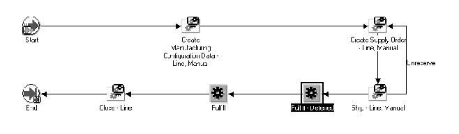

Line Flow - Configuration Workflow Process

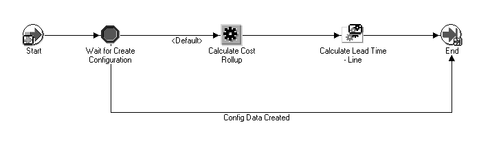

The figure below shows the first subprocess in the flow is the Create Manufacturing Configuration Date - Line, Manual.
Create Manufacturing Configuration Data - Line Manual Workflow Subprocess
This is the subprocess that performs the necessary Costing rollup and calculates the lead time for the configured item.
The figure below shows the next step in the configured item workflow, Create Supply Order - Line, Manual subprocess. This subprocess interfaces with the manufacturing system to trigger the assembly of the item. The Check Supply Type activity determines whether the item should be manufactured using discrete manufacturing or flow manufacturing. If the result is Flow Schedule, the Create Flow Schedule activity is executed. If the result is a Work Order, the final subprocess, the Create Work Order - Line process is executed.
Create Supply Order - Line, Manual Workflow Subprocess

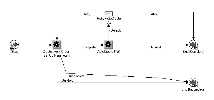

Create Work Order - Line Workflow Subprocess
The above figure indicates the final subprocess flow - Create Work Order - Line. The primary activity in this flow is the AutoCreate FAS activity, which will cause the WIP application to create a work order.
After the work order is created, the sales order will wait for completion of the work order before proceeding. When the work order is complete the inventory will be received into the inventory module and automatically reserved to the sales order.
The configured item then continues through the normal shipping and fulfillment steps and then its workflow is complete. It does not have an Invoice Interface subprocess because it is never invoiced. Only the model line, option classes and options may be invoiced depending on their item attributes.

The Generic Line workflow contains the Create Supply activity, which branches to various sub-processes based on different characteristics of the item and sales order line.
Order Management's workflows streamline the process of loading order information into the Purchasing Requisition import tables, eliminating the need to run the Purchase Release concurrent program. You can still run Purchase Release as a concurrent program, if you prefer to batch up requisition lines.

A branch of the existing Create Supply workflow subprocess in the seeded generic sales order line workflow initiates the autocreate purchase requisition processing when there is a Buy result.
