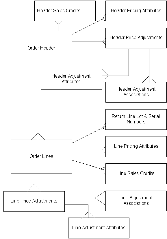

The Sales Order is modeled as a business object comprised of the following entities:
Header Level
Order Header
Header Sales Credits
Sales Agreement Order Header
Line Level
Order Lines
Sales Agreement Order Lines
Line Sales Credits
Line Price Adjustments
Line Pricing Attributes
Line Adjustment Attributes
Line Adjustment Associations
Lot Serial Numbers.

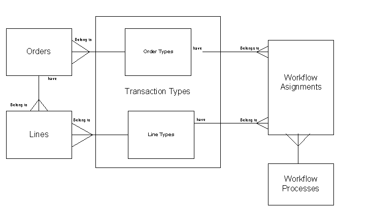

The application has an entity similar to the Order Type for the Line: the Line Type. Transaction Types stores both Order Types and Line types. Most of the Transaction Type attributes are common to the two types. However there are some controls that are available only at the Header level (e.g.: Order Numbering controls) and some only at the Line level. For example, a control that dictates whether a Line is sourced internally or externally. The category code on the Order Transaction type (ORDER, RETURN, MIXED) lets you control whether you want to mix outbound and inbound lines on a given Order.
Transaction Types also determines the workflow that the Order Header or Line follows. Header workflow is assigned to an Order type and a Line workflow to an Order Type, Line Type and Item type combination. The same order can contain lines with different line types following different flows.
Relationship between orders, lines, order types, line types, and workflow processes
