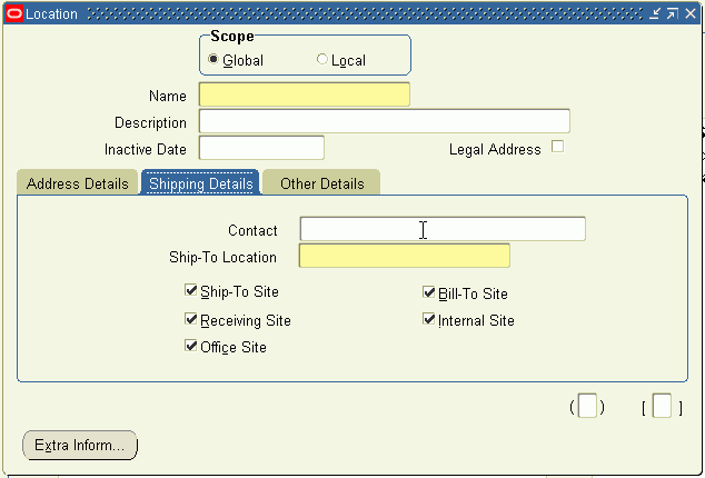

Step 5: Define Locations (Required)
If you're also setting up other Oracle applications, you may already have defined locations when you set up those applications.
You are required to set up at least one location for now. You can set up the remaining locations after you define inventory organizations and tax codes.
You may need to revisit this step after you set up organizations, if you want to link a location to an inventory organization.
See: Defining Locations.

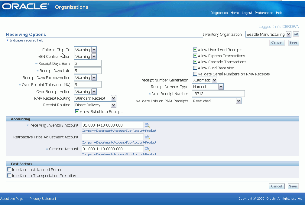

Define receiving options for the inventory organizations. For this task, see: Defining Receiving Options.

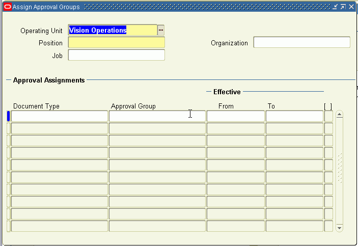

Define approval groups. See: Defining Approval Groups. (Required)
Assign approval groups. See: Assigning Approval Groups. (Required)

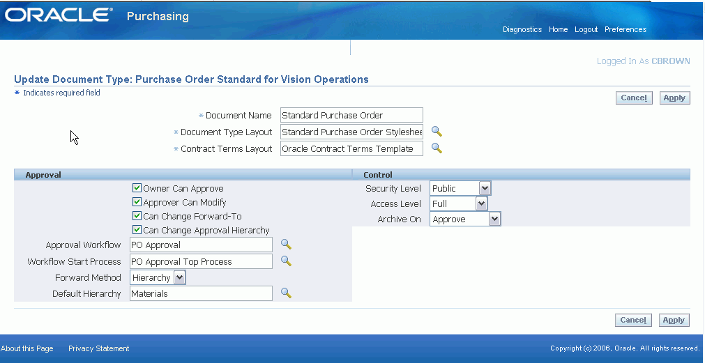

Define document types. See: Defining Document Types. (Required with defaults)
Default: Each Purchasing document (such as a Standard Purchase Order, Blanket Purchase Agreement, Quotation, or Requisition) comes with standard defaults. Update these defaults to meet your security and approval needs.

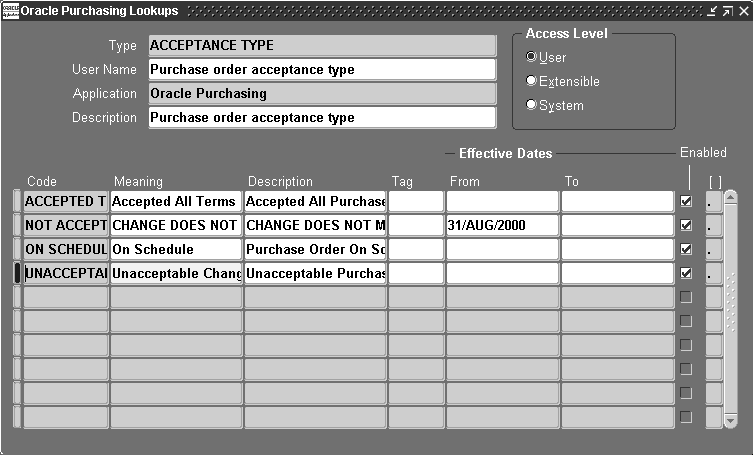

Define Purchasing lookups. See: Defining Lookup Codes. (Required with defaults)
Default: An example of a default lookup code that Purchasing provides is a Price Type of Fixed. See the section referenced above for a list of the other defaults that Purchasing provides.

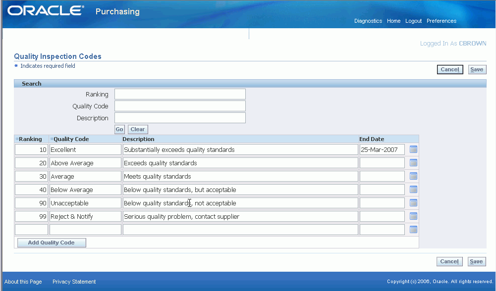

Define inspection codes. See: Defining Quality Inspection Codes. (Optional)
Default: If you skip this task, you will not be able to assign inspection codes during receiving.

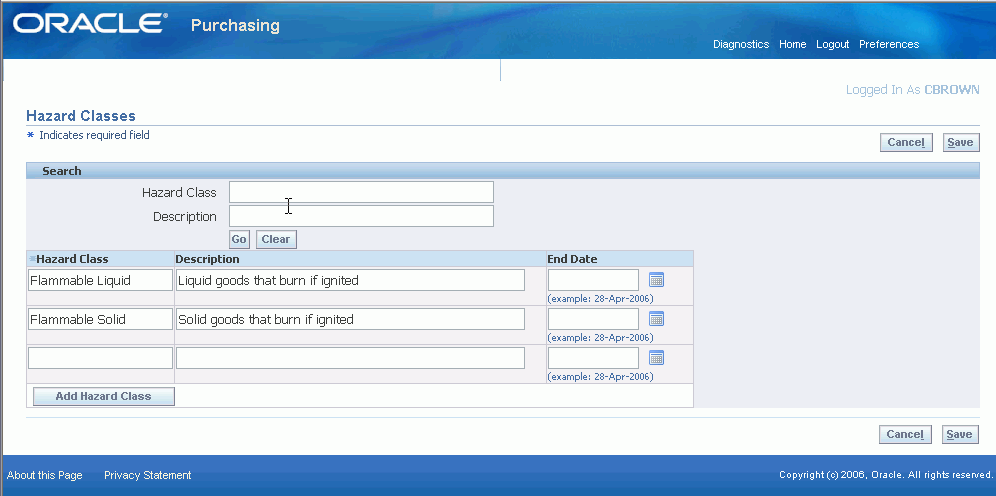

Define hazard classes. See: Defining Hazard Classes. (Optional)
Default: If you skip this task, you will not be able to assign hazard classes to items or purchase order lines.

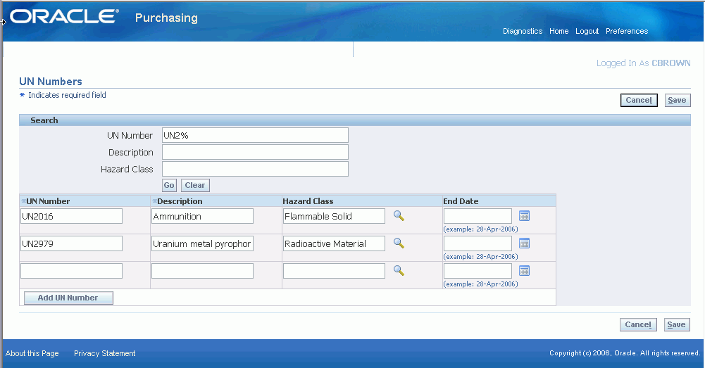

Define United Nations (UN) numbers. See: Defining UN Numbers. (Optional)
Default: If you skip this task, you will not be able to assign UN numbers to items or purchase order lines.

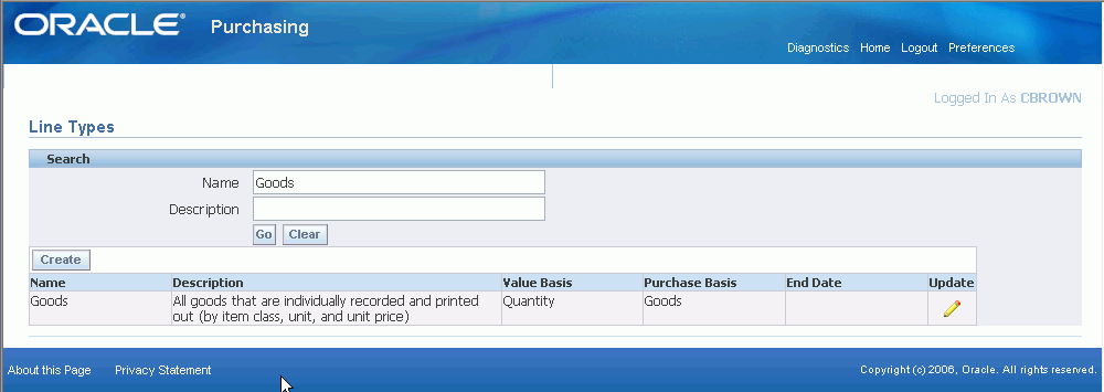

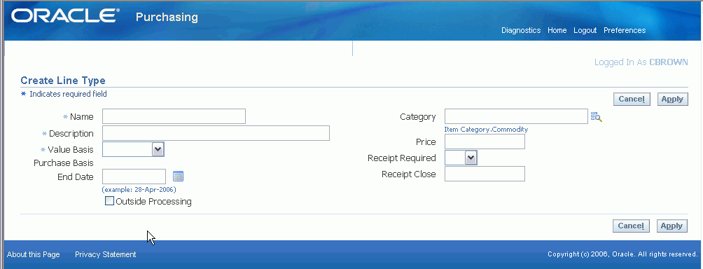

Step 28: Define Line Types (Required with defaults)
See: Defining Line Types.
Default: Default line types that Purchasing provides include Goods; Services; and Outside Processing, if Work in Process is installed.

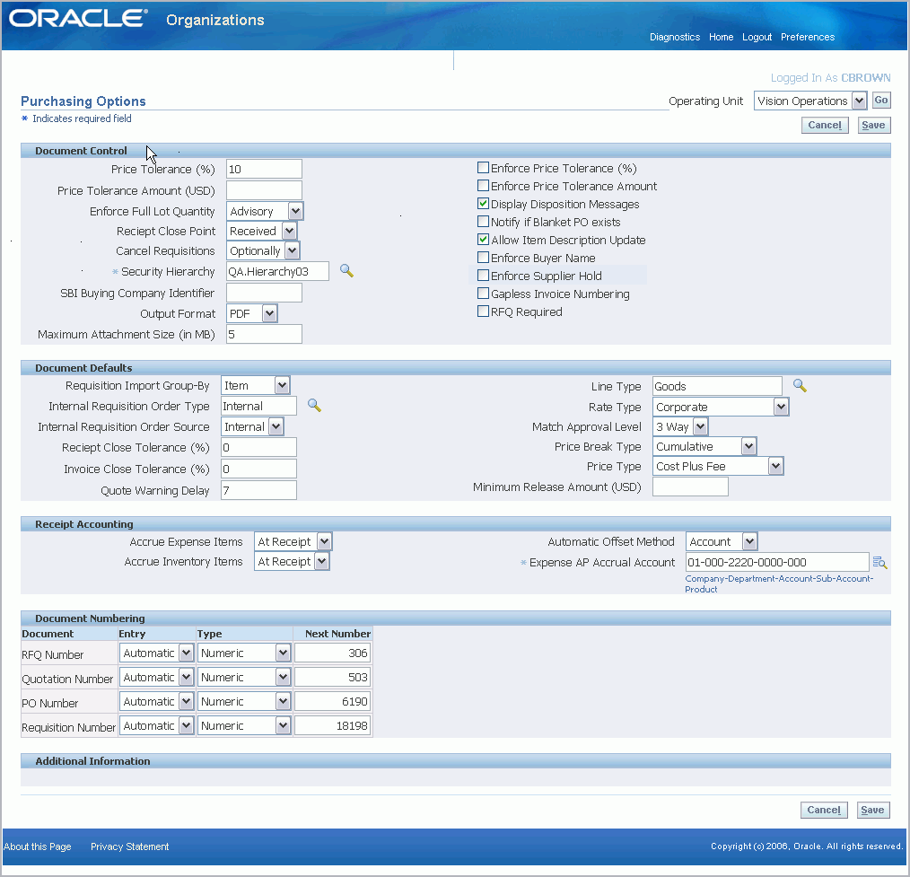

Step 31: Define Purchasing Options (Required)
See: Defining Purchasing Options.
Context: This step needs to be performed for each operating unit.
Step 32: Define Receiving Options (Required)
You may not need to perform this step if you've already defined receiving options in Step 6 Define Organizations and Organization Relationships. See: Defining Receiving Options.
Context: This step needs to be performed for all inventory organizations. Use the Change Organization function in the Purchasing menu to perform this step for each inventory organization.

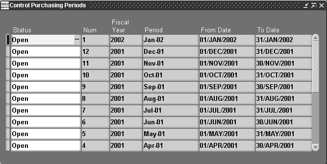

Step 33: Open Inventory and Purchasing Accounting Periods (Required)
This step involves the following tasks.
Open Inventory accounting period. See: Maintaining Accounting Periods, Oracle Inventory User's Guide.
Context: This task needs to be performed for each inventory organization.
Open Purchasing accounting period. See: Purchasing Periods.
Context: This task needs to be performed for each ledger.

Use the Locations window to define ship-to, receiving, and other location information for Purchasing documents.
To set up locations for Purchasing
Navigate to the Locations window.
For information on the Name, Description, Inactive Date, Global, and Address Details fields, follow the instructions in Setting Up Locations, Oracle HRMS Enterprise and Workforce Management Guide or see the online help for the Location window.
Fill in information in the Shipping Details tabbed region.
Note: Selecting the check boxes means that you are making the location Name a valid location in the list of values on a Purchasing document. For example, selecting Ship-To Site makes the location Name a valid choice in the list of values for the Ship-To field on a purchase order header. Note that if you define a default Ship-To or Bill-To Location in the Supplier-Purchasing region of the Financials Options window for your organization, that is the location that defaults onto your purchase orders. But if you wanted to change that default, the location Name that you define here and enable as a Ship-To or Bill-To site is available in the list of values for you to choose from in the Ship-To or Bill-To fields.
Contact: Optional contact name for the location Name.
Ship-To Location: Usually the same as the location Name. You could select a separate, previously defined Ship-To Location-for example, if you wanted to create a location Name, Office A, and specify Receiving Dock A as its Ship-To Location. Note, however, that once you specify a separate Ship-To Location, you can no longer enable the location Name as a Ship-To Site. In this example, Receiving Dock A is the ship-to site for Office A; therefore, Office A itself cannot also be the ship-to site.
Ship-To Site: Select this option to make the location Name a valid ship-to organization on a purchase order or requisition.
Receiving Site: Select this option to make the location a valid receiving Location when creating a receipt or receiving transaction.
Office Site: Select this option to indicate that this location Name is an office site, such as a field office.
Bill-To Site: Select this option to make the location Name a valid bill-to site. The Bill-To Site, which is used by Payables, is specified on a purchase order header.
Internal Site: Select this option to make the location a valid internal ship-to location when creating an internal requisition.
Optionally fill in information in the Other Details tabbed region.
Inventory Organization: Select an inventory organization within which this location will be available in the list of values on a Purchasing document. By selecting no inventory organization, this location becomes available on Purchasing documents in all organizations.
EDI Location: If you use Electronic Data Interchange (EDI) to receive Advance Shipment Notices (ASNs) or ASNs with billing information (ASBNs), enter a defined location. This location should match the ship-to location specified on an ASN or ASBN. See: Advance Shipment Notices (ASNs).
If you want to use the Extra Information button to enter additional information required by your business, see: Entering Extra Information, Oracle HRMS Enterprise and Workforce Management Guide or see the online help for that window.

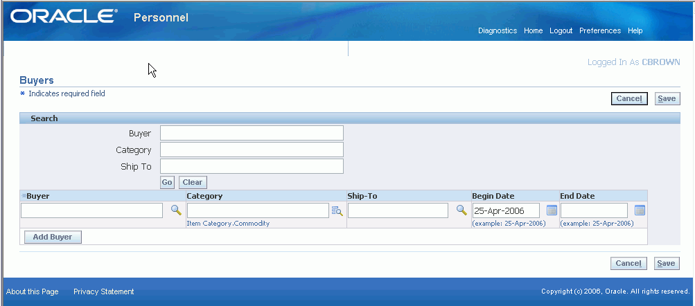

Use the Buyers window to define and maintain your buyers. Buyers can review all requisitions using the Requisitions window, and only buyers can enter and autocreate purchasing documents. See the Document Types window for rules governing access to documents. See: Defining Document Types.
Prerequisites
Define employees before performing this step. See the online help for the Enter Person window for details.
Define locations before performing this step. See: Defining Locations.
To define buyers
Navigate to the Buyers window.
If you are defining a new buyer click Add Buyer in the Buyers window. To enter changes to an existing buyer use the Search region to enter the buyer's name in the Buyer field, the category assigned to the buyer in the Category field, or the buyer's ship-to location in the Ship-to field. Once you have completed one or all of these fields click Go.
Enter the Name of an employee who you want to define as a buyer. If the name you want does not appear in the list of values, use the Enter Person window to enter that person as an employee.
Enter the default purchasing Category of the goods the buyer typically orders. Purchasing defaults this value in the Category field when you are autocreating documents. See: Defining Categories, Oracle Inventory User's Guide.
Enter the name of the ship-to location for which the buyer typically creates purchase orders. Purchasing defaults this value when you are autocreating documents.
Enter the Start Date that you want to initiate the responsibilities for a buyer. The default is the current date.
Enter the End Date after which the employee is no longer a buyer.
Click Save.

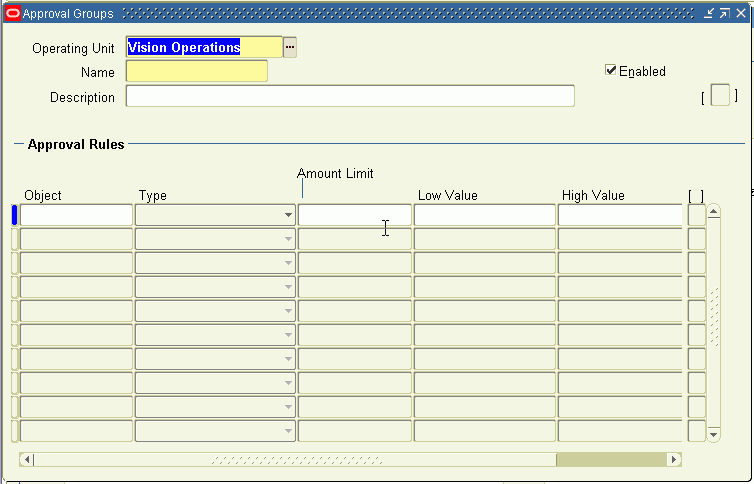

Use the Approval Groups window to define and update approval groups. Once you have defined an approval group here, you can then use it to assign approval functions to jobs or positions in the Approval Assignments window. You cannot delete an approval group that is used in an active assignment. You can enable or disable the entire approval group, or you can enter inactive dates for individual approval rules.
Prerequisites
Review how your choices in this window affect your approval routing. See: Defining Approval Authorization Rules.
To define approval groups
Navigate to the Approval Groups window.
Select the Operating Unit for this approval group.
Enter the Name of the approval group. You can change existing approval group names, but names must be unique.
Select Enabled to permit the approval group to be assigned to a position/job in the Approval Assignments window.
Choose one of the following Objects:
Account Range - (Required) For this option, you enter the accounting flexfields for the Low and High Values. Include Type rules identify accounts that you want to be included on the document. Exclude Type rules identify accounts that you do not want on the document. If you do not enter a rule for an account, the default is to exclude the account. If you enter only an Exclude Type rule, Purchasing does not automatically include everything else.
For example, entering only the following account includes account 01.000.0451 and excludes all else:
| Account Range | Include | 01.000.0451 | 01.000.0451 |
Entering only the following account excludes all accounts:
| Account Range | Exclude | 01.000.0451 | 01.000.0451 |
Entering only the following two accounts includes all accounts except 01.000.0451:
| Account Range | Include | 00.000.0000 | ZZ.ZZZ.ZZZZ | |

The Inactive Date is optional, but you must enter an Amount Limit for Include Type rules.
Document Total - (Required) The document total refers to the monetary limit on an individual document. For this option, the Type defaults to Include, and you can enter only the Amount Limit (required) and the Inactive Date (optional).
Item Category Range - For this option, you enter the purchasing category flexfields for the Low and High Values. Include Type rules identify manufacturing categories that you want to be included on the document. Exclude Type rules identify categories that you do not want on the document. If you do not define a rule for a category, the default is Include. The Inactive Date is optional, but you must enter an Amount Limit for Include Type rules.
Item Range - For this option, you enter the item flexfields for the Low and High Values. Include Type rules identify items that you want to be included on the document. Exclude Type rules identify items that you do not want on the document. If you do not define a rule for an item, the default is Include. The Inactive Date is optional, but you must enter an Amount Limit for Include Type rules.
Location - The location refers to the deliver-to location on a requisition as well as the ship-to location on purchase orders and releases. Include Type rules identify locations that you want to be included on the document. Exclude Type rules identify locations that you do not want on the document. For this option, you enter the location in the Low Value field. If you do not define a rule for a location, the default is Include. The Inactive Date is optional, but you must enter an Amount Limit for Include Type rules.
Select the rule Type: Include or Exclude indicates whether to allow objects that fall within the selected range.
Enter the Amount Limit. This is the maximum amount that a control group can authorize for a particular object range. This field is required only for Include type rules.
Enter the Low Value. This is the lowest flexfield (accounting, purchasing category, or item) in the range pertinent to this rule. When the object is Location, enter the location. You cannot enter this field when the object is Document Total.
Enter the High Value. This is the highest flexfield (accounting, purchasing category, or item) in the range pertinent to this rule. You cannot enter this field when the object is Location or Document Total.
Enter the Inactive Date on which Purchasing will no longer use this rule in formulating the group.
Save your work.

Use the Assign Approval Groups window to assign approval groups and approval functions to positions or jobs. If you are using approval hierarchies (the Use Approval Hierarchies option in the Financials Options window is enabled), you must first use the Approval Groups window to establish rules for your approval groups. Then you can assign approval groups to positions in this window. When you are not using approval hierarchies, you can use this window to assign approval groups and approval functions to jobs within your organization.
Prerequisites
Define approval groups before performing this step. See: Defining Approval Groups.
Review how your choices in this window affect your approval routing. See: Using Approval Assignments.
To assign approval groups
Navigate to the Assign Approval Groups window.
Select the Operating Unit for this approval group assignment.
Enter the Position for which you want to assign approval groups and approval functions. If the Use Approval Hierarchies option in the Financial Options window is not enabled, this field is not applicable.
If you are not using approval hierarchies, enter the Job.
Select the approval function you want to assign to this position or job.
Enter the approval group that you want to assign to the selected position or job. The list of values includes only enabled approval groups with at least one approval rule. See: Defining Approval Groups.
Enter the Start Date and End Date for the assignment.
Important: The start and end dates that you assign here are the effectivity dates of the assignment. When the system date reaches the end date of the assignment, the rule no longer applies. There is no explicit warning that the rule is no longer in effect.
Save your work.

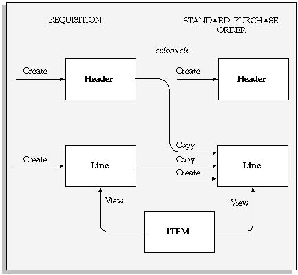

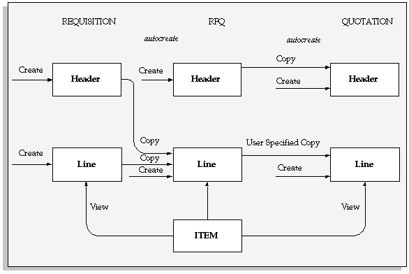

You can provide attachments for your items. When you reference an item on a purchasing document, Purchasing makes the corresponding item attachments available for you to review. Purchasing also prints text attachments on your purchase orders and RFQs if you choose Supplier as the usage when you create the item attachment.
You can create attachments for your requisition headers and lines. When you AutoCreate a requisition line onto a purchase order, Purchasing copies the attachments from the requisition header and line to the corresponding purchase order line. As a buyer, you can provide additional attachments to a purchase order even after you AutoCreated it from a requisition.
If the purchase order line references more than one requisition line, Purchasing copies only the header and line attachments from the requisition line that is the basis for the purchase order line. For example, if you place multiple requisition lines onto a single purchase order line, Purchasing copies only the requisition header and line attachments from the line where you use the Copy option.
For each requisition line copied, the corresponding header level attachment is copied. For example, you have a requisition with 3 lines and they have 3 line level attachments and a header level attachment. You then AutoCreate this requisition to a purchase order with 3 lines, each of the 3 lines in the purchase order would have the specific line attachment and the common header attachment.

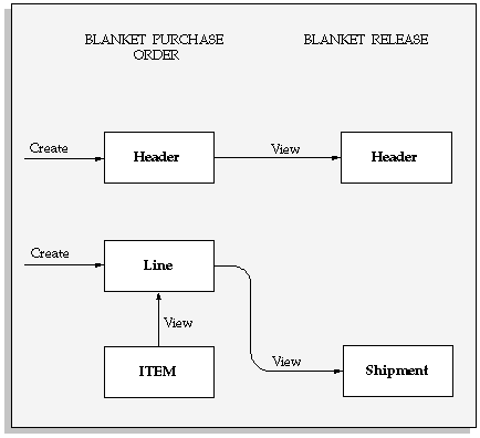

You can create long attachments for your blanket purchase agreements at the header and line level. You can review the blanket purchase agreement header attachment on the corresponding release header, and you can enter new attachments on the release header. You can also review the blanket agreement line attachment on the corresponding release shipment, and you can enter new attachments for the shipments. Purchasing does not copy requisition attachments to a blanket agreement or release when you AutoCreate a release.
Similar to standard purchase orders, Purchasing copies requisition header and line attachments to the corresponding RFQ line. Purchasing copies all RFQ header and line attachments to the corresponding quotation header and line when you copy a quotation using the Entire RFQ or RFQ Header and Lines options in the Copy Document window. Purchasing copies only the attachments from the RFQ header to the quotation header when you copy a quotation using RFQ Header Only. If you choose the Selective option when copying a quotation, Purchasing copies the RFQ header attachments to the quotation header and lets you decide which line attachments you want to copy to the quotation line.

To define Purchasing Options
Navigate to the Purchasing Options window.
Select the Purchasing Options Operating Unit.
Document Control Options
Enter the Price Tolerance Percentage. This is the percentage by which the autocreated purchase order line price cannot exceed the requisition line price. If you select Enforce Price Tolerance Percentage, you can create, but not approve, purchase orders for which this tolerance is exceeded. There is no restriction on how much a price can decrease, but changes to the line (quantity or unit of measure for example) may cause the price tolerances to be exceeded.
Note: If the price on a requisition line is zero, then price tolerance checks do not apply.
Enter the Price Tolerance Amount. This is the dollar amount by which the autocreated purchase order line price cannot exceed the requisition line price.
Note: If you set both price tolerance percentage and amount values, the system will apply the more restrictive of the two.
Select one of the following values for the Enforce Full Lot Quantity option:
None: The requisition quantity is not rounded to the lot quantity.
Automatic: The requisition quantity is forced to the rounded quantity.
Advisory: An advisory message suggesting rounding and a suggested rounding quantity are displayed, but you can override.
Enforce Full Lot Quantity is used for rounding quantities on Internal Requisitions, for example:
System Options Enforce Full Lot Quantities = Yes
Items Rounding Factor = 75%
Items Unit of Issue = DZ
Unit of Measure on Internal Requisition = Each
If the user enters 6 Each on the Internal Requisition, the quantity will be rounding to 0. If the user enters 11 Each on the Internal Requisition, the quantity will be rounded to 12 Each.
See: Overview of Requisitions.
Select the Receipt Close Point, which is when the shipment is closed for receiving: Accepted (passed inspection), Delivered, or Received. Note that you need to set the receipt close tolerance percentage in the Default Options window. See: Defining Default Options.
The Cancel Requisitions options apply only to requisitions from which purchase orders were autocreated. Select one of the following:
Always: When canceling the purchase order, Purchasing also cancels the requisition.
Never: When canceling the purchase order, Purchasing does not cancel the requisition, so it is again available for inclusion on a purchase order.
Optional: When canceling the purchase order, you are given the option to cancel the requisition. See: Controlling Documents.
Select a Security Hierarchy, which is a position hierarchy from the Position Hierarchy window. When the Security Level is set to Hierarchy for a document in the Document Controls window, this position hierarchy governs access security for the document.
Important: This field is enterable only when the form is accessed from the Purchasing menu.
If you have selected Gapless Invoice Numbering for the entire business unit or for a specific supplier site, enter the SBI Buying Company Identifier. This is an identifier included in the invoice number created by the Pay on Receipt process, as well as for debit memos resulting from return receipts, and invoices resulting from retroactive purchase price adjustments. This portion of the invoice number identifies the buying business unit and is included as follows:
<Prefix>-<SBI Buying Company Identifier>-<Selling Company Identifier>-<Invoice Type Code>-<Seq #>
Where:
Prefix is specified by the profile option PO: ERS Invoice Number Prefix. (optional) and only applies to invoices resulting from the Payment on Receipt process. See: Profile Options in Purchasing. See: Payment on Receipt.
SBI Buying Company Identifier is a unique code for the operating unit. This is defined as a Purchasing Option and need not be unique.
Selling Company Identifier is a code for the supplier site. It is defined in the supplier site window. The Selling Company Identifier does not need to be unique within the same supplier; however, it must be unique across suppliers.
Invoice Type Code:
ERS (Evaluated Receipt Settlement) for Pay on Receipt invoices
RTS (Return to Supplier) for Debit Memos
PPA (Purchase Price Adjustment) for invoices resulting from a retroactive price adjustment
Seq# is a gapless sequence number defined for each buying company/selling company/invoice type combination when Gapless Invoice Numbering is enabled.
All segments of the gapless invoice number are separated with a hyphen.
The PO Output Format selection defines the output format for purchase orders sent to the supplier using print, e-mail, or fax. It also enables functionality related to that output format.
PDF: Purchase orders are output in the Adobe Portable Document Format (PDF). You can view the purchase order fully formatted from the Enter Purchase Order window, Purchase Order Summary window, Change History page, Oracle iProcurement, and Oracle iSupplier Portal. You can also communicate the purchase order to the supplier from the Purchase Order Summary window.
Text: Purchase orders are output in text.
Note: Your ability to communicate the purchase order to the supplier from the Approval window remains the same with either setting. Only the formatting of the output changes.
If the PO Output format is PDF, enter the Maximum Attachment Size. This indicates the maximum file size, in megabytes, that is allowed as a File type attachment to an e-mailed purchase order.
See: About Attachments, Oracle Applications User's Guide.
Select Enforce Price Tolerance Percentage if you want Purchasing to enforce the price tolerance percentage.
Select Enforce Price Tolerance Amount if you want Purchasing to enforce the price tolerance amount.
Select Display Disposition Messages if you want to see any disposition messages defined against inventory items when they are placed on requisitions.
Select Notify If Blanket PO Exists if you want to be notified of existing blanket purchase agreements when you create a requisition, purchase order, or blanket purchase agreement line for the item. If you sourced the item, you see the following message: Blanket purchase order [number] already exists for this item. Your requestors can directly create a release for the blanket purchase agreements instead of creating a requisition or purchase order if you allow your requestor to enter releases. See: Viewing and Responding to Notifications.
You can define for each item whether you allow updating of the item description during the creation of requisition, RFQ, quotation, or purchase order lines. This update affects only the line you are creating. Select Allow Item Description Update if you want Yes to be the initial default of the Allow Description Update attribute when you are defining a new item.
Select Enforce Buyer Name to enforce entry of only your name as the buyer on purchase orders. Otherwise, you can enter the name of any active buyer. See: Defining Buyers.
Select Enforce Supplier Hold if you do not want to be able to approve purchase orders created with suppliers that are on hold. Use the Suppliers window to place suppliers on hold. See: Suppliers, Oracle iSupplier Portal Implementation Guide.
Note: Even if you put a supplier on hold in the Suppliers window, you can still approve a purchase order to that supplier if Enforce Supplier Hold is not checked here.
Select Gapless Invoice Numbering to enable gapless (no breaks in numbering) invoice number generation for your buying organization during Pay on Receipt processing. See: Payment on Receipt.
Note that you can enable gapless SBI numbering for the entire operating unit with this setting or limit it to a supplier site(s) in the Supplier Site window.
Select RFQ Required to require an RFQ for an item before you can autocreate the corresponding requisition line onto a purchase order. You can override this value for each item or requisition line.
Document Default Options
Select one of the following Requisition Import Group By options for requisitions imported through the requisition open interface: All (not grouped), Buyer, Category, Item, Location, or Supplier. See: Requisition Import Process.
Select the default Order Type for internal requisitions.
Important: The Order Type field is visible only if the application Oracle Order Management is installed.
Order types are defined in Order Management. The order type you choose here is the type that Purchasing uses to create sales orders from internal requisitions.
Select the default Order Source for internal requisitions.
Purchasing defaults and only uses Internal. This is the source OrderImport uses to transfer internal requisitions from Purchasing to Order Management.
Enter the Receipt Close tolerance percentage for your shipments. Purchasing automatically closes a shipment for receiving if it is within the receiving close tolerance at the receiving close point. Set the receiving close point in the Control Options window. You can override this option for specific items and orders. See: Defining Control Options.
Enter the Invoice Close tolerance percentage for shipments. Purchasing automatically closes a shipment for invoicing if it is within the invoicing close tolerance at billing, when Payables matches invoices to purchase orders or receipts. You can override this option for specific items and orders. See: Defining Control Options.
Enter the Quote Warning Delay. This is the number of days before a quotation expires that you want to receive an expiration warning. When a quotation is due to expire within the number of days you provide here, you receive the following message in the Notifications Summary window: Quotations active or approaching expiration: [number]. See: Viewing and Responding to Notifications.
Select a default Line Type for requisition, RFQ, quotation, and purchase order lines. When you create any of these documents, the line type is part of your item information. You can override the line type for each document line. See: Defining Line Types.
Select the currency Rate Type that defaults on requisitions, purchase orders, RFQs, and quotations. If the Rate Type is User, you can override this default for each document line. If either your functional currency (defined in your ledger) or your transaction currency (the currency you enter in a purchasing document window) is Euro (the European Monetary Unit currency), and the other is another European currency, Purchasing defaults in the appropriate conversion Rate Type, Rate, and Rate Date. See: Defining Conversion Rate Types, Oracle General Ledger User's Guide.
Select one of the following options for Match Approval Level:
Two-Way: Purchase order and invoice quantities must match within tolerance before the corresponding invoice can be paid.
Three-Way: Purchase order, receipt, and invoice quantities must match within tolerance before the corresponding invoice can be paid.
Four-Way: Purchase order, receipt, inspection, and invoice quantities must match within tolerance before the corresponding invoice can be paid.
See: Receiving Controls, Options, and Profiles.
Note: The Invoice Match Option in the purchase order Shipments window and the Match Approval Level here are independent options. The Invoice Match Option determines whether Payables performs invoice matching to the purchase order or the receipt. You can perform whichever Invoice Match Option you want on a shipment regardless of the Match Approval Level you choose here.
Select the Price Break Type that defaults on blanket purchase orders:
Cumulative: Price breaks apply to the cumulative quantity on all release shipments for the item.
Non-cumulative: Price breaks apply to quantities on individual release shipments for the item.
Select the Price Type that defaults on purchase orders. Use the Lookup Codes window to define price types. See: Defining Lookup Codes.
Enter the Minimum Release Amount that defaults on blanket, contract, and planned purchase orders. This amount is in your functional currency. See: Overview of Multi-Currency Accounting, Oracle General Ledger User's Guide.
Receipt Accounting Options
Choose one of the following Accrue Expense Items options:
At Receipt: Accrue expense items upon receipt. You can override this flag in the Shipment Details window when you are entering purchase orders and releases.
Period End: Accrue expense items at period end.
Important: When using Cash Basis Accounting, you should set this option to Period End, but you will not normally run the Receipt Accrual - Period End process.
For Accrue Inventory Items, you currently have only one choice: On Receipt.
An offset is an accounting entry that is created to offset, or balance, another accounting entry. Automatic Offset Method is the method used to automatically create the account for the offsetting transaction. Here the offsetting account is the Receiving Inspection Account, which offsets the Accrual Account transaction at the time of receipt and the Charge Account at the time of delivery. The Automatic Offset Method controls which of the two accounts are used as the base account and which as the overlay account, as well as which segment is used to overlay the base account segment.
Choose one of the following Automatic Offset Method options:
None: No substitutions are made and the Receiving Inspection account for the destination organization is used.
Balancing: The base account is the Receiving Inspection Account for the destination organization and the balancing segment is overlaid with the balancing segment of the Charge Account.
Account: The base account is the Charge Account and the account segment is overlaid with the account segment of the Receiving Inspection Account.
Note: The Automatic Offset Method is not supported with retroactive pricing, shared services, and drop shipment flows.
Enter the default Expense AP Accrual Account.
Document Numbering Options
Select the [Document] Number Entry method for RFQ, quotation, purchase order, and requisition numbers:
Automatic: Purchasing automatically assigns a unique sequential number to each document when you create the document.
Manual: You provide a document number manually when you enter the document.
Important: You can change the method of entering document numbers at any time. If you originally allow manual entry and switch to automatic entry, make sure to enter a Next Number that is higher than the highest number you assigned manually.
Select the [Document] Number Type you want Purchasing to use for RFQ, quotation, purchase order, and requisition numbers: Numeric or Alphanumeric.
Important: If you choose Automatic document number entry, you can generate only numeric document numbers, but you can still import either numeric or alphanumeric values from another purchasing system.
Important: If you import purchasing documents from a foreign system that references alphanumeric numbers, you must choose Alphanumeric as your number type, regardless of your numbering method.
If you choose Manual document number entry, you can choose numeric or alphanumeric numbers. You can change the document number type from Numeric to Alphanumeric whenever you want. You can change the document number type from Alphanumeric to Numeric only if all your current document numbers are numeric.
Important: The ordering of numeric values in lists of values can appear random when you use the Alphanumeric number type. If you are using Alphanumeric numbering, consider entering all numeric values with the same number of digits. For example, if you can assume all numeric values contain six digits, you should enter the first value as 000001.
Important: You should setup the numbering type to be the same in all operating units in which you are planning to create and enable global agreements.
Enter the Next Number. This is the starting value you want Purchasing to use for generating unique sequential document numbers if you choose Automatic document number entry. Purchasing displays the next document number that will be used for a new document when you create the new document. You cannot enter this field if you choose Manual document number entry.
If you use Master Scheduling/MRP, Inventory, Work in Process, or any non-Oracle system to create requisitions automatically, you must also let Purchasing number the corresponding requisitions automatically.
Click Save.
Use the Receiving Options window to define options that govern receipts in your system. Most of the options that you set here can be overridden for specific suppliers, items, and purchase orders. See: Receiving Controls, Options, and Profiles.
To define receiving options
Receiving Options
Enter the Enforce Ship To location option to determine whether the receiving location must be the same as the ship-to location. Choose one of the following options:
None - The receiving location may differ from the ship-to location.
Reject - Purchasing does not permit receipts when the receiving location differs from the ship-to location.
Warning - Purchasing displays a warning message but permits receipts when the receiving location differs from the ship-to location.
Choose an action for ASN Control. This field determines how Purchasing handles receiving against purchase order shipments for which an Advance Shipment Notice (ASN) exists. Choose one of the following options.
None - Purchasing does not prevent or warn you when you try to receive against a purchase order shipment for which an ASN exists.
Reject - Purchasing gives you a message and prevents you from receiving against a purchase order shipment for which an ASN exists.
Warning - Purchasing gives you a message informing you that an ASN exists for the purchase order shipment and lets you decide whether to receive against the purchase order shipment or its ASN.
Enter the maximum acceptable number of Days Early and Days Late for receipts.
Enter an action for Receipt Days Exceed-Action. This field determines how Purchasing handles receipts that are earlier or later than the allowed number of days selected above. Choose one of the following options:
None - Receipts may exceed the allowed days early or late.
Reject - Purchasing does not permit receipts outside the selected number of days early or late.
Warning - Purchasing displays a warning message but permits receipts outside the selected number of days early or late.
Enter the maximum acceptable Over Receipt Tolerance percentage.
Enter the Action for Over Receipt Action. This field determines how Purchasing handles receipts that exceed the quantity received tolerance. Choose one of the following options:
None - Receipts may exceed the selected tolerance.
Reject - Purchasing does not permit receipts that exceed the selected tolerance.
Warning - Purchasing displays a warning message but permits receipts that exceed the selected tolerance.
Enter the default RMA Receipt Routing that you assign goods: Direct Delivery, Standard Receipt, or Inspection Required.
Enter the default Receipt Routing that you assign goods: Direct Delivery, Standard Receipt, or Inspection Required. You can override this option at receipt time by changing the destination type for specific suppliers, items, and orders if the RCV: Allow Routing Override user profile is set to Yes. See: Profile Options in Purchasing.
Check Allow Substitute Receipts if you want to receive substitute items in place of ordered items. You must define substitute items in the Item Relationships window before you can receive them. You can override this option for specific suppliers, items, and orders. See: Defining Item Relationships, Oracle Inventory User's Guide.
Check Allow Unordered Receipts if you want to receive unordered items. You can later match the unordered receipts to a purchase order. If you enable this option, you can override it for specific suppliers and items.
Check Allow Express Transactions to enable express deliveries and receipts. See: Express Receipts and Receiving Transactions.
Check Allow Cascade Transactions to enable cascading for receipts and receiving transactions. See: Cascading Receipts and Receiving Transactions.
Select Allow Blind Receiving if you want blind receiving at your site. Blind receiving helps you ensure that receivers record the exact amount they receive. With blind receiving, you cannot see the quantity due or the quantity ordered for shipments when you receive items. Purchasing ignores all quantity receipt tolerances to help ensure that you can receive the exact amount the supplier shipped.
Select Validate Serial Numbers on RMA Receipts if you want serial numbers validated. Restricts serial numbers displayed in the list of serial numbers for an RMA line.
Choose the Receipt Number Generation method for receipt numbers
Automatic: Purchasing automatically assigns a unique sequential number to each receipt when you create the receipt.
Manual: You provide a receipt number manually when you enter the receipt.
Purchasing numbers receipts within inventory organizations rather than across inventory organizations. So, for example, the same receipt number could be used by different inventory organizations.
Important: You can change the method of entering receipt numbers at any time. If you originally allow manual entry and switch to automatic entry, make sure to enter a Next Number that is higher than the highest number you assigned manually.
Choose the Receipt Number Type you want Purchasing to use for receipt numbers: Numeric or Alphanumeric.
Important: If you choose Automatic receipt number entry, you can generate only numeric receipt numbers, but you can still import either numeric or alphanumeric values from another purchasing system.
Important: If you have any alphanumeric documents in your system, you must choose Alphanumeric as your number type, regardless of your numbering method.
If you choose Manual receipt number entry, you can choose numeric or alphanumeric numbers. You can change the receipt number type from Numeric to Alphanumeric whenever you want. You can change the receipt number type from Alphanumeric to Numeric only if all your current receipt numbers are numeric.
Enter the Next Receipt Number. This is the starting value you want Purchasing to use for generating unique sequential receipt numbers if you choose Automatic receipt number entry. Purchasing displays the next receipt number that will be used for a new receipt when you create the new receipt. You cannot enter this field if you choose Manual receipt number entry.
Accounting
Enter the accounting flexfield for the default Receiving Inventory Account.
Enter the account number for the Retroactive Price Adjustment Account. This is the account that receiving will use to post an adjusting entry for changes in pricing after a shipment has been received and accrued. See: Retroactive Price Update on Purchasing Documents.
Enter the account number for the Clearing Account. This is the account that is used for intercompany receivables in the procuring organization when the receiving organization is not the same as the procuring organization.
Cost Factors
If you have implemented Oracle Advanced Pricing to calculate cost factors, check Interface to Advanced Pricing.
If you have implemented Oracle Transportation Execution to calculate transportation costs, check Interface to Transportation Execution.
Click Save.

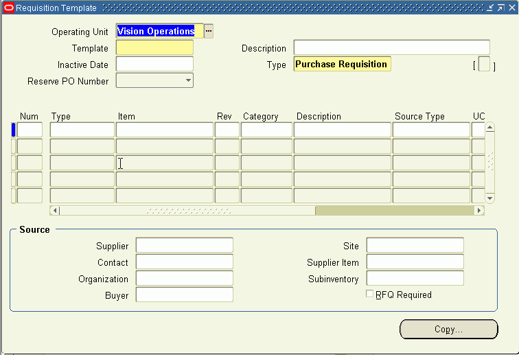

Use the Requisition Templates window to define requisition templates. These templates automate requisitioning of commonly ordered items like office supplies. To create a requisition for office supplies, requestors in your organization simply use your template and enter the quantity of each item they want to order.
To create a template, you can specify the items individually or you can reference an existing requisition or purchase order. If you reference an existing document, Purchasing adds all lines on the document to the template. You can reference multiple documents to add all their lines to the same template.
After you define a template, you can reference the template in the Supplier Item Catalog. When you do so, Purchasing displays all template lines that are valid for the destination organization, and you can use any of these lines on your requisition. You can create requisitions with this template as long as the requisition creation date is before the template inactive date.
To define requisition templates
Navigate to the Requisition Templates window.
Select the Operating Unit for this template.
Enter the requisition Template name.
Enter a Description of the template.
Enter the Inactive Date after which you do not want any requestor to create a requisition from this template.
Enter the requisition Type: Internal or Purchase. In either case, you can enter individual requisition lines of either type.
If this template is to be used in Oracle iProcurement, select the Reserve PO Number option.
No prevents the requester from reserving a purchase order number at the time the requisition is approved.
Optional allows the requester to reserve a purchase order number at the time the requisition is approved.
Yes will automatically reserve a purchase order number at the time the requisition is approved.
To copy lines to a template
Select the Copy button to open the Base Document window.
Enter the Base Document Type: Purchase Order or Requisition.
Enter the base document Number from which you want to copy lines to the template.
Choose the OK button to copy all lines of the base document onto the template. You can choose the Cancel button to return to the Requisition Templates window without copying.
You can place lines from multiple documents onto the same requisition template.
To manually add lines to a template
Use the Lines region to manually add new lines to the template. You can also remove lines that you have copied from a base document, and you can change certain information in these lines.
Enter a Number in this field to identify the sequence of the line on your requisition. Purchasing provides default sequence numbers in increments of one.
Enter the line Type. You can enter or change information in this field only for new lines. The default is from the Purchasing Options window. See: Defining Default Options.
Enter the Item number. You can enter or change information in this field only for new lines.
For new lines only, you can enter the item Revision number.
If you entered an item, Purchasing displays the purchasing Category, and you cannot change it. Otherwise, you must enter a purchasing category.
Purchasing displays the item Description from the document you selected in the Base Document Number field. If you are entering a new line, the description is from the item master. You can change the description only if this attribute is active for the item.
The Source type determines the source of the requisitioned items. The choice you have in this field is dependent on your user profile options and the system profile options. At either level, you may be restricted to one of the following options: Inventory or Supplier.
Note that if you have both options, you can source requisition lines independently of the requisition type. You can even mix inventory and supplier sourced requisition lines in the same requisition. Purchasing creates one internal sales order for each inventory source type requisition line on this requisition. The supplier source type requisition lines go onto purchase orders, either automatically with AutoCreate Documents or manually with the Purchase Orders window.
Enter the default unit of measure.
Optionally, enter a suggested quantity for requisitioners in Oracle iProcurement.
For supplier sourced lines, you can enter the unit price, and this price is used in the Requisitions window. For inventory sourced lines, the cursor does not enter this field, and the price in the Requisitions window is the actual cost from inventory.
If Oracle Services Procurement is implemented, enter an amount for a fixed price services line type. Amount is required and the source type must be Supplier.
Indicate that this line was from a negotiated source by checking the Negotiated checkbox. You can change it only if your responsibility has that function enabled.
Save your work.
To enter sourcing information
You can enter sourcing information for the current line in the lower part of the window.
For supplier source type lines, you can enter the name of the Buyer to whom you want to assign the requisition line. The buyers can query requisition lines that you assign to them when they AutoCreate purchase orders.
For supplier source type lines, you can select RFQ Required to indicate that you want to require an RFQ before the buyer can create a purchase order for the requisition. Purchasing displays a warning message if you try to create a purchase order without a required RFQ.
For supplier source type lines, you can enter a suggested Supplier for your requisition items. You can choose a supplier from the list of available suppliers.
For supplier source type lines, you can enter the supplier Site. You can enter this field only if you provide a suggested supplier name. You can choose a supplier site from the list of values.
For supplier source type lines, you can enter the name of your Contact at the supplier site.
For supplier source type lines, you can enter the Supplier Item number.
For inventory source type lines, you can specify the source Organization.
For inventory source type lines, you can optionally specify the Subinventory source. If you do so, Oracle Order Management reserves the goods and uses only the specified subinventory for allocation. If the goods do not exist at the specified subinventory, Order Management backorders them, even if they do exist in another subinventory.

Use this window to define codes for different classes of hazardous materials. You provide the class name, description, and the date after which the class is no longer active. You can assign a hazard class to multiple UN numbers to identify hazardous items.
Purchasing automatically copies hazardous material information onto your documents and prints this information on your purchase orders, RFQs, and Receipt Travelers. Purchasing automatically displays hazardous material information for your receivers.
If you use Multilingual Support (MLS), translations can be entered for the hazard classes from within each of your installed languages. To enter the translations for the hazard classes, select Translations from the View menu. For more information on MLS, see the Oracle E-Business Suite User's Guide.
Navigate to the Hazard Classes window.
If you are defining a new hazard class click Add Hazard Class. To enter changes to an existing hazard class use the Search region to enter the hazard class's name in the Hazard Class field or the description in the Description field. Once you have completed one or all of these fields click Go.
Enter a unique name for each hazard class you want to define. For example, you might provide any of the following classes: Explosive, Poisonous, Toxic.
Enter a description for your hazard class. You can use this description to provide a more detailed explanation of the hazard class.
Enter the date your hazard class becomes inactive. You cannot use the hazard class after this date.
Click Save.

Use this window to define United Nations identification numbers for hazardous materials. You can associate a hazard class with multiple identification numbers. You can also assign an identification number and a hazard class to each item you define.
Purchasing automatically copies hazardous material information onto your documents. Purchasing prints hazardous material information on your purchase orders, RFQs, and Receipt Travelers and displays this information for your receivers and inspectors.
If you use Multilingual Support (MLS), translations can be entered for the UN numbers from within each of your installed languages. To enter the translations for the UN numbers, select Translations from the View menu. For more information on MLS, see the Oracle E-Business Suite User's Guide.
Define Hazard Classes before performing this step. See: Defining Hazard Classes.
To define UN numbers
Navigate to the UN Numbers window.
If you are defining a new number click Add UN Number. To enter changes to an existing number use the Search region to enter the number in the UN Number field, the Description, or the Hazard Class. Once you have completed one or all of these fields click Go.
Enter the UN identification number. You can define multiple instances of the same UN number as long as the descriptions are different.
Enter a Description for your identification number.
Enter the Hazard Class you want to associate with the identification number. This is optional.
Optionally enter the Inactive Date for the identification number.
Click Save.

Use the Oracle Purchasing Lookups window to define lookup codes in Purchasing.
Purchasing uses lookup codes to define lists of values throughout the system. A lookup category is called a lookup type, and the allowable values for the lookup type are called lookup codes. You can add your own codes to those initially provided for some of the lookup types, depending on your Access Level.
For example, Purchasing supplies the following Supplier Type codes: Employee and Supplier. You might want to define an additional code called Consultant to use for the purchase of consulting services.
Important: You cannot change or delete codes once you have added and saved them, but you can change the code descriptions.
For detailed information on defining and updating lookups, see: Lookups, Oracle Applications Developer's Guid or see the online help.
If you use Multilingual Support (MLS), translations can be entered for the lookups from within each of your installed languages. To enter the translations for the lookups, select Translations from the View menu. For more information on MLS, see the Oracle E-Business Suite User's Guide.
To define lookup codes
Navigate to the Oracle Purchasing Lookups window from the menu.
Enter one of the following predefined lookup Types: 1099 Supplier Exception, Acceptance Type, FOB (free on board), Freight Terms, Minority Group, Pay Group, PO/Requisition Reason, Price Type, Quotation Approval Reason, Reply/Receive Via, and Supplier Type.
Enter up to 25 characters as a unique code you want to add to the lookup codes already provided. Purchasing provides the following codes for the listed lookup types:
1099 Supplier Exception: Purchasing provides no 1099 Supplier Exception codes, but you can define your own. These codes are used only in the Payables reports: 1099 Invoice Exceptions Report and 1099 Supplier Exceptions Report.
Acceptance Type: Purchasing provides Accepted Terms, On Schedule, and Unacceptable Changes.
FOB: Purchasing provides no FOB codes, but you can define your own. This code is printed on your purchase orders.
Freight Terms: Purchasing provides no Freight Terms codes, but you can define your own. This code is printed on your purchase orders.
Minority Group: Purchasing provides no Minority Group codes, but you can define your own. Minority Group codes are used to classify suppliers for reporting purposes.
Pay Group: Pay Groups can be assigned to Payables invoices. Then Payables payment batches can be limited to invoices assigned to a specified Pay Group. The system provides no Pay Group lookups, but you can define your own in this window.

Use the Quality Inspection Codes window to define and update your inspection codes. You can define as many codes for inspection as you want. Each code must have a corresponding numerical ranking, which provides an inspection scale. You use these inspection codes when you receive and inspect the items you ordered.
To define quality inspection codes
Navigate to the Quality Inspection Codes window.
If you are defining a new code click Add Quality Code. To enter changes to an existing code use the Search region to enter the ranking in the Ranking field, the Quality Code, or the Description. Once you have completed one or all of these fields click Go.
Enter a Ranking number that corresponds to a specific quality code. This value must be between 0 and 100, where 0 represents the lowest quality. For example, 10 might represent a quality ranking of Poor, while 90 might represent a quality ranking of Excellent. Purchasing lists these rankings when you inspect your receipts.
Enter a Quality Code to indicate a particular quality standard. For example, you might want to define Excellent Condition or Damaged as quality codes.
Enter a description for your quality code. You can use this description to provide a more detailed explanation of the quality code.
Enter the Inactive Date after which the quality code is no longer active.
Save your work.

Use the Line Types window to define and update line types.
When you enter a line on a purchasing document and choose a line type, Purchasing automatically displays the default information that you define here for the line type.
Line types let you distinguish their value basis between quantity and amount based line items. You use quantity based line items when you know the quantity and price of the line you are ordering. For example, you might buy a dozen pens for $10. You use amount based line items when you are ordering a service.
If Oracle Services Procurement is implemented, fixed price and rate value based line types are also possible. You use fixed price based line items when you are ordering a service with a set fee. You use rate based line types when you are ordering services on a fee per unit basis. For example, you might order consulting services at $250 per hour.
You can create line types to reflect different characteristics for the items you purchase. For example, you may want to define one line type for items you order by quantity and unit price, another line type for services you order by hour, and yet another that indicates an outside processing operation used in Oracle Work In Process (WIP). You can create purchasing document lines and specify whether they are for goods, services, outside processing, or any other line type you define.
You can further refine the definition of your line type by specifying a purchase basis for a line type. You can choose a purchase basis of goods or services. If Oracle Services Procurement is implemented, you can also choose temp (temporary) labor. Value basis, discussed above, reflects how you wish to value the purchase. For example, quantity, amount, or rate. Purchase basis indicates the nature of the purchase and determines the attributes that are required, as well as the associated business flows downstream.
Outside processing line types are necessary when you are using WIP and want to enter purchasing documents for outside processing operations in WIP. When you choose an outside processing line type on a purchasing document line, you can enter only outside processing items and the destination type can be only Shop Floor.
Purchasing automatically provides you with a line type of Goods that is quantity based. If Work in Process is installed, Purchasing also provides you with an Outside Processing line type. You can set up your purchasing options to copy a default line type for lines you add to every requisition, purchase order, RFQ, or quotation document. You can override the default line type for each document line you create.
If you use Multilingual Support (MLS), translations can be entered for the line types from within each of your installed languages. To enter the translations for the line types, select Translations from the View menu. For more information on MLS, see the Oracle E-Business Suite User's Guide.
Prerequisites
Define categories. See: Defining Categories, Oracle Inventory User's Guide.
Define units of measure. See: Defining Units of Measure, Oracle Inventory User's Guide.
Navigate to the Line Types window.
If you are defining a new line type click Create. To enter changes to an existing line type use the Search region to enter the Name or the Description. Once you have completed one or all of these fields click Go. Enter your changes by clicking the Update icon for your line type.
Enter the Name and Description of the line type.
Enter the Value Basis for the line type.
Amount: Receive items by amount. You cannot change the unit of measure and unit price on purchasing document lines.
Fixed Price: If Oracle Services Procurement is implemented, enter services by amount only. Receive items by amount. You cannot change the unit of measure and unit price on purchasing document lines.
Quantity: Receive items by quantity. Outside Processing line types must have this value basis.
Rate: If Oracle Services Procurement is implemented, enter services by rate (price) and amount. Receive items by amount.
Important: You can not change line type attributes after transactions have been created for that line type.
Enter the Purchase Basis for the line type.
Goods: For quantity value based line types.
Services: For amount and fixed price based line types.
Temp Labor: If Oracle Services Procurement is implemented, for fixed price and rate based line types.
Enter the End Date on which the line type is no longer usable.
Select Outside Processing to restrict this line type to purchasing outside processing. Also, when you use an outside processing line type on a purchasing document, your choices for the item are limited to outside processing items. You can select this check box only if the value basis is Quantity and if you are using Work in Process.
Enter the default purchasing Category for items with this line type. You can override this purchasing category on purchasing document lines.
Select Receipt Required if you want this as the default on your purchasing document shipments with this line type. You can overrule the default when you enter the shipment.
Enter the default Unit of measure for items with this line type. You must enter a default unit when you use the Amount value basis for your line type. You can override this unit of measure on your purchasing document lines only when you use non-Outside Processing line types with Quantity value basis.
If you use the Amount value basis, you may want to choose your functional currency as the unit of measure. For example, if your functional currency is US dollars, you may want to define a unit of measure USD that you can use for your line types with the Amount value basis.
If Oracle Services Procurement is implemented, line types with a rate value basis the unit of measure class can be restricted by the setting of the profile PO: UOM Class for Temp Labor Service.
Enter the default Unit Price for items with this line type. Purchasing automatically enters a unit price of 1 when you use the Amount value basis and prevents you from updating this price when you create your line type. You can override this unit price on your purchasing document lines only when you use line types with Quantity value basis.
Click Save.

Use the Document Types window to define access, security, and control specifications for all Purchasing documents. You cannot enter new document types; you can enter new document subtypes only for RFQs and quotations.
If you use Multilingual Support (MLS), translations can be entered for the document types from within each of your installed languages. To enter the translations for the document types, select Translations from the View menu. For more information on MLS, see the Oracle E-Business Suite User's Guide.
Prerequisites
To define document types
Navigate to the Document Types window.
Select your Operating Unit and click Go
Select a Document Type from the list and click its icon in the Update column. If your document type is one of Purchase Agreement, Purchase Order, Quotation, Release, Request for Quotation, or Requisition you can update the attributes discussed in the following steps.
You can enter user-defined Document Subtypes only for document types Quotation and Request for Quotation. You can delete Quotation and Request for Quotation document types you have created, but only if no actual document exists for the type. Purchasing provides the following document subtypes:
Purchase Agreement - Blanket and Contract (For more information on these document types, see: Purchase Order Types.)
Purchase Order - Planned, Standard, Requester Change Order (For more information on these document types, see: Purchase Order Types.)
Quotation - Bid, Catalog, and Standard (For more information on these document types, see: Types of Quotations and RFQs.)
Release - Blanket and Scheduled (For more information on these document types, see: Purchase Order Types.)
Request for Quotation - Bid, Catalog, and Standard (For more information on these document types, see: Types of Quotations and RFQs.)
Requisition - Internal and Purchase (For more information on these document types, see: Requisition Types.)
Enter your Document Name for the document. The description must be unique for the given document type. The name that you enter here appears as a list of values choice in the Type field in the appropriate document entry window. For example, the Name Bid Quotation appears, along with the Quotation Class Bid, as a list of values choice in the Quotation Type field in the Quotations window.
The Quotation Class is applicable only for document types Quotation and Request for Quotation. Choose one of the following options:
Bid - The quotation or RFQ is for a specific fixed quantity, location, and date.
Catalog - The quotation or RFQ includes price breaks at different quantity levels.
For more information about Bid and Catalog, see: Types of Quotations and RFQs. (Although there are three types of quotations-Bid, Standard, and Catalog-there are only two quotation classes-Bid and Catalog. Standard belongs to the Catalog class.)
For purchasing documents other than requisitions, select the stylesheet for this document type in the Document Type Layout field.
If you have selected PDF as your purchase order output format, you must select a layout template in Document Type Layout. See: Defining Control Options. See: Setup Purchase Order Communication to Suppliers.
If you have implemented Oracle Procurement Contracts, you must select a contract terms layout template in Contract Terms Layout. Note that if a Document Type Layout is specified, Oracle Purchasing will use that template to format output. See the Oracle Procurement Contracts Implementation and Administration Guide for details.
Check Owner Can Approve to indicate that document preparers can approve their own documents. This field is not applicable when the Document Type is Quotation or RFQ.
Important: If you are using budgetary control and enable this option, you should also enable the Reserve at Requisition Completion option in the Financials Options window. Likewise, if you disable this option, you should also disable the Reserve at Requisition Completion option.
If you are defining a style that includes standard purchase order pricing enhanced and global blanket purchase agreement pricing enhanced; enable pricing transparency using the Pricing Enhanced checkbox.
Note: Pricing transparency is applied to the Standard Purchase Order and the Global Blanket Purchase Agreement Document Styles defined only when Pricing Enhanced check box is enabled.
Refer to the Pricing Transparency section for more information.
Check Approver Can Modify to indicate that document approvers can modify documents. This field is not applicable when the Document Type is Quotation or RFQ.
Check Can Change Forward-To to indicate that users can change the person the document is forwarded to. This field is not applicable when the Document Type is Quotation or RFQ.
For more information on how this and the next two fields affect your approval routing, see: Approval Routing.
Check Can Change Approval Hierarchy to indicate that preparers and approvers can change the default approval hierarchy in the Approve Documents window. This field is not applicable when the Document Type is Quotation or RFQ.
Check Can Change Forward-From to indicate that preparers can change the name of the document creator. This field is applicable only when the Document Type is Requisition.
For Purchase requisitions only, select Use Contract Agreements for Auto Sourcing to require the requisition creation autosourcing logic to include approved contract purchase agreements. The autosourcing logic for requisition creation will not consider contract purchase agreements if this box is unchecked, even if you have the profile PO: Automatic Document Sourcing set to Yes.
Include Non-Catalog Requests - For Oracle iProcurement only, this checkbox is used in conjunction with the Use Contract Agreements for Auto Sourcing. Select this checkbox to enable the use of contract purchase agreements when autosourcing non-catalog requisitions.
For user-defined quotations and RFQs, Purchasing displays as a default the Security Level of the Standard Quotation or RFQ, and you cannot enter the field. Otherwise, choose one of the following options:
Hierarchy - Only the document owner and users above the owner in the defined purchasing security hierarchy may access these documents.
Private - Only the document owner may access these documents.
Public - Any user may access these documents.
Purchasing - Only the document owner and users listed as buyers in the Define Buyers window may access these documents.
For an overview of Security Level and Access Level, see: Document Security and Access.
For user-defined quotations and RFQs, the Access Level is that of the Standard Quotation or Standard RFQ, and you cannot enter the field. Otherwise, choose one of the following Access Level options:
Full - Users can view, modify, cancel, and final close documents.
Modify - Users can only view and modify documents.
View Only - Users can only view documents.
The Forward Method field is not applicable when the Document Type is Quotation or RFQ. The following options apply regardless of whether you are using position hierarchies or the employee/supervisor relationship to determine your approval paths. Choose one of the following options:
Direct - The default approver is the first person in the preparer's approval path that has sufficient approval authority.
Hierarchy - The default approver is the next person in the preparer's approval path regardless of whether they have approval authority. (Each person in the approval path must take approval action until the person with sufficient approval authority is reached.)
The Archive When field is applicable only when the Document Type is Purchase Agreement, Purchase Order, or Release. Choose one of the following options:
Approve - The document is archived upon approval. This option is the default. The Change Order workflow begins only if this option is chosen. See: Workflow Processes for Approving Change Orders.
Communicate - The document is archived upon communication. A document communicate action would be printing, faxing, or e-mail.
The Default Hierarchy field is not applicable when the Document Type is Quotation or RFQ. Otherwise, when Use Approval Hierarchies is enabled in the Financial Options window, you can enter a position hierarchy from the Position Hierarchy window. This hierarchy then becomes the default in the Approve Documents window.
Approval workflows for specific document types:
In Purchasing, all approvals are handled in the background by Oracle Workflow technology. The default approval workflow processes in Purchasing use the approval controls and hierarchies you define according to the setup steps in Setting Up Document Approval and Security. If you created a workflow process of your own and wanted to associate it with a specific document type, you would choose that workflow process here.
Select the Approval Workflow you want to use for this particular document type, or use the default that is already provided.
The PO Approval workflow is used for approving purchase orders. The PO Requisition Approval workflow is used for approving requisitions. If you've created a workflow of your own, you can select that for this document. See: Approval Workflows.
Select the Workflow Startup Process you want to use for this particular document type, or use the default that is already provided.
Usually the Workflow Startup Process is the highest-level process in a workflow. The default startup process for the PO Approval workflow is the PO Approval Top Process. The default startup process for the PO Requisition Approval workflow is the Main Requisition Approval Process. If you've created a startup process of your own, you can select that for this document.
For requisitions only, select the Approval Transaction Type. If you have implemented Oracle Approvals Management, this selection associates the transaction type with the requisition document type. Leave the field blank to use the standard Oracle Purchasing approval logic. See: Oracle iProcurement Implementation Guide and Oracle Approvals Management Implementation Guide. See: Setting Up Document Approval and Security.
For requisitions only, select the Autocreate Workflow you want to use for automatically creating purchase orders or releases from approved requisition lines, or use the default that is provided.
The default workflow that comes with Purchasing is the PO Create Documents workflow. If you've created a workflow of your own, you can select that for this document. See: Workflow for Creating Purchase Orders or Releases.
For requisitions only, select the Autocreate Workflow Startup Process you want to use, or use the default that is already provided.
The highest-level process for the PO Create Documents workflow is the Overall Document Creation / Launch Approval Process. If you've created a startup process of your own, you can select that for this document.

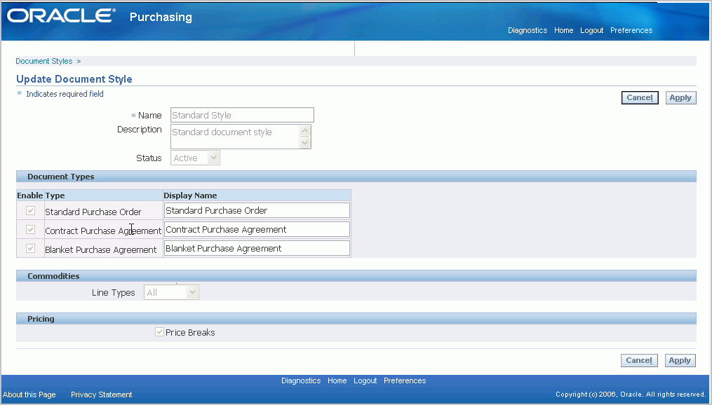

Use the Document Styles window to create and update purchase order styles.
Purchase order document styles allow organizations to control the look and feel of the application to match the usage of the purchasing document. Through reusable document styles, organizations can turn on or off various Oracle Purchasing features, thereby simplifying the user interface. In addition, document styles provide the ability to define purchasing document names that align more closely with the naming conventions of your organization’s business. When a purchasing document is created using a document style, disabled features are hidden.
For example, you can create a document style for a specific commodity, such as temporary labor. This document style optimizes field labels and presentation for that commodity, thereby simplifying purchase order entry.
Prerequisites
To define document styles
Navigate to the Document Styles window.
If you are defining a new document style click Create. To enter changes to an existing style use the Search region to enter the Name, Description, or the Status. Once you have completed one or all of these fields click Go. Enter your changes by clicking the Update icon for your document style.
Note: Once a style has been saved, you can only update the style to be less restrictive.
Enter the Name and Description of the document style. The style name must be unique.
Select the Status as Active for a new style or Inactive for a style you no longer want used.
You must enter a unique Display Name for the Standard Purchase Order. This is the name that appears in the Buyer Work Center.
If you are defining a style that applies to contract purchase agreements or blanket purchase agreements, check their boxes and enter a unique Display Name.
If Services Procurement is implemented, check the Purchase Bases that apply to this document style. See: Defining Purchase Basis.
Select whether specific or all Line Types are enabled for this document style. See: Line Types in Purchasing Documents.
If you are defining a style that includes blanket purchase agreements, enable price breaks using the Price Breaks checkbox.
If Services Procurement is implemented and you have enabled a Temp Labor basis, use the checkbox to enable Price Differentials.
If Services Procurement is implemented, enable the Complex Payments attributes that apply:
Check Advances if advance payments are to be allowed.
Check Retainage if withholding of a portion of the payment until all work under a contract is accepted is to be allowed.
Check Progress Payments to enable partial payments during performance of the contract. If Progress Payments is enabled, at least one pay item must be selected.
Milestone - Enable for payments based on progress events. Enabled by default for Goods line type.
Rate - Enable when payment amount is pro-rated based on the percentage of work completed.
Lump Sum - Enable when payment amount is a fixed amount based on the percentage of work completed.
Enable Treat Progress Payments as Contract Financing if it applies to this style's progress payments.
In the Pricing region, select the Enhance Pricing checkbox if you wish to enable the Pricing Transparency functionality.
Select Deliverable Hold Control check box to initiate payment hold by deliverables under the Controls region.
Deliverable Hold Control is applicable for a Purchasing Document Style with a Document Type of Standard Purchase Order and Complex Purchase Order irrespective of the Pay when Paid check. It enables you to hold a payment independent of Pay when Paid.
Click Apply.

Use the Control Purchasing Periods window to control the purchasing periods defined in the Accounting Calendar window. You use purchasing periods to create journal entries in your general ledger system. Purchasing lets you create journal entries only for transactions you enter in an open purchasing period. You create general ledger journal entries when encumbering requisitions, purchase orders or accruing receipts.
If you use encumbrance or budgetary control, Purchasing verifies that the GL Dates you provide on purchase order distributions and requisition distributions are within an open purchasing period. See: Budgetary Control and Online Funds Checking, Oracle General Ledger User's Guide.
If you use the Center-Led Procurement feature of Oracle Purchasing, you must insure that the purchasing periods remain open in all business units that you are likely to process purchase orders and receipts. See: Setup Center-Led Procurement.
Prerequisites
To control purchasing periods
Navigate to the Control Purchasing Periods window from the menu.
Purchasing displays the Period Status, Period Number, Fiscal Year, Period Name, Begin Date, and End Date for each existing period.
In the Period Status field, you have the following options:
Closed - Use this option to close this purchasing period. When you close a purchasing period, Purchasing does not allow further accruals during this period. Purchasing reverses the status of accrued purchase order lines so that you can accrue them in the next period if you want.
Future - Use this option if you want to open this purchase period in the future. This option is available only when the current status is Never Opened.
Never Opened - Purchasing displays this default status if you have not opened this period in the past.
Open - Use this option to open this purchasing period.
Permanently Closed - Use this option if you do not want to open this period in the future. This option is irreversible.

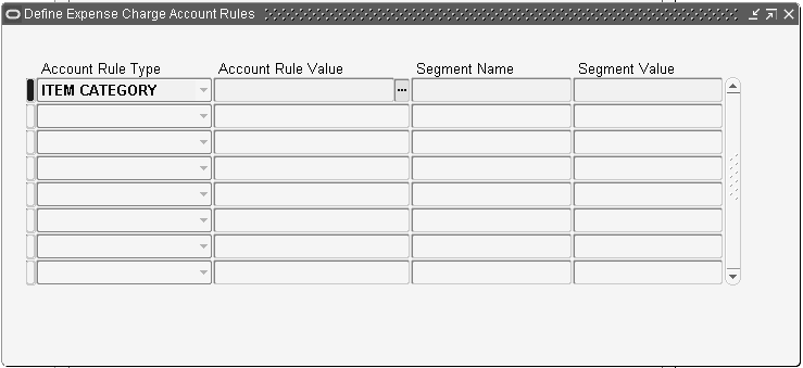

When determining the default charge account for a line with a destination type of expense, the account generator may reference the charge account defined on the employee record. If the account generator references the employee record, then the Expense Charge Account Rules enable you to override one or multiple segments of that default account based on the item category. This ability to override does not interfere with the action of the account generator, but simply replaces those segments you configure after the account generator has created a charge account.
Note: This feature is available for lines containing one-time or inventory items as long as their destination type is expense.
The account segments defined in this window can only be used when the following conditions are true:
Destination type is expense
Purchase order was not created from a requisition
Account was not set in preferences
Account was not successfully derived from project-based rules
Account was not successfully derived from the item setup
Setup Steps
Navigate to the Expense Charge Account Rules window.
Select the Item Category in Account Rule Value. Duplicate rules for the same category are not permitted.
Select the account Segment Name. Duplicate rules for the same account segment are not permitted.
Select the account in Segment Value that you want to override the employee charge account segment for this item category.
Save your work.

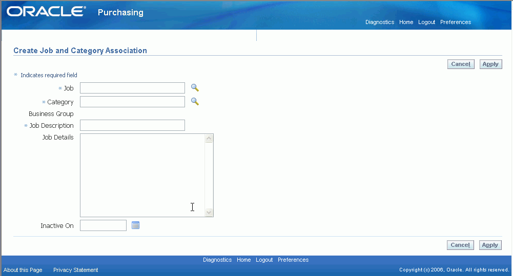

Part of the setup of Oracle Services Procurement is to associate a purchasing category set to an HR job. This is required for the entry of temp labor line types.
Prerequisites
To define associations
Navigate to the Job Category Association window from the menu.
Click Create to define a new association.
You can search for existing associations by selecting Job, Category, or Business group. You then modify the association by clicking the Update icon.
Enter or select the Job.
You can only enter jobs belonging to your business group unless the profile HR: Cross Business Groups is set to Yes.
Enter or select the Category.
Enter a descriptive title in Job Description.
Enter a narrative regarding this job in Job Details.
Enter an Inactive Date.
Save your work.
