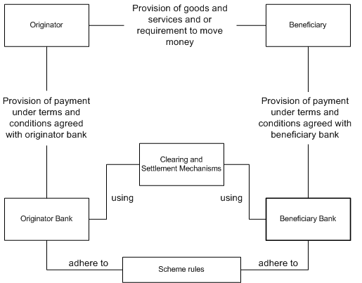

A SEPA Credit Transfer (SCT) is a payment instrument for the execution of credit transfers in Euro between Customers located in the SEPA zone. The SEPA Credit Transfer is executed on behalf of an Originator. The payment is transferred from the Originator’s Bank account to the Beneficiary’s bank account.
The following parties are involved in the process:
The Originator: is the Customer who initiates the credit transfer with the Originator Bank with an instruction. The funds for such a credit transfer is made available by means of a debit from a specified payment account of which the Originator is the account holder. .
The Originator Bank: is the Financial Institution that receives the Credit Transfer Instruction from the Originator and acts on the payment instruction by making the payment to the Beneficiary Bank in favor of the Beneficiary’s account according to the information provided in the instruction and in accordance with the provisions of the SEPA scheme.
The Beneficiary Bank: is the Financial Institution that receives the Credit Transfer Instruction from the Originator Bank and credits the account of the Beneficiary, according to the information provided in the instruction and in accordance with the provisions of the SEPA scheme. The Originator Bank and Beneficiary Bank may be one and the same Financial Institution.
The Beneficiary: is the Customer identified in the Credit Transfer Instruction who receives the funds by means of a credit to its payment account.
Demand for payment services using a customer credit transfer arises from an Originator, who wishes to transfer funds to a Beneficiary. While a bank provides the payment service, the underlying demand and its nature are outside the control and responsibility of the banking industry or any individual bank.
For this requirement to transfer funds to be satisfied, the bank holding the account of the Originator must have the means necessary to remit funds to the bank holding the account of the Beneficiary and in the process be provided with the necessary information to accomplish the transfer.
If the Originator has sufficient funds or sufficient credit with which to execute the credit transfer, if the Originator is acting within its authority and the credit transfer does not break any applicable legal, regulatory, or other requirements, including requirements established by the Originator Bank, then the Originator Bank makes the payment and advises the Originator accordingly.
If the bank holding the account of the Beneficiary, the Beneficiary Bank, has agreed to both the method and the rules for receiving the payment information as well as the method and the rules for receiving the payment value, then the transfer exists.
Based on these transfers the Beneficiary Bank uses the information received to credit the account of the Beneficiary, makes the funds available and informs the Beneficiary what has been applied to its account.
The purpose of inter-bank Clearing and Settlement is to correctly exchange information and to safely exchange value. The demand for Clearing and Settlement services stems from the need to transfer money between banks.
