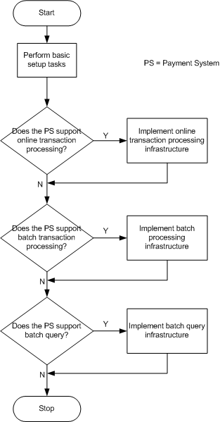

To determine what tasks you need to perform for your custom integration, see the flowchart below.

Use the flowchart below to determine what tasks you need to perform for your custom integration.
