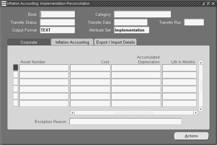

You can reconcile your prepared data with your actual General Ledger balances when the data preparation process is complete. The Inflation Accounting: Implementation Reconciliation window shows the asset balances for the inflation accounting figures for each category when the data preparation process has successfully completed. You can modify all balances, except Oracle Assets historic balances, to reflect the actual balances in the General Ledger. When the balances for all assets in a chosen category are reconciled, users can transfer the balances to the new inflation accounting system.
Some assets in the Inflation Accounting: Implementation Reconciliation window are highlighted. These assets are flagged as exceptions. The exception reason is displayed at the bottom of the window. These exceptions may be displayed:

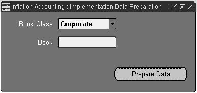

To prepare corporate or tax book data for implementation:
Navigate to the Inflation Accounting: Implementation Data Preparation window.
To prepare corporate book data for implementation, in the Book Class field, select Corporate.
To prepare tax book data for implementation, in the Book Class field, select Tax.
In the Book field, select the book name.
Note: If Tax is selected in the Book Class field, only MHCA enabled tax books are displayed; if Corporate is selected, only corporate book names are displayed.
Click Prepare Data.
To reconcile prepared data with actual General Ledger balances:
Navigate to the Inflation Accounting: Implementation Reconciliation window.
Query the book and category to be reconciled.
Enter the book and category names.
Run the query.
All assets related to the chosen book and category combination are displayed in the tabbed regions.
Note: If the Transfer Status field indicates the transfer is COMPLETED or RUNNING, all fields in the tabbed regions are display only. If the Transfer Status field indicates that the transfer is NOT TRANSFERRED or ERROR, you can update any of the fields on the Inflation Accounting tab.
Select the Inflation Accounting tab.
In the Revalued Cost field, optionally enter the revalued asset cost.
In the Net Revaluation Reserve field, optionally enter the net revaluation reserve after the effect of cost backlog and general fund.
In the Backlog Accumulated Depreciation field, optionally enter backlog depreciation.
In the Revalued YTD Depreciation field, optionally enter year-to-date depreciation after revaluation.
Note: These values are displayed:
Assets entered in a prior fiscal year to the use of implementation process: Revalued YTD = Oracle Assets' year-to-date depreciation + linear split of Inflation Accounting revalued year-to-date depreciation.
Assets entered in the current fiscal year of implementation processing: Revalued YTD= Oracle Assets' year-to-date depreciation + Inflation Accounting revaluation of Oracle Assets' year-to-date depreciation.
In the Revalued Accumulated Depreciation field, optionally enter accumulated depreciation after revaluation.
In the Operating Account Cost field, optionally enter the operating cost account after revaluation.
In the Operating Account Backlog field, optionally enter the operating account backlog after revaluation.
In the General Fund field, optionally enter the general fund after revaluation.
Select the Export/Import tab.
Optionally enter the export filename and date.
Note: Only displayed if export data process successfully exported balances for assets.
Optionally enter the import file name and date.
Note: Only displayed if import data process successfully imported balances for assets.
Run the query.
To export balances for all assets for the chosen book and category, click Export Data.
Note: The export data process can be run as many times as required for the same category.
To import balances for all assets for the chosen book and category from files created by the Export Data process, click Import Data.
Note: This button is only enabled if data exists for the category previously exported.
Note: The import data process can be run as many times as required for the same category. The original balance figures created by the data preparation process are overwritten each time the process is run.
To generate the Inflation Accounting: Implementation Reconciliation Report, click Report.
To transfer inflation accounting asset balances to the new inflation accounting system, click Transfer to Inflation Accounting.
Note: This process can only be run once for each category.
The Note pop-up window appears displaying the Transfer Implementation Data concurrent request ID.
