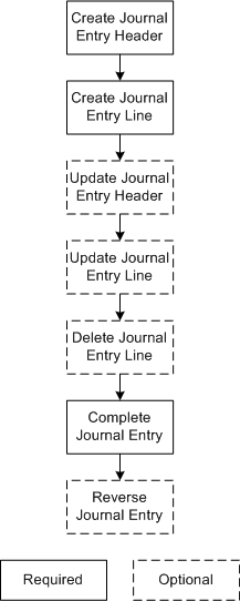

The figure below shows the create and complete manual journey entry process and is described in the following text.
Create and Complete Manual Journey Entry
The create and complete manual journal entry process includes the following steps:
Create journal entry header by calling CREATE_JOURNAL _ENTRY_HEADER API.
Create journal entry line by calling CREATE_JOURNAL_ENTRY_LINE API.
Optionally, update the journal entry header by calling UPDATE_JOURNAL_ENTRY_HEADER API.
Optionally, update the journal entry line by calling UPDATE_JOURNAL_ENTRY_LINE API.
Optionally, delete the journal entry line by calling DELETE_JOURNAL_ENTRY_LINE API.
Complete the journal entry by calling COMPLETE_JOURNAL_ENTRY API.
Optionally, reverse the journal entry by calling REVERSE_JOURNAL_ENTRY API.
Users can delete the journal entry at anytime by calling DELETE_JOURNAL_ENTRY API if the journal entry is not transferred to General Ledger.
