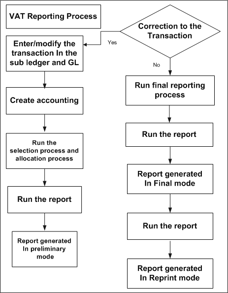

The VAT reporting process involves the steps shown in the following diagram:
To generate VAT reports, you must complete the following steps.
Note: Not all VAT reports support the final reporting mode. Hence, you need not run the EMEA VAT: Selection process, allocation process or final reporting process for the following reports:
French Deductible VAT Declaration Report
German Payables VAT Reconciliation Detail Report
German VAT for On-account Receipts
Italian Generate Annual Customer and Supplier Listing Report
Portuguese Suppliers Recapitulative Extract File
Portuguese Suppliers Recapitulative Report
Portuguese Customers Recapitulative Report
Portuguese Customers Recapitulative Extract File
Select the tax transactions. See: Running the EMEA VAT Selection Process
Allocate tax and taxable box number to tax transactions, if this is applicable to your country or tax reporting requirements. See: Running the EMEA VAT Allocation Process
Generate preliminary reports using the Submit Request window. See the individual report descriptions in this chapter. VAT reports, which are run for an open tax period (final reporting process not run for this particular period), are considered preliminary reports and are printed with a Report Type: Preliminary. You can run preliminary reports more than once. The preliminary tax reports enable you to run a trial version of the reports to verify and correct data before reporting to the tax authorities.
Process final reports. See: Running the Final Report Process
Generate the final reports using the Submit Request window. See the individual report descriptions in this chapter.
Reprint final reports using the Submit Request window. You can run reprints more than once.

If there is any error, then modify the transaction to correct the error and run the EMEA VAT Selection and EMEA VAT Allocation processes. If there is an error in the allocation rules, then correct the rules and run the EMEA VAT Allocation process.
Run the EMEA VAT: Final Reporting Process in the Submit Request window for stamping all the tax transactions as final.
If you make changes to the transaction before running the final process, then you must run the EMEA VAT Selection and EMEA VAT Allocation processes (if your country has enabled Allocation). Additionally, you must run the preliminary reports. Repeat this process until the report data is correct and then run the EMEA VAT Final Reporting process.
You cannot change any data in the transaction after running the final process and the application closes the tax period. After completing the final process, you can run individual reports in the final and reprint mode.
