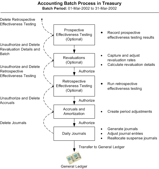

The Treasury accounting process creates company journal entries and transfers journal entries from Treasury to General Ledger. This process comprises the following steps, some of which are optional:
Prospective hedge effectiveness testing (optional)
Perform revaluations (optional)
Retrospective hedge effectiveness testing (optional)
Generate accruals and amortizations
Generate daily journals
Transfer journals to General Ledger
You can automate the Treasury accounting process by running the Accounting Streamline Processing concurrent program. You can link any of the four steps together in a sequence and the program can be scheduled during non-business hours without any user intervention. The program also lets you run the accounting process in batch mode for either a single company or for all the companies available based on your user access level. For more information, see: Streamline Accounting Process.
This figure illustrates the Treasury accounting process.
You can post journal entries for cashflow amounts (that is, non-revaluation and non-accrual journal entries) on a daily or weekly basis, and post journal entries for your revaluation/accrual deals on a separate timeline. The posting of cashflow amounts does not require performing revaluations or generating accruals prior to generating daily journals.You choose, for each company in Treasury, whether to start the accounting process at revaluations or accruals by setting the Accounting - Perform Deal Revaluations company parameter. For more information on setting company parameters, see: Company Profiles. If you set the Accounting - Perform Deal Revaluations company parameter to Yes, then you must perform revaluations.
If you choose to perform revaluations, you can additionally choose whether to perform hedge effectiveness testing as a part of your accounting process by setting the Accounting - Perform Hedge Effectiveness Testing company parameter. For more information on setting company parameters, see: Company Profiles, page 2-1. If you set the Accounting - Perform Hedge Effectiveness Testing company parameter to Yes, then you must start your accounting process with prospective hedge effectiveness testing.
You choose to create journal entries either for all transactions or for validated transactions only by setting the Validation Required for Accounting system parameter. See: System Parameters for more information.
You start the accounting process by creating an accounting batch. An accounting batch consists of a batch ID, a batch period (date range for the transactions included in the batch), and a set of transactions that fall within the batch period. If you perform revaluations, the set of transactions that fall within the batch period depends on the accounting method your company uses. For more information on choosing an accounting method, see: the Accounting - Trade / Settlement Date Method company parameter in Company Profiles.
You can create an accounting batch and generate journals in one step for non-revaluation and non-accrual journal entries. If you are performing revaluations and/or generating accruals, then after you create an accounting batch, you must authorize the batch at each step of the accounting process. For example, once you complete revaluations you must authorize the batch before you can begin accruals for that same period. Similarly, the accruals batch must be generated and authorized before you can generate any journals for that date range.
You cannot change or delete an authorized accounting batch because it may affect the accounting process. If you have authorized the revaluations and accruals for a batch, you can only delete the batch or make any changes to the revaluations for the batch after you un-authorize both the revaluations and accruals. If you want to make changes to the accruals, you must first un-authorize the accruals.
Important: Once a batch has been transferred to General Ledger, you cannot un-authorize, make changes, or delete the batch.

The start and end dates of the batch period are automatically populated based on the end date of the previous batch and the length of the periods that are defined in the company accounting calendar. Typically a period is one month. You can edit the period end date as required. For example, you can create a batch period of one day or two weeks in length. The first time you create a batch, the start date for the batch period is the date of the oldest transaction and the end date is the current system date.
The dates covered by batch periods must be consecutive, unique and gapless. Each date must appear in a batch, and the same date cannot appear in two different batches. For example, if you create a batch for the period June 1 to June 15, you cannot create another batch for the period June 1 to June 30, or start the next batch on June 17. Instead, you must either create another batch that covers all of the remaining dates (for example, a batch for June 16 to June 30) or delete the existing batch and create a new batch that covers all of the dates (June 1 to June 30).

Revaluation is the process of adjusting the rates and prices of your financial instruments to reflect the current market value and calculate the realized or unrealized profit and loss.
Revaluation is an optional step in the accounting process. If you set the Accounting - Perform Deal Revaluations company parameter to Yes, you must perform revaluations as part of the accounting process. If you set the parameter to No, you cannot perform revaluations. For more information on setting company parameters, see: Company Profiles.
When you perform revaluations, you:
Define the end date for the accounting batch period. If this is your first ever accounting batch for this company, you will also need to define the batch start date.
Capture the rates that you want to use to revalue the batch from the Current System Rates window.
Review and adjust the revaluation rates, as required.
Calculate your mark-to-market and currency gain or loss revaluations. The currency gain or loss is calculated using the GL daily rate.
Authorize the revaluations.

You can recalculate revaluations as often as you want. Once you are satisfied with the revaluation results, you must authorize them before you can move to the next step in the accounting process. You cannot change revaluations once they are authorized.
To change authorized revaluations, you must first reverse any authorizations that exist for the batch. For example, if you authorized the revaluations and accruals for a batch, then you must un-authorize the accruals and revaluations before you can change the revaluations for the batch. You cannot recalculate revaluations for a batch once you have transferred the daily journals for the batch to General Ledger.

Accruals are the first mandatory step in the accounting process. If your company set the Accounting - Perform Deal Revaluations company parameter to Yes, then you must perform revaluations before you can perform accruals. See: Revaluations.
You cannot perform accruals on individual deals. Instead, you must perform accruals in batches. For each batch that you accrue, you must:
Define the start and end dates for the batch, unless the batch is already defined.
Create the period adjustments for the accrual.
Authorize the accrual for the batch.
You can adjust the accruals for a batch up until the point when you transfer your daily journals to General Ledger. For more information, see: Transferring Journals to General Ledger. You must authorize your accruals adjustments before you proceed to the next step in the accounting process, Daily Journals. See: Daily Journals.

Use the Daily Journals window to generate the daily journals for an accounting batch, view the generated journal entries, change the dates or GL accounts for your journal entries, and reallocate suspense journal entries to a GL account.
After you enter and verify all accounting changes for the journal, use the Transfer Journals to GL window to transfer your journals from Treasury to General Ledger. Once you transfer your daily journals to General Ledger, you cannot change any of the accounting for the batch in Treasury.
Use the Daily Journals window to generate daily journal entries for an accounting batch. Daily journals are generated based on the deals in the accounting batch and the journal entry actions that you set up in the Journal Entry Actions window. See: Journal Entry Actions.

Use the Streamline Accounting Process to automate the routine accounting closing process for deal revaluation, hedge effectiveness testing, accruals, generating journals, and transferring journals to the general ledger into a single process. You can link any or all of the steps together in a sequence and run in a concurrent program which executes each individual accounting process for the specified company or companies. You can schedule the concurrent program in batch mode during non-business hours without any user intervention.
You can run the Streamline Accounting Process for either a single company or for all the companies available based on your user access level. A separate concurrent request is submitted for each company you have access to. Each company has its own concurrent request log which lists warning messages and error messages. If there are any warning messages or error messages, you need to review the concurrent request log to determine the error.
Use the Submit Request window to run the Accounting Streamline Processing Program. For more information, see: Submitting Requests.
Report Parameters
Company: The treasury companies you have access to as defined by the User Access Level. If the field is left blank, the system processes all treasury companies that you have access to.
Batch End Date: The batch ending date. The default is the current system date.
Start Process From: The starting point for the accounting process. The choices are:
Revaluations: Start process from revaluation rates capture.
Retrospective Testing: Start process from retrospective hedge effectiveness testing.
Accruals: Start process from accrual generation.
Daily Journals - Generation: Start process from journal generation.
Daily Journals - Transfer to GL: Start process from journal process.
Important: The company parameter Accounting - Perform Deal Revaluation affects the results of the Streamline Accounting Process. If you set the parameter to No, no revaluations would be performed by the program.
End Process After: The ending point for the accounting process. The choices are:
Revaluations: End process after revaluation details are authorized. This value can be selected if the Start Process From is Revaluations.
Retrospective Testing: End process after retrospective hedge effectiveness testing details are authorized. This value can be selected if the Start Process From is Revaluations or Retrospective Testing.
Accruals: End process after accrual details are authorized. This value can be selected if the Start Process From Revaluations, Accruals or Retrospective Testing.
Daily Journals - Generation: End process after journals are generated. This value can be selected if the Start Process From is Revaluations, Accruals, Retrospective Testing or Daily Journals - Generation.
Daily Journals - Transfer to GL: End process after journals are transferred. This value can be selected for any of the Start Process From options.
Warning: Verify your work before you transfer the journal entries to General Ledger. It is important to review the accounting information before you transfer journals, because once a journal is transferred to General Ledger, you cannot make any changes to the journal.
Journals in Closed Periods: Sets the method to handle journal entries that fall into a closed period. This field is enabled only if the End Process After parameter is set to Daily Journals - Transfer to GL. The choices are:
No change: The journal entry date is left as is and transferred to General Ledger.
Next open: The journal entry is the first date of the first open accounting period and then transferred to General Ledger.
