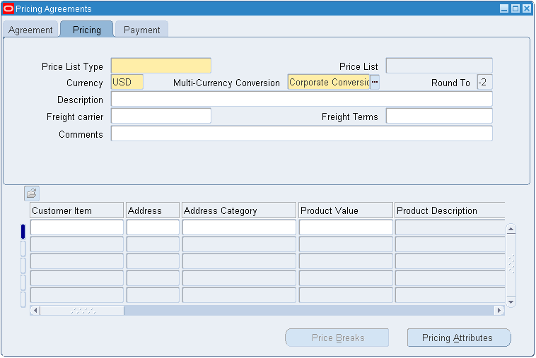

To attach the multicurrency conversion list to an agreement
Navigate to the Pricing Agreements window.
Enter Agreement Type: Standard or Agreement.
For standard agreements, you must select a price list. The base currency, rounding factor, and multicurrency conversion attached to that price list default to the window.
For agreement price lists, in the Pricing tab, select a multicurrency conversion.
For Agreement price lists, you can select lists where the base currency of the multicurrency conversion list is the same as the base currency of the agreement. When multicurrency is enabled, the Rounding Factor field in the agreement is grayed out; you can update it only in the attached multicurrency conversion.
Save your work.
