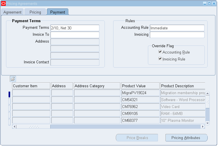

In the Payment tab
Select the Payment tab.
Pricing Agreements window
Select the payment terms:
When you enter a sales order in Oracle Order Management, and the agreement uses a standard price list, the payment terms default from that price list. You can override the price list terms on the agreement.
When you enter a sales order in Oracle Order Management, and the agreement uses an agreement price list, the payment terms default from those that you enter in this field.
Enter the bill-to name in the Invoice To field.
Enter a bill-to adress in the Address field.
Enter the bill-to contact in the Invoice Contact field.
In the Rules region, select a default accounting rule.
Select the invoicing rule:
Accounting and invoicing rules are set up in Oracle Receivables.
In the Override Flag region, the override check boxes for the Accounting and Invoicing Rules are for information only.

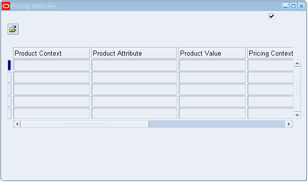

To define pricing attributes
Click Pricing Attributes in the Pricing Agreements window to display the Pricing Attributes window.
The Product Context, Product Attribute, and Product Value default from the Agreement Line that you are entering.
Complete the Pricing Context, Pricing Attribute, and Value From/To fields.
Save your work.
Note: The pricing attributes are joined as AND conditions because they apply to one price list line.

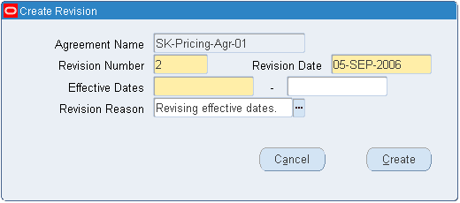

Click Create Revision to display the Create Revision window.
The Agreement Name defaults from the original agreement. Although you cannot change the agreement name, you can change the revision number. The Revision Date value defaults to the current date.
In the Revision Number field, identify the version of the agreement you are creating. This helps you track and manage different revisions of the agreement.
Enter the effective start and end dates for the agreement. Date ranges cannot overlap, and only one revision can be in effect for a given range of effective dates.
In the Revision Reason field, select a reason that describes why you are revising the agreement.
Click Create to display the new agreement in the Pricing Agreements window. The new revision number displays in the Revision field.

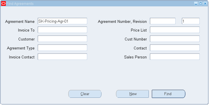

Use the Find Agreements windows to find agreements or agreement revisions by one or more of the following criteria: Agreement Name, Agreement Number/Revision, Invoice To, Price List, Customer, Cust Number, Agreement Type, Contact, Invoice Contact, or Sales Person.
To find agreements
Navigate to the Find Agreements window.
Enter your search criteria.
When you have completed your entries, click Find to display the search results.
Note: To create a new agreement, click the New button.
