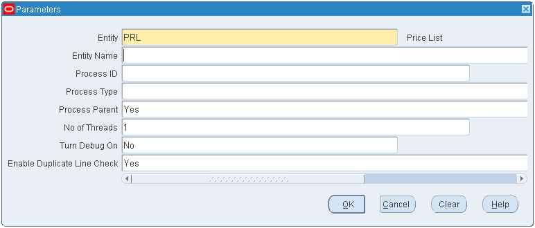

In the Submit Request window, Name field, select QP: Bulk Import of Price List.
Report Parameters
QP: Bulk Import of Price List Parameters
Entity: Indicates which pricing entity is to be processed. The default value is PRL (price list).
Entity Name: This is an optional parameter. Enter the name of the price list to be processed. If this field is left blank, the system processes all entities of the selected entity type that are available for processing in the interface tables.
If you enter a price list name, that price list is considered for import even if it failed in a previous import and regardless of the other flags (for example, even if PROCESS_ STATUS_FLAG not equal to P, or PROCESS_FLAG not equal to Y or REQUEST_ ID not equal to NULL in the QP_INTERFACE_LIST_HEADER record).
Process ID: This value corresponds to the process_id in the interface tables. The Process ID groups data in the interface table. You can select criteria to specify which records to process.
If this field is left blank, all available records for processing are considered subject to the restrictions entered in the Entity Name field.
Process Type: This field corresponds to the process type that is listed in the interface tables such as XML. If specified, the bulk loader processes only the records with PROCESS_TYPE column matching the value entered here.
Process Parent: Select Yes (the default) or No to determine if the loader should process a price list line when validation for a child pricing attribute fails. Valid values are Yes (the default) and No.
No of Threads: Enter a number that indicates the total number of child processes or threads to achieve multithreading for list lines and their child records. The default value is 1.
Multithreading occurs when the child concurrent processes are initiated after a user submits the Process Parent request. The parent process first processes the list header records and then the qualifiers records before spawning child processes. The child processes upload price list lines and attributes.
Note: Multithreading can impact the length of processing time that is required; therefore, you should not exceed the number of Central Processing Units (CPUs) that are available when running the program. Ideally, you should schedule this process for a slow processing period or when few users are on the system.
Turn Debug On: Select Yes or No (default):
Select No to improve loading performance; however error messages are not sent to the Debug log.
Select Yes to have all error messages sent to the Debug Log.
The Debug On parameter controls only the log files. However, error messages, number of records processed, and other related information is written to the output file, regardless of the value set for Debug On.
Enable Duplicate Line Check: The bulk loader can upload thousands of lines into the pricing (QP) lines table. If Enable Duplicate Line is set to Yes, then the QP: Bulk Import of Price List checks for duplicates lines and displays an error message if duplicate lines are found. If it is set to No, then the duplicate check is not done. The default value is Yes.
