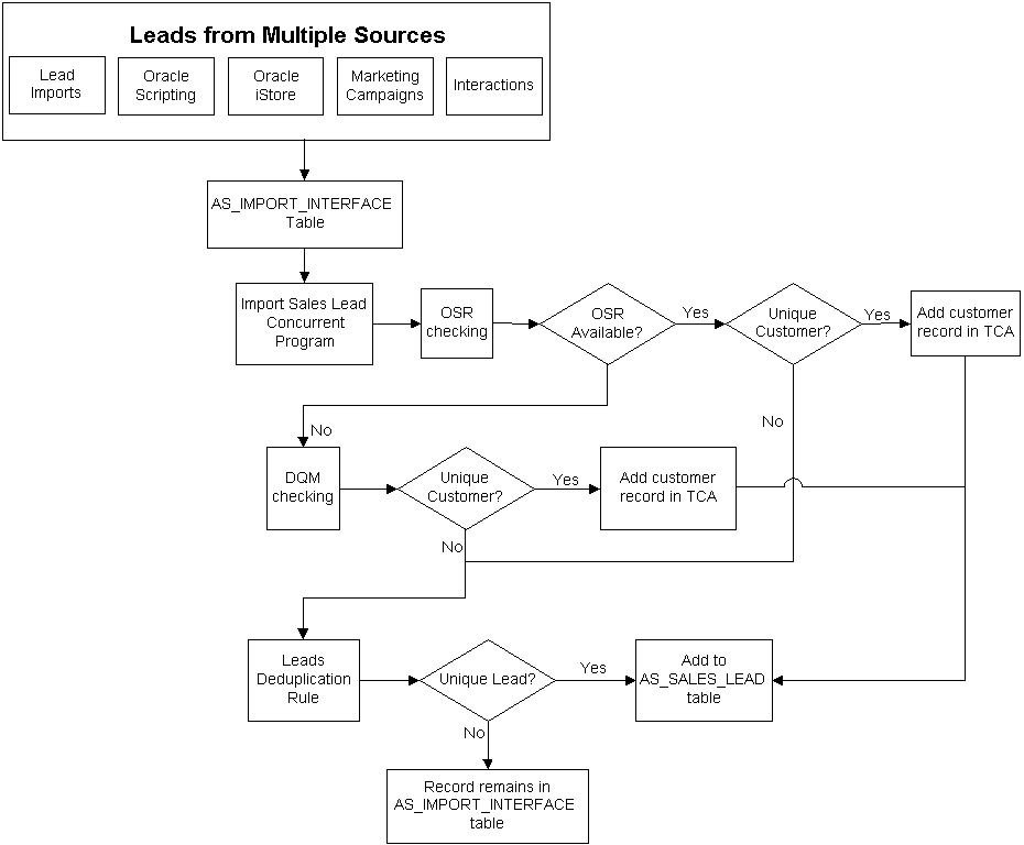

Figure: Business Flow for Capturing and Cleaning Leads gives the flow of leads after they are stored in the AS_IMPORT_INTERFACE table. For more information on the import process, see Capturing and Cleaning Leads.
Leads enter Oracle Leads Management from multiple sources: Lead Imports, Oracle Scripting, Oracle iStore, Marketing Campaigns, and Interactions. The lead records are stored in the AS_IMPORT_INTERFACE table.
The Import Sales Lead concurrent program processes each lead record in the AS_IMPORT_INTERFACE table in the following order and manner:
The lead record is checked for the existence of Original System Reference.
Next, Data Quality Management (DQM) checks if a customer record for the lead already exists in TCA. If a record does not exist, then a new record is created in TCA.
After DQM, the record is run through the Leads Deduplication rule to check if the lead record exists in the AS_SALES_LEAD table. If it does not exist, then the record is added to the AS_SALES_LEAD table.
