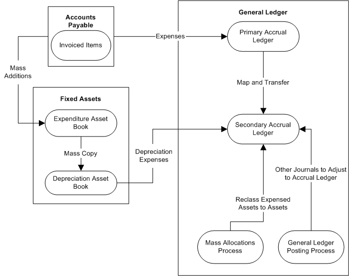

The diagram below shows an overview of the integration between Payables, Assets, and General Ledger under the GASB 34/35 asset accounting process as described in the GASB 34/35 Asset Accounting Process table.
GASB 34/35 Asset Accounting Process Flowchart
The table below describes the GASB 34/35 asset accounting process.

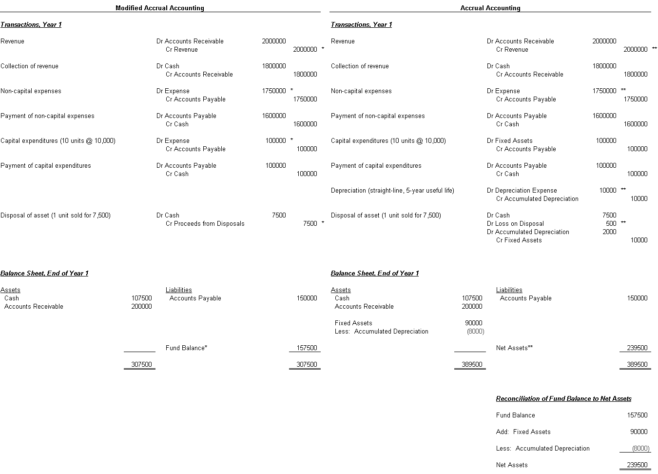

The example below shows how the differences between modified accrual and accrual accounting affect the respective balance sheets.
This example depicts the accounting treatment of the same series of business transactions using the modified accrual and accrual bases of accounting. The basis for the modified accrual accounting shows a Fund Balance of $157,500 and the basis for the accrual accounting shows Net Assets of $239,500.
Capital expenditures, which are expensed in modified accrual accounting, are recorded as assets and depreciated in accrual accounting. Asset disposals are also accounted for differently. The reconciliation of the Fund Balance to Net Assets takes the Fund Balance of $157,000, adds the Fixed Assets value of $90,000, and deducts the Accumulated Depreciation of $8,000. This equals the Net Assets value of $239,500.
Modified Accrual Versus Accrual Asset Accounting Example
