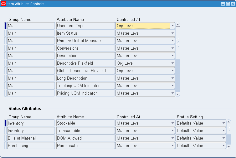

Item attributes are information about an item, such as order cost, lead time, and revision control.
One of the prerequisites for defining items (and assigning values to item attributes) is setting attribute controls.
This attribute control type determines whether you have centralized (Master level) or decentralized (Organization level) control of item attributes.
Attributes maintained at the Master level have the same attribute values in each organization in which an item is assigned. For example, you maintain an item's primary unit of measure at the Master level.
Attributes maintained at the Organization level may have different attribute values in different organizations. For example, an item may be min-max planned in a distribution organization but material requirement planning (MRP) planned in a production organization.

You can change the control level of some attributes in special cases, or in certain circumstances. The following table shows attributes with conditionally updateable control levels and the consequences of changing the attribute control level:

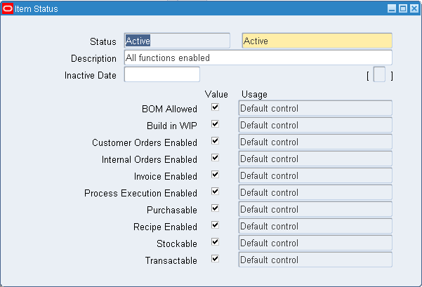

Status control describes whether certain status attributes have default values that appear when you assign a status code to an item, and whether status codes control those attribute values after the defaults are assigned to an item.
Note: Item Status Control differs from material status control. Item status control controls the action you can perform on an item, such as purchasing or stocking an item. Material Status controls the transactions you can perform on an item. See Overview of Material Status for more information about material status control.
The status attributes are:
BOM Allowed
Build in WIP
Customer Orders Enabled
Internal Orders Enabled
Invoice Enabled
Transactable
Purchasable
Stockable
Recipe Enabled
Process Execution Enabled

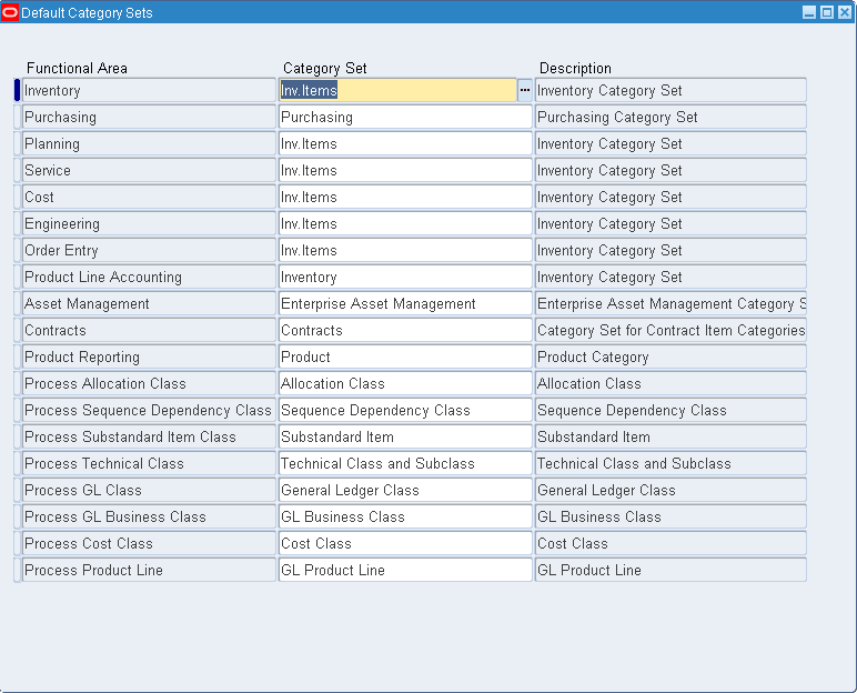

An item-defining attribute identifies the nature of an item. What designates an item as an engineering item is the attribute Engineering Item, but what controls the functionality of the item is the collection of attributes that describe it. You can buy an engineering item if you want to; set Engineering Item, Purchased, and Purchasable to Yes.
The following table presents item defining attributes:
| Functional Area | Item Defining Attribute |
| Oracle Inventory | Inventory Item |
| Oracle Purchasing | Purchased, or Internal Ordered Item |
| Oracle Master Scheduling/MRP and Oracle Supply Chain Planning | MRP Planning Method |
| Oracle Cost Management | Costing Enabled |
| Oracle Engineering | Engineering Item |
| Oracle Order Management | Customer Ordered Item |
| Oracle Service | Support Service, or Serviceable Product |
When you set an item defining attribute to Yesthe item is automatically assigned to the default category set of the corresponding functional area. For example, if you set Inventory Item to Yes the item is automatically assigned to the default category set for the Inventory functional area.
Related Topics
Defining Default Category Sets

Status attributes enable and disable the functionality of an item over time. Each status attribute allows you to enable the item for a particular use. For example, if you set the status attribute Purchasableto Yes, you can put the item on a purchase order.
The status attributes are related to the item defining attributes. You cannot enable a status attribute if you do not set the corresponding item defining attribute to Yes.
The following table presents status attributes:
| Status Attribute | Item Defining Attribute | Functional Area / Oracle Product | Functionality |
| Stockable | Inventory Item | Inventory | Enables you to store the item in an asset subinventory. |
| Transactable | Inventory Item | Inventory, Order Management, Purchasing, Work in Process | Enables you to transact the item in Oracle Inventory, Oracle Order Management, Oracle Purchasing and Oracle Work in Process. |
| Purchasable | Purchased | Purchasing | Enables you to place the item on a purchase order. |
| Build in WIP | NA | Work in Process | Enables you to build the item on a discrete job, a repetitive schedule, or both. |
| Customer Orders Enabled | Customer Ordered Item | Order Management | Enables you to place the item on a sales order. |
| Internal Orders Enabled | Internal Ordered Item | Inventory, Order Management, Purchasing | Enables you to create an internal sales order for the item |
| BOM Allowed | Inventory Item | Bills of Material | Enables you to create a bill of material for the item |
| Invoice enabled | Invoiceable Item | Receivables | Enables you to create an invoice for the item |
| Recipe Enabled | NA | Process Manufacturing | Enables you to create a recipe or formula for this item in process manufacturing. |
| Process Execution Enabled | Inventory Item | Process Manufacturing | Enables you to use the item in a production batch as an ingredient, product, or by-product. |
You set status control for a status attribute with the Item Attributes Control window.
Interdependencies for Status Attributes
Each status attribute is dependent on the value of at least one other attribute. For example, you cannot set Stockable to Yes if you set Inventory Item to No. The following table presents interdependencies for the status attributes:
| Attribute | Must be set to | If |
| Stockable | No Yes | Inventory Item is set to No ASL is VMI enabled |
| Transactable | No Yes | Stockable is set to No ASL is VMI enabled |
| Purchasable | No | Purchased is set to No |
| Build in WIP | No | Inventory Item is set to No OR BOM Item Type is NOT set to Standard |
| Customer Orders Enabled | No | Customer Ordered Item is set to No |
| Internal Orders Enabled | No | Internal Ordered Item is set to No |
| BOM Allowed | No | Inventory Item is set to No |
| Invoice Enabled | No | Invoiceable Item is set to No |
| Process Execution Enabled | No | Inventory Item or Recipe Enabled Flag is set to No |
When defining an item, you can use the item attribute Item Status to control status attribute values. You determine the list of values for the Item Status attribute by defining Item Status codes. An Item Status code has a user-defined set of Yes and No values for the status attributes. The values are applied to the status attributes when you choose an Item Status code when defining an item. For example, assume that you define an Item Status named Prototype with all status attributes set to Yes except for Customer Orders Enabled. Next, you define another item status, Active, with all status attributes set to Yes. In the beginning of a product development cycle, assign the status code Prototype to an item so that you cannot place the item on a sales order. Later, assign the status code Active to allow all functions for the item. See: Defining Item Status Codes.
Use pending statuses to automatically update an item's status on a specified date. For each item, specify a list of pending statuses and the corresponding effective dates. See Defining and Viewing Pending Statuses.

You can choose between centralized and decentralized control of item attributes. The control level you define for an attribute applies to all items. Defining attribute controls does not determine the value of an attribute, only the level at which it is controlled. You assign values to the attributes when you define an item.
Important: Oracle strongly recommends that you create only one Item Master organization. Assign all other organizations to this master. This allows you to associate the same item with a variety of assigned organizations-eliminating the need to replicate identical items between organizations. This documentation assumes you are using a single Item Master.
To define item attribute controls
Navigate to the Item Attribute Controls window.
Scan the information displayed in the Group Name and Attribute Name fields to locate the desired attribute.
The Group Name field displays the name for a group of attributes. Attributes are grouped by function, such as Main, Inventory, and Receiving. When you define or update items, define templates, or view item attributes, you can display the attributes for a particular group. This makes it easier to locate a specific attribute.
Select a control level for the attribute.
Master Level: Define and maintain this attribute at the Master level. For the same item, the values of this attribute are identical across all organizations.
Org Level: Define and maintain this attribute at the Organization level. For the same item, each organization may define a different value for this attribute.
Important: Some attributes can only be set at a specific level. In these cases, you have only one option. See: Master Level vs. Organization Level.
Choose a status setting for each status attribute.
Defaults Value: Value of this attribute, as defined by the status code, defaults when you assign the status to an item. You can change this default value.
Not Used: Use neither default nor status control.
Sets Value: Value of this attribute, as defined by the status code, defaults when you assign the status to an item. Once assigned, you cannot change the default.
Save your work.

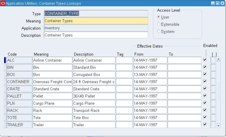

Container Types are used in defining physical attributes of items.
To define a container type
Navigate to the Container Types window from the menu.
Enter a unique container type name.
Enter a description of the type.
Save your work.
To make a container type inactive
You can delete a container type if it has not been used in defining physical attributes for an item.

You can use statuses to provide default values for certain item attributes to control the functionality of an item. When you update the values for a status, all items to which it is assigned are also updated.
Important: When your current organization is not the Item Master organization, the organization is temporarily changed to the Item Master organization until you exit this window. You can use the statuses created here in all defined organizations.
A status code controls certain item attributes designated as status attributes. The status attributes are:
BOM Allowed
Build in WIP
Invoice Enabled
Transactable
Purchasable
Stockable
Recipe Enabled
Associated with each status attribute is a Status Setting option. This option determines whether a status attribute value is set by the status code and is not updatable, defaulted and updatable, or not used when you define an item. You choose a Status Setting for a status attribute with the Item Attributes Controls window. You assign a status code to an item when you define the item. See: Status Attributes and Item Status Control.
To define an item status
Navigate to the Status window.
Enter a unique name for the status code.
For each attribute, use the Value option to indicate the functionality that is controlled by the status code.
Save your work.
To delete an item status
You can delete a status if it has not been used.
To make an item status inactive
Enter the date on which the item status becomes inactive.
As of this date, you can no longer assign this status to an item. The status remains valid for items to which it is already assigned.
Related Topics

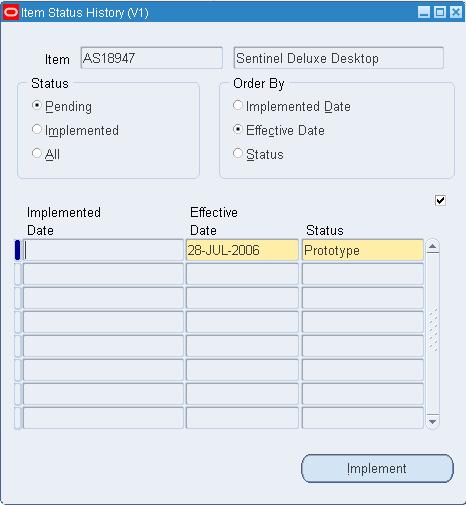

You can assign one or more pending statuses for an item, to be implemented on future dates. These statuses become effective on their assigned effective dates. You can also view the history of an item status.
To create a pending status
Navigate to the Master Items Summary window and select an item.
Choose Pending Status from the Tools menu to navigate to the Item Status History window.
Enter the effective date. This is the date on which the pending status becomes effective for the item.
Enter the name of the status to be implemented on the effective date.
Save your work.
To update an item with a pending status
Select a pending status.
Choose Implement to submit the process.
Note: You can also submit the request from the All Reports or Pending Status window by entering Update item statuses with pending statuses in Name field. Enter an item and organization (if necessary), and choose Submit.
To view status history
View the information in the Implemented Date, Effective Date, and status Name fields.
Related Topics

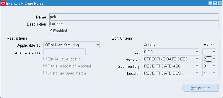

You can create picking rules that enable you to sort picks based on criteria that you define for sales orders, process manufacturing batches, or work in process jobs. Oracle Inventory reviews the picking criteria order and the options for each criterion.
After you create a picking rule, you use the rules workbench to assign the rule to a particular item.
Navigate to the Picking Rules window.
Enter a unique name and description for the rule.
Select the picking restriction. The available choices are sales order, process manufacturing, and work in process.
Enter the shelf life days if applicable. If you enter a value in this field, then the system allocates the material the number of days that you enter in the Shelf Life Days Item Master window field before the lot expires. For example, if an item is set to expire in ten days, and you enter four days in the Shelf Life Days field, then the system allocates the material at least four days before the material expires.
Select Single Lot Allocation, to allocate only a single lot for this rule. If you do not select this check box, the system may use this rule to allocate more than one lot.
Select Partial Allocation Allowed to accept a partial allocation of a lot. If you do not select this check box, then the system allocates only one lot when using this rule.
Note: Single lot allocation controls whether the system can allocate multiple lots for a particular demand. Partial lot allocation controls whether the system can allocate quantities of a lot less than the total lot quantity available.
Click Customer Spec Match to require quality specification matching.
Select the sort criteria for the rule. You can rank sort criteria to determine the importance level for that criterion. For example a criterion ranked 1 is higher in value than a criterion that is ranked 3. The sort criteria are:
Lot: You can sort by lot based on the following criteria:
Lot Number Asc: Sorts the lot by number in ascending order.
Lot Number Desc: Sorts the lot by number in descending order.
FIFO: Sorts the lot by first in first out.
FEFO: Sorts the lot by first expired first out.
Revision: You can sort by revision based on the following criteria:
Revision Asc: Sorts by revision in ascending order.
Revision Asc: Sorts by revision in descending order.
Effective Date Asc: Sorts by revision effective date in ascending order.
Effect Date Desc: Sorts by revision effective date in descending order.
Subinventory: You can sort by subinventory based on the following criteria:
Subinventory Asc: Sorts by subinventory in ascending order.
Subinventory: Desc: Sorts by subinventory in descending order.
Receipt Date Asc: Sorts by receipt date in ascending order.
Receipt Date: Desc: Sorts by receipt date in descending order.
Locator: You can choose to sort by locator based on the following criteria:
Locator Asc: Sorts by locator in ascending order.
Locator Desc: Sort by locator in descending order.
Save your work.
Click Enable to enable the rule.

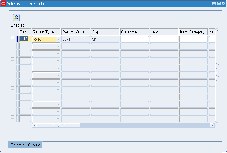

Click Assignment to open the rules workbench.
You use the Rules Workbench to assign your picking rule. The rule that you created on the Inventory Picking Rules page appears on the Rules Workbench. The system automatically assigns a sequence number and return type to the rule. You can modify the sequence number, but you cannot modify the return type. You can assign your rule to any combination of criteria the Rules Workbench displays. For example, if you create a picking rule that allocates material by lot number in ascending order followed by locator in ascending order, you can assign it to an item in the Rules Workbench. This means for picking, the system allocates the lowest lot number of the item in the lowest locator number where the item resides.
Enter values in any combination of the following fields. These values determine how the system allocates the material according to the rule that you created. For example if you created a rule that allocates lots based on FIFO, you can assign that rule to a particular customer, so that material you pick for that customer is allocated based on FIFO.
Customer
Item
Item Category
Item Type
Assignment Group
Source Subinventory
Supplier
Order Type
Freight Code
Project
Task
Transaction Action
Destination Subinventory
Transaction Reason
Transaction Source
Transaction Type
UOM Class
Date Type
Date From
Date To
Click Enabled to enable the rule for the given set of criteria.
Note: You can only modify disabled rules.
Save your work.
Related Topics

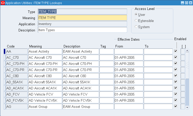

The User Item Type item attribute is a QuickCode you use when you define an item. You can use the types provided by Oracle Inventory or create your own.
To define your own item types
Navigate to the Item Type QuickCodes window. The User access level is selected indicating you can add or modify QuickCodes without restriction.
Enter a unique alphanumeric code describing the item type. You can define a maximum of 250 QuickCodes for a single QuickCode type.
You cannot change the values in this field after saving them. To remove an obsolete QuickCode you can either disable the code, enter an end date, or change the meaning and description to match a replacement code.
Enter the meaning of the item type. Inventory uses this value in the list of values for the User Item Type item attribute in the Items window.
Optionally, enter from and to effective dates.
If you enter an Effective From date you cannot use the item type before this date. If you leave this field blank, the item type is valid immediately.
If you enter an Effective To date you cannot use the item type after this date. Once an item type expires, you cannot define items using the item type, but can query items that already use the item type. If you do not enter an end date, your item type is valid indefinitely.
Indicate whether the item type is enabled. An item type must be enabled before you can define items using the item type. If you disable an item type you cannot use it to define items but can query items that already use this item type.
Save your work.

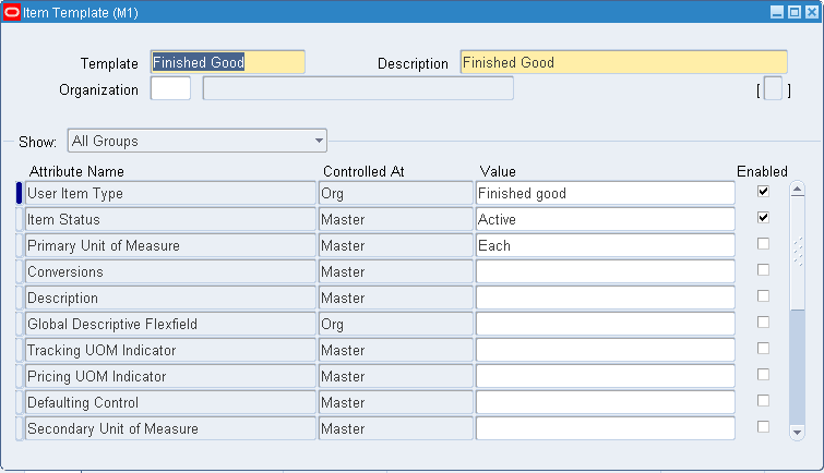

Templates are defined sets of attributes that you can use over and over to create many similar items. Templates make initial item definition easier. Oracle recommends that you use templates-either those Oracle provides or those you define-when you define your items.
The following four tables describe the templates provided by Oracle. Each table shows a different set of templates.

You can also define your own templates using the Item Templates window. Note that the window does not validate any of the template attributes. In other words, you can define a template with contradictory attributes. Only when you use a template to define an item does Inventory verify that the attributes are valid for a given item. If you cannot update an item attribute the value from the template is not applied. If a combination of attributes is invalid a warning appears when you save the item.
You can enable or disable the attribute value for each attribute in a template. When you use a template, it applies only the enabled attributes for that particular template.
To make defining templates easier, you can use the Copy From function on the Tools menu in the Item Templates window. This opens the Copy Template modal window, where you can copy attributes from one or more attribute groups to a new template. You can also create a hybrid template by copying attributes from multiple templates. See: Copying Item Templates.
You specify the template to use when you define or update an item. All updatable attributes you assigned to the template appear in the current item definition. You can then change the attributes as appropriate for the item you are defining.
If you specify a template name for an existing item, the template overwrites existing attributes. You can apply as many templates as you want to an existing item. The more recent attribute values (from the last template applied) override previous values unless the previous value is not updatable (such as the Primary Unit of Measure, which is never updatable). For example, you define a new item and apply a template that has the Primary Unit of Measure = EACH and Cycle Count Enabled = YES. Then you apply a new template with Primary Unit of Measure = DOZ, Cycle Count Enabled = NO, and Carrying Cost Percent = 3. The attribute values are now: Primary Unit of Measure EACH, Cycle Count Enabled NO, and Carrying Cost Percent 3.
Also, a template does not update status attributes when the values are conflicting. For example, if an item is transactable and stockable, a template cannot change Transactable to Yes if it leaves Stockable equal to No.
You can create templates that are specific to one organization. You can use an organization specific template only if you are in that particular organization. If the specific organization is not the Item Master organization, you may use that template only in the Organization Items window and only attributes controlled at the Organization level are updated.
For organization specific templates, some attributes, such as the planner, may be tied to the organization. For this reason, you cannot change the organization specified in the template once the template has been defined.

A template is a defined set of attribute values. When you apply a template to an item, you overlay or default in the set of attribute values to the item definition.
You can apply the same or different templates to an item multiple times. The more recent attribute values (from the last template applied) override previous values unless the previous value is not updatable (for example, the Primary Unit of Measure, which is never updatable).
For example, you define a new item and apply a template that has the Primary Unit of Measure = EACH and Cycle Count Enabled = YES. Next, you apply a new template with Primary Unit of Measure = DOZ, Cycle Count Enabled = NO, and Carrying Cost Percent = 3. The attribute values are now: Primary Unit of Measure EACH, Cycle Count Enabled NO, and Carrying Cost Percent 3.
To define item templates
Navigate to the Item Templates Summary folder window.
Choose New to navigate to the Item Template window.
Enter a unique name and description for the template.
Indicate whether the template is restricted to use by only one organization. If you leave the organization code blank, you can use the template in any organization.
Note: When you enter an organization code, some attributes, such as the planner, may be tied to the organization. For this reason, you cannot change the organization once the template has been defined.
Select an tabbed region to display attributes and values for an item attribute group.
Enter a value for those attribute you want to include in the template.
For non-mandatory item attributes, you can enter blanks (spaces) for the value or leave null. When you next apply this template to an item, the spaces overwrite any existing attribute value.
Indicate whether an attribute is enabled for this template.
Important: If you enable a status attribute, its value will not be applied to the item if the status attribute is under status control. See: Defining Item Status Codes.
Save your work.

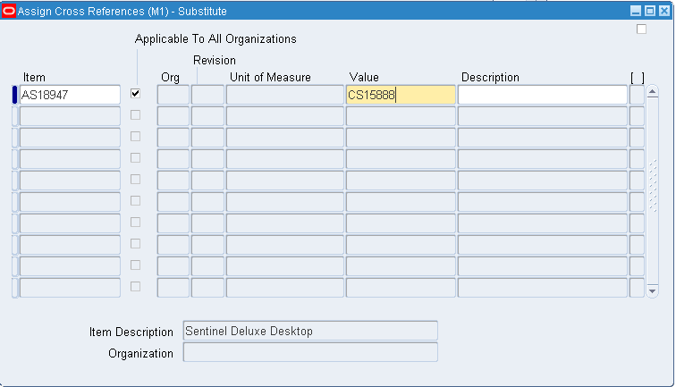

You can assign multiple cross-reference types to an item.
To assign cross-references types to items from the Cross-Reference Types window
Navigate to the Cross-Reference Types window.
Select the cross-reference you want to assign.
Choose Assign to navigate to the Assign Cross-References window.
Enter an item.
Indicate whether the cross-reference applies only in the specified organization or to all organizations to which the item is assigned.
You can optionally enter a unit of measure for the cross-referenced entity if the cross-reference type is Item GTIN Code. You can select any UOM that is permissible in a transaction.
Enter the name of the organization to which the cross-reference applies.
If you select Applicable To All Organizations, this field is skipped.
Enter a cross-reference value.
This value is the entity you cross-reference to the item, such as its old item number or supplier part number.
Save your work.
To assign cross-references types to items from the Master Items Summary window:
Navigate to the Master Items Summary window.
Select an item.
Choose Cross References from the Tools menu.
Enter the cross-reference type name.
Save your work.

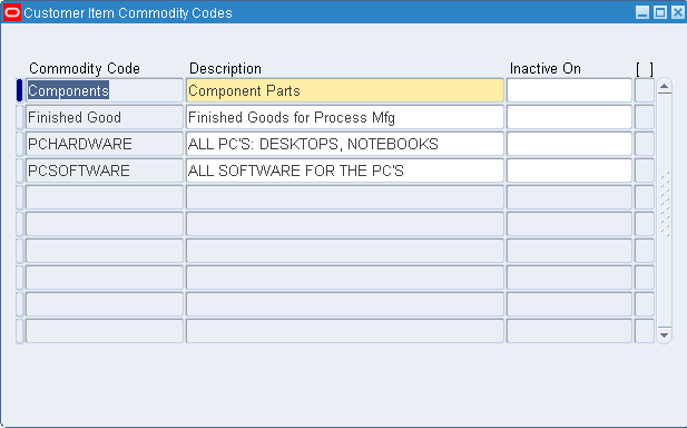

Customer Item Commodity Codes are used to group customer items and can be entered during the definition of customer items.
To define a commodity code
Navigate to the Customer Item Commodity Codes window from the menu. When you open the window, Inventory displays the existing commodity codes.
Enter a unique commodity code name.
Enter a description of the code.
Save your work.
To make a commodity code inactive
Enter the date on which the commodity code becomes inactive. As of this date, you cannot assign this code to a customer item.
You can delete a commodity code if it has not been used in a customer item.

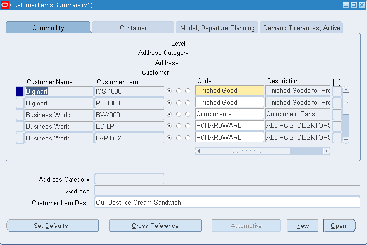

Use the Customer Items Summary and Customer Items Detail windows to define and update customer items. You can toggle between these windows with the Summary/Detail option in the Go option on the Toolbar. You can cross reference customer items to your Oracle Inventory items to support processing orders and shipments. See: Defining Customer Item Cross References.
To find customer items
Navigate to the Find Customer Items window by selecting Customer Items from the menu.
Enter selection criteria. Note that you can enter a specific Address Category or Address only if you have entered a customer.
Select the Find button to open the Customer Items Summary window.
To define customer items
Enter the Customer Item number and description.
Select one of the existing Customer Names (in the Details window, you can use either Customer Name or Customer Number,). See: Creating a Customer, Oracle Receivables User's Guide.
Select the Definition Level: Customer, Address Category, or Address.
A customer item defined at the Customer level is recognized across all address and address categories for that customer. If you ship an item to multiple customer ship-to sites that have been grouped as an address category, you can define the customer item for that address category. You would define a customer item at the address level if you ship the item to only one ship-to site for that customer.
For the Address Category definition level, enter the address category. See: Creating an Account Site, Oracle Receivables User's Guide.
For the Customer Address definition level, enter the customer address.
In the Commodity tabbed region, you can assign the customer item to a Commodity Code. See: Defining Commodity Codes.
In the Container tabbed region, you can enter the default master and detail containers for this customer item as well as the minimum fill percent for the container. See: Defining Container Types.
In the Model, Departure Planning tabbed region, you can reference a customer item as when the item is a Customer Item that belongs to the same Customer and the BOM Item Type attribute is set to Model. See: Bills of Material Attribute Group.
You can also check Required to indicate that items must be departure planned before they released and Before Build to indicate that ATO items must be departure planned before they are built.
In the Demand Tolerances, Active tabbed region, you can enter positive and negative tolerance percentages and select or deselect the Active check box.
Save your work.
To open the Customer Items Details window
To facilitate information entry, you can select the Open button in the Customer Items Summary window to open the Customer Items Details window, where you can enter any of the information in the Customer Items Summary window.

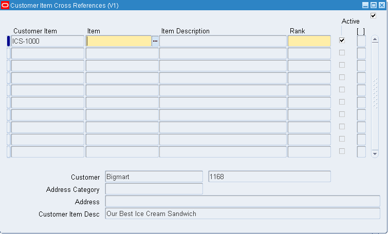

Use the Customer Item Cross References window to define and update cross references between your inventory items and the customer item numbers defined in the Customer Items Summary/Detail windows. See: Defining Customer Items.
To find customer item cross references
Navigate to the Find Customer Item Cross References window by selecting Customer Item Cross References on the menu.
Enter selection criteria to restrict the search. You can select the Clear button to clear all selection criteria.
Select the Find button.
To define customer item cross references
Navigate to the Customer Item Cross References window by selecting the New button in the Find Customer Item Cross References window.
You can also navigate to this window by selecting the Cross Reference button in the Customer Items Summary window. Inventory displays the existing cross references for the customer item on the current line in the Customer Items Summary window, and you can add new cross references by selecting a new row.
Enter the customer item number. The current customer is displayed if you navigated to this window from the Customer Items Summary window.
Enter the inventory item number for which you want to establish a cross reference to the customer item number.
Enter the Rank as a positive number. To permit alternate or substitute inventory items for a customer item, you can define multiple cross references to inventory items for a single customer item. In these cases, you must specify the Rank of the cross reference. The highest rank is 1.
Deselect Active to deactivate the cross reference.
Save your work.

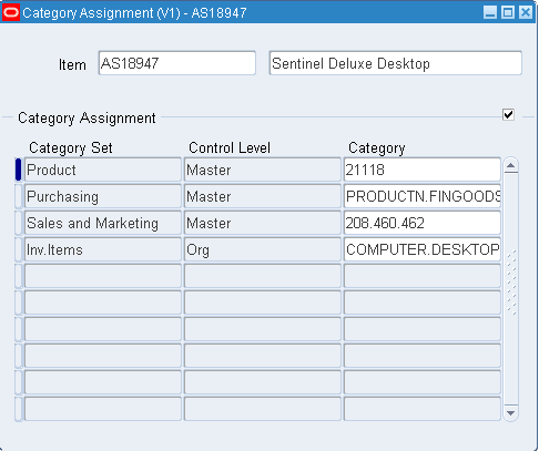

You can use categories and category sets to group your items for various reports and programs. A category is a logical classification of items that have similar characteristics. A category set is a distinct grouping scheme and consists of categories.
The flexibility of category sets allows you to report and inquire on items in a way that best suits your needs.

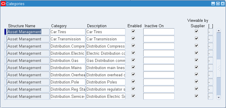

To define a category
Navigate to the Categories window.
The Find Categories window appears. Choose New.
If you choose a multi-segment flexfield structure you can assign a specific meaning to each segment. For example, if you want to group items according to product line and product information then you can use the first segment to represent product line and the second segment to represent the product. See: Item Category Flexfield Structures.
Important: The categories assigned to a category set must have the same flexfield structure as the set itself. This is true even if you choose not to validate the category list.
If you have set up your flexfield segment as No Validation required, you can enter a unique category name.
Optionally, enter a category Description.
Select Enabled to enable the category.
Select Viewable by Supplier to allow suppliers to see the category in iSupplier Portal.
Save your work.
Enter the date on which the category becomes inactive.
As of this date, you can no longer assign the category:
as the default category of a new category set
as a valid category of a category set
to an item
as a valid category of an item catalog group
You cannot assign an inactive date to a category that is the default category for a mandatory category set.

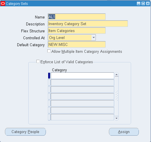

You can use categories and category sets to group items for various reports and programs.
Note: Category sets may be used as a means to develop custom lists of items on which to report and sort. You can also create other category sets such as John's Priority or Jane's Priority, with categories like high, medium, and low.
The category set Inventory is seeded when you install Oracle Inventory. The category set Purchasing is seeded when you install Oracle Purchasing.
If you plan to use Order Management's group pricing functionality with item categories, you must add the categories to the Order Entry category set.
Important: You must use this window to define valid categories for each purchasing category set before you can use Oracle Purchasing.
To define a category set
Navigate to the Category Set window.
Enter a unique category set name.
Enter a description.
Note: The categories you assign to a category set must have the same flexfield structure as the set itself. This is true even if you choose not to validate the category list.
Master Level: Item assigned to this category set has the same category value in all organizations where it is assigned.
Org Level: Item assigned to this category set may have a different category value in each organization where it is assigned.
This is the default category used when assigning an item to the category set. For example, a category set may have a default category called New. After an item is assigned to New, you can override the default category and choose another relevant category for each item.
Indicate whether to enable an item to be assigned to multiple categories within this category set.
If you enable this feature, you can assign an item to multiple categories within a category set. For example, you may define a Hazard category set. In this case, an item may be assigned to both the Poison and Corrosive categories.
Note: Enable this feature to create cartonization groups. See: Cartonization
Note: For cost management purposes, Oracle recommends having a separate category set, with this feature disabled, for costing fixed assets. Costing functionality does not permit an item to be associated with multiple categories within a category set.
Indicate whether to enforce the list of valid categories.
If you do not enable this feature, you can assign an item to any category defined that uses the same flexfield structure as this category set.
If you enable this feature, you can assign an item only to those categories defined as valid categories for this category set.
If the enforce list of categories assignment checkbox is not checked, then all of the categories associated to the category set for purchasing are displayed in the LOV on the Enter PO window.
if the enforce list of categories assignment is checked, only the categories defined in the table are available in the category LOV on the enter PO window.
Select a list of valid categories.
The list of values here includes only categories that use the same flexfield structure as the category set you are defining.
Save your work.

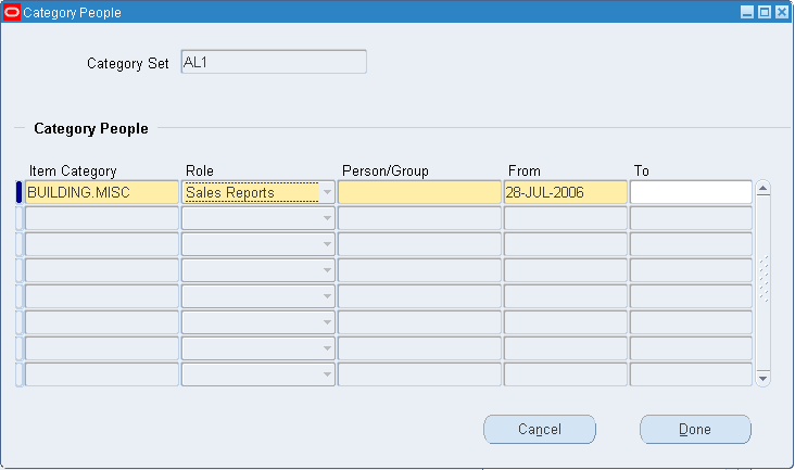

To assign people to categories
The category people window is available to you if you have the edit category people privilege. Category people allows you to secure access to items that are assigned to a particular category. For example you can restrict who can view the sales reports for a particular set of items.
Select Category People from the Category Sets window.
Select the desired Item Category from the list of values.
Select the desired Person/Group from the list of values.
Enter the desired From date, or accept the default system date.
Enter a To date if applicable.
Repeat steps 2-5 to assign more categories as needed.
Save your work.
Select Done.

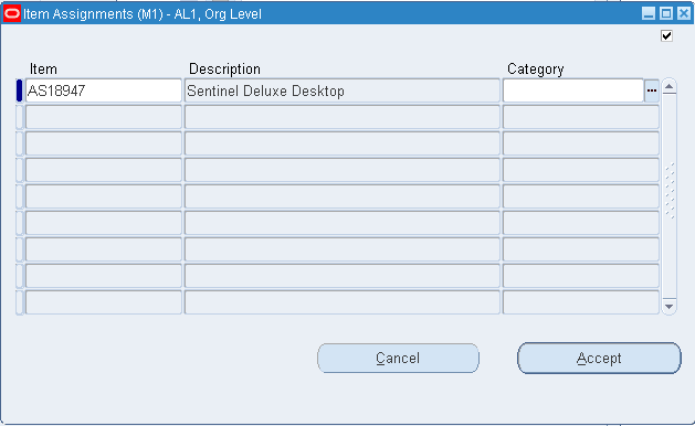

To assign items to categories:
Choose the Assign button. See: Assigning Items to Categories.

When you install Oracle Inventory, you must assign a default category set to each of the following functional areas: Inventory, Purchasing, Order Management, Costing, Engineering, and Planning. Product Line Accounting is seeded with the Inventory category set. Inventory makes the default category set mandatory for all items defined for use by a functional area. If your item is enabled for a particular functional area you cannot delete the item's corresponding default category set assignment. Default category sets are required so that each functional area has at least one category set that contains all items in that functional area.
You can enable an item for each functional area by using that functional area's item defining attribute. An item defining attribute identifies the nature of an item. For example, what designates an item as an “engineering item" is the attribute Engineering Item. If a functional area's item defining attribute is controlled at the Organization level, then that functional area may only have an Organization level default category set.
You set the item defining attribute when you define the item. The following table presents item defining attributes:
| Functional Area | Item Defining Attribute | Enabling Value |
| Inventory | Inventory Item | Yes |
| Purchasing | Purchased | Yes |
| Purchasing | Internal Ordered Item | Yes |
| Master Scheduling/ MRP | MRP Planning Method | MRP Planning, MPS Planning |
| Cost Management | Costing Enabled | Yes |
| Engineering | Engineering Item | Yes |
| Order Management | Customer Ordered Item | Yes |
| Service | Support Service, or | Yes |
| Service | Serviceable Product | Yes |
| Product Line Accounting | none | n/a |
When you enable an item for a certain functional area, Oracle Inventory automatically assigns the item to the default category set of that functional area and the default category of that set. For example, if you set Inventory Item to Yes, then Inventory automatically assigns the item to the Inventory functional area's default category set and default category.
You may change a functional area's default category set under certain conditions. You should ensure that every item within the functional area belongs to the new default category set (which replaces the existing default category set). If the item defining attribute of the functional area is controlled at the Organization level then the new default category set should also be controlled at the Organization level.
Prerequisites
To define a default category set
Navigate to the Default Category Sets window.
Select the category set to use as the default for the functional area.
Oracle Inventory also makes this category set mandatory for all items defined for use by the functional area.
You should not change the Purchasing category set after you have created requisition or purchase order lines using the categories.
Note: Product Line Accounting is enabled when you assign a default category set.
Note: The category set Product, is a seeded category set. It is the default category set for the Product Reporting functional area. The system automatically assigns this category to customer ordered or internal ordered items.
Save your work.

When you enable an item in a functional area, the item is assigned to the default (mandatory) category set and default category of the functional area. You can override the category set's default category. In addition, you can manually assign your item to an unlimited number of category sets. You may optionally assign an item to more than one category within a category set based on the category set definition. For more information see: Defining Category Sets
To assign an item to a category from the Category Set window
Navigate to the Category Set window. See: Defining Category Sets.
Enter a category set.
Choose Assign. The Item Assignment window appears.
Select the item from the current organization to assign to the category.
Select a category.
The list of values contains categories with the same flexfield structure as the category set you selected in the Category Set window. If Enforce the list of valid categories is selected the list is limited to those categories.
Save your work.
To assign an item to a category from the Item windows
Navigate to the Master Items Summary or Organization Items Summary window.
Select an item.
Choose Categories from the Tools menu.
The item you selected appears at the top of the Category Assignment window.
Select a category set
Select a category.
The list of values contains categories with the same flexfield structure as the category set you selected. If Enforce the list of valid categories is selected the list is limited to those categories.
Save your work.

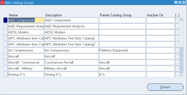

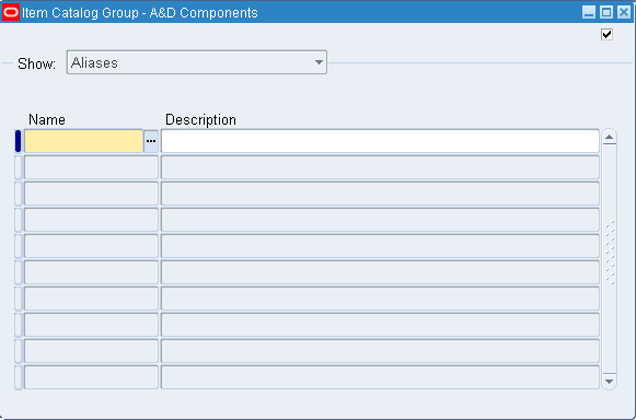

You can specify any number of recommended categories for an item catalog group. This is for information/reporting purposes only. You can print the list of categories and use the list as recommended categories when you define items.
To enter a list of recommended categories to use when assigning categories to the items in this catalog group
Navigate to the Item Catalog Groups window.
Select an item catalog group and choose Details. The Item Catalog Group window appears.
Select the Categories tabbed region.
Select a category set and category.
Save your work.

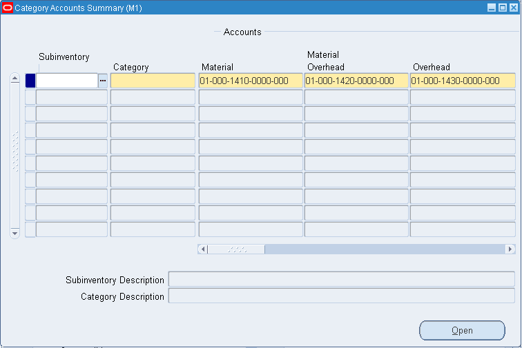

You can use the Category Accounts Summary window to define, query, and update category valuation and expense accounts. If your current organization is a standard costing organization, you can define category accounts at the category and optionally subinventory level. If your current organization is an average costing organization you must define category accounts at the cost group/category level.
You can only define category accounts for categories that belong to the default category set for the product line functional area. See: Defining Category Sets and Defining Default Category Sets.
You cannot update category accounts if any of the restrictions explained in the following table exist:
| Condition Preventing Account Update | Standard Costing Organization | Average Costing Organization |
| On hand Quantity > 0 | Quantities exist in the subinventory. Note: If subinventory is null, all subinventories in the organization are considered. | Quantities exist in any locator associated with the cost group |
| Pending Transactions | Pending transactions associated with the subinventory and category exist | Pending transactions associated with the project and cost group exist |
| Uncosted Transactions | Uncosted transactions associated with the subinventory and category exist | Unclosed transactions associated with the cost group exist |
To define or change category accounts in a standard costing organization
Navigate to the Category Accounts window. The Find Category Accounts window appears.
If you are defining a new category account, choose the New button. If you are changing an existing category account, select a category, or subinventory, or both, and choose the Find button. In both instances, the Category Accounts Summary window appears.
Optionally, select a Subinventory.
If a subinventory is not selected, you can define accounts that are specific to the category. Once you define a category account with a null subinventory, the accounts that are associated with that category are defaulted each time you define a new category/subinventory combination for that category.
For example, if you select a category, override the defaulted organization level accounts, then save your work, the next time you select this category in this window, the new accounts not the organizational level accounts are defaulted. These default accounts can be overridden. Categories with null subinventories can be used as templates when you need to create several category/subinventory combinations.
Select a Category.
When you select a category, accounts are defaulted from the organization level. You can change these accounts.
Select account numbers for the following:

To define category accounts in an average costing organization
Select New to open the Category Accounts Summary window.
Important: You can also enter and update account information for a single category in the Category Accounts window, which you can access by selecting the Open button.
Select a Category.
Select a Cost Group.
Cost groups are mandatory. If your current organization is not Project References Enabled, the organization's default cost group is used and cannot be update. If your organization is Project References Enabled, you can select any cost group. See: Defining Cost Groups, Oracle Cost Management User's Guide .
Important: All subinventories that contain items belonging to the selected category set use these accounts for inventory valuation. You therefore cannot change an account if there is on-hand inventory in any of these subinventories.
Material: A default general ledger account to accumulate material costs for this category/cost group. This is usually an asset account.
Outside Processing: A default general ledger account to accumulate outside processing costs for this category/cost group combination. This is usually an asset account.
Material Overhead: A default general ledger account to accumulate material overhead or burden costs for this category/cost group combination. This is usually an asset account.
Overhead: A default general ledger account to accumulate resource or department overhead costs for this for this category/cost group combination. This is usually an asset account.
Resource: A default general ledger account to accumulate resource costs for this category/cost group combination. This is usually an asset account.
Encumbrance: A default general ledger account to hold the value of encumbrances against this category/cost group combination
Bridging: This account is optional.
You can also optionally enter an Analytical Invoice Price Variance, Analytical Purchase Mirror, Non-Invoiced Sales Order, Non-Invoiced Revenue, Analytical Revenue Mirror, Analytical Margins of Goods Sold, and Average Cost Variance account.
Analytical Invoice Price Variance:
Analytical Purchase Mirror:
Non-Invoiced Sales Order:
Non-Invoiced Revenue:
Analytical Revenue Mirror:
Analytical Margins of Goods Sold:
Average Cost Variance:
Save your work.
You can use item cataloging to add descriptive information to items and to partition your Item Master into groups of items that share common characteristics. You configure in advance what is required to uniquely define an item in each group. When you define your items, you assign them to an item catalog group.
To define your catalog, you set up as many distinct item catalog groups as you need to partition your Item Master. Each group has unique characteristics (called descriptive elements) that completely describe items belonging to the group.
When you assign an item to an item catalog group, you define values for the descriptive elements that apply to your item. For example, an item catalog group called Computer could have a descriptive element called Processing Speed. Possible values for Processing Speed might be 100MHZ, 133MHZ, and so on.
Once the process of defining and cataloging items is complete, you can:
Provide standard language in referring to items, enabling companies in the same industry to communicate effectively without needing to name their items identically.
Store a detailed description of what an item is without having to embed that meaning in the item number.
Use descriptive elements as search criteria for items.
Update the item description with a concatenated value of the item catalog group information.
Find common existing parts when developing an engineering prototype.
To define an item catalog group
Enter a unique name for the group.
If you choose to build an item's description from the catalog, the description is built beginning with the information entered here. See: Concatenated Item Descriptions.
Note: You can choose to use the Catalog Name instead of the Description as the first element in a concatenated item catalog description. To do this change the INV:Use catalog name in the item description profile option to Yes. See: Oracle Inventory Profile Options.
Save your work.
To make an item catalog group inactive
Enter the date on which the catalog group becomes inactive.
As of this date you can no longer assign items to this group. You can use an inactive group in reports and searches.
To define descriptive elements for an item catalog group
Select an item catalog group and choose Details. See: Defining Descriptive Elements.
Related Topics
Specifying Recommended Categories
When you define descriptive elements for an item catalog group, you specify whether the value of a particular descriptive element can be concatenated and used as an item's description.
When you assign an item to a catalog group, you choose descriptive elements that apply to the item, and assign values to the descriptive elements. You can then create a concatenated item description by choosing the Update Description button. If you choose Update Description, Oracle Inventory concatenates the item catalog group information and overwrites the item description with this new information.
Oracle Inventory builds a concatenated item description by combining segments of catalog information. The first segment is either the catalog group Description or the Catalog Name. You can choose which to use by setting the INV:Use catalog name in the item description profile option. See: Oracle Inventory Profile Options.
Additional segments consist of the values for descriptive elements that have Description Default turned on.
The Item Catalog Flexfield separator is used as a delimiter between each segment of the combined description. See: Defining Key Flexfield Segments, Oracle Applicatons Flexfields Guide.
When the description is displayed, the delimiters appear even if data is missing for some of the descriptive elements. For example, an item catalog group called Computer with a description of Personal Computer, and descriptive elements of Speed (25 MHZ), Size ( ), and Monitor (color), would produce this description:
Personal Computer,25 MHZ,,color
Related Topics
You can define any number of descriptive elements for an item catalog group. You can also describe whether the descriptive element is required at item definition, and whether the descriptive element value is included by default in the item catalog description.
Descriptive element values can be concatenated and used to create an item's description. You turn this feature off or on for each descriptive element in a catalog group. Turn Description Default on for any element you want included in a concatenated description. You create a concatenated description when assign an item to an item catalog group. See: Assigning Items to Catalogs.

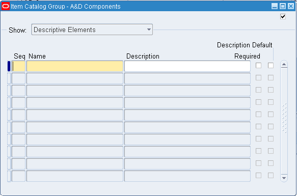

Select the Descriptive Elements tabbed region.
Enter a unique sequence number.
When you assign an item to a group, the descriptive elements are presented in the order you define here.
Enter the name of a new descriptive element.
Examples: Color, height, texture.
Determine whether the descriptive element is required for this catalog group.
When you assign an item to a catalog group, you must enter a value for required descriptive elements in order for the catalog to be considered complete. If an element is not required, entering a value is optional.
Determine whether the descriptive element is automatically used to create the catalog description (Description Default).
If you choose to concatenate the value of the descriptive element to create the catalog description, you can use this description to overwrite an existing item description.
Save your work.
Related Topics
You can specify any number of aliases for items that belong to a catalog group. This is used for information and reporting purposes only.
To define an aliases for items in a catalog group
Select an item catalog group and Choose Details. The Item Catalog Group window appears.
Select Aliases from the Show drop down list.
Enter a unique Name for the alias in the name field.
Enter a Description for the alias.
Save your work.
