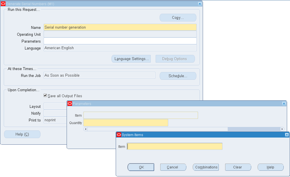

Navigate to the Generate Serial Numbers window or All Reports window.
Enter Serial Generation in the Name field. The Parameters window opens.
Enter an item that is under serial number control.
Enter a quantity of serial numbers to define and reserve for the item. The quantity must be a positive integer.
Click Submit to launch the process.

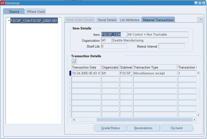

Click the Material Transactions tab to view the material transactions that are associated with the serial. The Item Details alternative region displays information about the item. The Transaction Details alternative region displays item transactional information, such as the transaction date, subinventory, and transaction type.

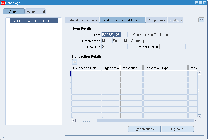

Click the Pending Transactions tab to view pending transactions for the serial. Pending transactions are actions that you performed on the serial, but are not completed by the transaction manager. The Item Details alternative region displays information about the item. The Transaction Details alternative region displays item transactional information, such as the transaction date, subinventory, and transaction type.

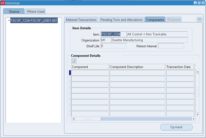

Click the Components tab to see the components used in the item production with their associated quantities. You can click this tab only if you view by Source. You can also restrict the Components tab to honor formula security. You can restrict formula security by user or responsibility. Three levels of security are available: Update, View-Only, and Hidden. When a user tries to access the genealogy of serial to which he or she does not have formula access, the system displays a warning message.
The Item Details alternative region displays information about the item, such as the item number and organization where the item resides. The Component Details alternative region contains detailed component information, such as the associated job or batch if applicable, and the component item number and description.

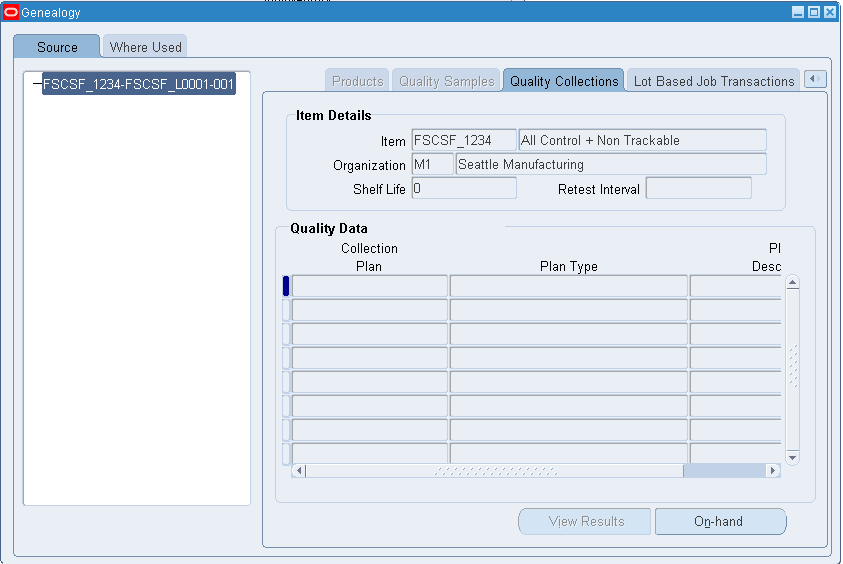

Click the Quality Sample tab to view process manufacturing quality information. You enable process quality on the Item Master. The Item Details alternative region displays information about the item, such as the item number and the current organization where the item resides. The Quality Data alternative region displays information, such as the sample number, sample source, and quality results
If you have Oracle Quality installed, you can define serial number as a collection element. If the serial is not associated with the quality data, you cannot see it in the Quality Collections tab. The Item Details alternative region displays information about the item, such as the item number and the organization where the item currently resides. The Quality Data alternative region displays information about the quality collection plan.

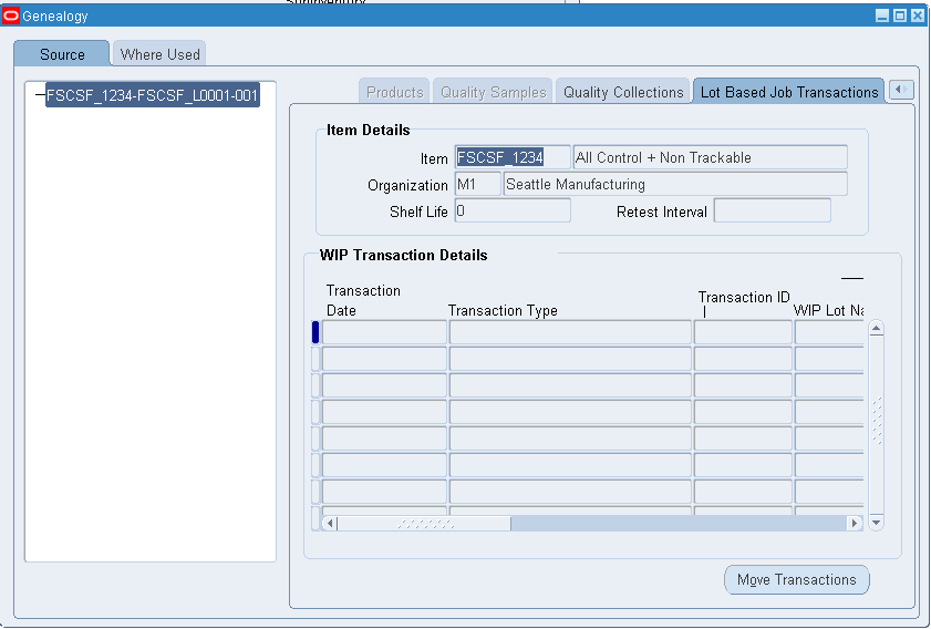

If you have Oracle Shop Floor Management installed, you can see the Lot Based Job Transactions tab. The Lot Based Job Transactions tab displays the Oracle Shop Floor Management transactions, such as splitting, merging, bonus lots, and updating assemblies. It displays the previous values for WIP Lot Name, Start Quantity, and Assembly Number, and the resulting values after the transaction.
