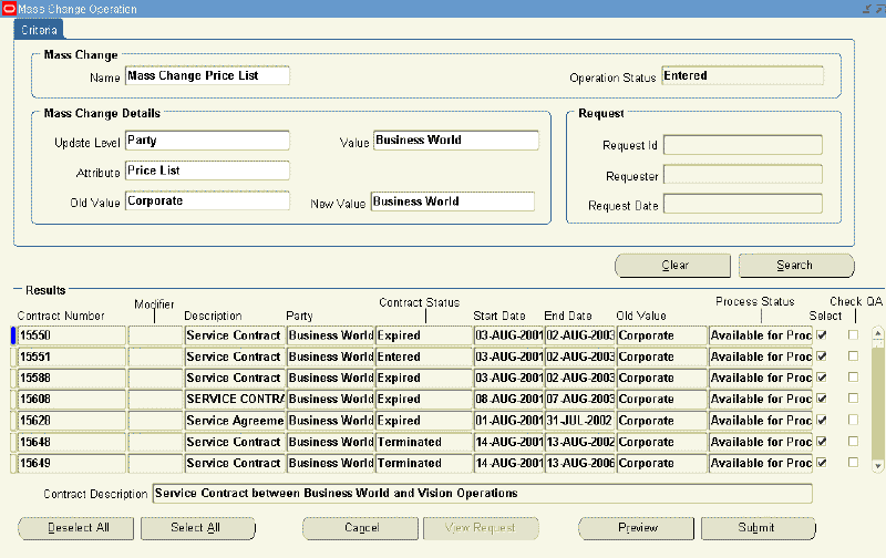

Modifying Multiple Contracts at the Same Time (Mass Change)
You can change one attribute of multiple contracts with a single request using mass change functionality. Mass change is allowed for contracts that are in appropriate status, where the operation update online is permitted.
Note: Canceled contracts and Entered contracts that contain no lines do not appear in the Mass Change form. This form is designed for contract administrators to centrally manage contracts, which are generally in the Active status. Entered contracts, which may have lines and no sublines are essentially acted upon by assigned sales representatives who do not typically need to perform mass changes. Sales representatives are usually managing a limited number of contracts with specific requirements, rather than a large number of contracts that may require mass changes.
Mass Change supports changes to a particular instance selected in the update level. For example, if changes are to be made at the operating unit, it will update records pertaining to that operating unit.

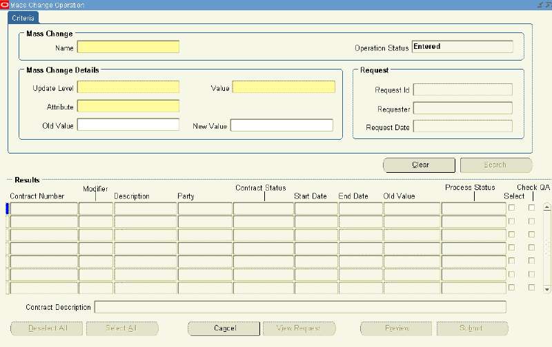

The Mass change window allows you to enter the scope of the mass change request and selection criteria. It determines which contracts are to undergo a mass change. The update level is seeded, but may also be restricted by use of the OKS: Mass Change Security Level profile option. If the security of the profile option is turned on, the list may contain only the Contract and Contract Group levels; otherwise, the following is the list of update levels available:
Mass change permits the following attributes to be changed. Making change on a contract has a subsequent cascading effect and therefore needs to be carefully considered before allowing such a change. Following attributes are permitted for mass change that can be selected from the Attribute's LOV in the Mass Change header:
To modify multiple contracts at the same time:
  1. From the Navigator, navigate Contract Administration, and then select Mass Change.
    The Mass Change Operation window appears.
    the picture is described in the document text
  2. Enter the name of mass change.
  3. From Mass Change Details select the value Update Level from the LOV, such as Party.
  4. Select Value from the LOV, such as Business World.
  5. Select an appropriate attribute from the LOV, such as Price List
    Attributes supported by mass change are listed in this list.
  6. Select an old value, such as Corporate.
  7. Select a new value, such as Business World.

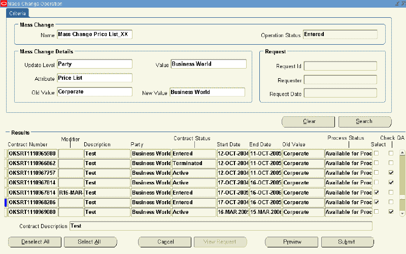

  8. Click Search or click Cancel and start over.
    If you click the Search button, all the contracts that meet the criteria appear in the Result region. By default, all the records are selected.
  9. To deselect a contract, check the Select check box.
    Note: You can deselect all contracts by clicking Deselect All or you can select all contracts by clicking Select All.
  10. To run the quality assurance (QA) check first, select the Check QA check box.
  11. To preview the request without submitting it, click Preview.
    The Mass Change Submission window appears.
    Because the Mass Change is a powerful process, you may preview a report. This ensures that you do not unintentionally update any contracts. To do so, you can run a preview, review the report, then submit it when you are confident the changes are correct.
  12. To submit the request, click Submit the Request.
    1. Select either As soon as possible or On Specific day.
    2. Click OK.
      A note appears, indicating that the Mass Change request was successfully submitted.
      You are returned to the Mass Change window. The Operation Status field provides the status for the mass change.
      The Request region is populated with details of the request.
      Note: While submitting the mass change request, if one of the requests has an error it will display an error message. In this case, you can resubmit the request after making the changes to that request. This can be done until all the contracts in the mass change request are successfully processed.
  13. To view the details for the request, select View Request.
    The Requests window appears.
  14. After the request is completed, requery the Mass Change request window to view the updated operation status and request information in the Mass Change Operation window.

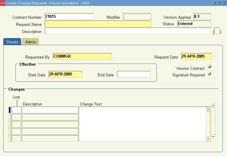

Entering Contract Changes
Prerequisite
Confirm the status and operations setup allows changes for the category and status.
To enter contract changes:
  1. From the Navigator, navigate to Contract Administration, and then select Launchpad.
  2. Select the Contract Navigator tab.
  3. Highlight the contract you want to change.

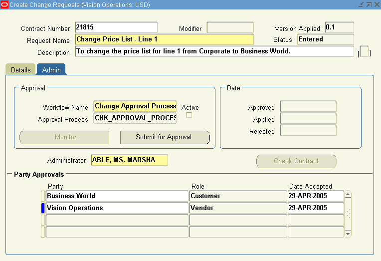

  4. Right-click the contract and select the Create Change Request option.
    The Create Change Requests window appears.
  5. Enter the request name and a description.
  6. Confirm the requester's name in the Request By field.
    This person receives a workflow notification when changes are approved and can be applied to the contract.
  7. Enter the request date.
  8. Enter the effective dates.
  9. To version the changed contract, select the Version check box.
  10. To require signature, select the Signature Required check box.
  11. Record the lines for which you are requesting a change and the exact nature of the change. For example, apply an extra 10% discount.
  12. Select the Admin tab.
  13. In the Workflow Name field, select the approval workflow.
  14. Select an administrator.
  15. Select party approvals (optional).
  16. Save.
  17. Click Submit for Approval.
    A note message appears, indicating that the change request has been Submitted for approval
  18. Click OK.

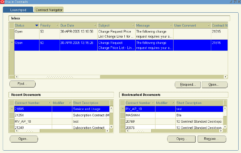

  3. From Select Notification Type, select Change Request Approvals.
  4. Click Find.
    The contracts that have open change requests appear.
  5. Highlight a contract from the Inbox and click Respond.
    The Notification Details window appears.
  6. Click Approve.
    The worklist window shows the change request has been approved.

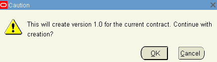

To create different contract versions for your customer:
  1. From the Service Contracts Authoring window, select the Tools menu and select Create New Version.
    A caution window appears indicating that the application will create a new version.
  2. Click OK.
    A note appears, indicating that a new version has been created successfully.
  3. Click OK.
    In the Version field, the digit that is in front of the period, or the major version number, increases by one. The minor version is reset to zero.

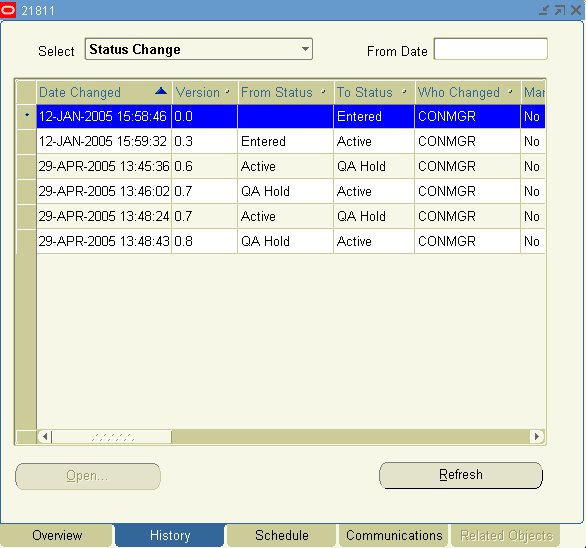

Viewing Contract History
To view contract history:

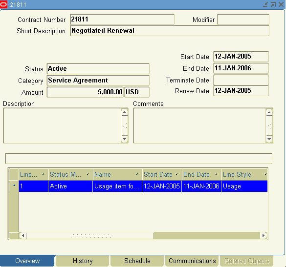

  1. In the Contract Navigator tab of the Oracle Contracts window, select a contract.
  2. Double-click the contract.
    The Contract Execution window appears.
  3. Select the History tab.
  4. From the Select list choose an option:
  5. To open a contract version or change request, highlight the version and select Open.
    Depending on what you select, the Service Contracts Authoring window or the Create Change Request window appears.

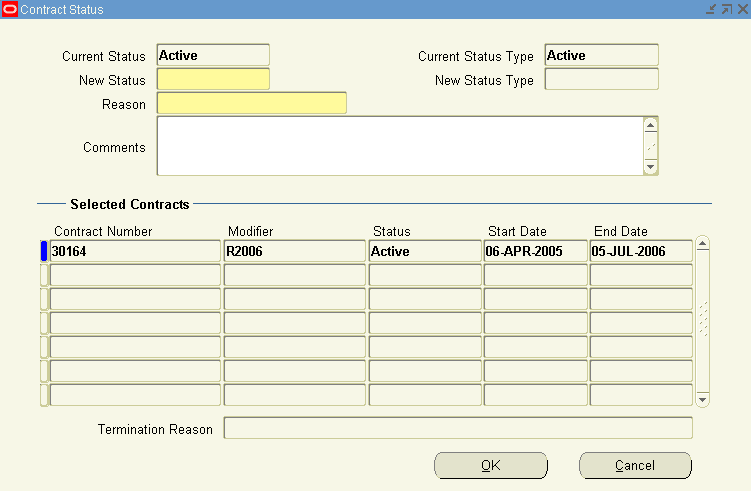

  1. In the Contract Navigator, right-click a contract and select Change Status.
    The Contract Status window appears.
  2. Select the new status from the LOV.
    Note: The New Status LOV is dependent on the Current Status. For example, the New Status LOV values for Terminated contract are different from that of an Entered or Active Contract.
  3. Select a reason from the LOV.
    If you need to add more reasons for the status change, your system administrator can add more options in the Lookup Codes.
  4. Use the Comments field to enter any additional information.
  5. Click OK.
  6. A Status window appears indicating that the status change was successful.
  7. Click OK.
